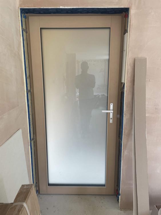

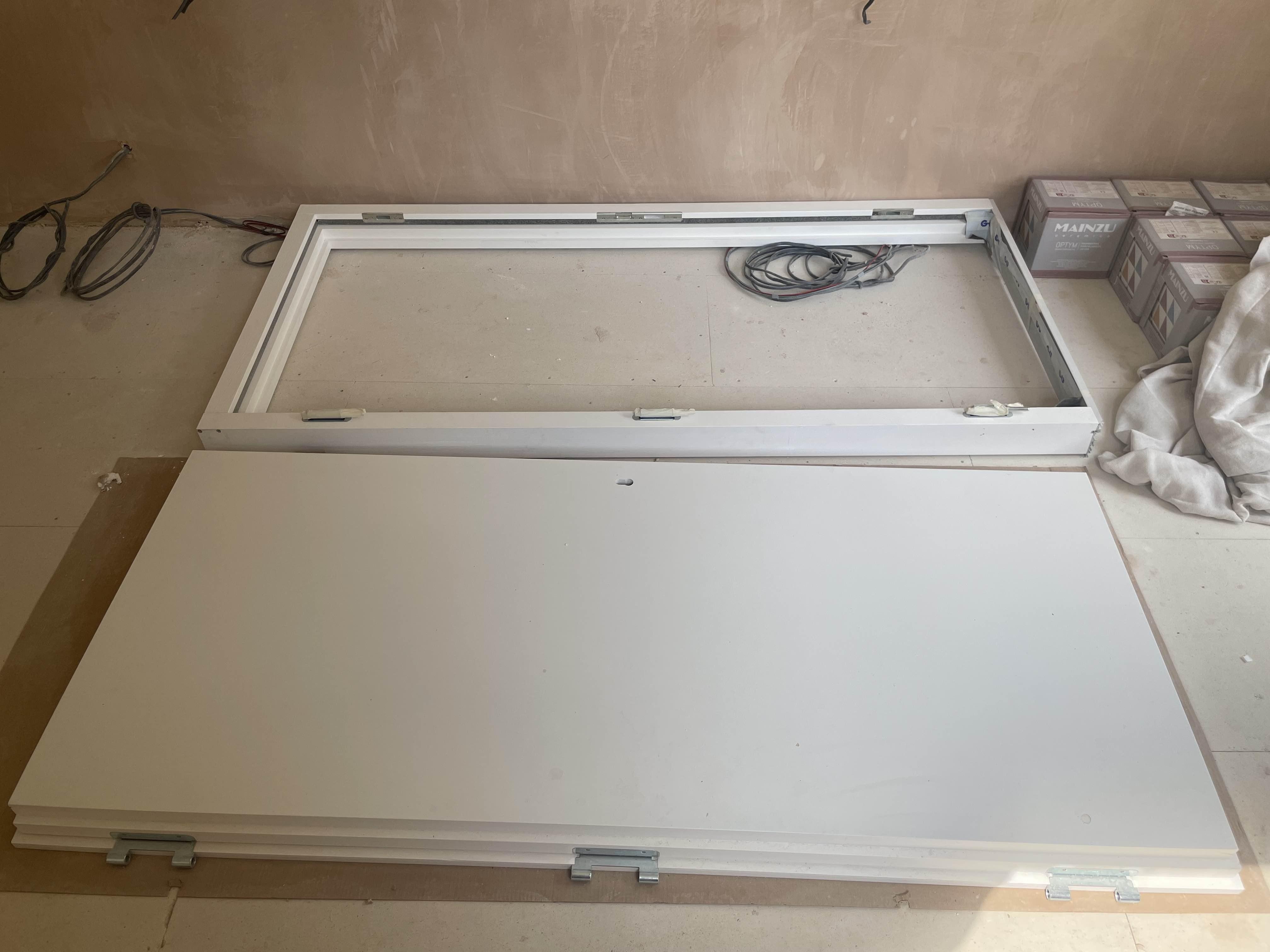

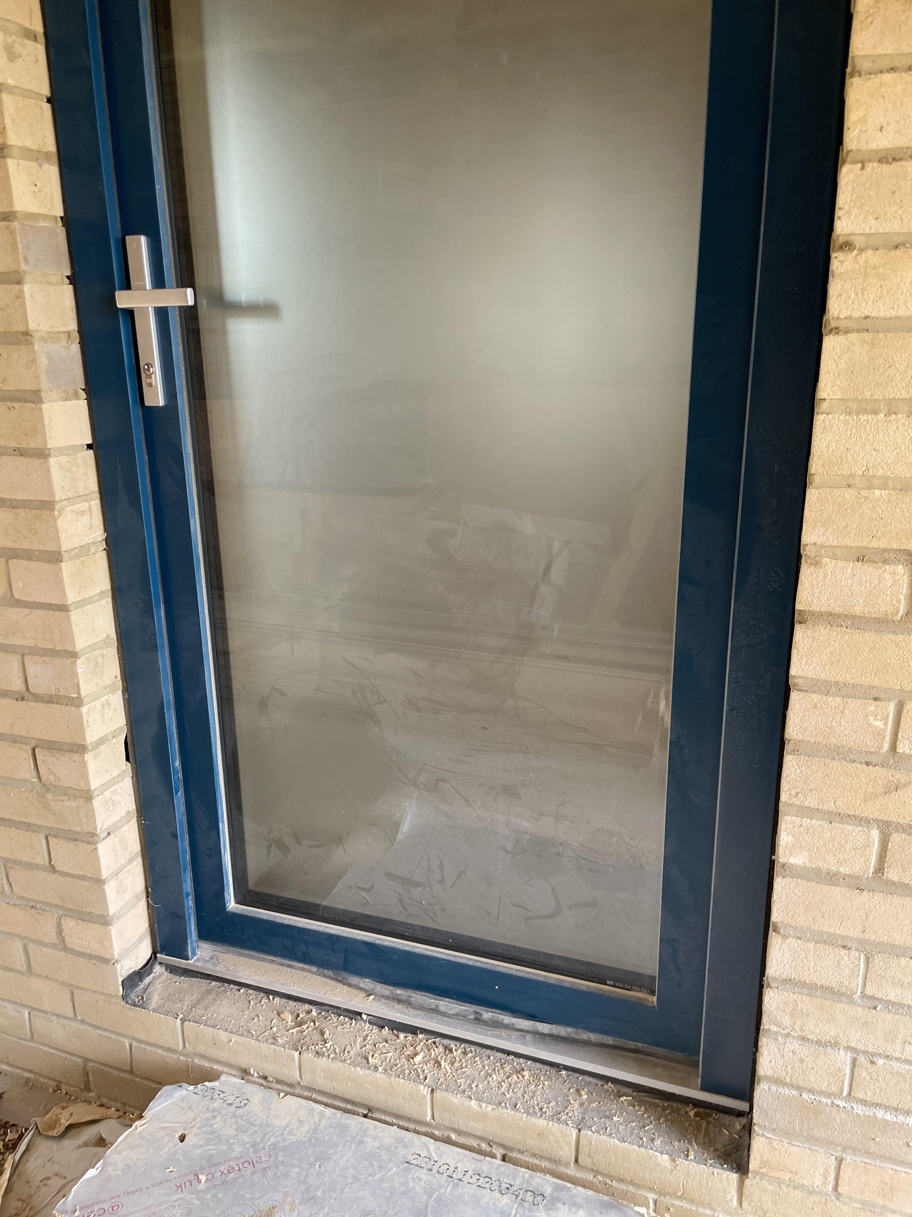

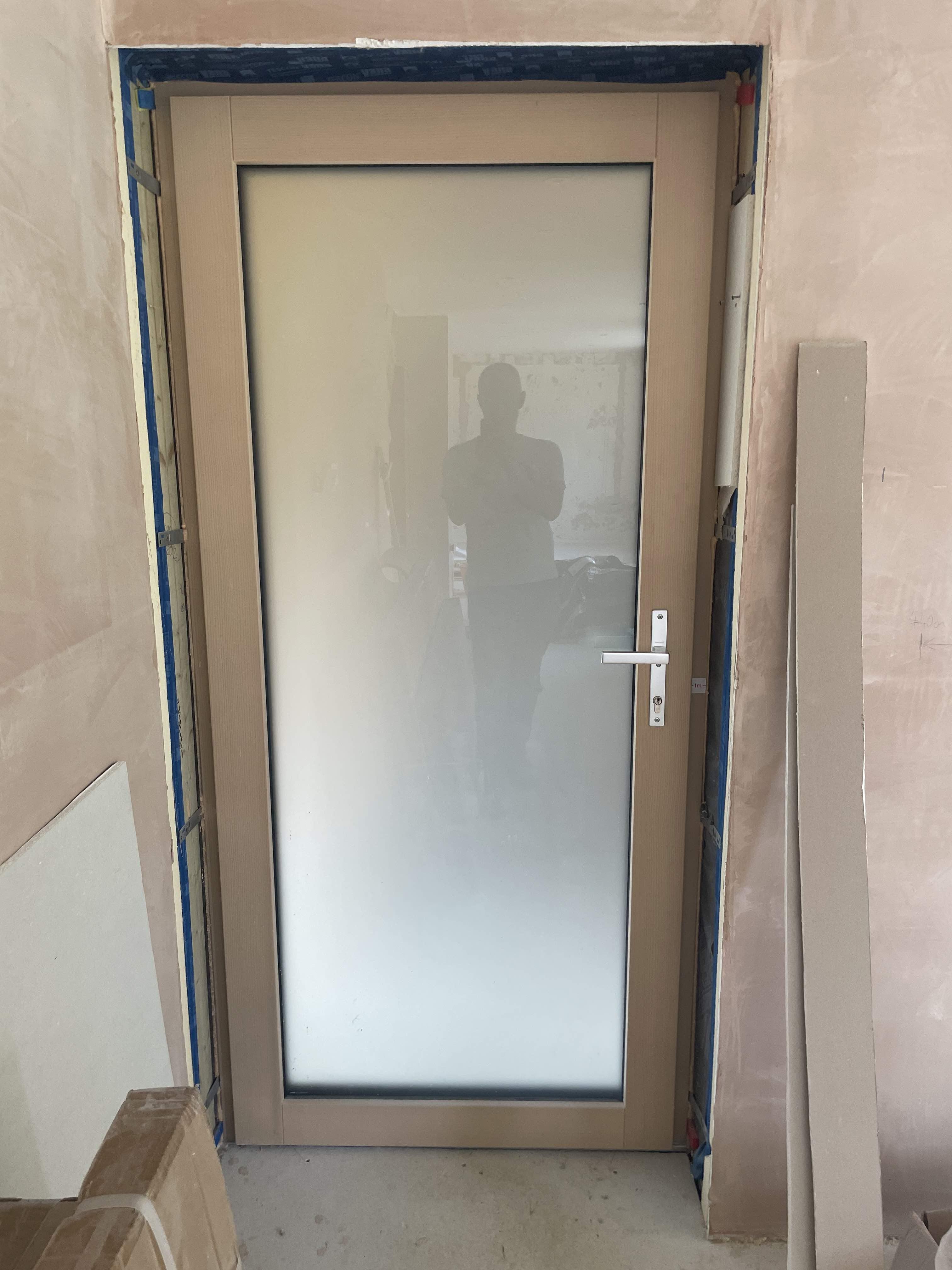

  6. Hi all, We are nearly three years along from starting what should have been a 4-6 month Enerphit standard renovation of our 1961 home in Bedfordshire. The builders we employed haven't really engaged well with the energy-efficiency measures, they don't really like learning new ways of doing things and their quality control seems to be set at "that'll do." I am left with lots of jobs to do myself. One of these is to replace a lovely new Internorm triple glazed door with an FD30 rated, very heavy (and expensive), Passivhaus doorset. I wondered is there a "for sale" or "swaps/exchange" section on this site, or can someone recommend a good place to find this? Really I'd like to find someone who would like my Internorm door, can help me remove it and then I can get on with installing the FD30 door in its place. (Attached photos of Internorm door - exterior finish is RAL 5020 - and the new doorset)
