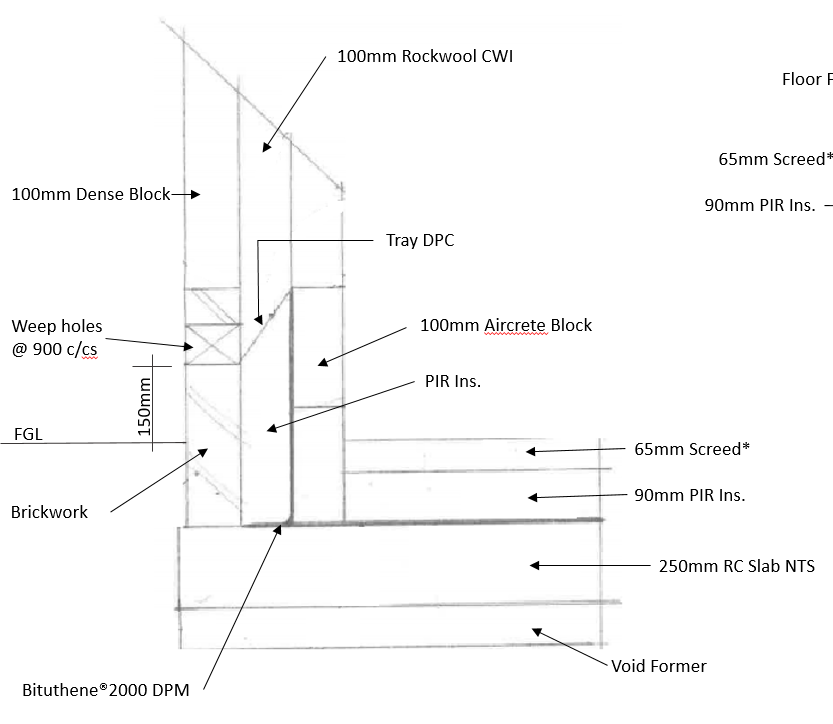

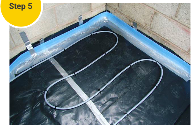

That's my concern! I can see the logic in leaving extra gaps to the sides of PIR and filling with an appropriate foam when fitting between timber joists. I suppose those joists may swell or shrink, or just move a little over time and what was a snug fit the day you fitted the PIR might be less so (or too much so) later on. In my case, I'm putting PIR onto a concrete slab, inside blockwork walls so I don't expect movement. I reckon I'll fit the PIR as snug as possible, then add a small bit of spray foam where there are gaps. Then wait a bit, then add some more, then repeat, then panic when the PIR starts rising up, then rip it out and swear a lot.
Afternoon all. Once I finish the DPM detail, I will be laying 100mm PIR boards down over my ground slab before UFH and screed go over the top. I will of course be taping the joins between the PIR boards, and am minded to fill any gaps around the edges or between boards with spray foam. I have seen a few useful debates about filling gaps in ceiling or roof PIR insulation, but not for ground floors. Regarding ceilings/roofs, there are those that argue in favour of cutting your PIR undersized relative to the gap between joists, leaving about 5-10mm gaps all around deliberately so that you can foam-fill the edges, thereby achieving a better tightness than you might if relying on cutting boards to size. Is this practise advisable where the floor is concerned? Does anyone have any recommendations on techniques, tools and materials for this purpose please? Thanks
