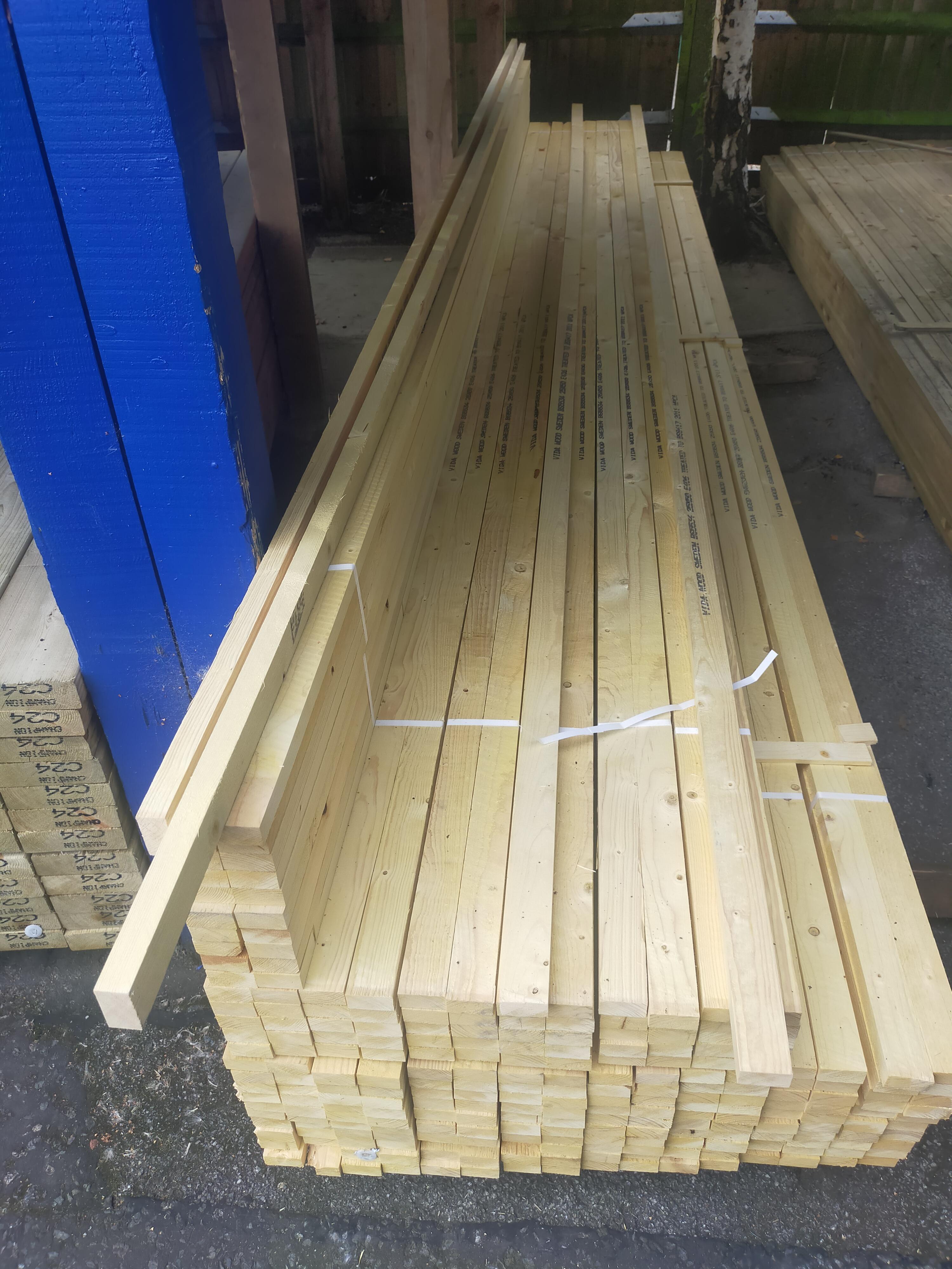

  11. I was thinking of something like this @Crofter from champion timber... 50x25mm pressure treated.
  12. Great stuff @Dave Jones, exactly the sort of thing I am hoping to do. I hadn't thought of putting the battens through a planer, good idea.

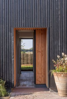

  13. Evening. I am considering fitting external timber cladding to look a bit like this.. I appreciate the benefit of something expensive like larch or cedar for the natural colour of the timber, but I want it black. In light of the colour choice, my thinking is that I can buy something cheap like 25mm x 50mm pressure treated batten, paint it black, and away I go. Am I missing something?! Thanks

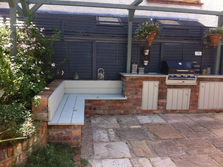

  17. I do, though its not quite a wall, more like this, with corners etc..

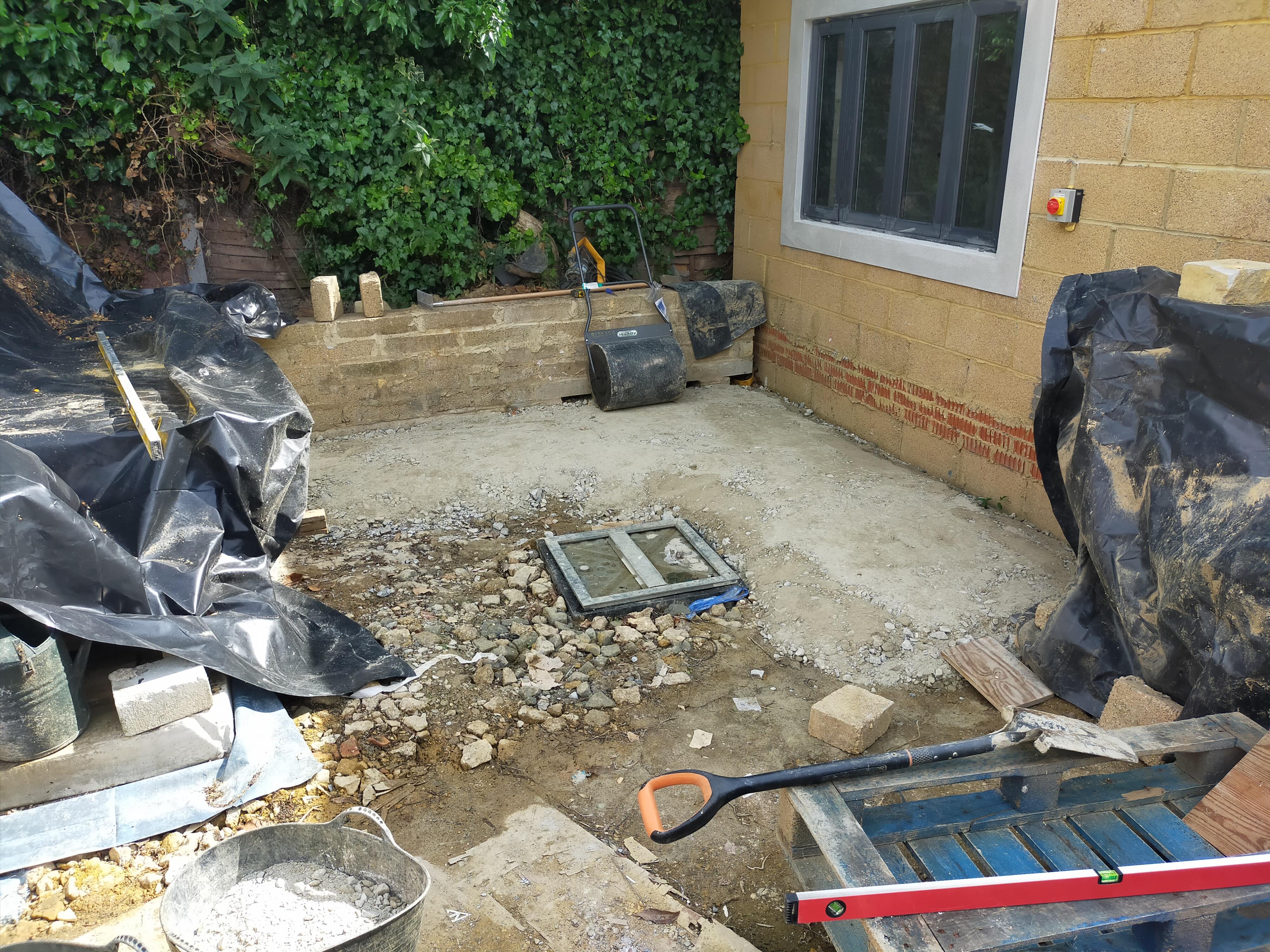

  18. Afternoon. In preparation for the construction of an L shaped seating corner I have compacted hardcore and type 1 to a combined depth of 100mm min, as shown in the attached photo. The soil underneath is exposed clay (i.e the topsoil has been stripped away) but the area benefits from a French drain. I was thinking of laying brick straight on to the compacted base, but I'm concerned the brickwork will crack over time. What's my best option here? 1. Lay brickwork on the compacted base. 2. Cast a small (70mm deep) slab for the brickwork to go on. 3. I've got some old 40mm solid concrete slabs. I could lay them on a thin bed of cement, then build the brickwork on top of the slabs. Any advice greatfully received!

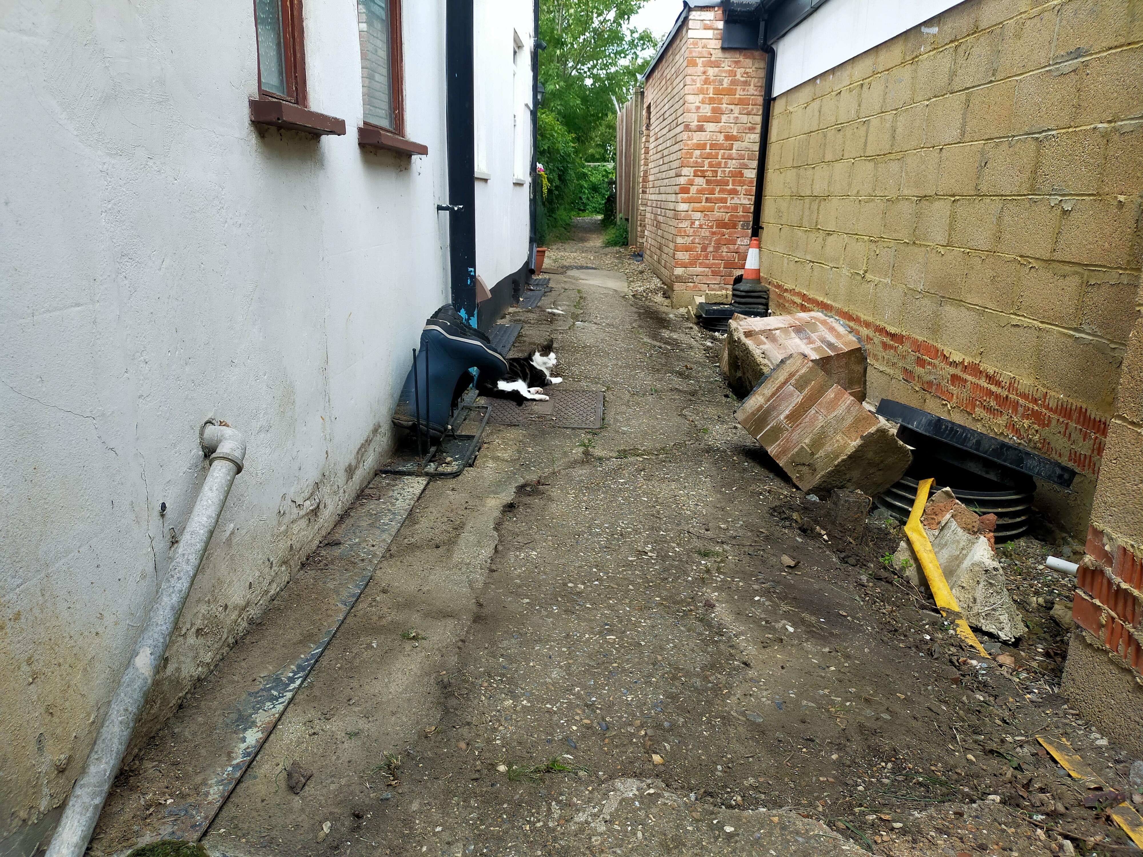

  19. Hi all. I want to renovate the existing concrete footpath shown in the attached photo by laying tiles or thin slabs on top of it. The existing path is made of concrete 60mm to 180mm deep without reinforcement. The path is generally sound, though it has no sub-base. The path currently slopes far too much for tiles to be laid on it, falling away by up to 80mm over 1.6m, and it stops short in several places where I want to lay tiles. My plan is to expand the existing path outward by adding 100mm compacted sub base and cement until the path is wide enough, then build up the level of the existing path until it is level with it's current highest point. I can then lay tiles or thin slabs on it. I imagine I will use new concrete laid on top of the existing path to do this. The new concrete will be 80mm deep at its deepest, feathered down to zero where it meets the highest point of the existing path. Thing is, how should I adhere the new concrete to the existing?

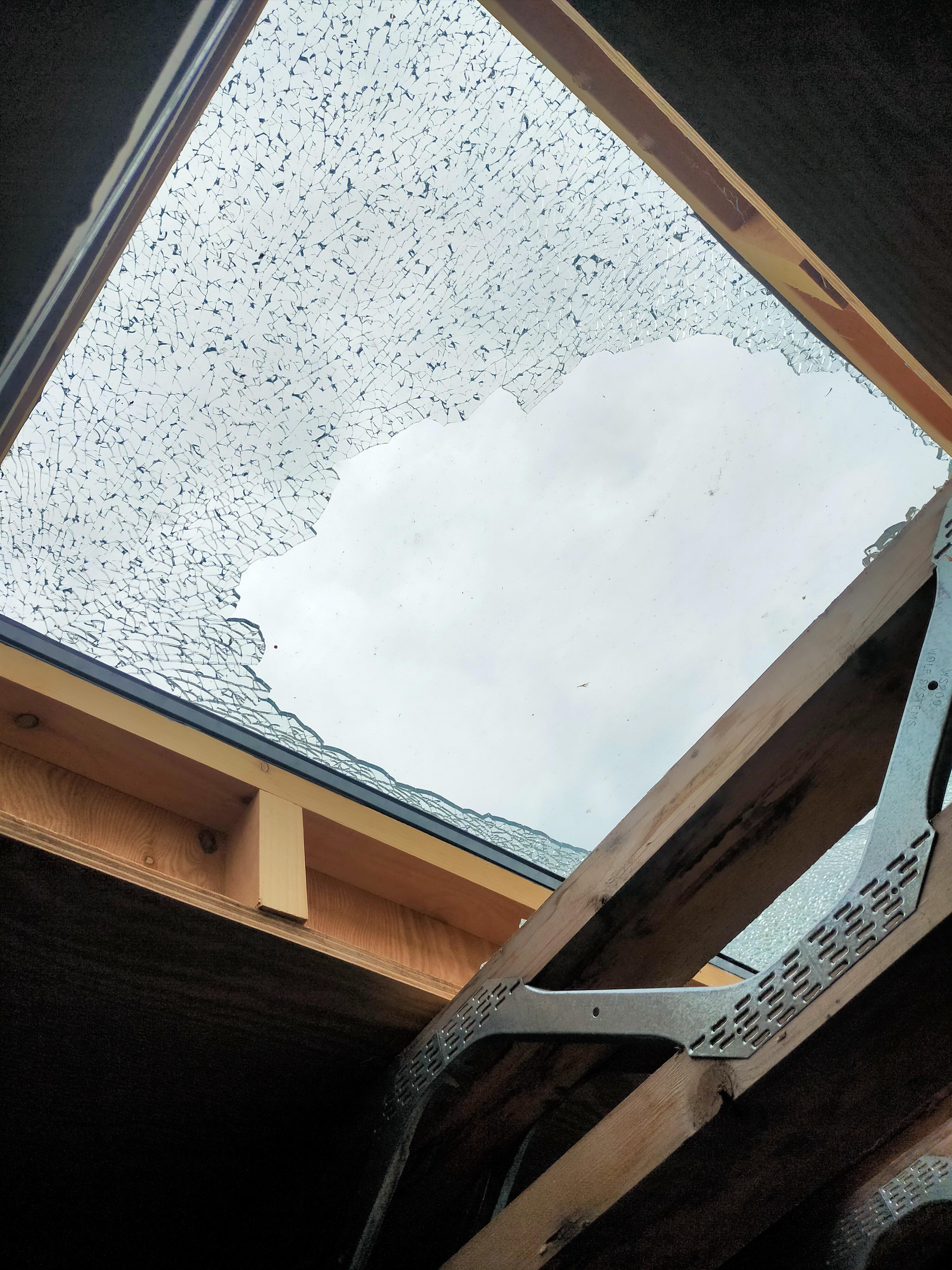

  20. Anyone experienced this before?! I bought double glazed skylights from a local supplier and installed them myself around Xmas time. They rest on a standard timber upstand, are not screwed in place but do have two continuous beads of mastic around the top of the upstand. This morning I discovered that the inner glazing panel of one of the skylights had shattered. The outer panel is fine, which rules out impact from outside, and nobody was in the building yesterday, ruling out impact from below. On Saturday I used a hole cutter to create a vent in a vertical surface about three metres away from the skylight in question. That might have sent a vibration through the roof structure and cracked the glass perhaps. Timber does of course expand and contract, but timber upstands are standard practice and mine are perfectly ordinary. Any ideas on how I can go about replacing the unit? If I have to force it up and off I'm concerned I will damage the upstand.
