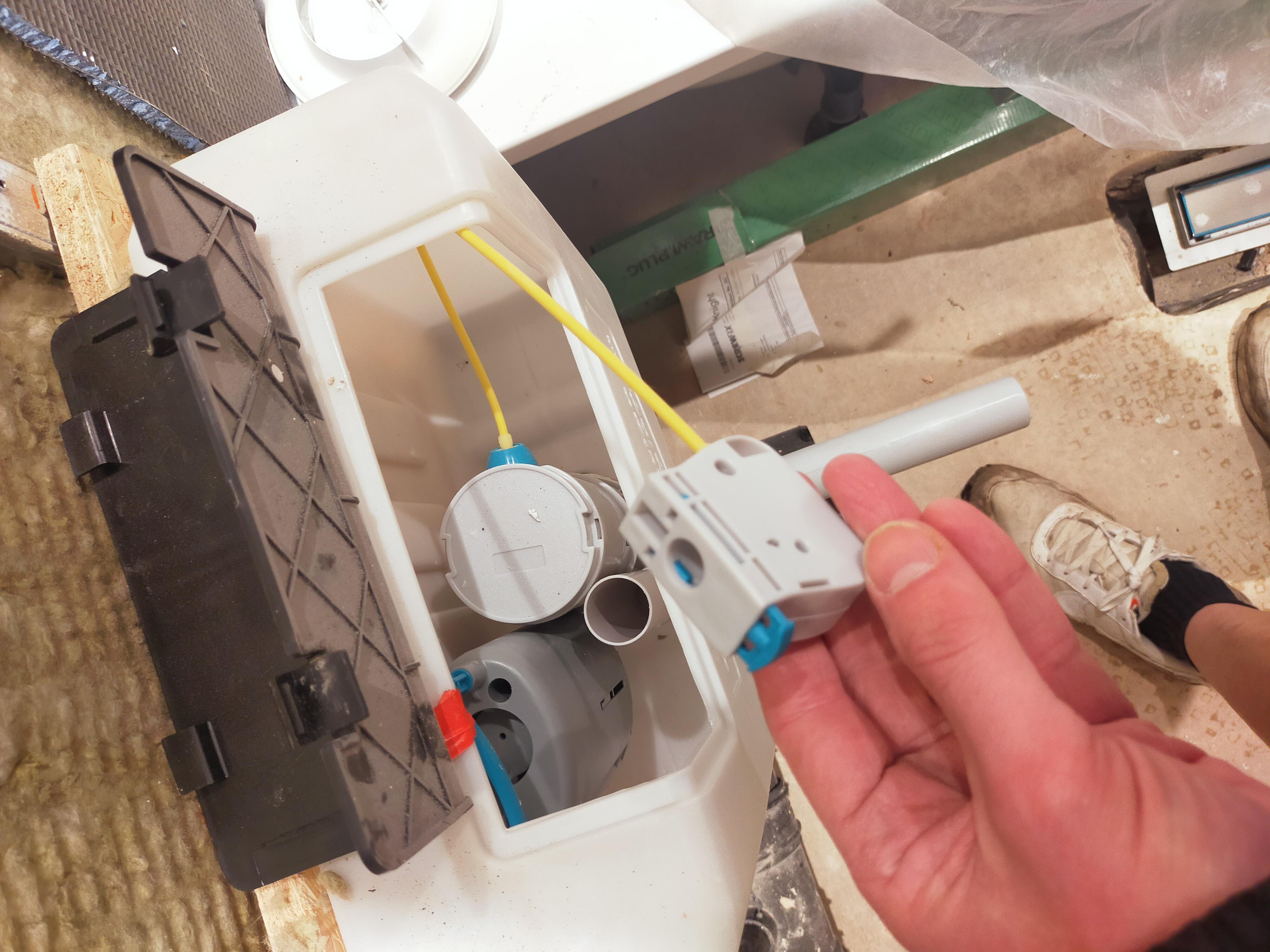

@markocosic In your set up, how does one access the cistern / mechanism etc in future to repair it?

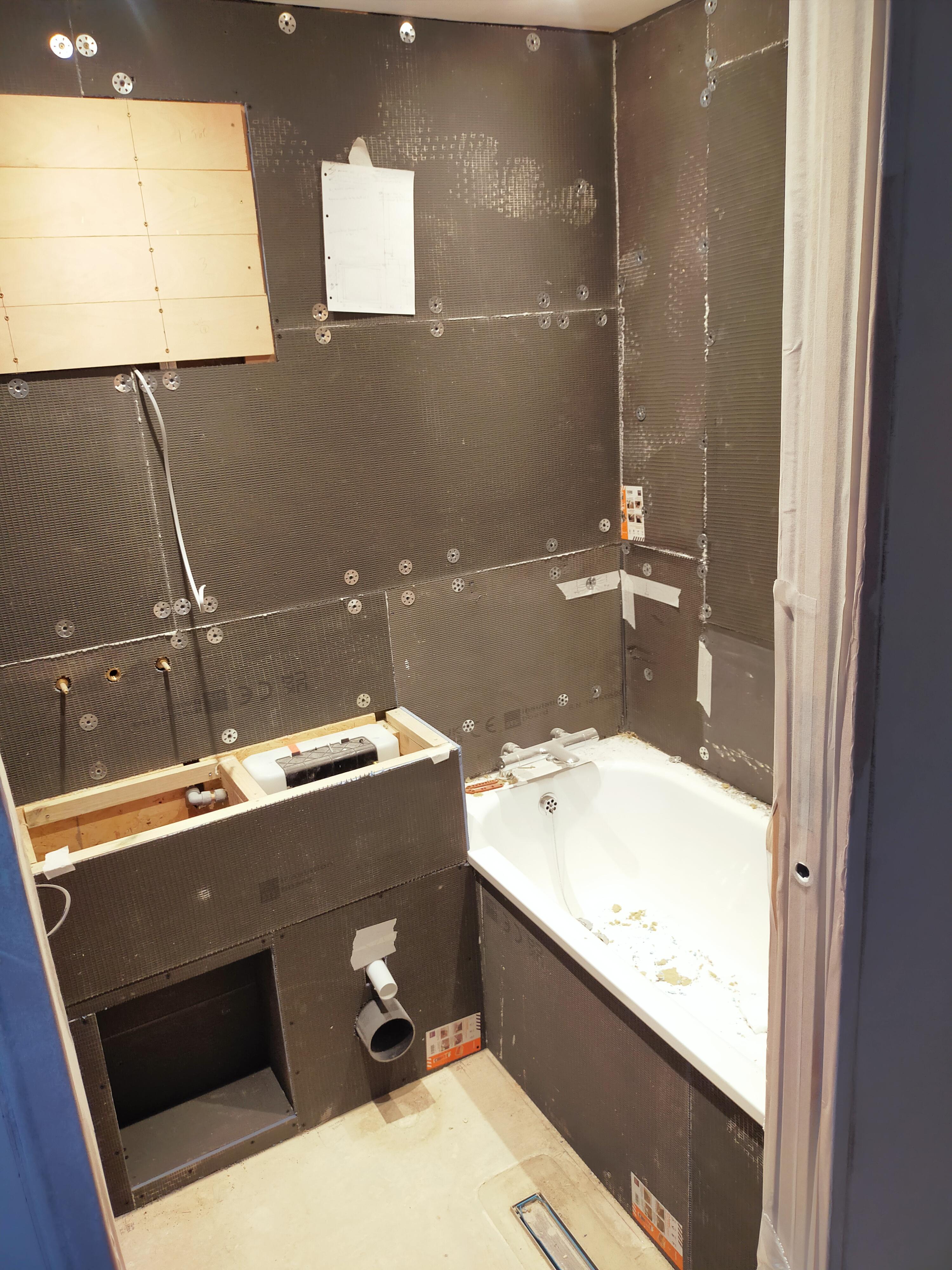

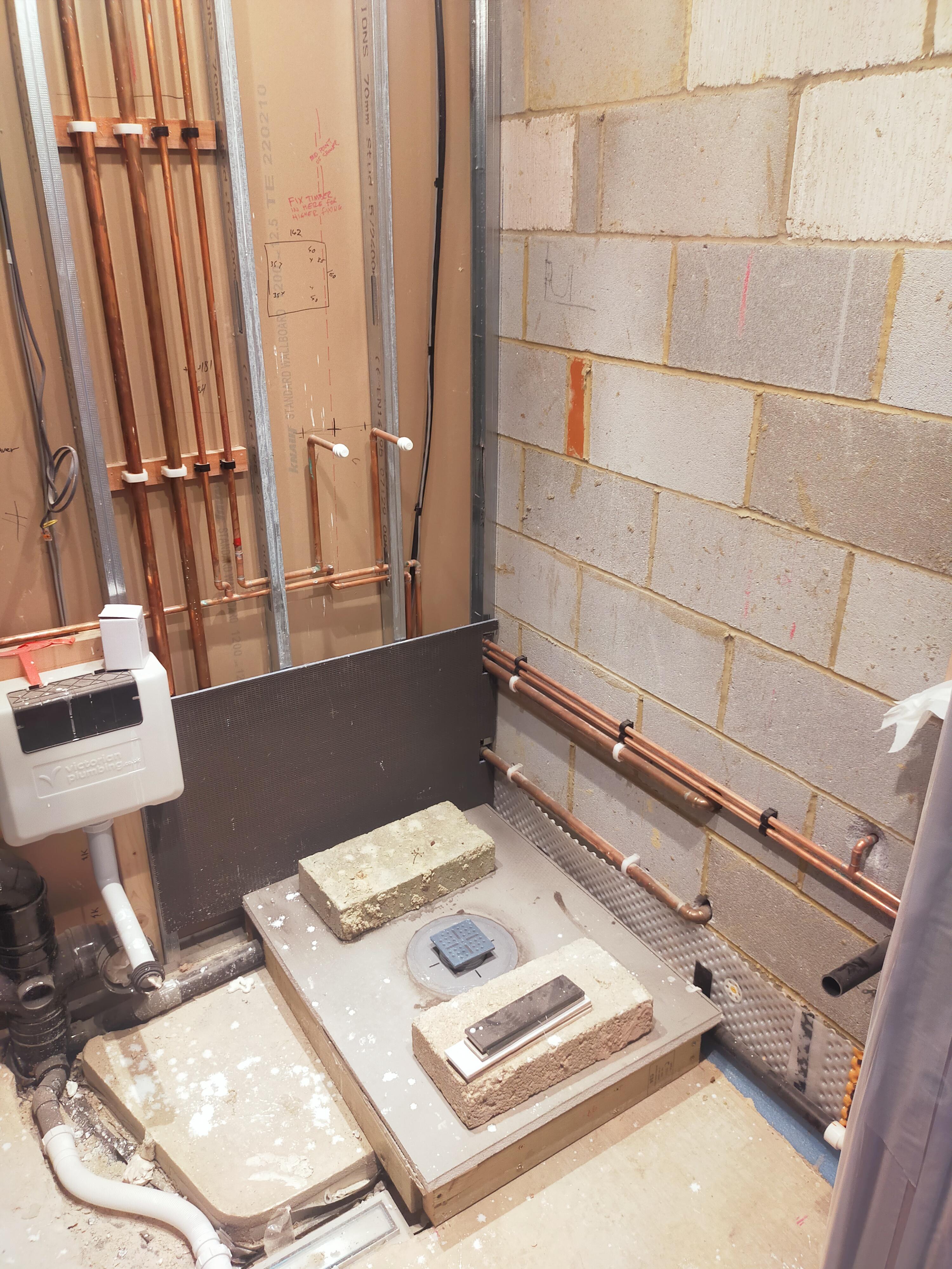

Hi all. I am thinking of using a wall-hung WC, requiring a 'wall frame with cistern' kit, or a 'concealed cistern and frame' kit, like so: The wall the w/c will hang from is an internal partition wall, made using metal studs and plasterboard (photo attached). Plainly, the cistern frame cannot be attached to the metal studs, but various manufacturers tell me that if I build a reasonable timber frame behind it, the cistern frame unit can be attached to the timber and will then take the weight of the wall-hung w/c. Plus me sitting on it. Which is a fair bit of weight. Has anyone any experience of fitting such a unit to a timber frame, and if so, is that actually sufficient for a wall hung w/c? Thanks

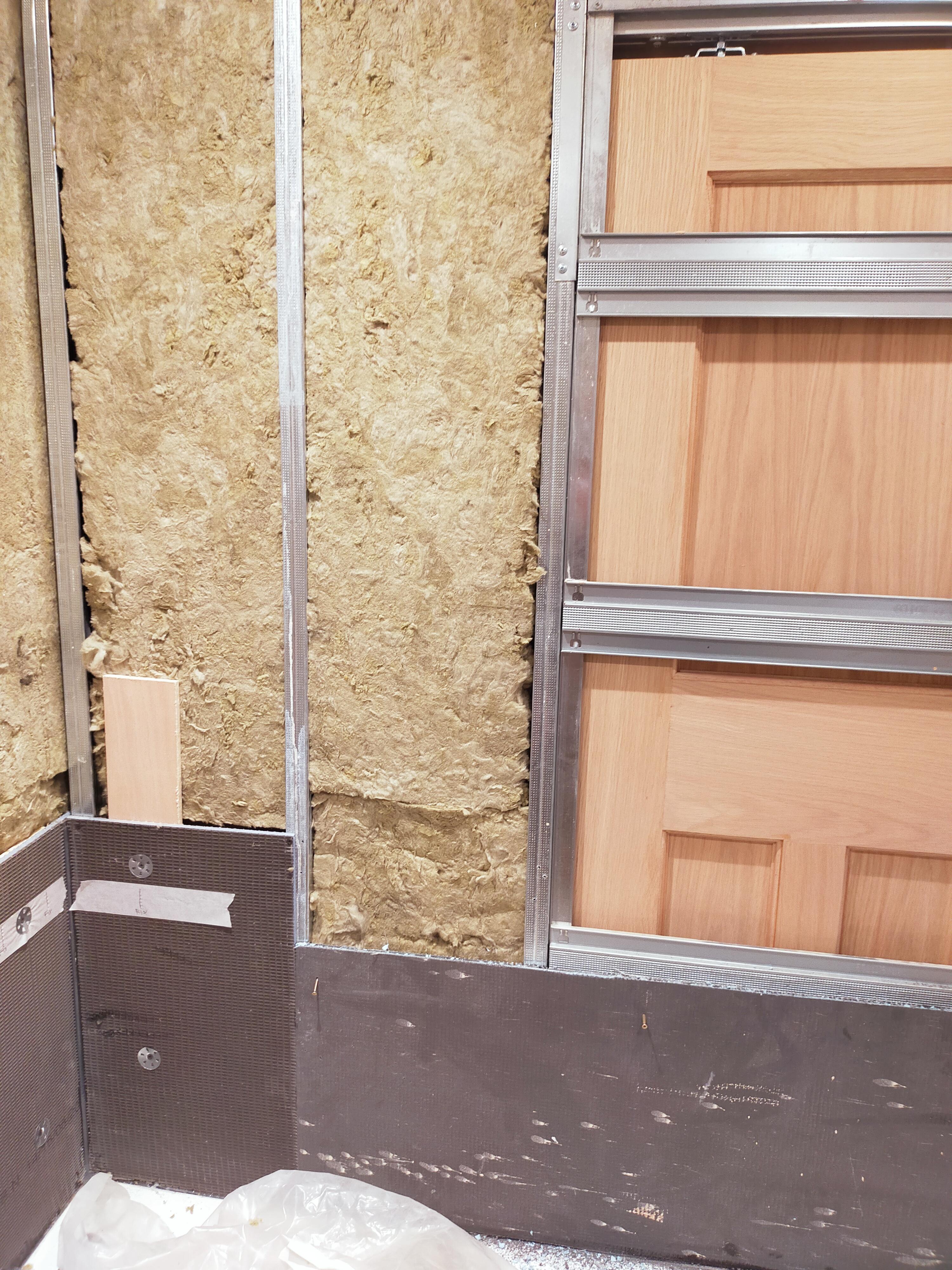

Thanks. I can't see any difference between the two sides of the MF studs that I've got. Wouldn't I just run into the same problem in the end either way though? The issue is not that the studs are sliding left and right inside the ceiling and floor channels. They are staying still but just bending away when the screw comes into contact with them. I have been using standard drywall plasterboard screws (the black ones). Do you use something like these: https://whiterosetools.com/products/timco-drywall-screws-self-drilling-tapping-screw-countersunk-bugle-head-zinc-phillips?utm_source=google.com&utm_medium=referral&utm_campaign=Google+SF+PMax&variant=42448585294018&sfdr_ptcid=20300_100_692063436&sfdr_hash=a02cc0be0789231c2d233329db42e7a2&gclid=CjwKCAjw04yjBhApEiwAJcvNoRNr3teWlDOHc0vbvwPAAqL7McS08e8MZC4cQxx_MsxAhOwnUviqYhoCDzgQAvD_BwE Cheers! -

Since creating this thread I have now built all the metal stud walls, plus one wall from timber, and half-boarded the lot ahead of first-fix services. My experience, which may help others considering whether to use metal or timber studs has been that the metal stud system is easy to install (even though I'm working alone) and a bit more forgiving than timber. It's quite quick therefore. One big problem has been trying to screw plasterboard to the metal 'C' studs. Far too often the tip of the screw passes through the plasterboard, meets the metal stud but then, rather than penetrating into the stud, pushes it away. This will often damage the plasterboard, and is extremely frustrating. Once the first screw is in properly the metal stud tends to stay still thereafter, but I have needed someone to go to the other side and push the side part of the stud up against the plasterboard to hold it still while I drill. That is possible when fixing the first side of plasterboards in place as you can still access the studs, but will not be possible when I close off the walls. Is there a solution to this?! Cheers -
