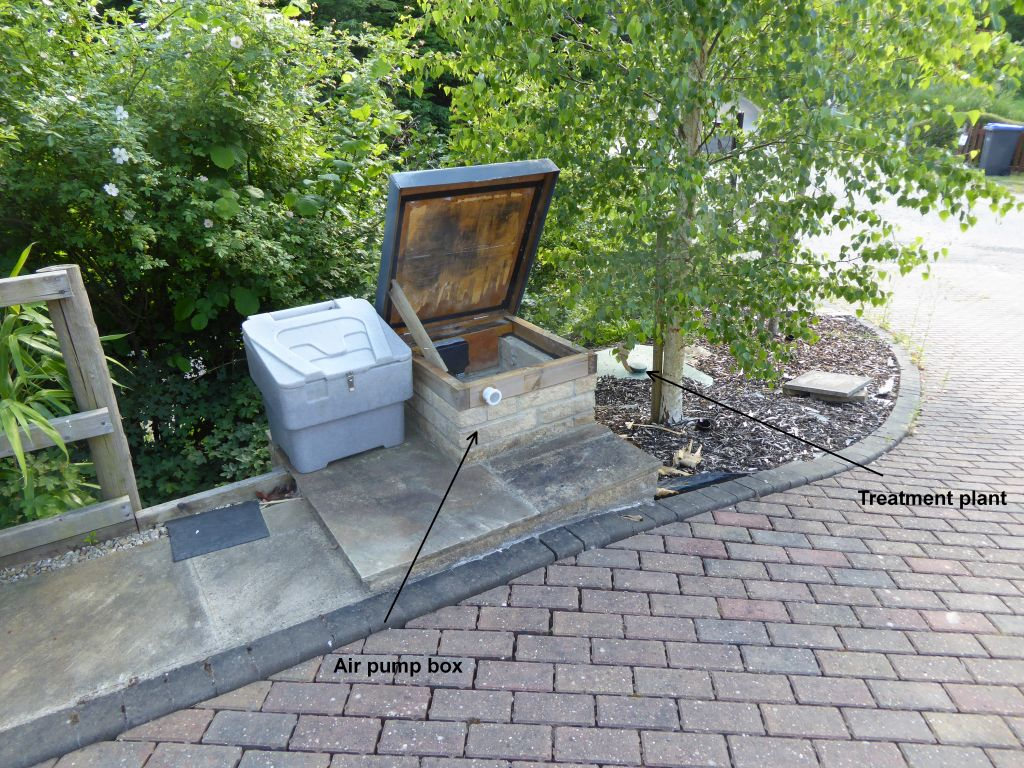

I built a remote box to house the air pump and alarm, because I wasn't wholly happy with having it sat in a box dangling over the main chamber of the unit (we have a BioPure). The main advantage of doing this was that, with the box being by the side of the drive I'm much more inclined to lift the lid and check the pump and alarm: -

I don't know if our experience with blower pumps is typical or not, but we are still using our ten year old Secoh JDK pump with no failures so far. I ignored the servicing instructions (out of laziness) and just bought a spare pump plus a couple of sets of spare diaphragms, so if the pump failed I could just quickly swap in the spare and replace the diaphragms in the old one in slow time. I ran out of bottle after 7 years of non-stop operation and changed the diaphragms as I was sure they must be about to fail. It didn't need this at all, as the old ones looked just fine. The pump's been running for about three years on the new diaphragms and shows no sign of giving up. The only thing I do annually is take the top cover off and give the air filter a clean, as it tends to collect a lot of dust and dead bugs. Other than that it's just quietly got on with doing its job. -

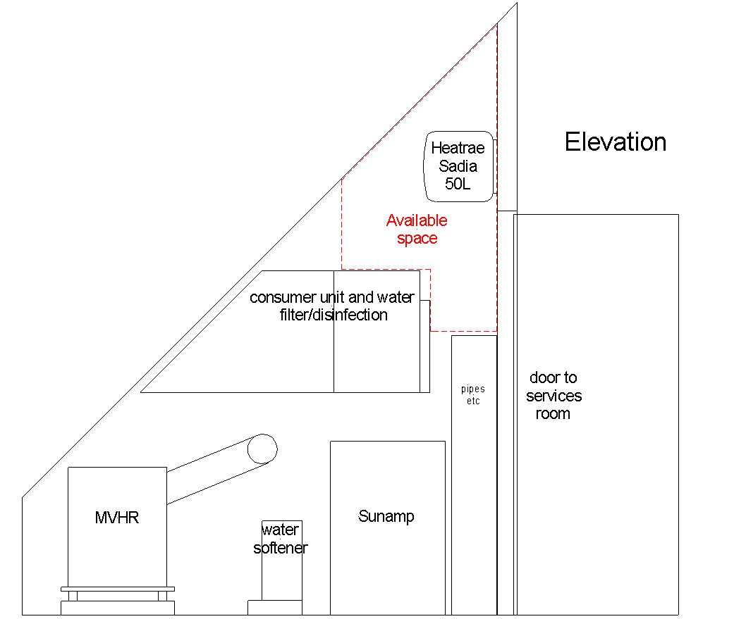

I've ordered one of the 50L Heatrae Sadia horizontal water heaters, should be here at the end of the week. Nice that it comes complete with all the bits needed to install it, PRedV, accumulator, tundish, built-in T/PRV etc, although the PRedV is redundant, as I already have a 3 bar one on the supply, plus our well pump cannot exceed about 4.5 bar anyway, given the depth of our well. If anyone wants a 22mm PRedV they are welcome to it, as I already have one spare sat here. Plan is to fix a doubled up bit of 19mm marine ply to the wall above the door, secured with loads of hefty screws into the studs behind the plasterboard. Should be fine to then bolt the bracket to this, as the max weight when full is only a tad over 70kg. Nice thing about this water heater is that it isn't smart, something of a rarity now. Last thing I want for a standby, emergency hot water system, is something that is too damned clever for its own good. Quite why anyone would ever feel the need to have a WiFi connected and controlled hot water heater is beyond me. I just want something simple that will provide some hot water if things go awry. Last thing I need is to be faffing around with an app in order to just have a shower.
Thinking about it, it'd be easy to buy a lower flow shower head, perhaps a bit like the ones used for electric showers, to use if we had to resort to the backup hot water system. The shower head we use all the time has a flow rate of around 10.5 litres per minute (I only know this because an annoying building inspector wanted me to measure it, then insisted a flow reducer be fitted - removed as soon as the house was signed off . . . ). I could probably find one with a much lower flow rate, rather than fit a flow reducer, simply because the flow reducer really reduced the force from the jets. If I fitted, say, a head with an 8 litre/minute flow rate then we'd get close to 10 minutes of shower time, which is pretty close to normal daily use anyway. This means that a 50 litre heater may well be all we need. These Heatrae Sadia units look well enough made, stainless steel tank and immersion element, just a simple thermostat for control and all the connections at one end.

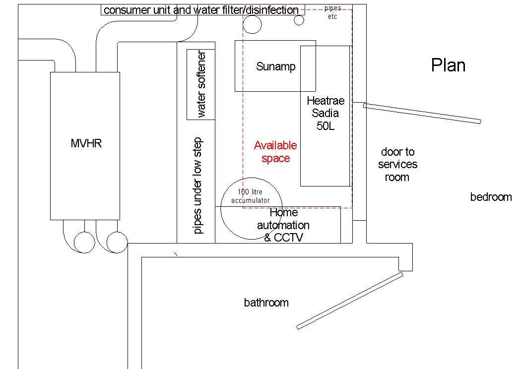

I can't make up my mind what to get to provide us with an emergency back up hot water supply. Space is really tight in the only area I could fit something. Below are rough scale sketches of the elevation and plan view of this area, with the only spare space marked in red. The best bet seems to be to find a horizontal water heater that I can wall mount, above the door. There is "just" room to get up to a 500mm diameter unit up there, no longer than 1200mm, and it must have all the connections at the end nearest the end wall (top in the plan view). The pipe work for the Sunamp is directly below that end, so plumbing will be straightforward, plus I can run a drain from the tundish out through the wall to near-ground level, as there is just gravel in that area outside. There's room for the expansion vessel in the corner where the pipes would come down, too. The unit that seems to best fit the bill is one of the Heatrae Sadlia Hotflo multipoints. The 50 litre would be a lot easier to fit, as it is slimmer and lighter than the 80 litre (sticks out 371mm from the wall versus 454mm) Both would be OK within the 1200mm max length restriction. The fitting bracket these use looks ideal, too, as you just bolt it to the wall and then lift the unit up and hook it into place. The question is whether 50 litres of hot water is OK as an emergency supply. My feeling is that it would do at a pinch, as the sums show that it could deliver at least 70 litres of shower temperature water, so enough for about 7 minutes of shower time. The full re-heat time is a bit over 40 minutes, so just spacing our two morning showers out a bit more would allow a couple of reasonable showers. The temptation is to get a larger unit, just in case, but I have to keep telling myself that this is just a standby system, to give us a backup source of hot water for emergencies, not our primary source of hot water. I've sketched in the smaller of the two Heatrae Sadia heaters below, and it looks like it would be a reasonable fit. I've not been able to find anything comparable, in terms of diameter, everything else just looks a bit too large.
