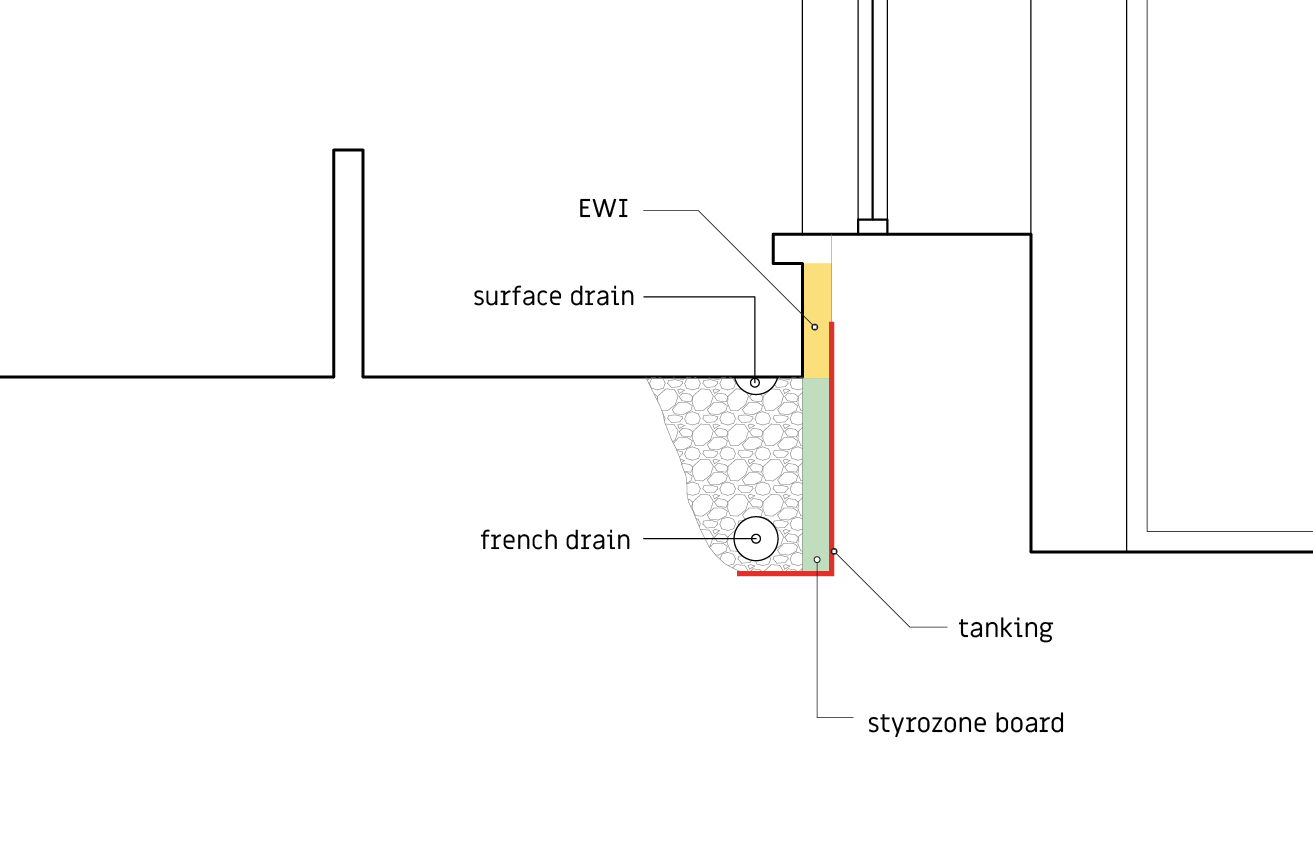

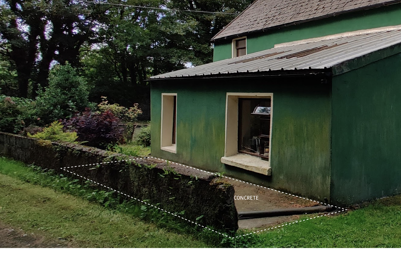

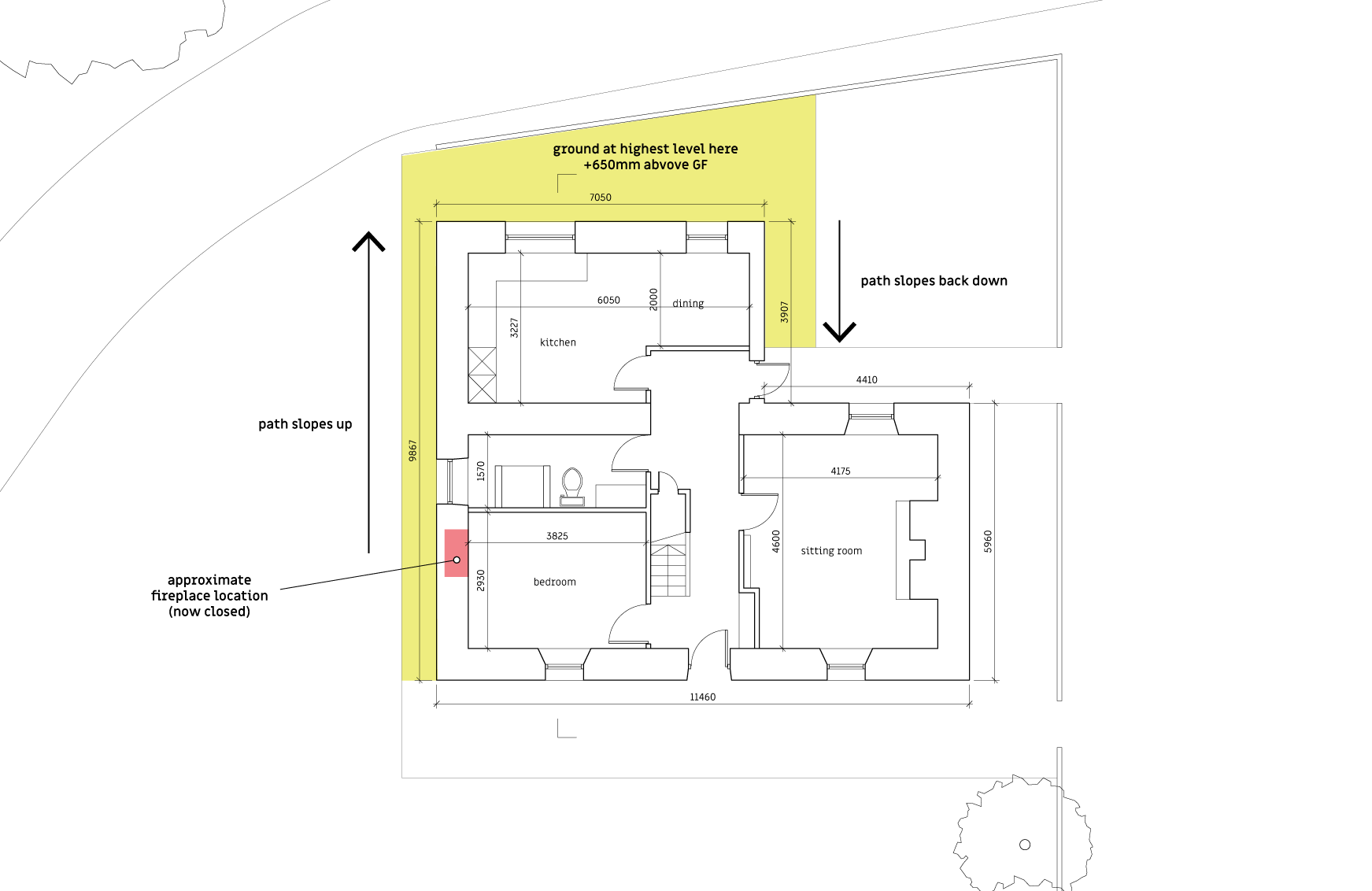

  16. I've posted a good bit lately about a refurb I'm hoping to embark on later this year / early next year. Part of the works will involve the installation of a french drain along some external walls to help with surface water drainage and to prevent the walls from soaking it up. One area where a french drain is being installed is along the southern elevation where the ground level is well above the internal floor level (approx 600mm). See attached pic. The area was concreted about 15 years ago to help prevent dampness internally and it has worked surprisingly well. The walls are quite dry internally. I'm tempted to leave all well alone but I'm sure it can be improved. I'm proposing to externally insulate the house so was wondering when it comes to this area I assume that I should tank the walls below ground first, then apply an insulation with high compressive strength before finishing off with the french drain etc? Something like the diagram below? Should I reinstate the concrete path outside the window and include a surface drain, or would I be as well to gravel it all - although if I do gravel it, I assume I'd be allowing more water to reach the drain?
  17. There was definitely a problem in the kitchen at one point due to the higher ground. The solution was a new concrete path outside at the highest point, probably about 15-20 years ago. This appears to have worked a treat as the walls are genuinely dry on that facade. Maybe I should leave all well alone and just concentrate on the eastern wall instead?

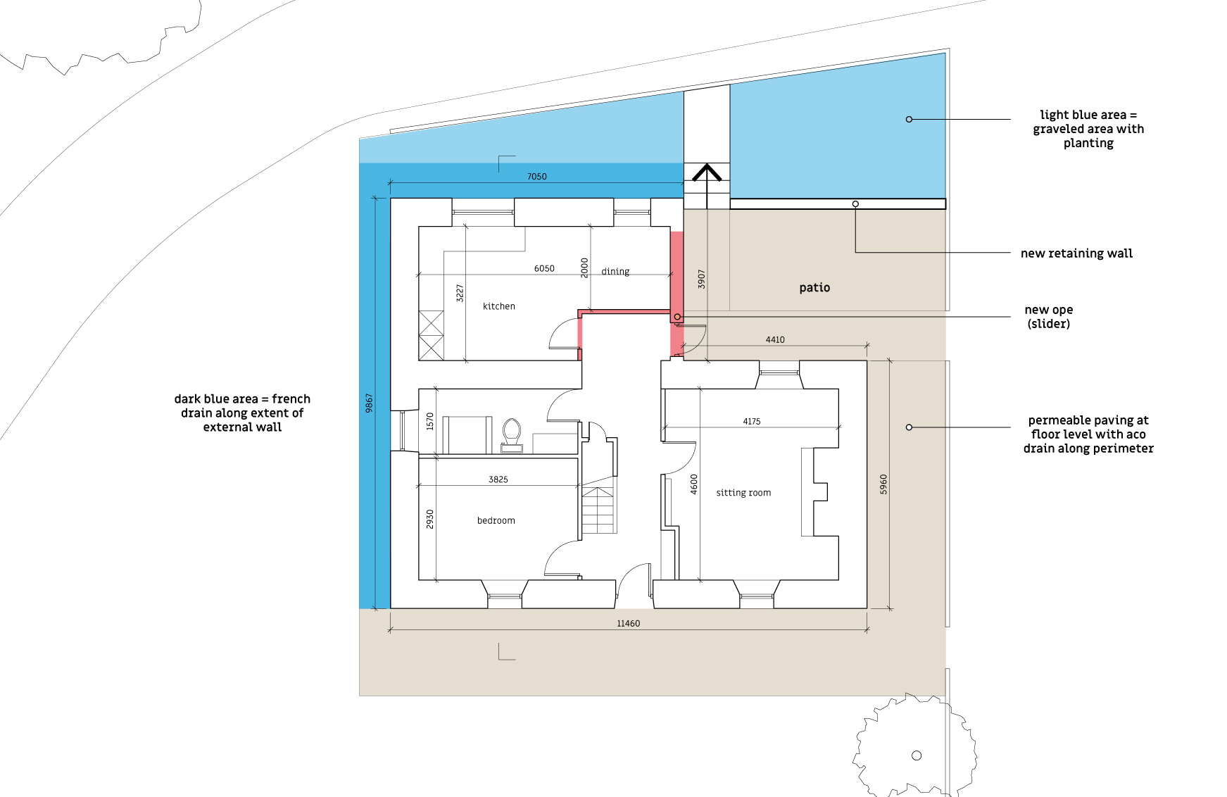

  18. My plan is to install a french drain along the eastern and southern perimeter of the house. I'm going to dig out a patio in the south-west corner (top right) and install a new slider so that the kitchen/dining can avail of the evening sun. I will pave the patio and remaining perimeter with a permeable paving including an aco drain along the perimeter of the house. I'm thinking the remaining area at high level to the south could all be gravel with planting - like a widened french drain. I'll add a few steps for access from the patio to a small gate (not shown)

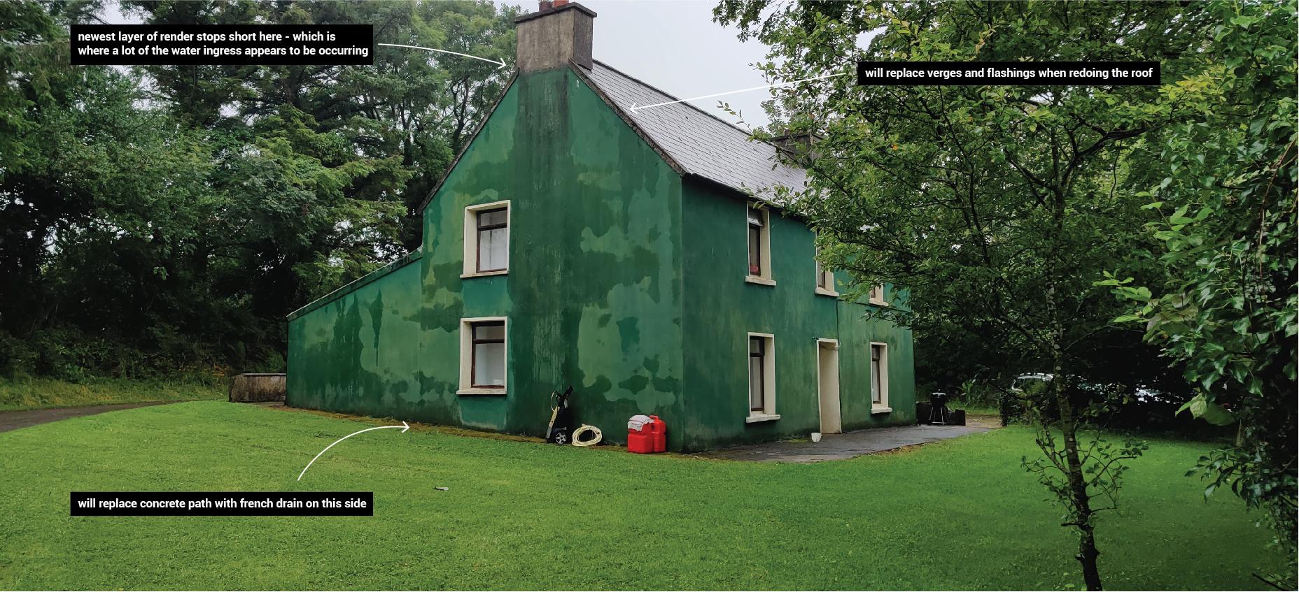

  19. The diagram below illustrates the current context around the house. There is an existing concrete path of varying condition around the perimeter of the house. The ground level rises to the south to a maximum height of approximately 650mm above FFL at the kitchen. So the area hatched yellow would generally be above FFL. The gable pictured in the previous photos is on the left (eastern side of the house). I've shown the approximate location of the fireplace on that gable for reference. Need to open up that wall to see what's what.

  21. The walls are in surprisingly good shape at floor level. I had to replace a washing machine in the kitchen recently and when I pulled out the old one, the wall behind was perfectly dry - and this is in an area where the ground level is at its highest above the floor level. The main location for dampness at ground floor is in a bedroom on that eastern gable shown in the first image. There used to be a fireplace in that room by all accounts but there's no trace of it now - so I would wonder how it was closed up. it was definitely never meant to be exposed! definitely - i will mark up a plan shortly to show how I intend to manage the perimeter. Yep - I'm thinking it makes sense to reroof now when there will be scaffolding in place anyway for the works to the walls. Will completely replace the rainwater goods as well. I don't think over-cladding with a rain-screen is the solution here given how well the majority of the wall is holding up. I was tempted to patch it up as you also suggest but the idea of insulating externally is starting to make more sense to me particularly as it consolidates the external envelope, improves the u-value, and in doing so moves the dew point closer to the outside.
  22. ya that's what i'm thinking now - because I've decided to leave the external render on because of its condition it kinda makes sense to just insulate it now too. i think the house would benefit then from exposing the walls internally to let them dry out to the inside. could leave windows open for a few months to encourage airflow through. I think only then will I know what kind of heating system I'll go for etc

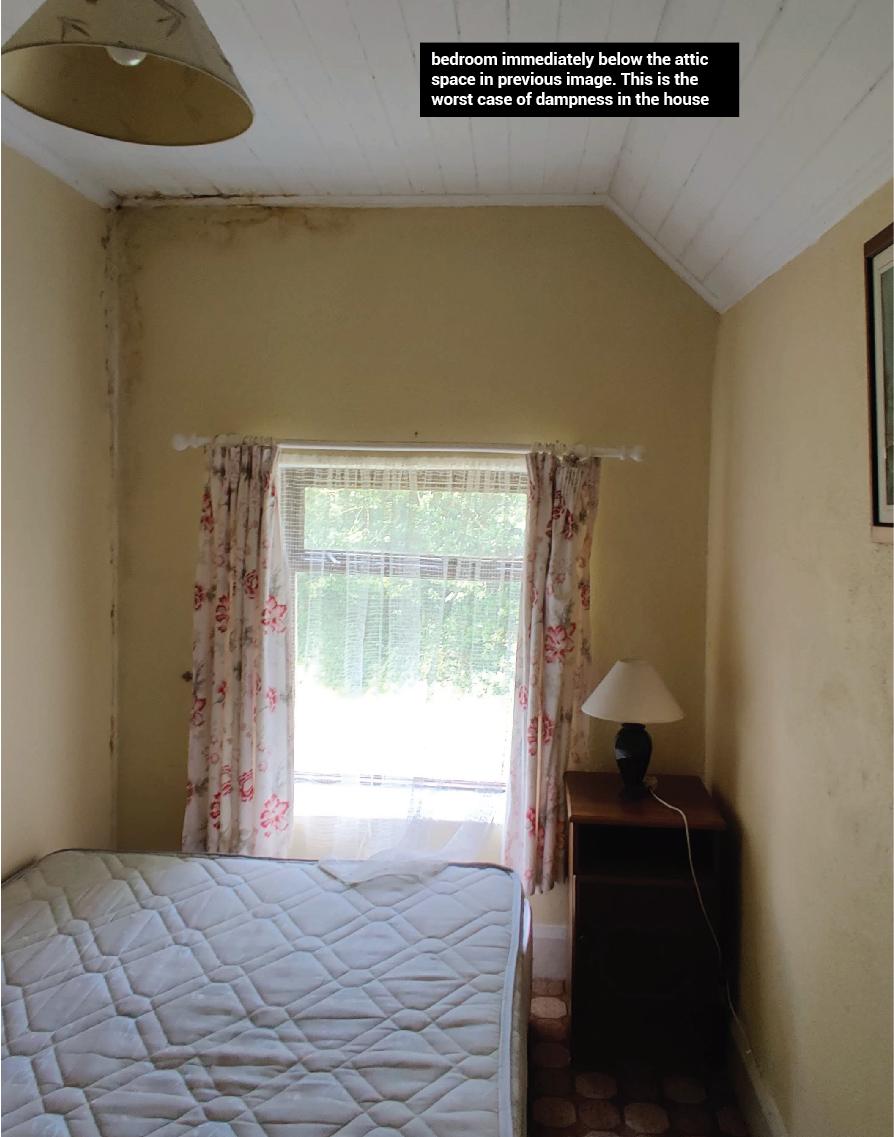

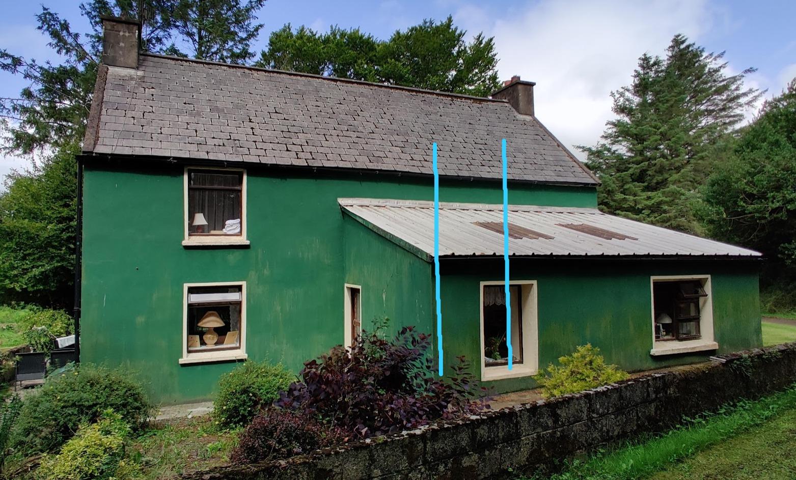

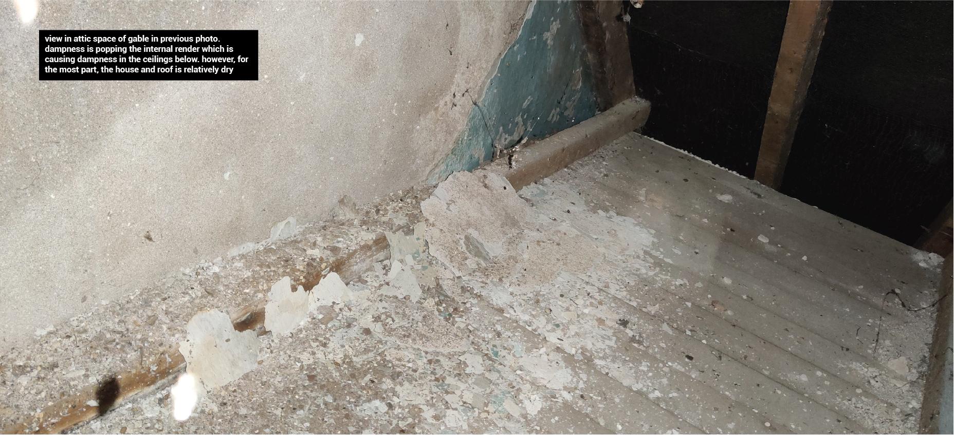

  24. I've attached a few pics below. for the most part the house is pretty dry considering it's rarely used and has no heating. the worst case of dampness is on the eastern gable. this is primarily due to the ground being above floor level in this location, and also a defect in the existing render at chimney level which is allowing some water/dampness. the verges are also of course gravel which are also contributing. There would be good drainage in the area so ground water isn't a problem. the house is well screened by trees but persistent rain would likely be the main cause of moisture build up. the fact that the house is unoccupied doesn't help.
  25. thanks - noted! That would suggest to me that the idea of externally insulating the wall might be the approach - but on the basis that I can hack of the internal render, even at ground floor level, to help dry out the wall to the inside.
