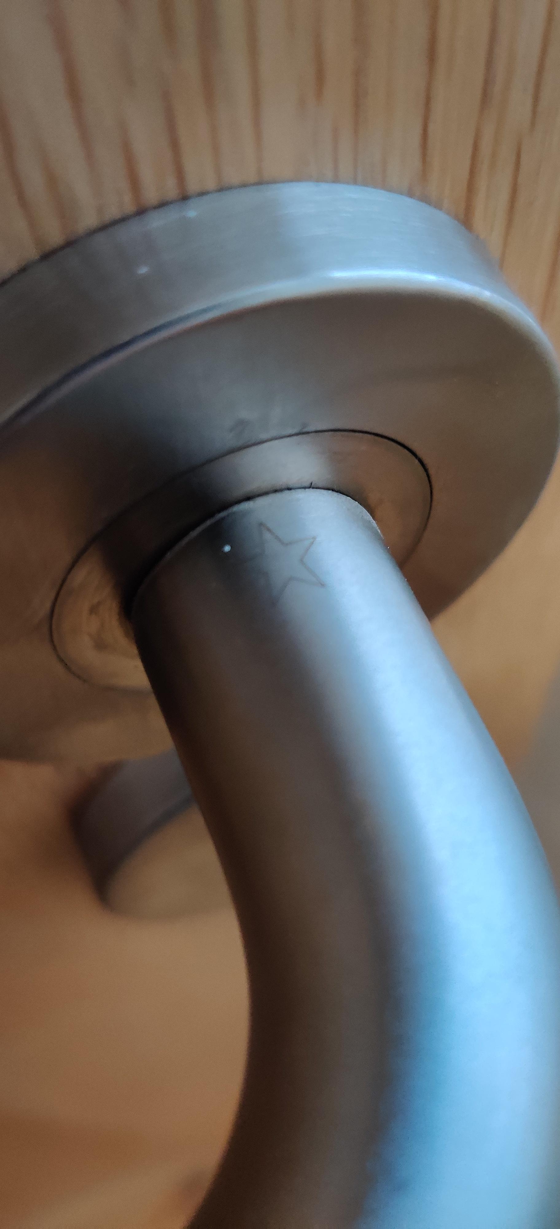

Anyone identify this door handle manufacturer?
Bemak replied to Bemak's topic in Doors & Door Frames
thanks again. will drop them an email with the pic you sent -
their website wont work for me - is it a brand name cos I'd need to find it in Ireland. Thanks again for your help on it. -
ah you legend - sorry for the late reply, wasn't getting notifications that there were replies to this thread. That's exactly the handle! Did you know it or did you do a better google search than me?! -

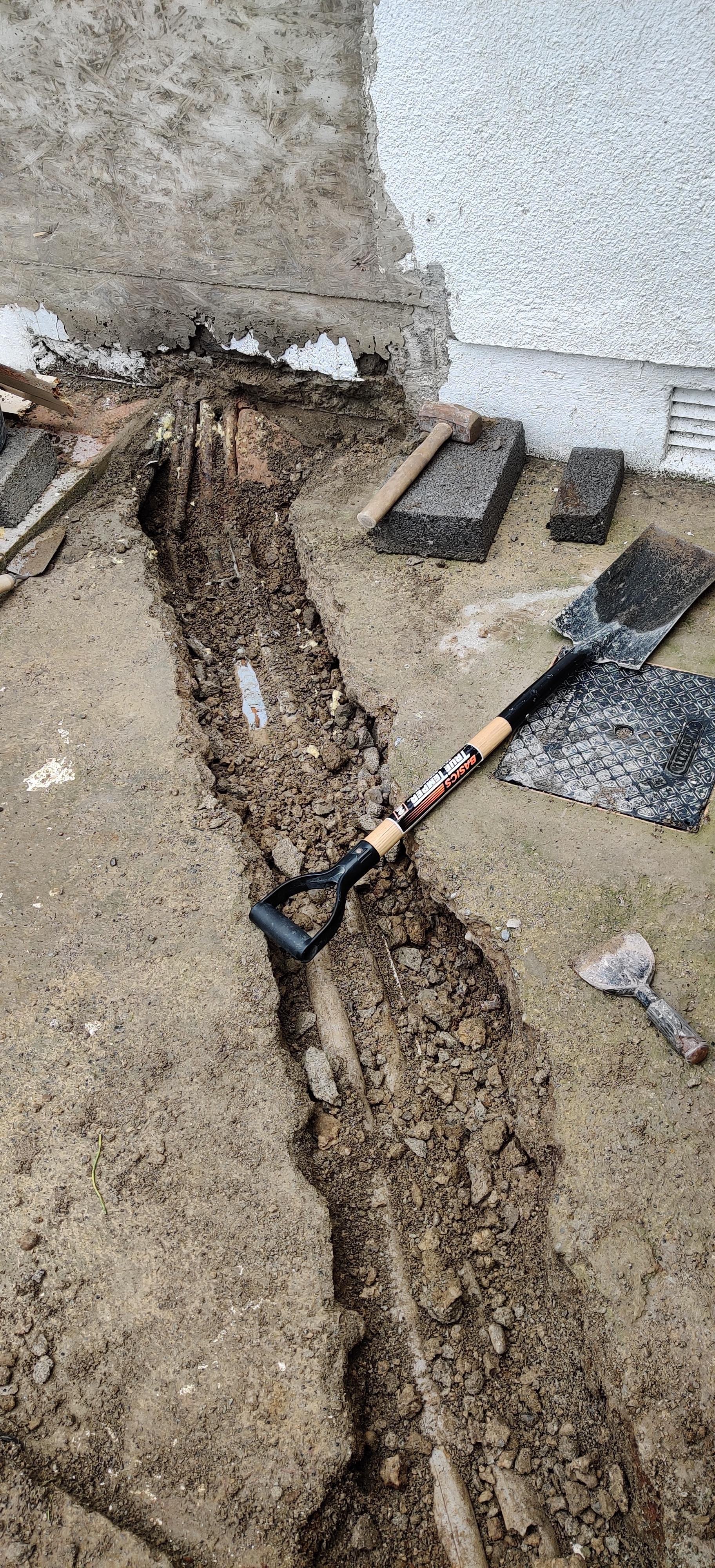

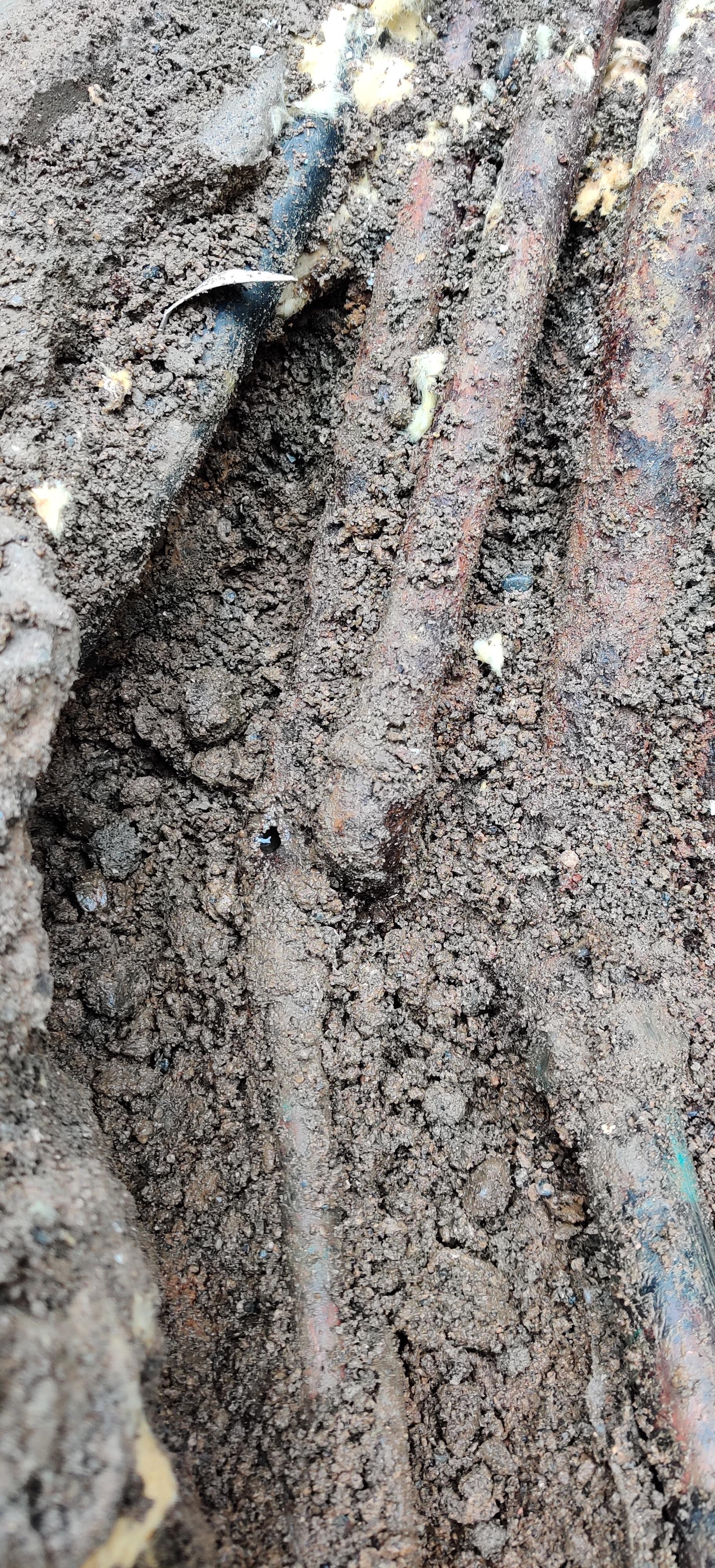

Did a bit of digging today. Found the leak quite quickly, the concrete was soft as I was breaking it so I was quite confident that the leak was in the ground. Such a relief to have found it.
Small update on this. Seems we have a leak in the system somewhere. Ground floors were up in the kitchen and it was bone dry underneath so we're satisfied that the leak isn't in the house. The volume of water being lost when we open the valve to serving the coil in the HWT would seem considerable to be able to drop the pressure so quickly hence why we think it would be very noticeable if the problem was internal. We've narrowed it down to two potential locations - one theory is the coil in the HWT could be burst and leaking into the system - however we're not getting anything out of overflow pipe and you would imagine that the tank would get slightly warm (which it's not) so our money is on the old pipes linking the external boiler to the house. They are old gun barrel pipes and the plumber reckons that there must be a leak there when the previous plumber was connecting up to them. So we have a but of digging ahead of us unfortunately. Fingers crossed it's one of these locations because we're out of ideas if it's not.
Have a lovely door handle that I want to match on other doors but have no idea where it came from. There's no branding on it apart from a start on top of the lever. Any ideas what brand it is? Thanks!
