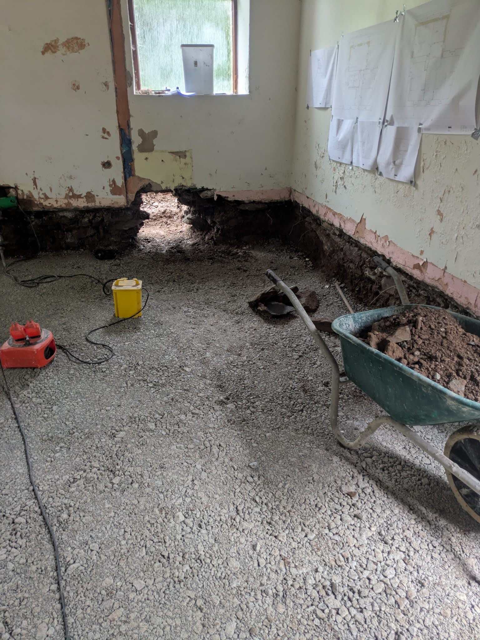

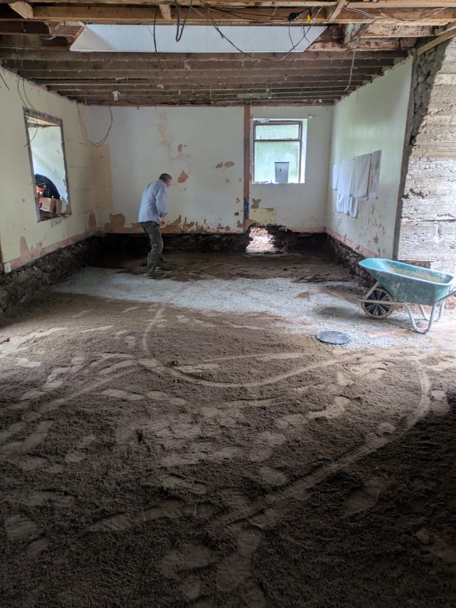

  6. sorry - i never got a notification on this post. In the end we dug down about 500mm and put in 100mm compacted hardcore, blinding, radon barrier, and then a 150mm subfloor. Once the extension is built, the next stage is 150mm insulation, 70mm screed with UFH and then the floor finishes. I’ll post some pics now of the progress

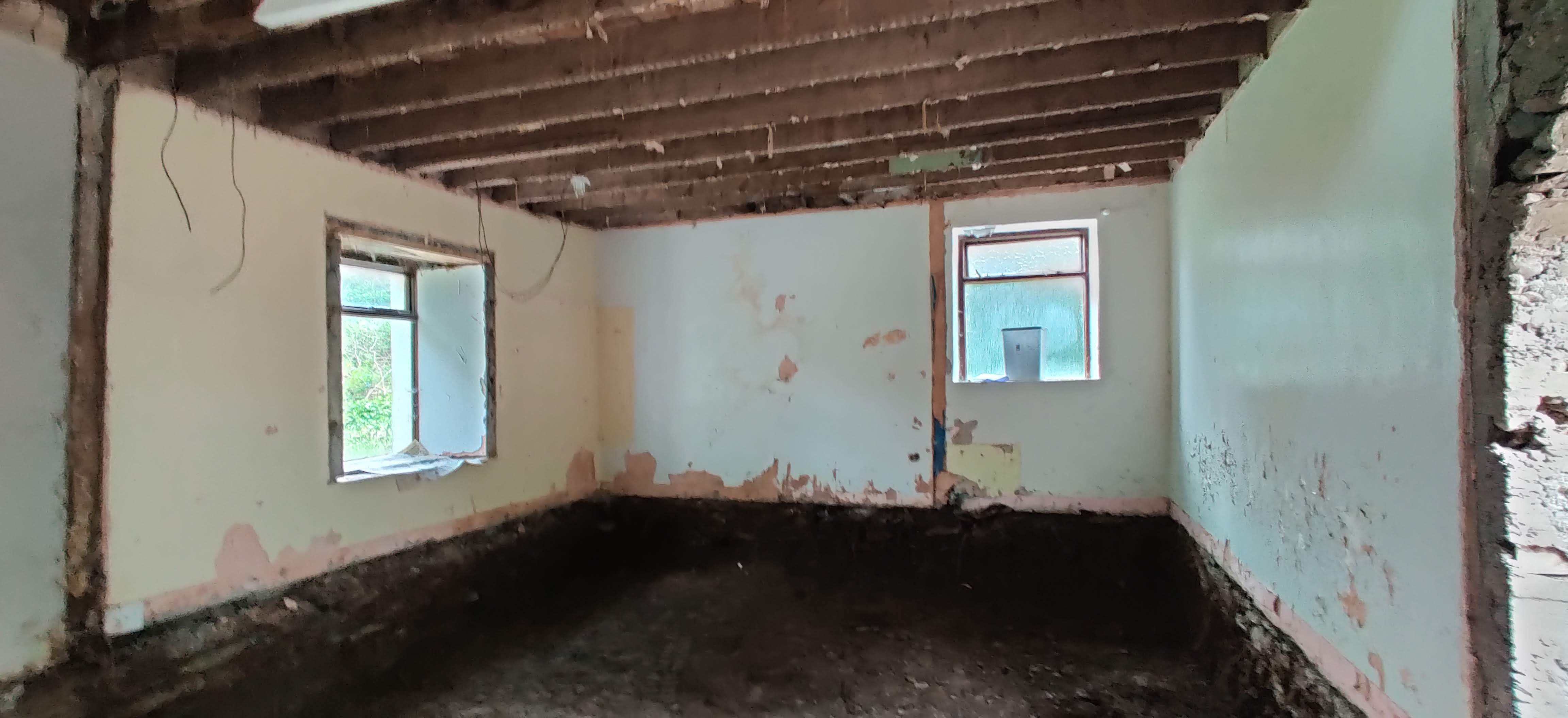

  15. yes we're putting in a new insulated GF slab which should make a big difference. the external walls are sand and cement render unfortunately. we looked into the possibility to taking it all off and replacing it with lime but it's a non-runner because of a) the prohibitive cost and b) as we're in an exposed area in the west of Ireland, lime render doesn't particularly suit the driving rain that we can experience for weeks on end. so the only direction for the walls to breathe will be inwards. we've stripped off the internal render however and thankfully the walls are quite dry as is. I'll install a french drain around the perimeter of the the house as well which should help with moving ground water away from the base of the walls. it's all we can do really

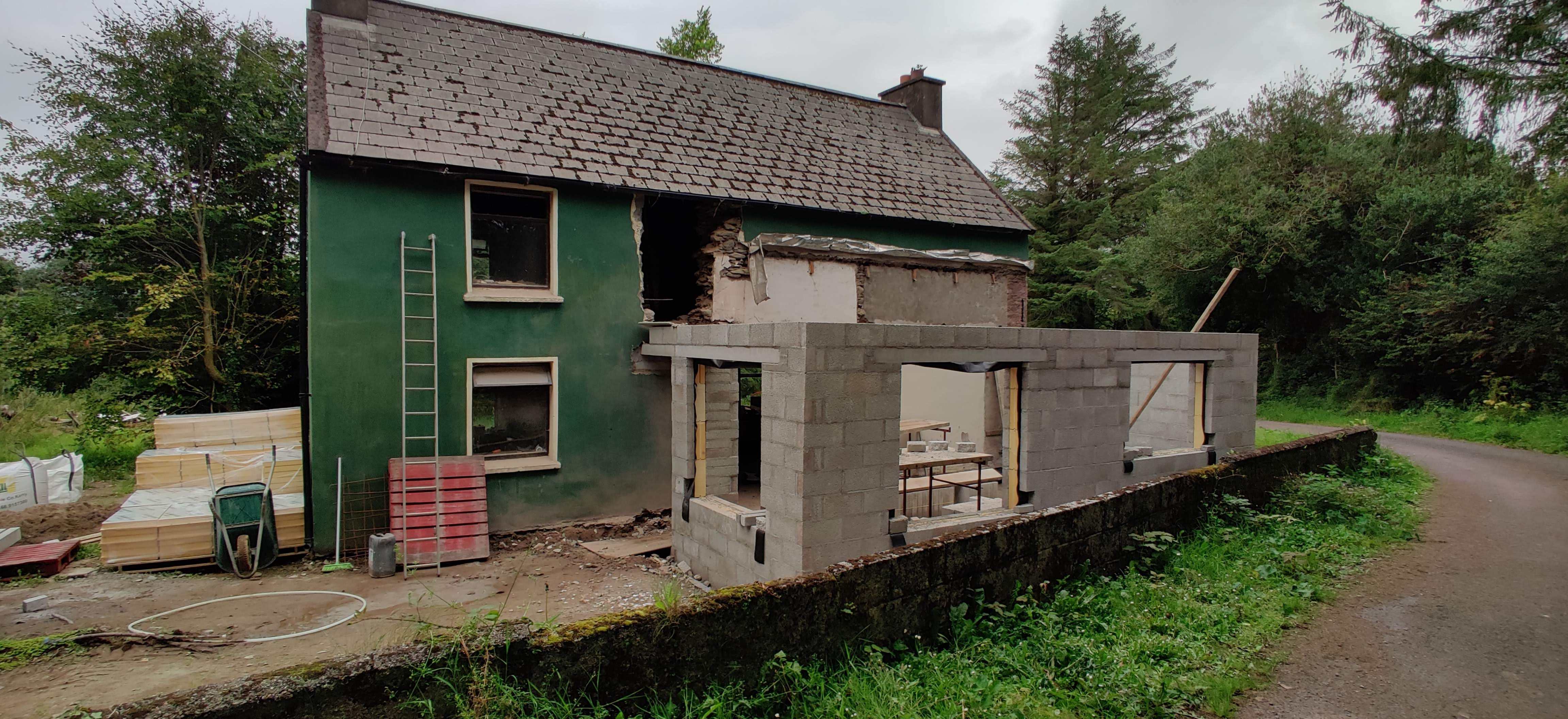

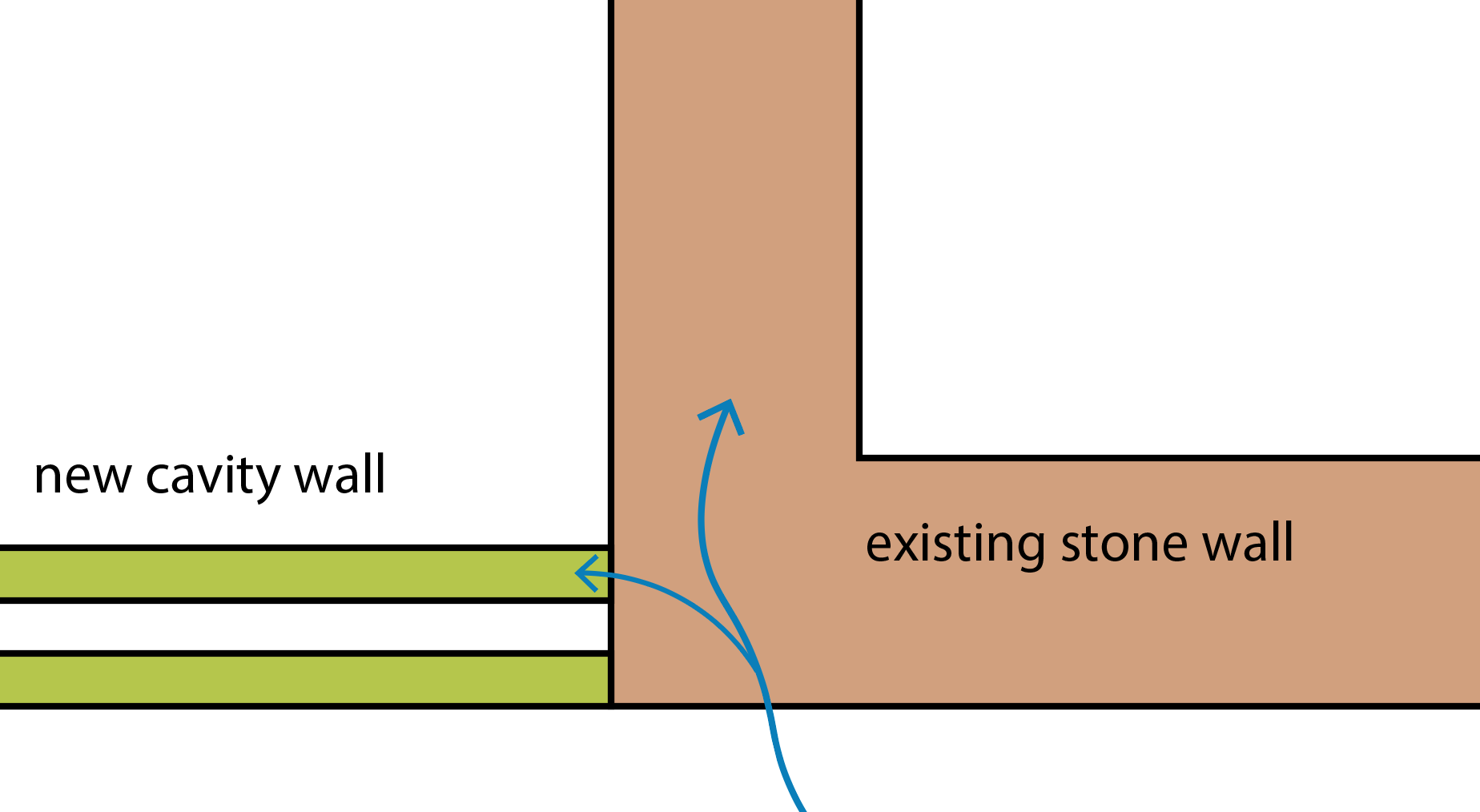

  24. just a quick query on a detail I want to ensure is correct. i'm planning to construct a cavity wall extension to the side of an existing two-storey farmhouse. the new extension will replace an old stone extension and we've yet to determine if the stone extension was keyed into the stone of the main house. In any case - I was wondering how best to detail the junction between the new blockwork and existing stonework to prevent any water in the stone wall from getting into the inner leaf (as per the crude diagram below). Is a vertical DPC the best bet or is there a better way of doing it?
