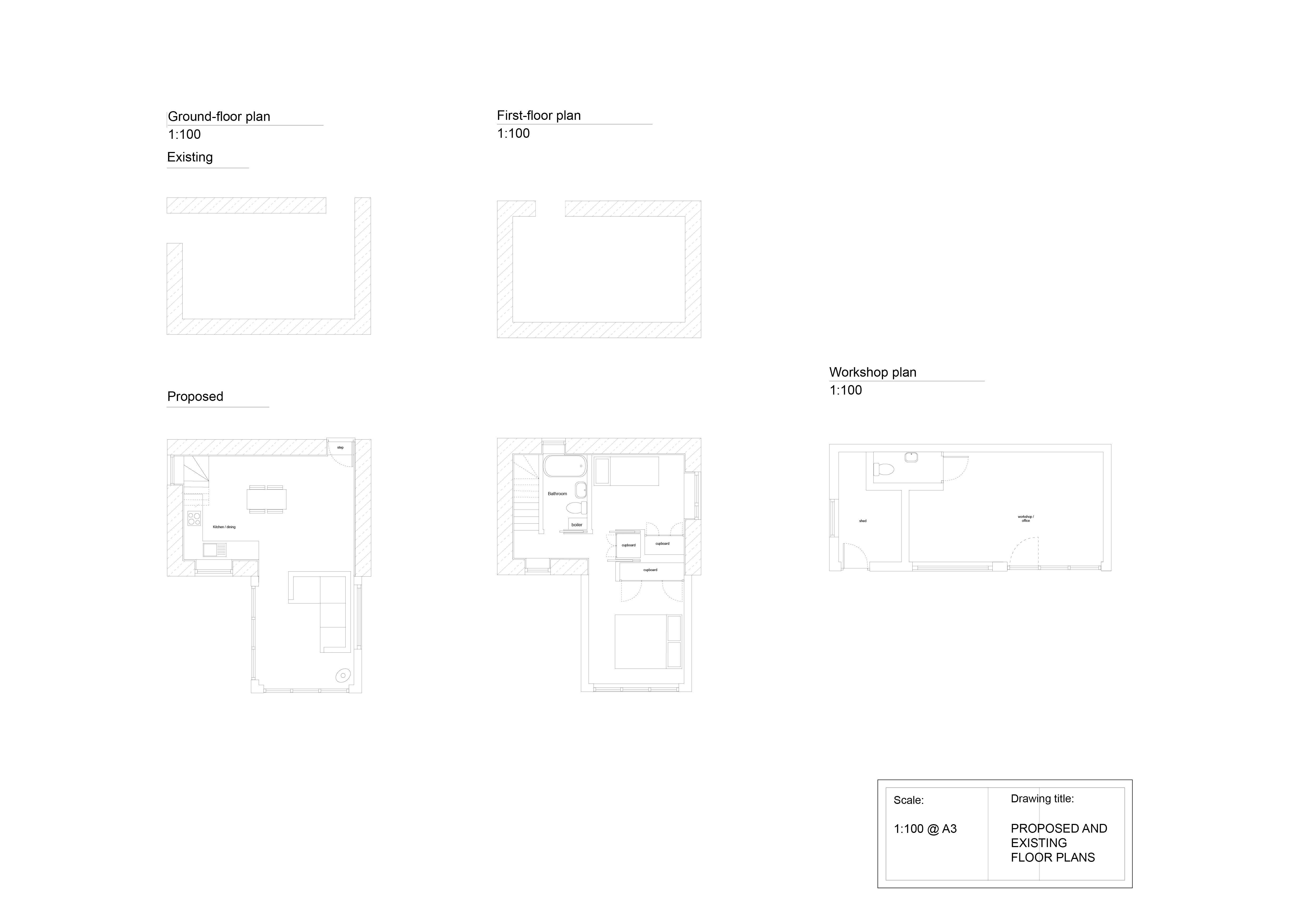

  15. Hi everyone, Realised I never did one of these intro posts so thought I should say hello and thank you for having me, seeing as it looks like I'll be having lots of questions! We're just waiting for our planning permission to come through (fingers crossed - planners have implied they support it) in a few weeks after lots of pointless surveys and delays, but hopefully we will get there in the end. We have a very small old granite barn, that looks a lot worse than it structurally is. We're hoping to convert and extend it into a 2 bed modest home, plus build an insulated workshop/office in the garden. Attached is a quick screenshot of our elevation plans! Would welcome any suggestions of suppliers and tradespeople in Cornwall. Thanks again for all your advice and support.
  16. Hi Peter. Sure, these are just the ones I did for planning. They don't currently show the right thickness of insulation
