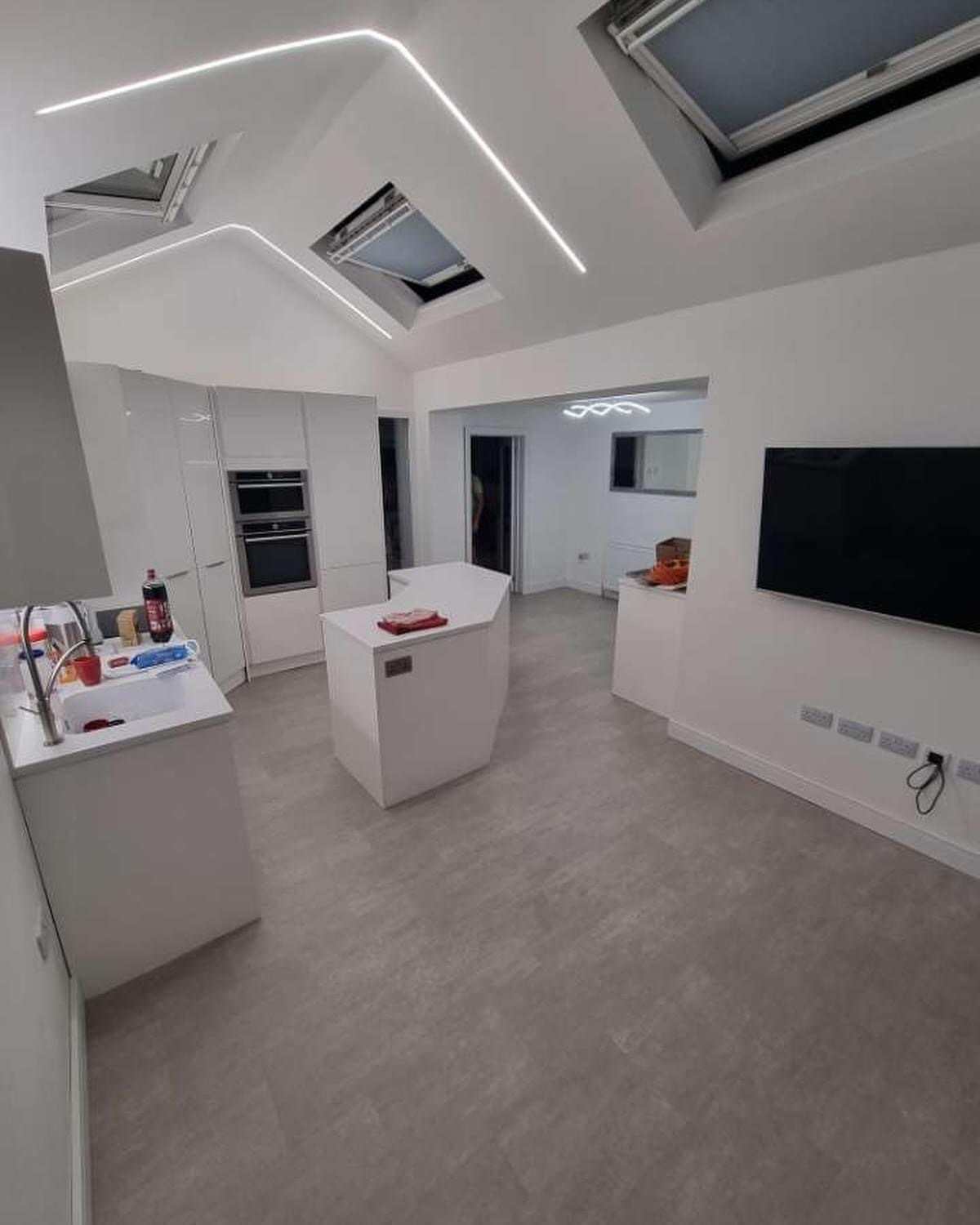

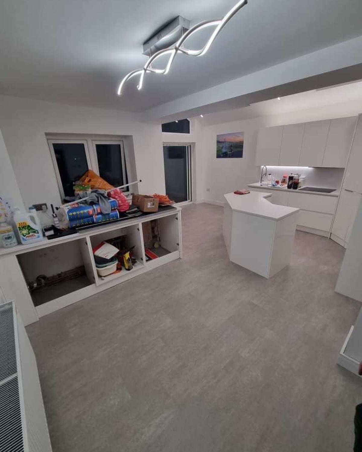

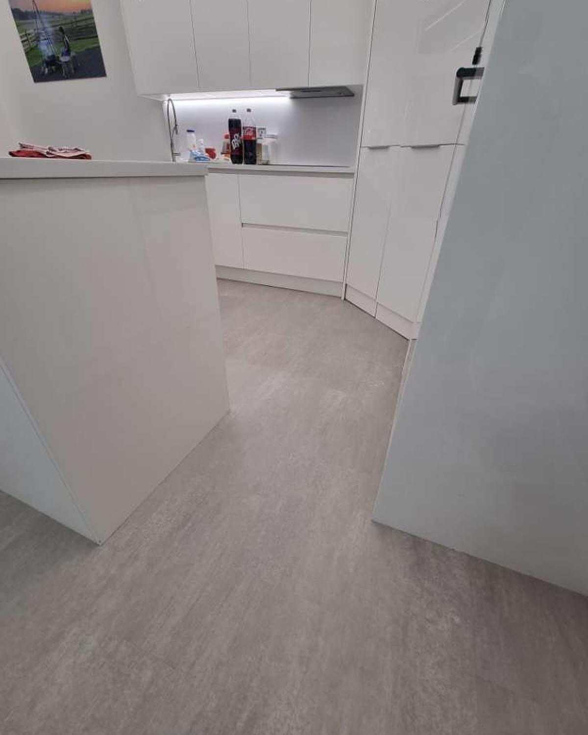

Well we ended up leaving the crackmat down and we got some fibre reinforcement screed over the top and then some glue down karndean to finish. Obviously looks no where as nice as the huge porcelain white gloss tiles but at least it’s not cracking now and is safe to walk on and is functional. I think when we charge the kitchen we might pull everything up and go back to the joists and replace the floor then. Huge thanks to everyone who took the time to reply it’s really appreciated ..

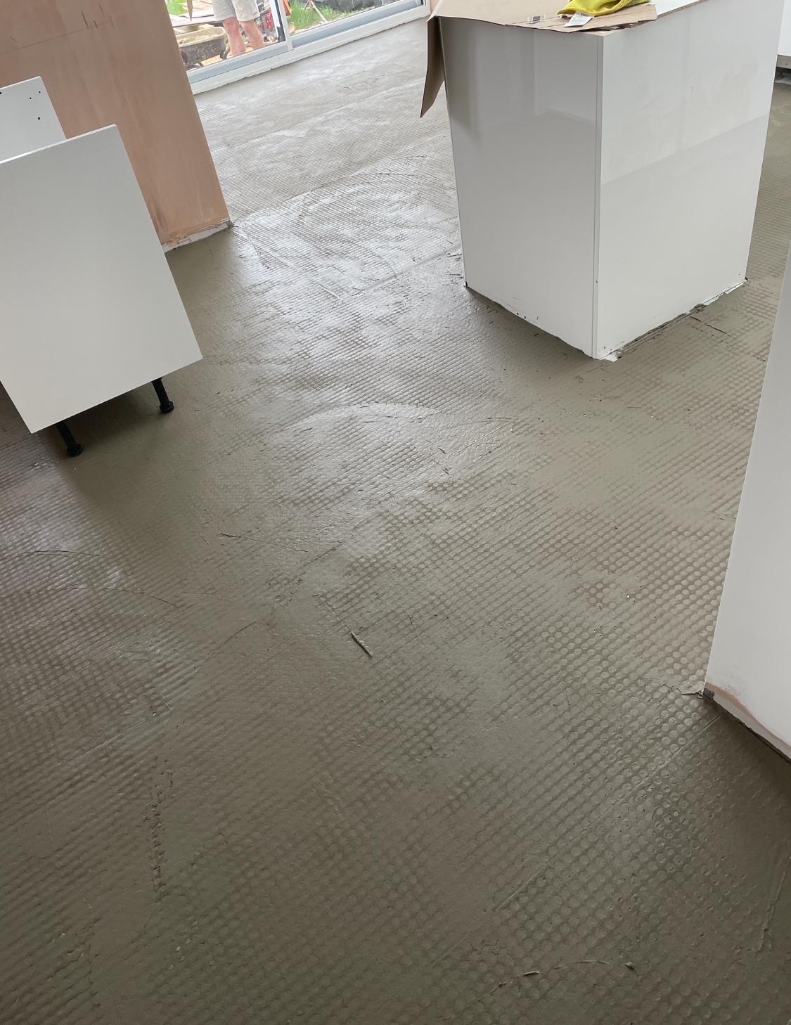

@bassanclan no idea about hangers.,but there is plenty of insulation I hope ripping the tiles up isn’t going to damage the sub floor as the underfloor heating is in it. There is a crackmat down so not sure if that needs to come up. Or if self leveller will be able to go down on top of it? I don’t think the builder will be back as we paid him his final payment last year and have been working with the tilers to try to get the cracked tiles sorted. When I asked the builder about the joist and floor he just said it was built to the architects spec 🤷🏻♀️ I would love to rip it all up and start again but with the new kitchen in and underfloor heating in, we can’t take everything up so are going to have to do the best fix possible. Whatever that is and try and get some flooring down that isn’t going to crack

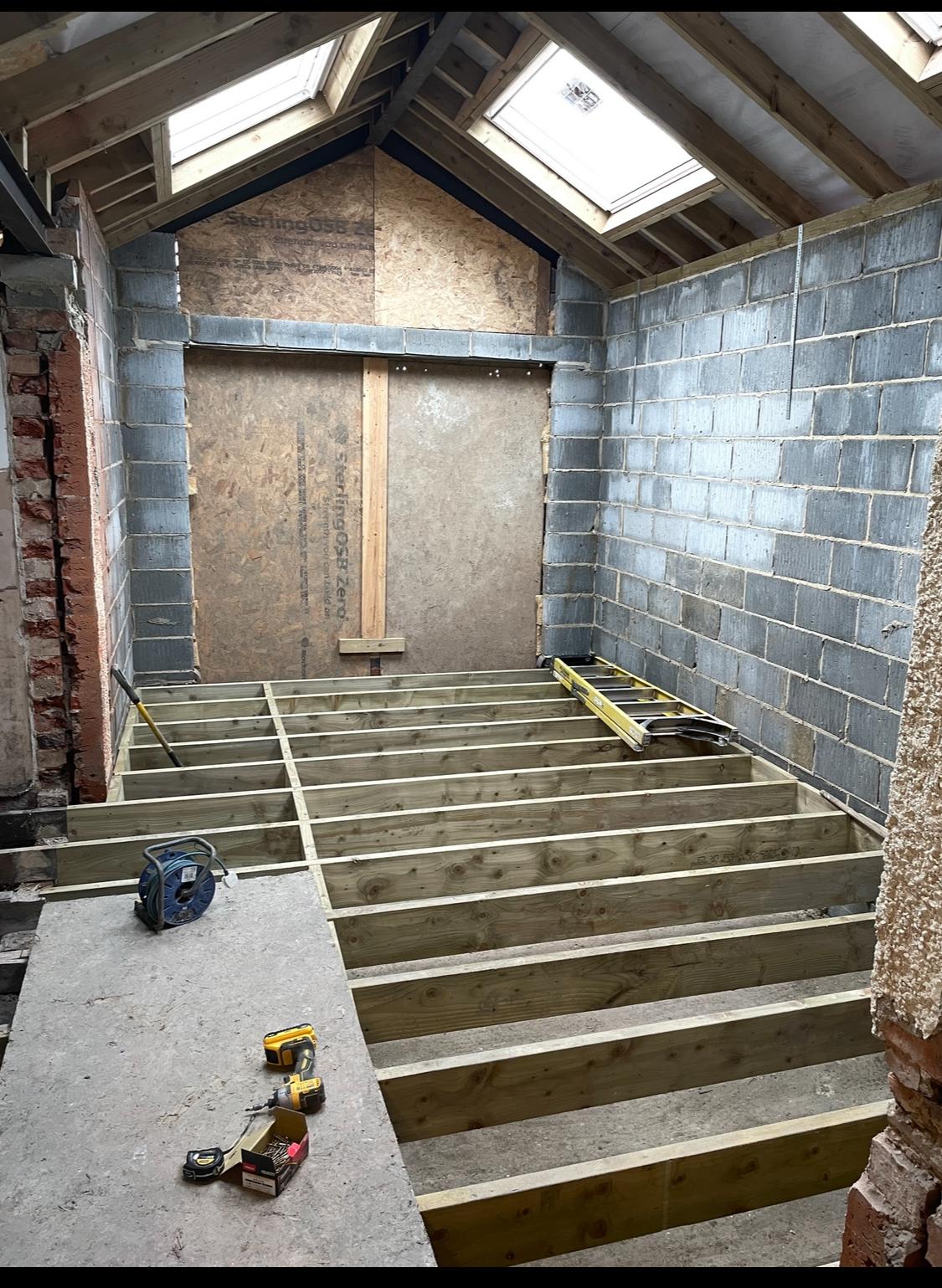

@Dave Jones 6mm ply Omnie board, then the tilers crack mat Span is 3200mm new extension which joined onto an existing kitchen suspended floor which spans 2300mm 😬

@Dave JonesOur builder said he built as per our architect spec which was “Structural floor to be in timber floor joisting. Install 200 x 50mm C16 floor joists at 400mm centres. Joists are not to be built into walling but are to be supported on restraint type joist hangers. Joists to have one row of herringbone or diagonal strutting - Herringbone strutting to be at least 38mm x 38mm; solid strutting to be at least 38mm thick and at least three quarters of the joist depth. Notches in joists to be no deeper than 0.125 times the depth of the joist and should not be cut closer to the support than 0.07of the span, nor further away than 0.25 times the span. Holes should be no greater than 0.25 times the depth of the joist; should be drilled at the neutral axis; and should be not less than 3 diameters (centre to centre) apart; and should be located between 0.25 and 0.4 times the span from the support” ??

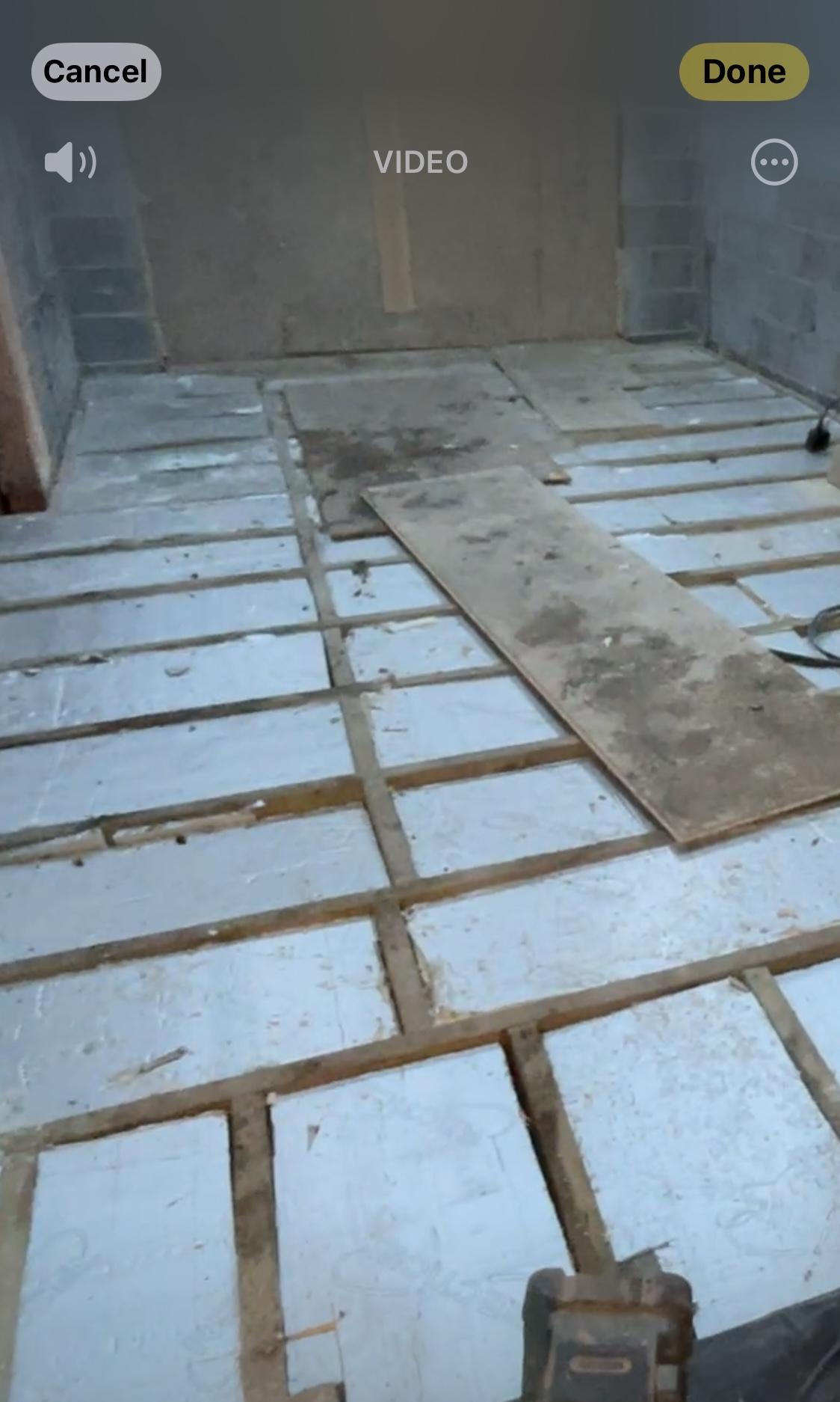

Hi we have a suspended floor. We used Omnie tor2 ufh floorboards with 6mm ply. The tiler used a crack mat and then we had 120cmx60cm porcelain tiles put down. The tiles keep cracking and the tiler said there is too much bounce in the floor. Any ideas how we can fix this bearing in mind we have ufh and although the ply had a pattern on showing where was safe to screw this has now been covered by the crack mat screed. Please help.
