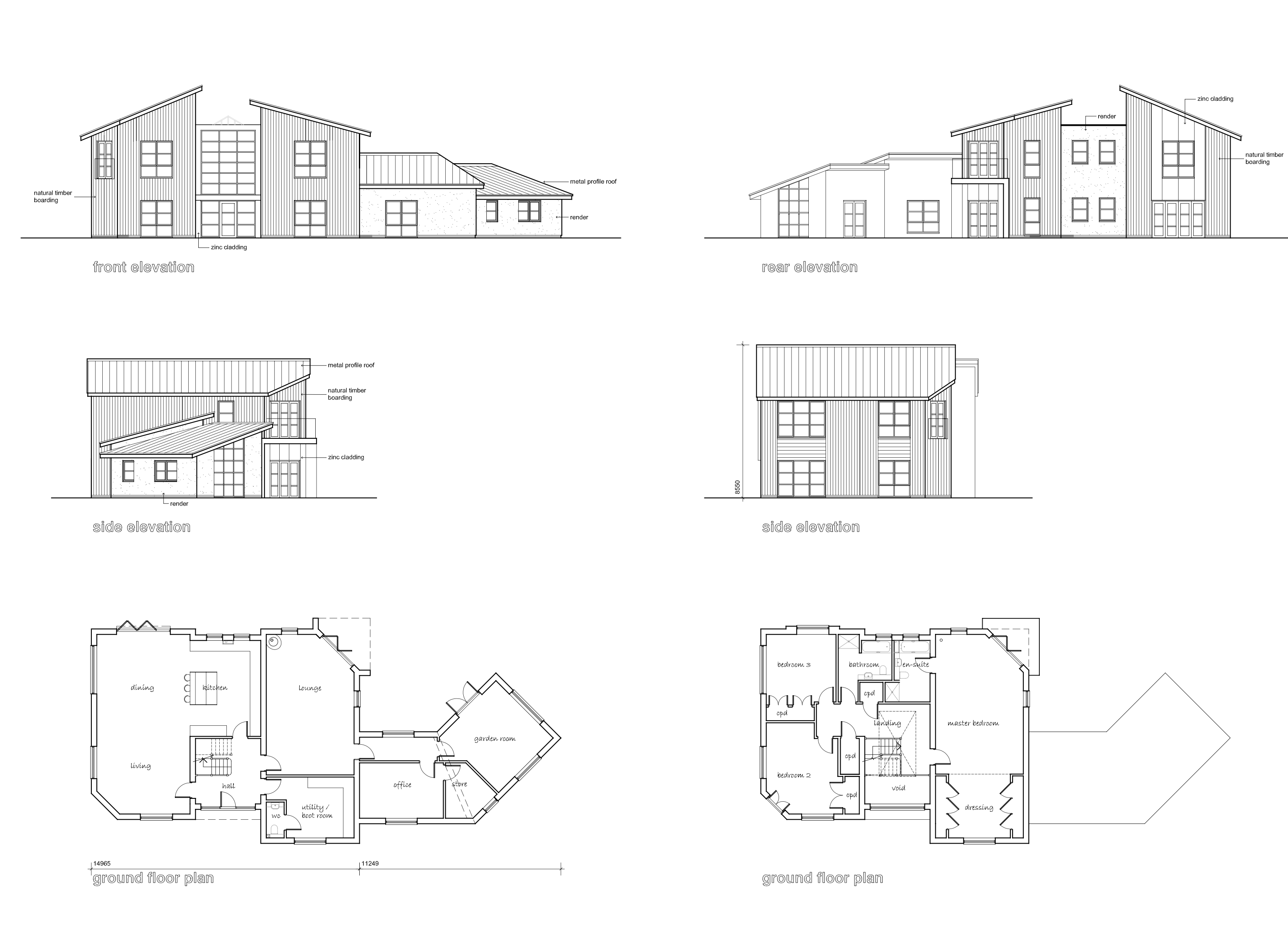

  3. (is this an ICF question or a foundation question ? both really ? Ok, so 2 options under consideration 1 - Insulated slab , KORE or Jackon or similar. Then off we go with ICF ... 2 - Standard trench with insulated slab prob with UFH in the slab, ICF coming off the concrete strip. (as per Nudura drawing) option 2 is simpler and therefore cheaper. Will I get a cold bridge issue ? Are the benefits of using insulated slab worth the extra cost ? other things to consider ? SE is steering towards 2 to save me costs, but am I compromising heat and insulation areas too much B6A02_1.pdf

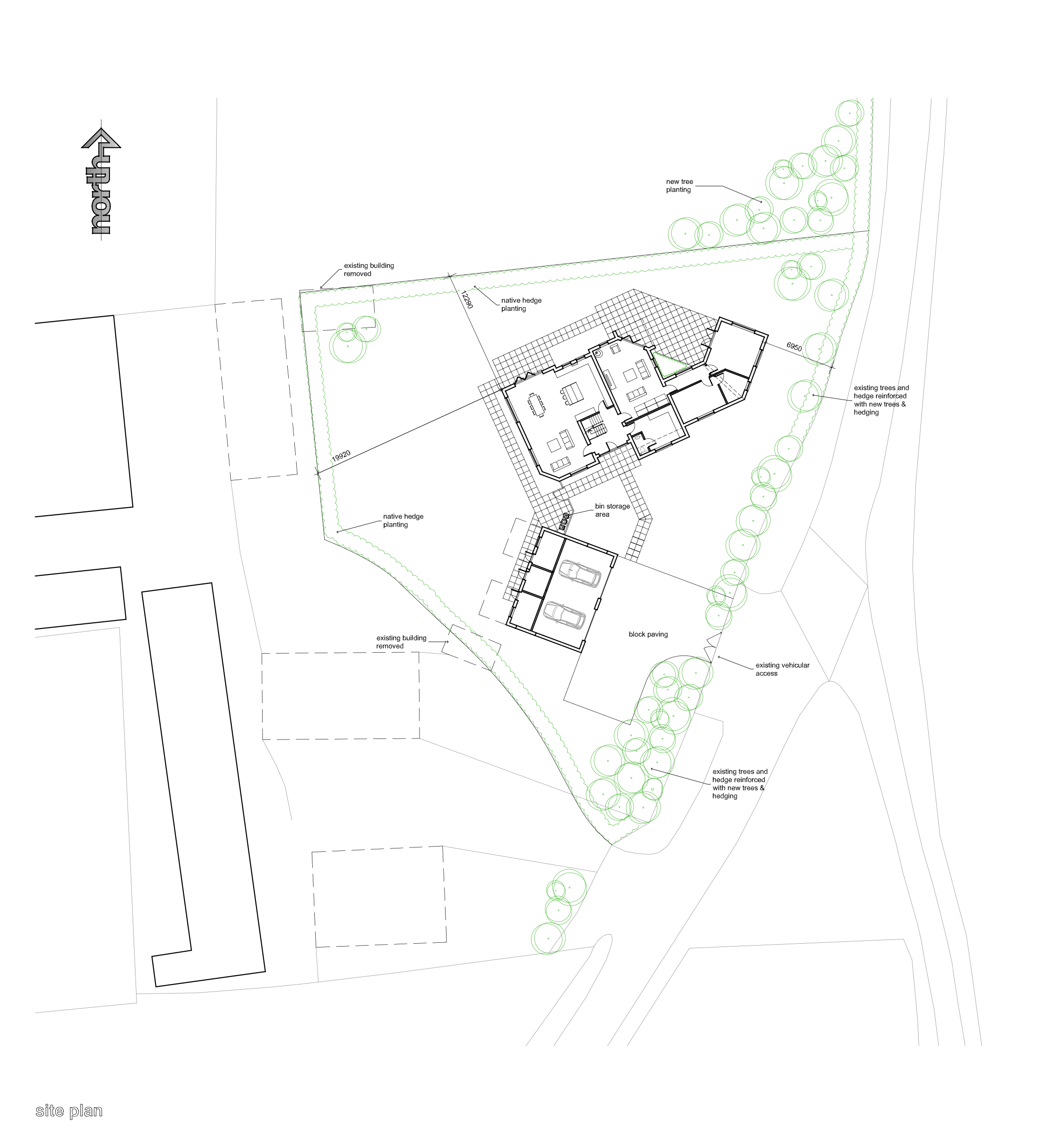

  23. Hi All, Here we go ! Have planning approved for the attached. Plan is to be as Eco as possible without going full passive. The main house is new build, the existing bungalow being converted into a garage. Plans are fluid internally, it wasn't our approved design so changes will be made. GSHP , UFH , MVHR , seeming to favour ICF over SIP as I want to do as much as possible myself. Likely SIP roofing. Externally a mixture of zinc (maybe) , render and timber clad. It's off mains so waste plant going in. Full electric , sadly single phase so will struggle until we can get that ramped up. I'm looking to modify the designs to make it as off the shelf as possible and simple to build, for costs and my sanity ! What have I missed ? Thanks Ian
