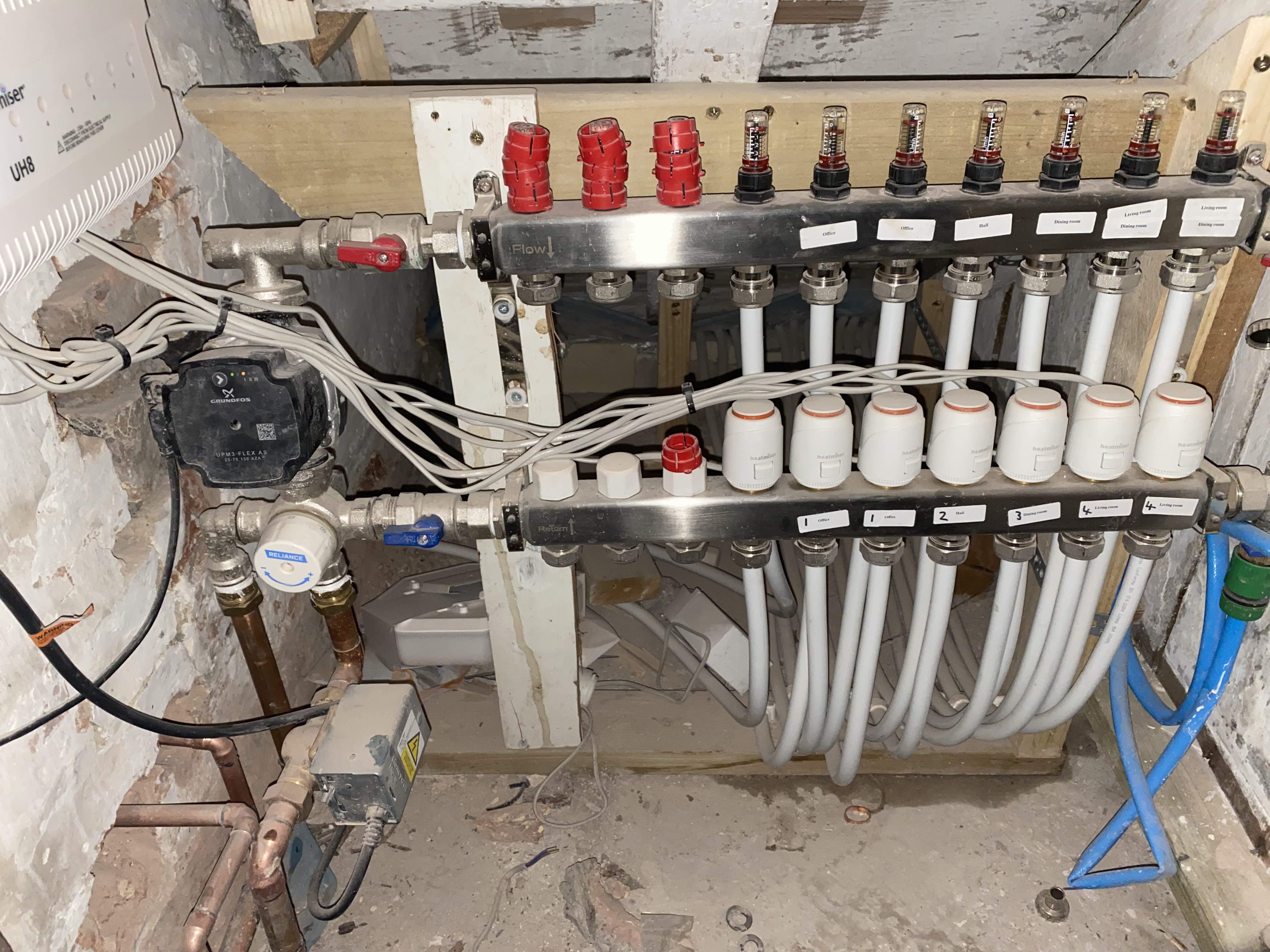

  8. Pretty sure it's the return, not sure why the gate is there though. The 2 port valve is on the flow and you can just see the nut of the auto-bypass valve, towards the bottom of the picture, between the two.
  9. Great stuff, thanks for the help, @Nickfromwales! We do have an AAV in the airing cupboard upstairs, I think it's on the return from the DWH coil.
  10. An AAV on both the flow and return? I'd seen sets sold where there's an AAV on the flow and pressure gauge on the return.

  17. Should/could the service void span multiple floors - I'm thinking so new cables could be dropped from the loft space to the ground floor without disturbing the first floor room? I assume doing so would increase the risk of noise travelling between ground and first floor rooms?

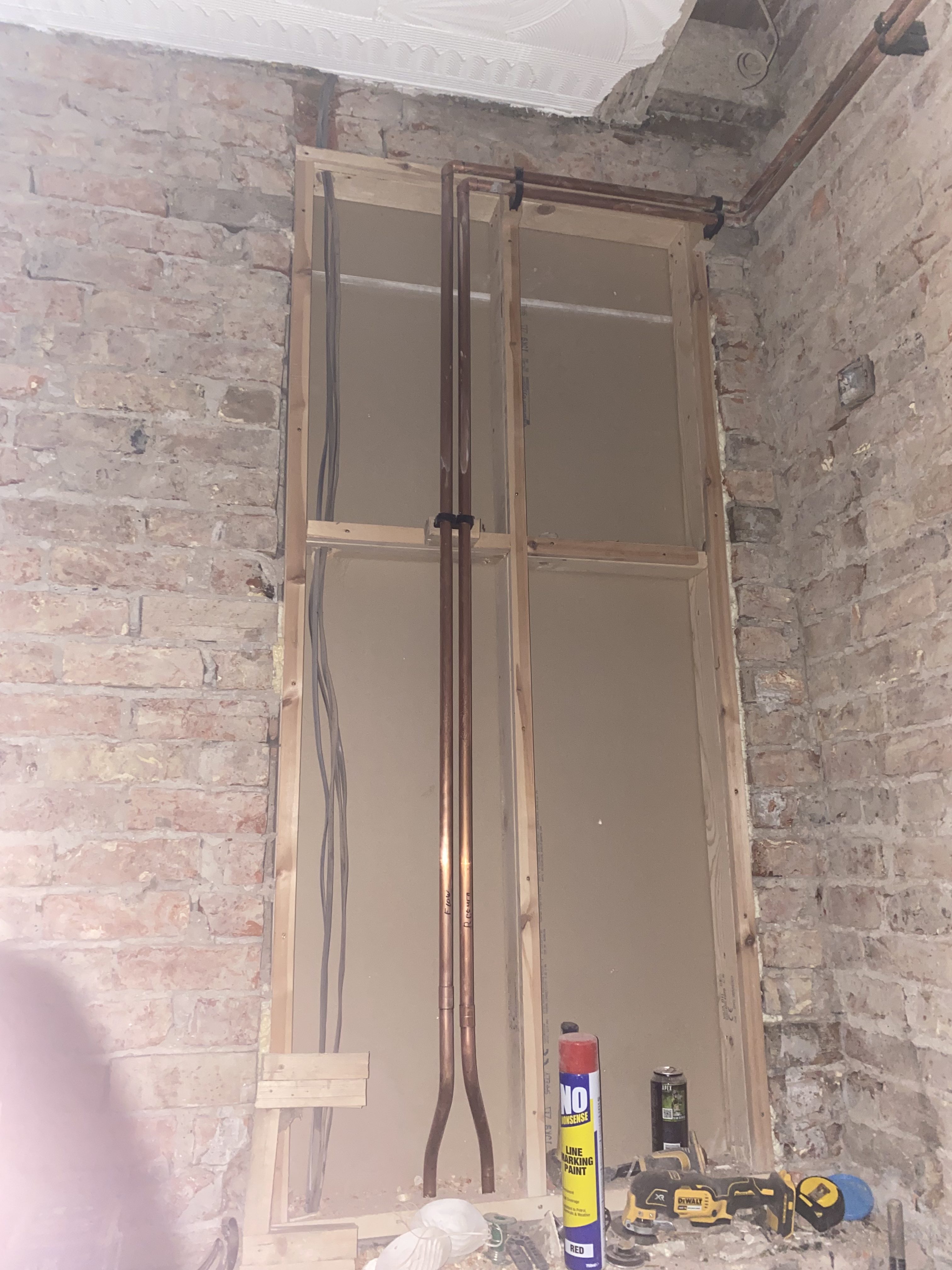

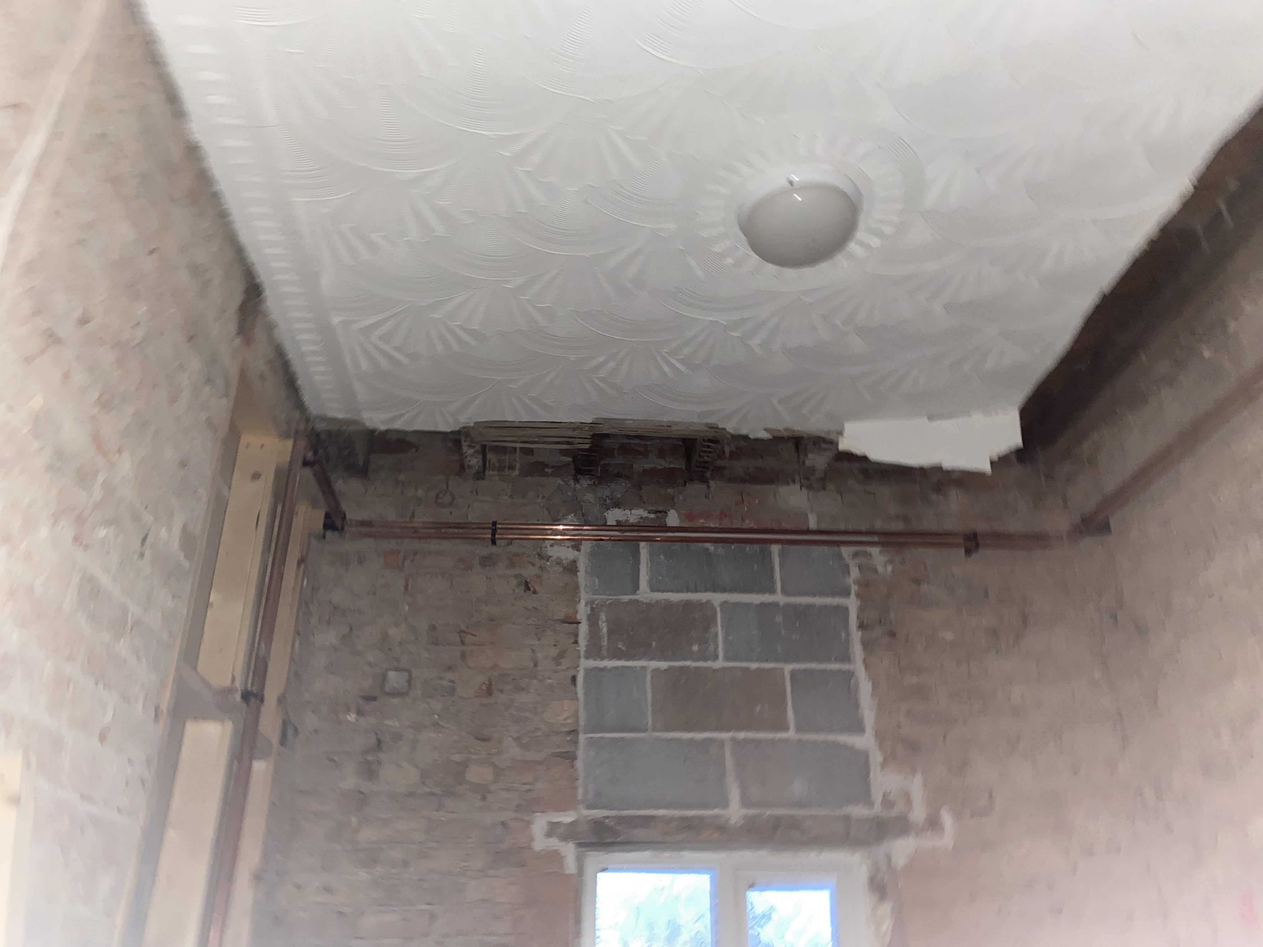

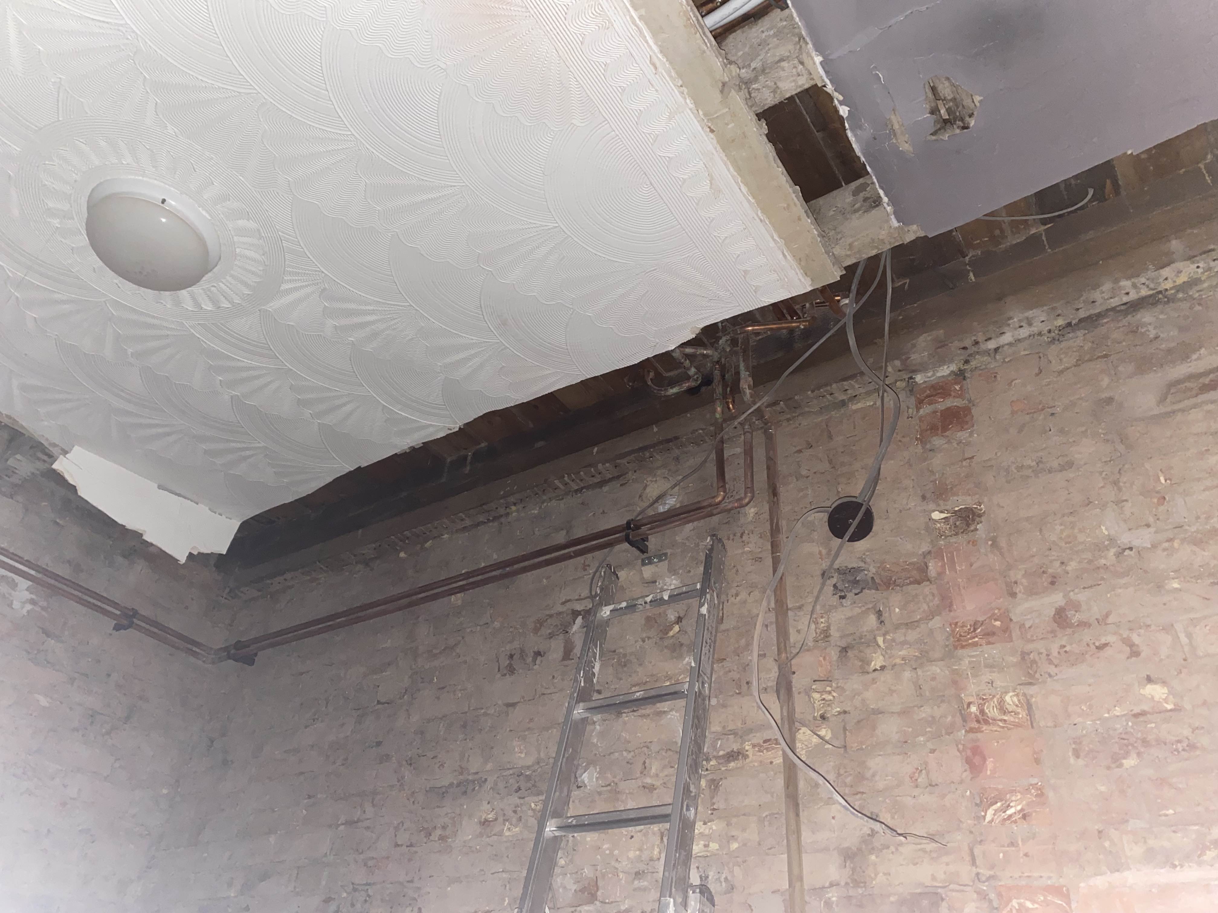

  18. I read this on an old buildings forum being touted as another reason not to use PIR and didn't think much of it. Seems like it's a growing problem given the majority of mass built housing is insulated with PIR? Perhaps it's less of a problem given the (lack of) care given to installing insulation by these mass builders - I bet the signal can still get through all the gaps in the cavity
  19. AFAIK, wood fibre covered with lime plaster doesn't need a VCL as the wood fibre itself is hygroscopic. Of course you need to consider the finer details, around junctions etc. Surely heat can only reduce the risk of condensation and indeed damp showing on the external face, if that heat is allowed to pass through the wall, negating the purpose of insulation? Damp walls are generally a symptom of a problem, the root cause needs addressing (reducing ground levels, fixing gutters, removing that external paint (assuming it's non-permeable)) etc.
  20. The plaster around the lathes was around 25mm thick, it was rock solid and so no signs of water damage. I have no idea how long it's been up for, but it took some budging. They don't make 'em like the used to!
