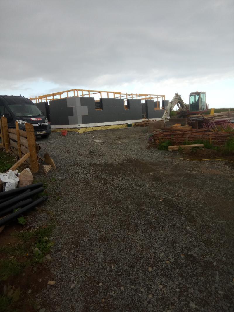

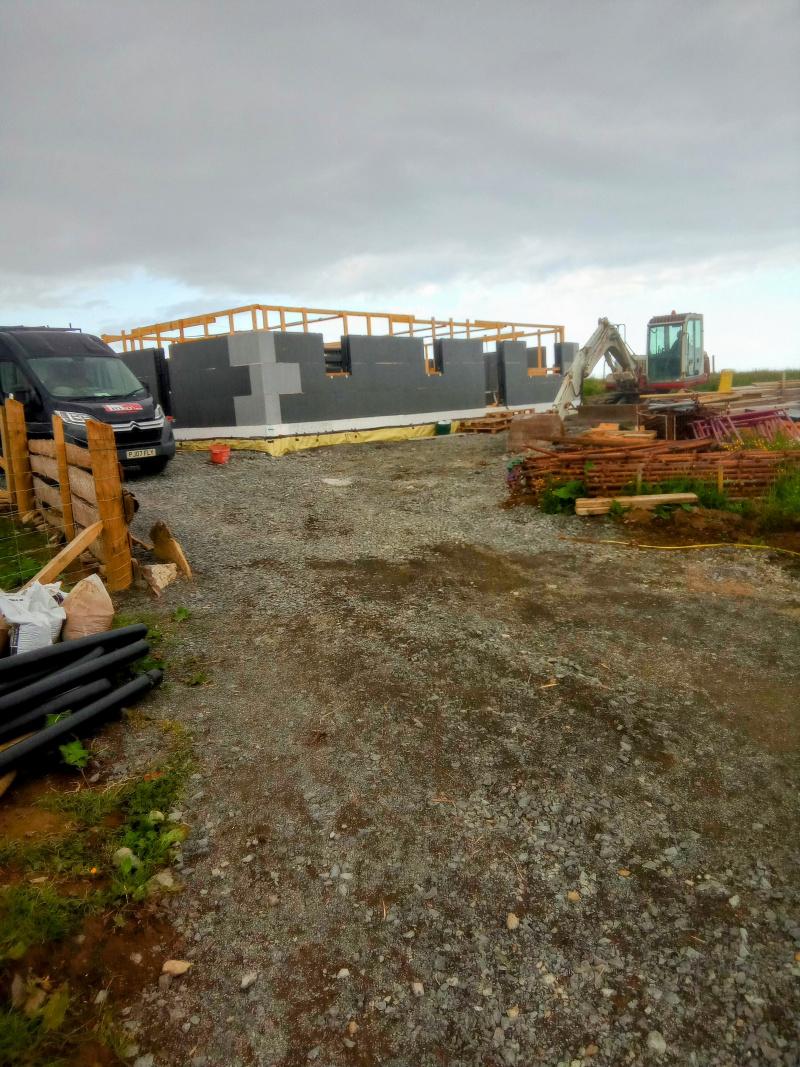

Day 48 of the build was a big one, we poured the ICF ( PolySteel) walls.
Following the slab pour 2 weeks earlier, we start on building the PolySteel ICF walls.

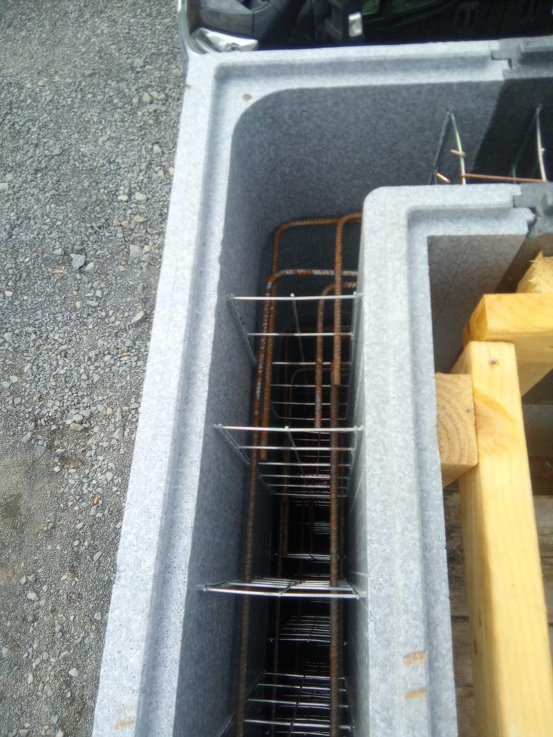

I've no experience with ICF, and thus can only comment on the usability and quality of PolySteel. The process is straightforward, all the blocks are t&g on all edges, so you simply use a bead of fire rated foam and push the blocks together. Each block clips to the last with two **clips joining the metal mesh inside the block together.
Our rebar spec, was I think over the top, but basically we had a pair of 10mm starter rebars vertically every 300mm centres so the first two rows we had to position the blocks over the starter bars. In addition to this each corner block( 2 left-hand and 2 right-hand in our case per course) have 4 off 10mm L bars and pairs of 10mm horizontally on 300mm  centres.
Our perimeter is just shy of 40M, so all in that's just short of 2KM of rebar.
Point 1, the spec calls for 400 mm L  corner bars, (which I had cut and bent)  you can't fit these. You can get 1 in but the other 3 need to be shorter on one side to get in, this was more so on the first two courses with the precast starter bars in the way. I ended up cutting 1 to  400mm X 300mm and 2 to 400mm X 200mm per set.

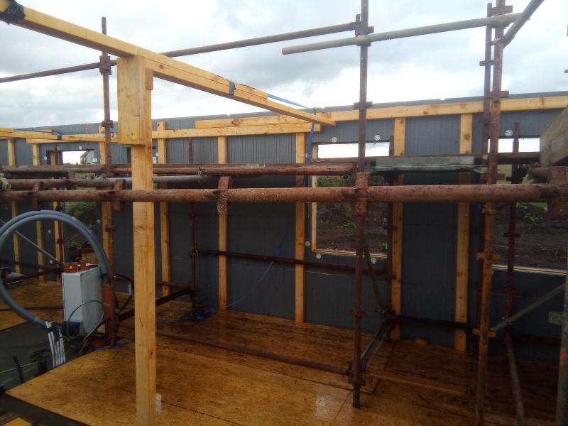

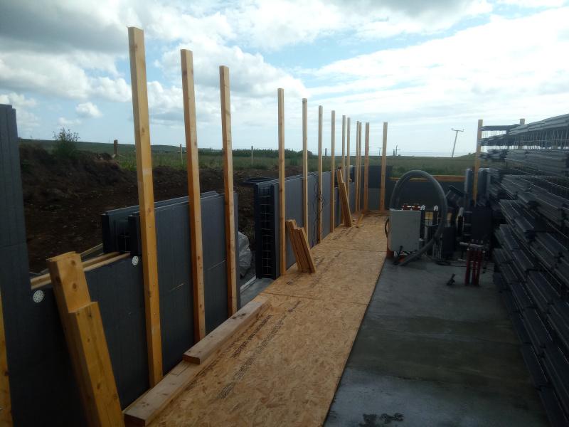

At two courses high it was time to start bracing. This was done by fixing 4x2 to the blocks on 1M centres and at every opening ( the 4x2 will be re-used for studding later)
I secured the timber to the blocks with 100mm baypole screws 3 per block in pre drilled holes. Below shows a bit later on but a 4x2 ring beam tied to all the verticals. We also tied the long walls (N&S) to each other with long ratchet straps and more 4x2. A little security if the winds picked up.
Once 3 course we're built, I made the boxes for the windows and doors, basically 6x2 screwed through the ICF into the timber. These we're then sealed with some silicon and or foam. On the back of the 6x2 I screwed in some coach bolts to act as a key to fix them to the concrete. Each course we added the corner and horizontal rebars.
We then erected some Kwikstage scaffold around the inside perimeter. This is old rusty scaffold but wasn't ready for the scrap man just yet.
The bays fit really well, snug if you like. When I purchased the scaffold I also got thrown in a load of 5ft tubes, swivel, couplers and clamps. So I went around and braced the scaffold and tied each section to each other with short sections of pole. This made the stage rigid, lastly used some standards to brace the North and South walls together, creating a mesh in the middle.

All blocks were screwed to the vertical 4x2 and then the vertical 4x2 we're plumbed and tied to the scaffold. This made the whole lot rock solid. I used string lines to make sure the walls were straight and plumb before fixing to the scaffold.
Now we put in the vertical rebar, pairs of 10mm rebar on 300 centres.
Pic below shows the corner L bars before the verticals were fitted.

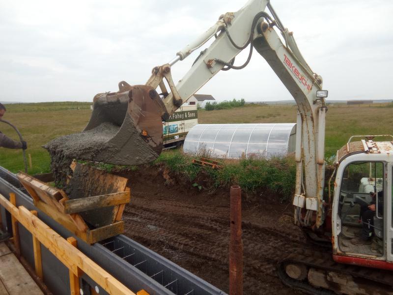

To pour the concrete, around 12M³, a pump was put of budget as they would have to come from Inverness, we were quoted 2K, so reverted to the 360 bucket method.

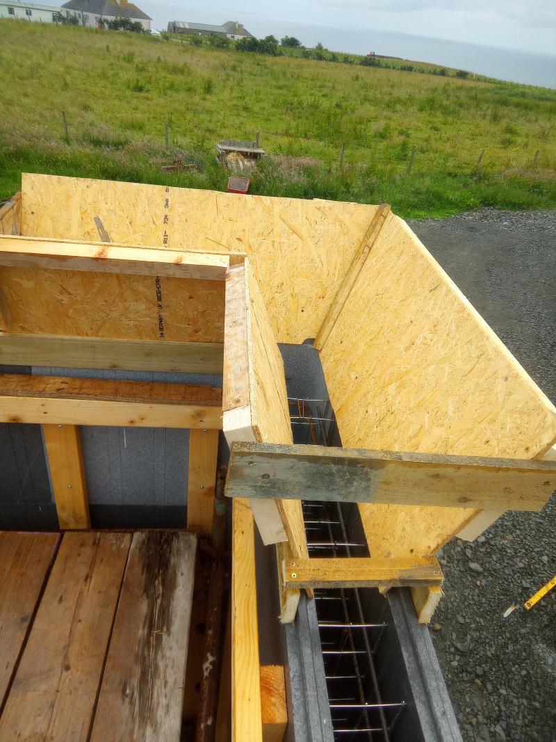

I created 2 pour boxes and 1 corner box put of OSB, to act as a funnel for the concrete.
We poured in 600mm levels and vibrated the concrete. Moving the pour boxes along as we went.
The first wagon had 7 cube so this would be over all the cills, once the cills were full, we capped them off and screwed some 4x1 in place. All working like a dream...

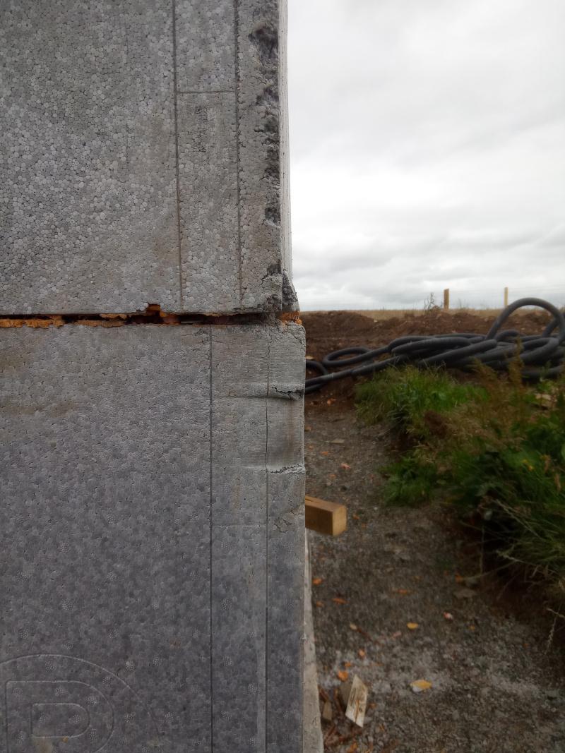

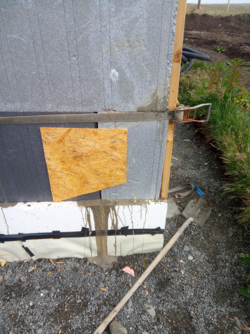

I went down to check levels etc, and noticed that one corner block on the SE corner, between a long window and large lounge window had moved😱. The t&g was holding but the was a 15mm gap. Ok panic starting now. We stopped pouring here and moved moved on but needed a solution. I'm not proud of this, but we used a haulage strap, through the window around and out through the door and back and ratcheted the section of  wall together with some timber on the corners to prevent the strap digging into the ICF.
Followed this up with some OSB and timber straps.

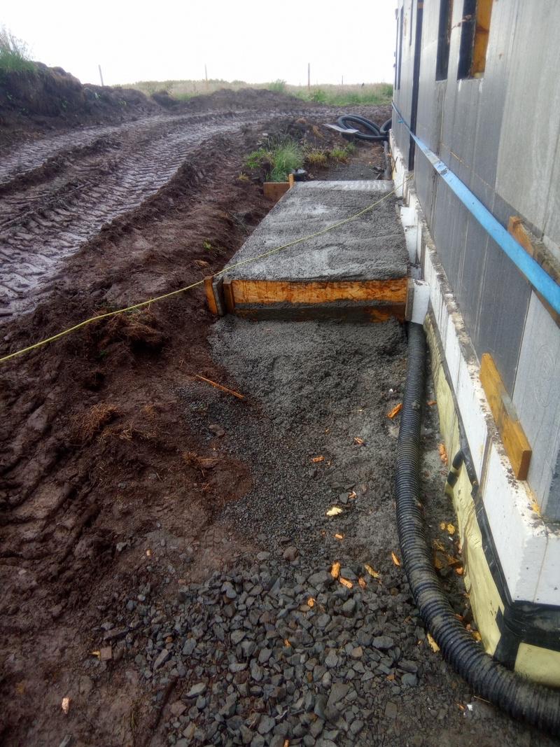

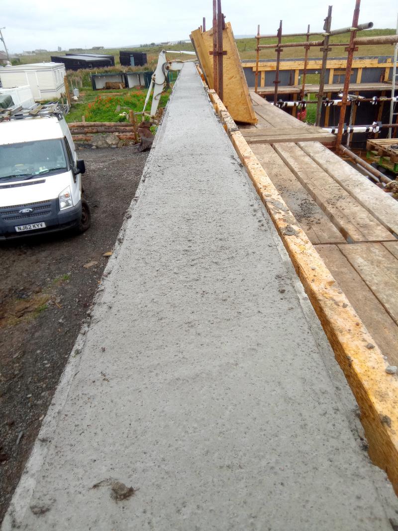

We were contemplating buckets when my neighbour brought his Manatu with a big bucket and managed with shovels for the last bit around 1/2 a cube.  While the tops of the walls were being floated, and in anticipation for excess concrete we managed to fill some shuttering for a front path, and the start of the ramp to the rear door.
This is the offcuts of ICF from the windows that will form the path and increase the levels at this corner hopefully softening the height in this corner.
So it's done, it's up, my heart rate is now normal, and I think I dodged a bullet or two. But with DIY and house building you have to adapt to react to the events as they unfold.  My list of favours I owe my neighbour has expanded. But we can sit here today and be proud of the product. the SE corner will need a little fettling to get square,but nothing to worry about.

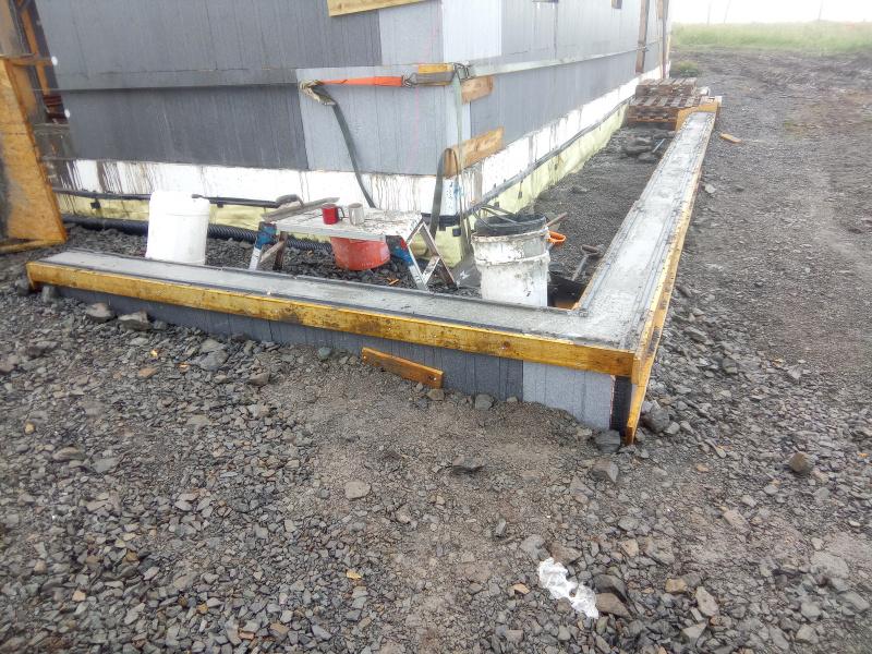

So after a few days off the job 1 day rest, and 2days taking care of some other bits and pieces, we've started cleaning up after the pour, and having a proper look at the problem SE ( moved) corner.
The block has basically rotated, so on the south wall there is now a gap at the bottom and on the East wall the bottom block sticks out about 15mm Tapering to being back in line.
It looks like I'll be able to rasp this flat on the E wall and use some foam on the S elevation. There is EWI going on this. So definitely a bullet dodged, and hopefully a easy fix.
