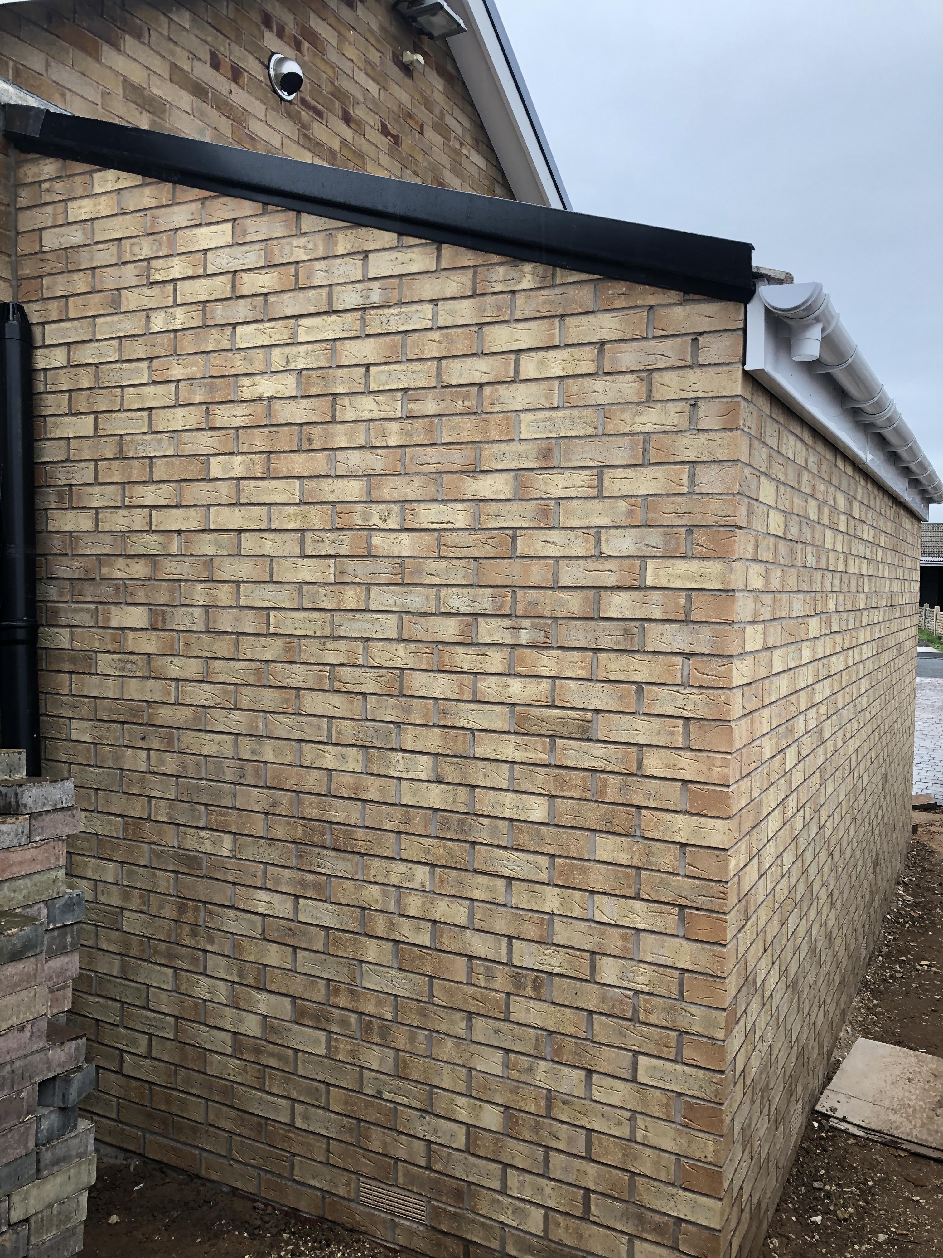

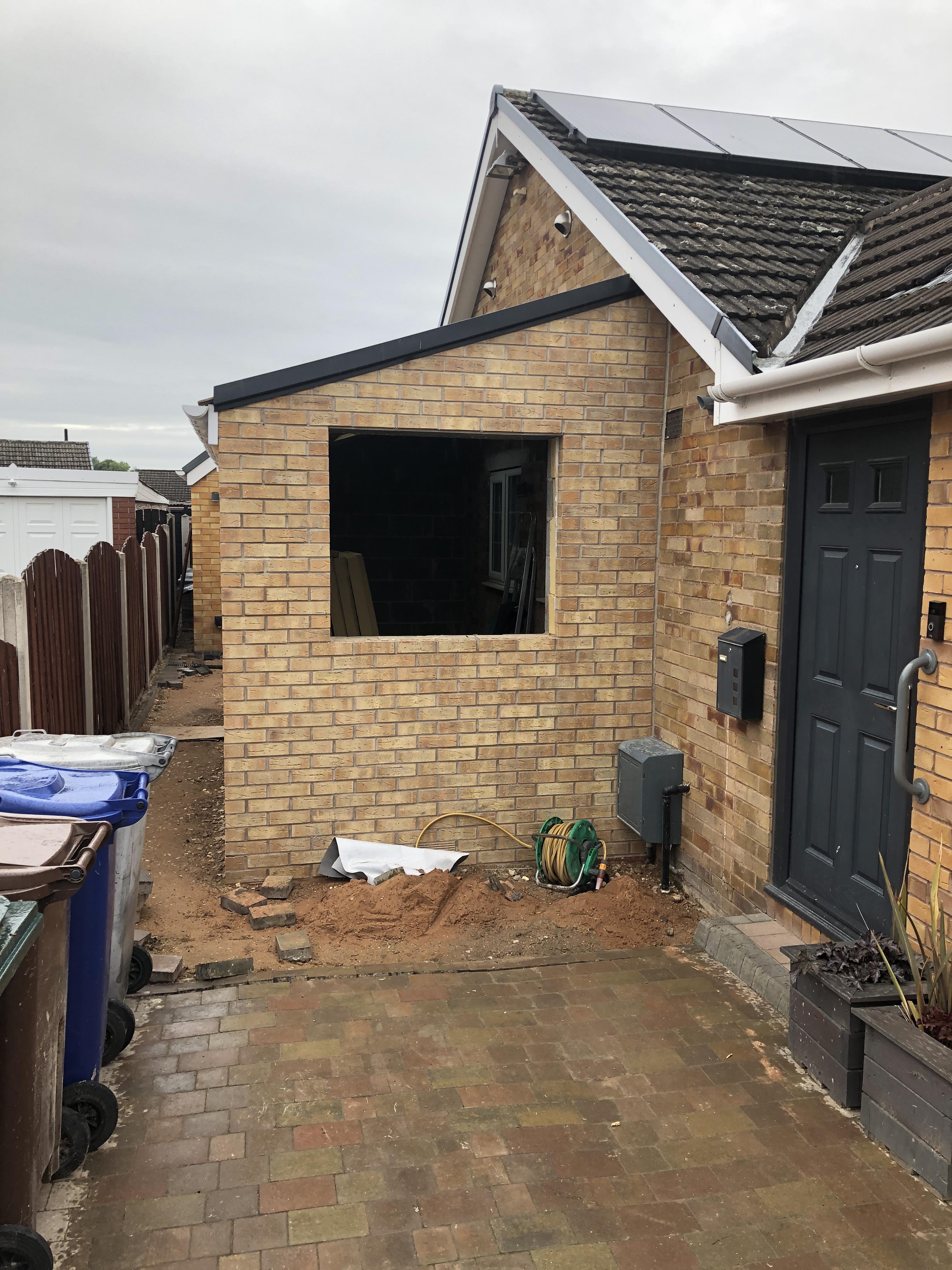

So the outside shell of the building is now completed, and yesterday I started work on the inside.
The lean-to roof was extremely close, but just squeezed it in with a slight pitch modification. This leaves me with essentially 3 sections of wall to clad: Near side will get done with EWI and brick slips, and the flue will get extended through the EWI, far side will get EWI and brick slips right up to the soffit, and that will leave a triangle with 1 missing corner above the extension. This will get clad with timber, and insulated to match the EWI spec. The EWI will likely get done first, the timber later.
Downpipe is to be fitted yet, and will temporarily get routed down the soil stack. I'm going to get several large water storage tanks, but as you can probably see i've got a mountain of block paving to shift first!!

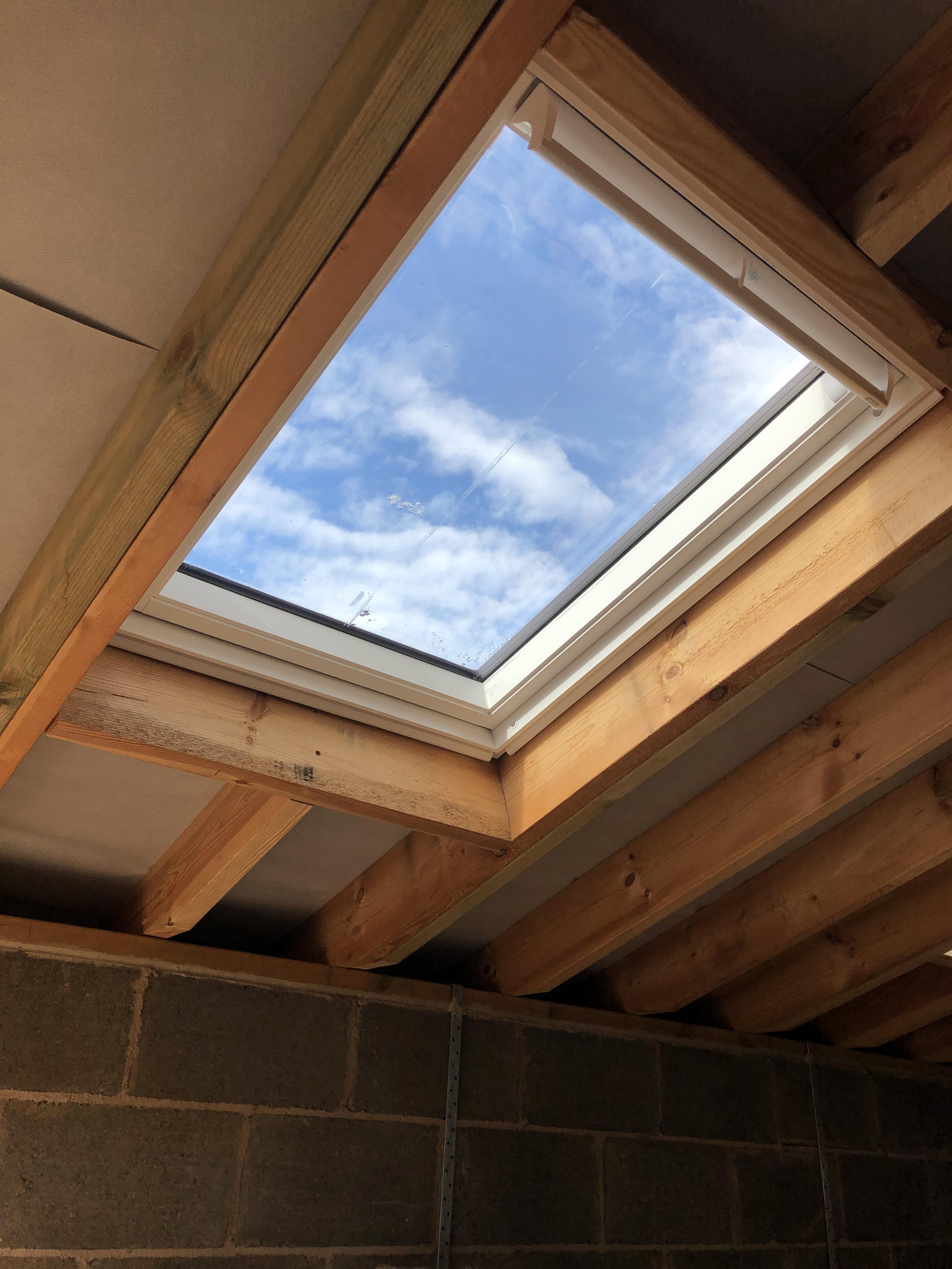

Really pleased with my size choice for the windows, had worried they weren't going to be big enough, but think they are spot on!

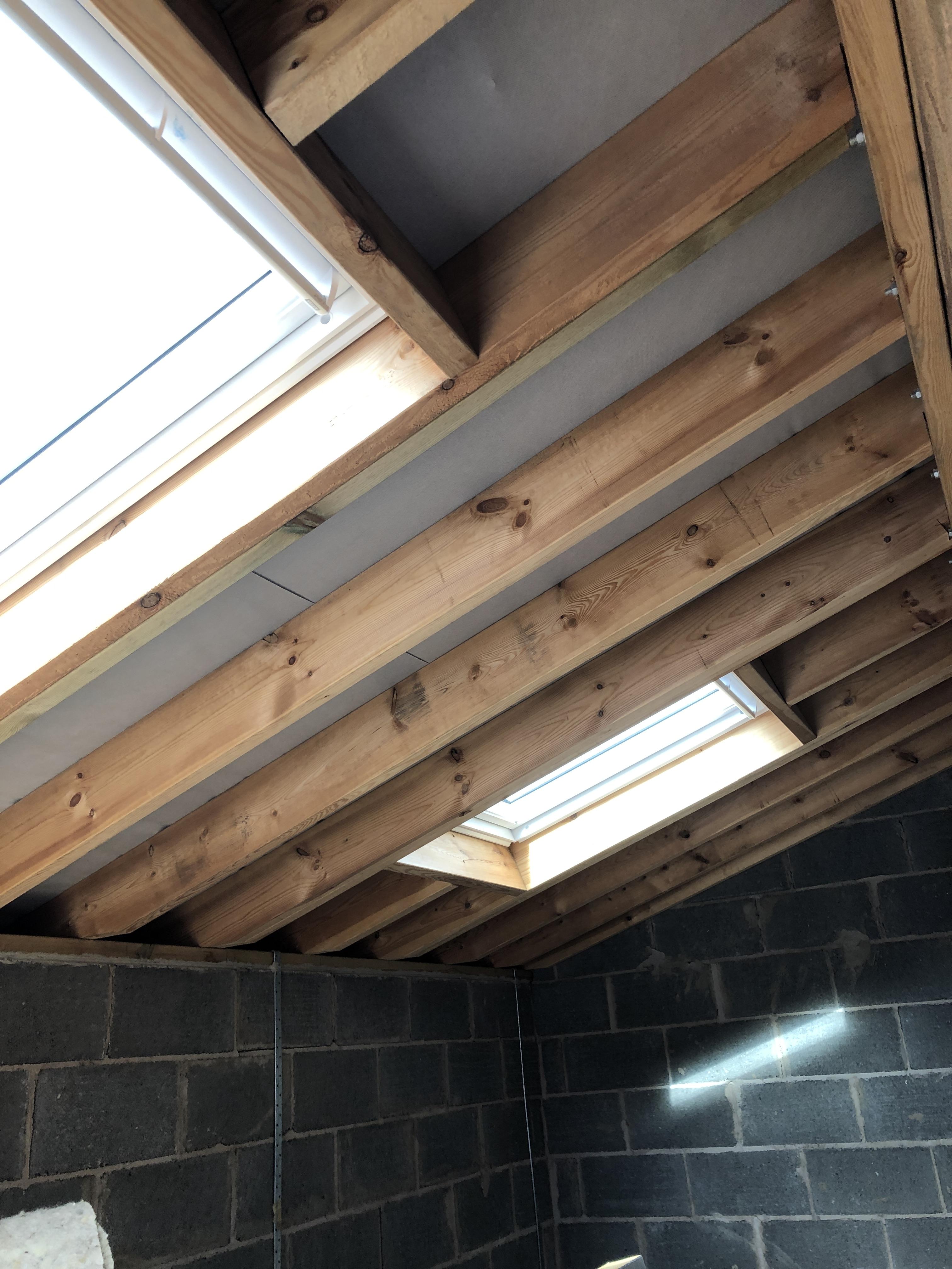

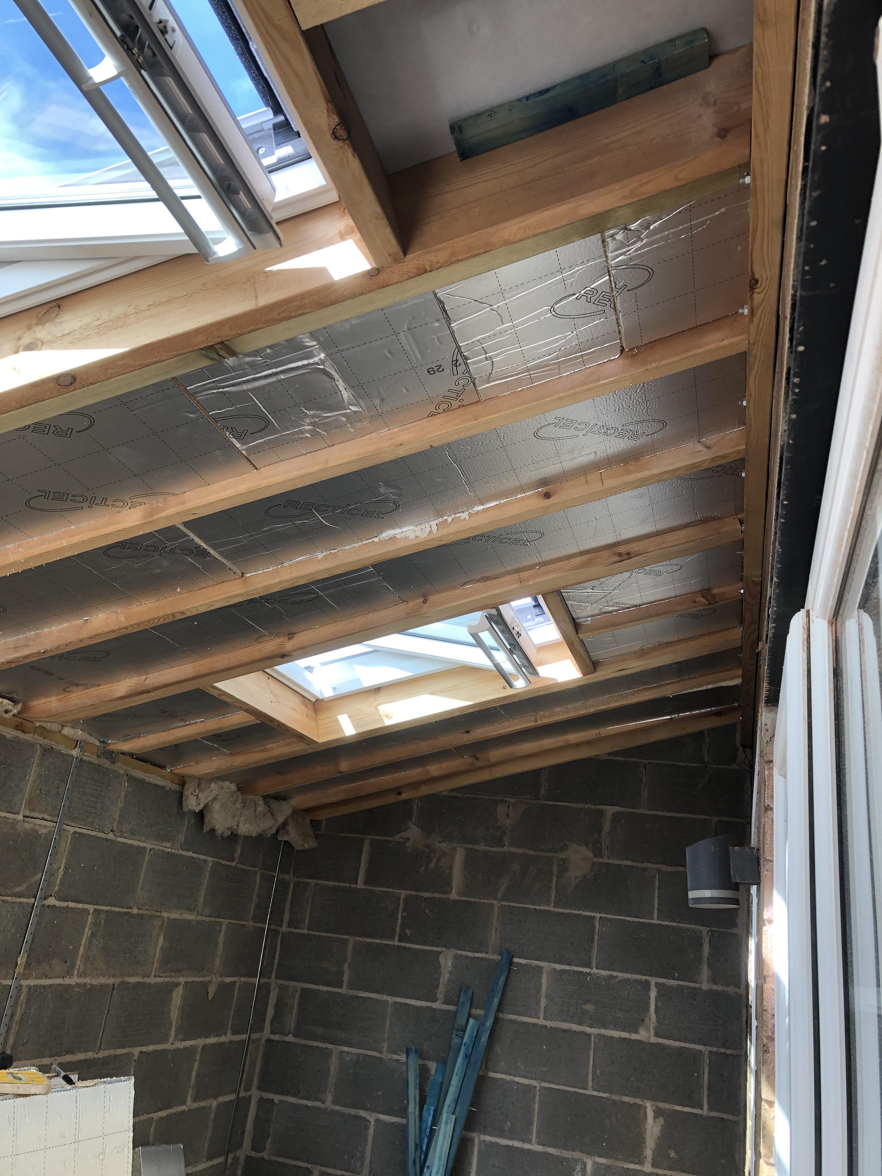

First day of me on the job, got the first layer of insulation in, 100mm PIR. Need to hit it with the expanding foam, there is then a further 50mm to go on top of this, and then 25mm under the rafters, before the plasterboard.

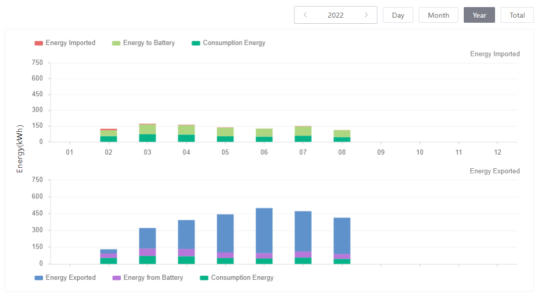

I also made the decision to invest in another battery, a further US3000C module to take me to around 6.6kWh of usable, and unlock the full 3kW output of the inverter, and given the current outlook to import pricing, I think i made the right choice.
Very pleased with how the battery system is performing even how it is currently with only a single module.
