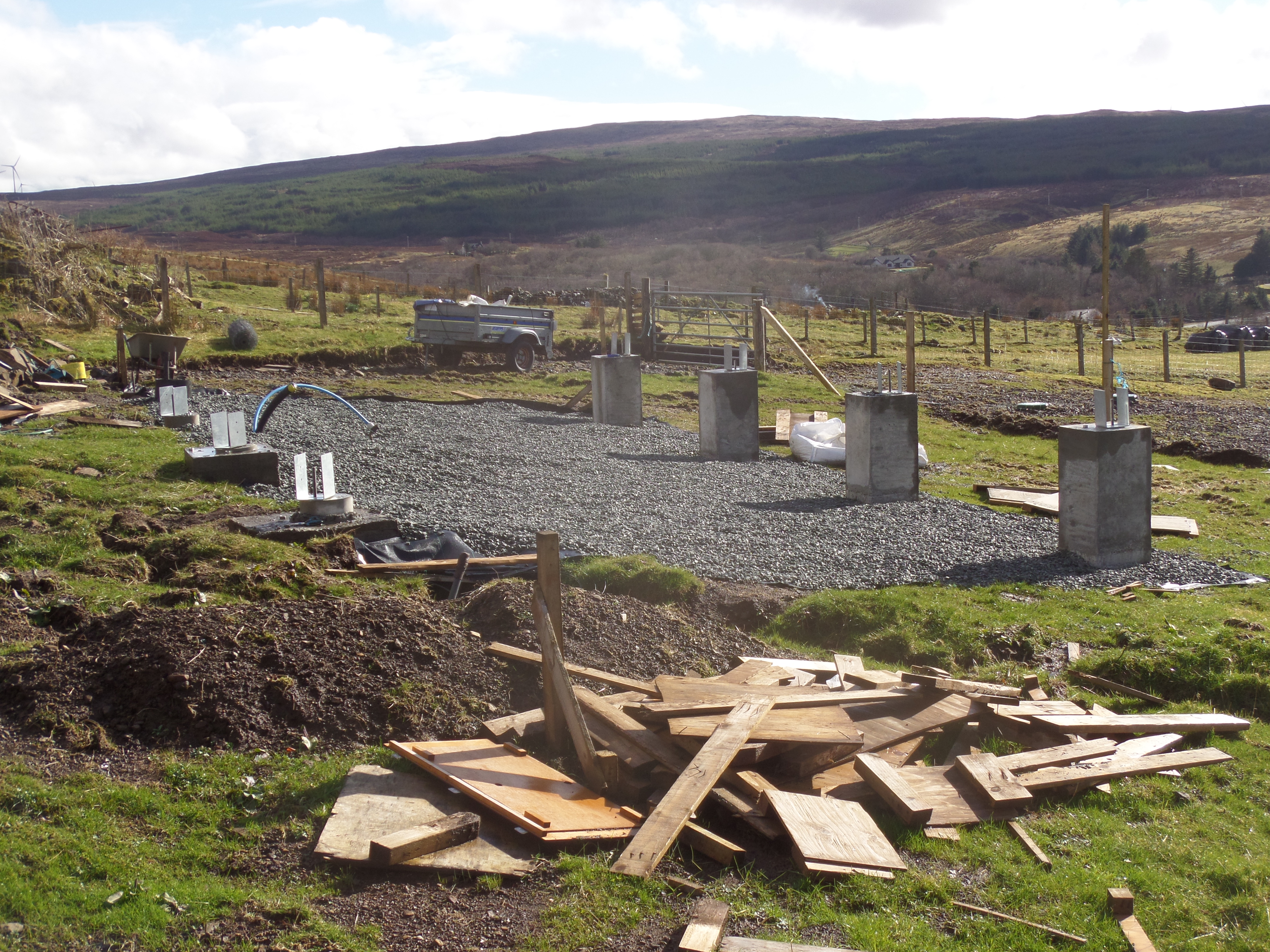

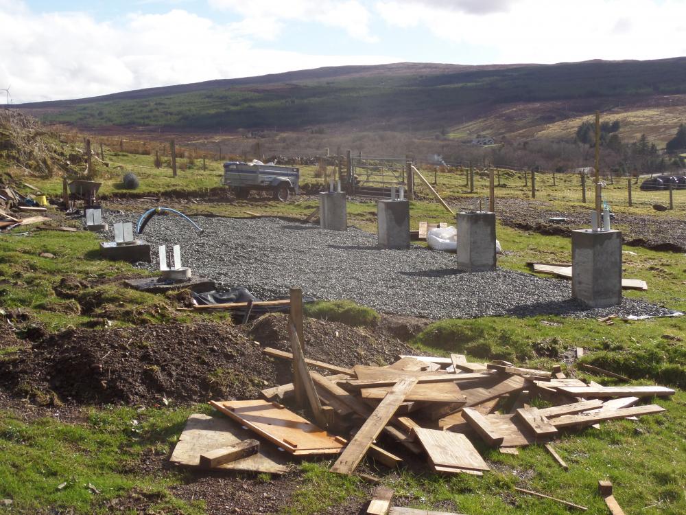

- footprint of house laid with membrane and chips
- concrete footings and piers poured

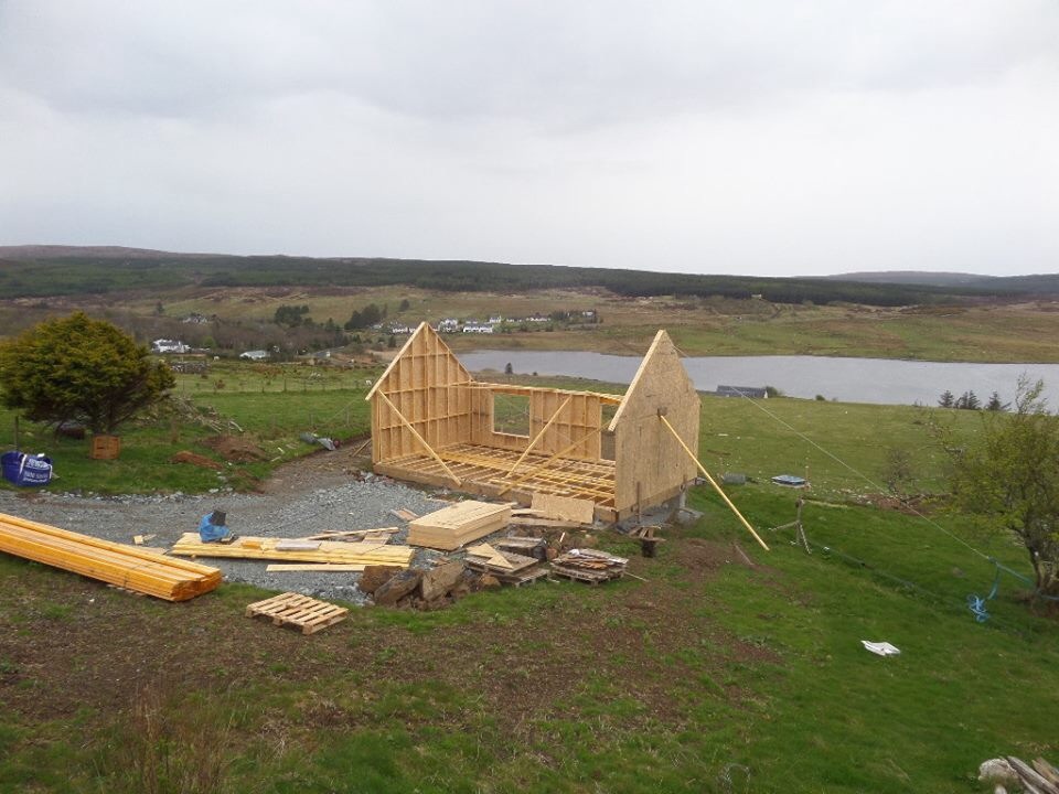

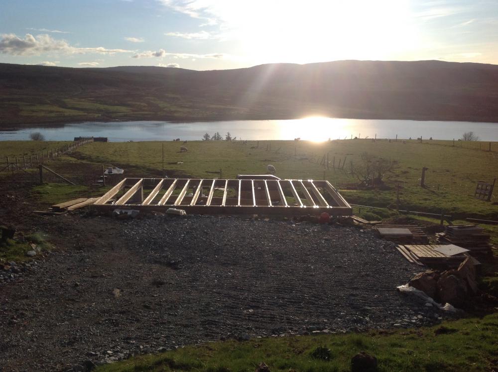

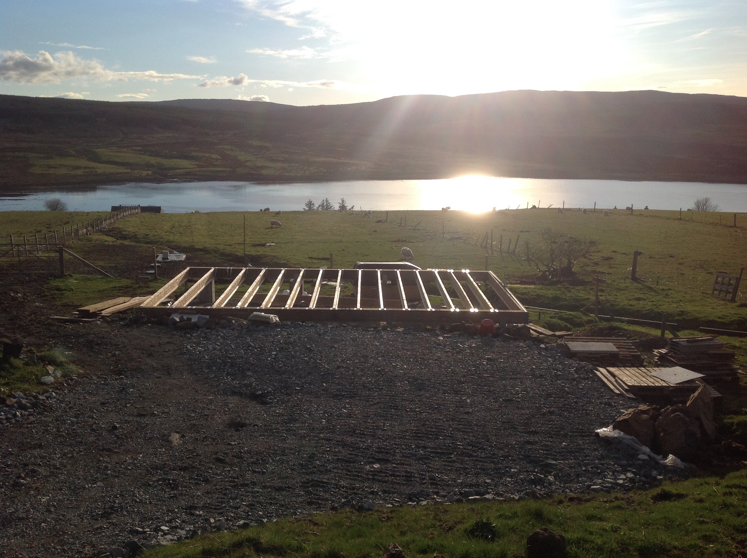

SAM_0654.JPGThis is the site ready for installation of the ring beam.
Ring beam and most of the joists installed
Frame starts going up

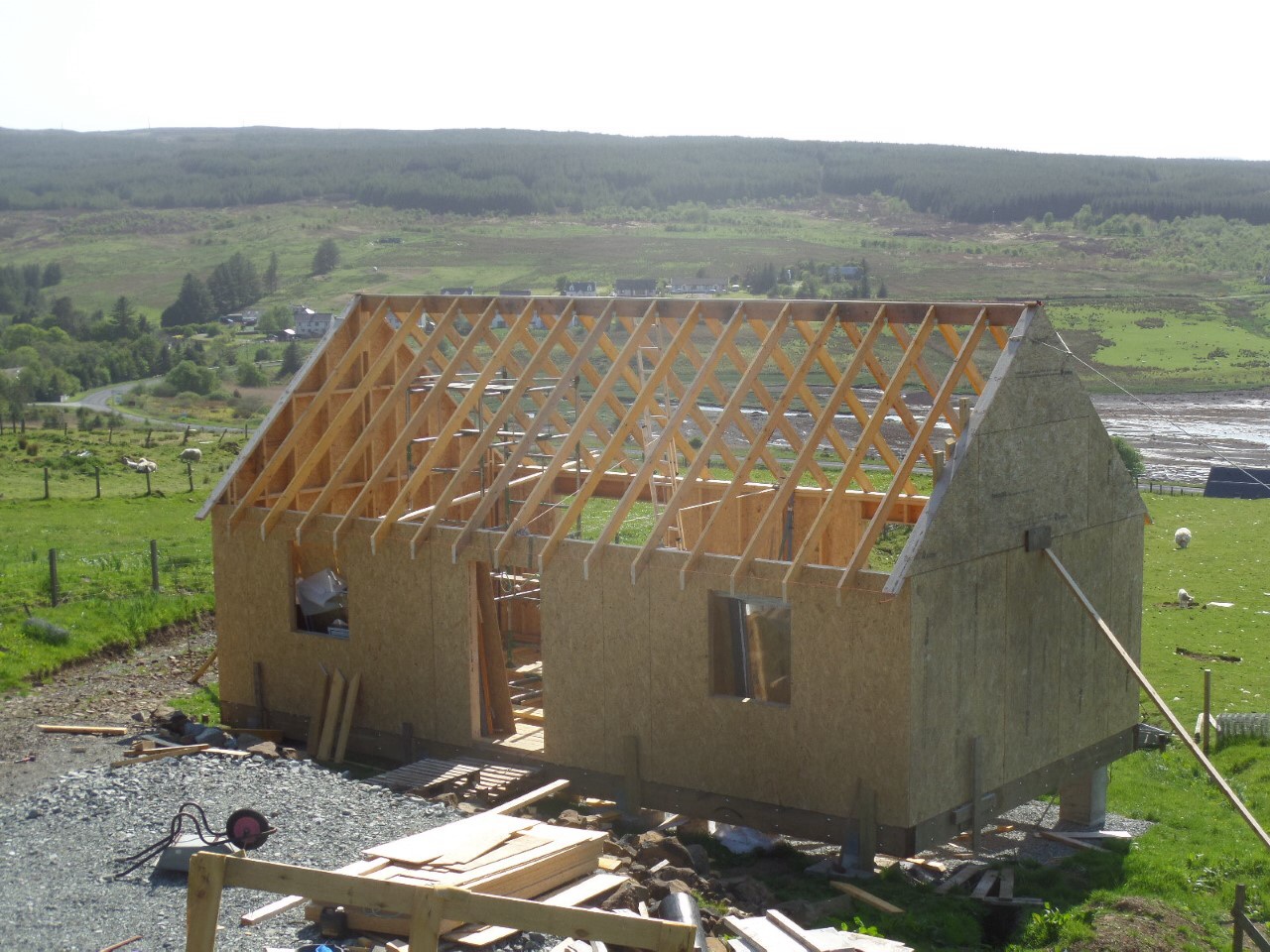

image.jpgRidge beam and rafters on- this is as far as I have got so far. It's been fun!

Thanks, it's been a lot of hard work but this stage is very satisfying.
I have decided to put the breather on the front and back walls first (tricky job by yourself in a 30mph wind!), then I will board the roof, then breather on the gables, then finally membrane on the roof. This sequence will work best in terms of working space and how the membranes overlap, I think.
I've been loaned a fairly basic scaffold tower (visible in picture above, inside the house) and am hoping that this plus the ladders will be sufficient. But if I find myself in a fankle I might well be looking for more/better scaffolding...
