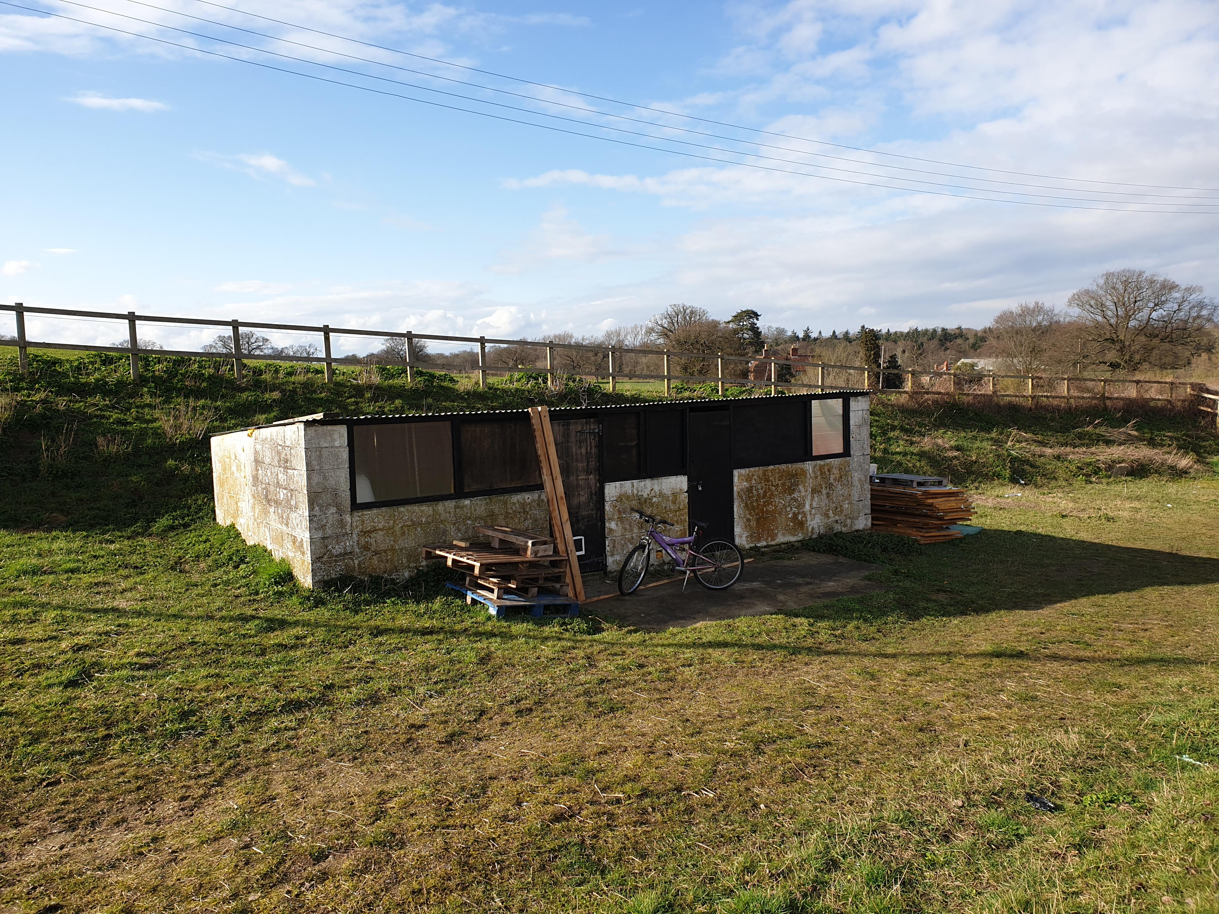

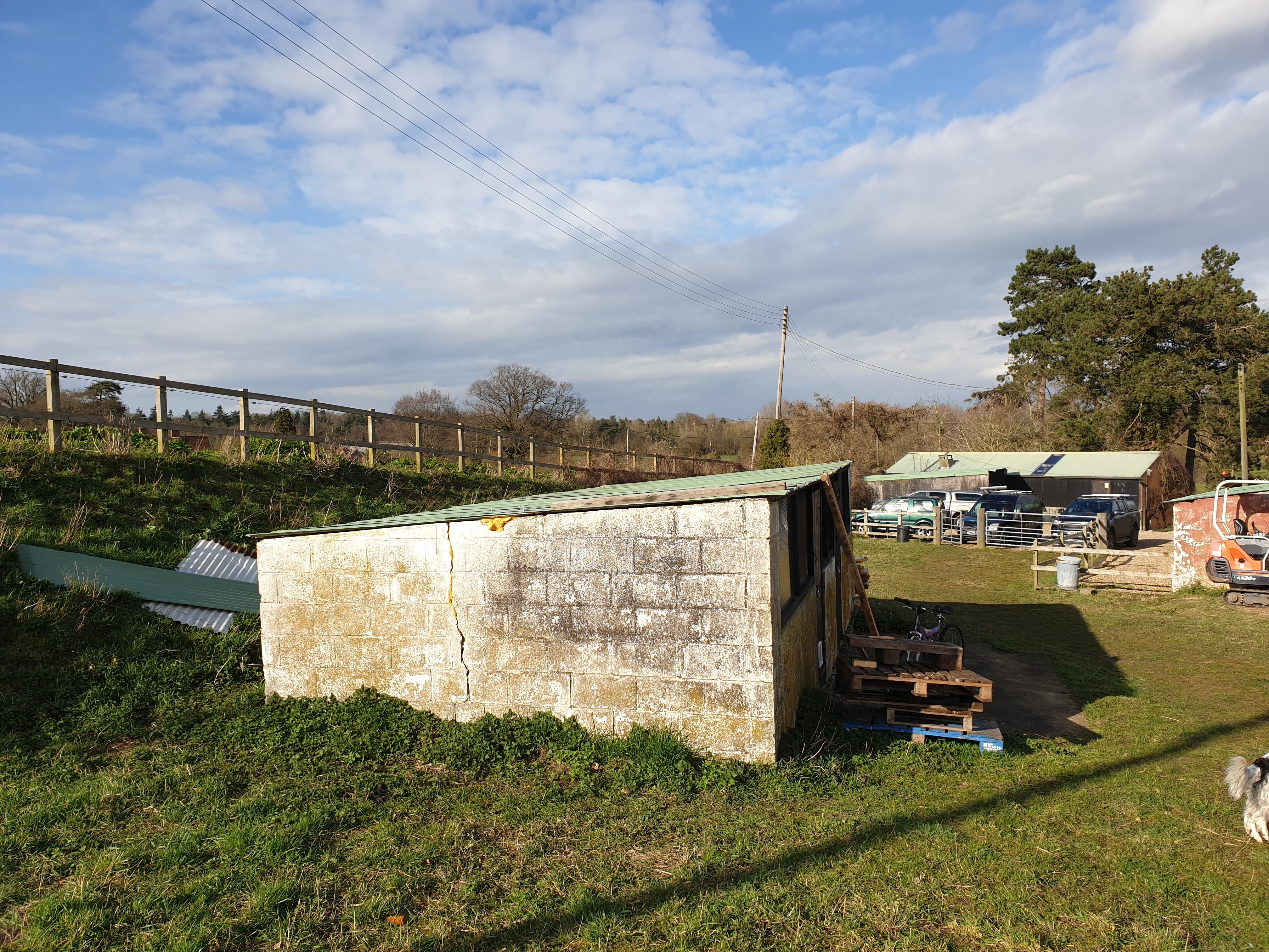

So, to store the things we really need I cleared out the old bike sheds, these had collapsed roofs which had to be removed, cut up and taken to the tip.
Then to provide us with storage space they had to be rebuilt.  The wood wasn't a problem, over the years we have knocked down lots of old sheds so we had lots of wood around which was good enough for this purpose.  We also had some roofing sheets from old sheds, enough for one of the bike sheds.
Even though the sheds suffer from subsidence they should be good enough for the duration of the build (we hope) when they can be knocked down.

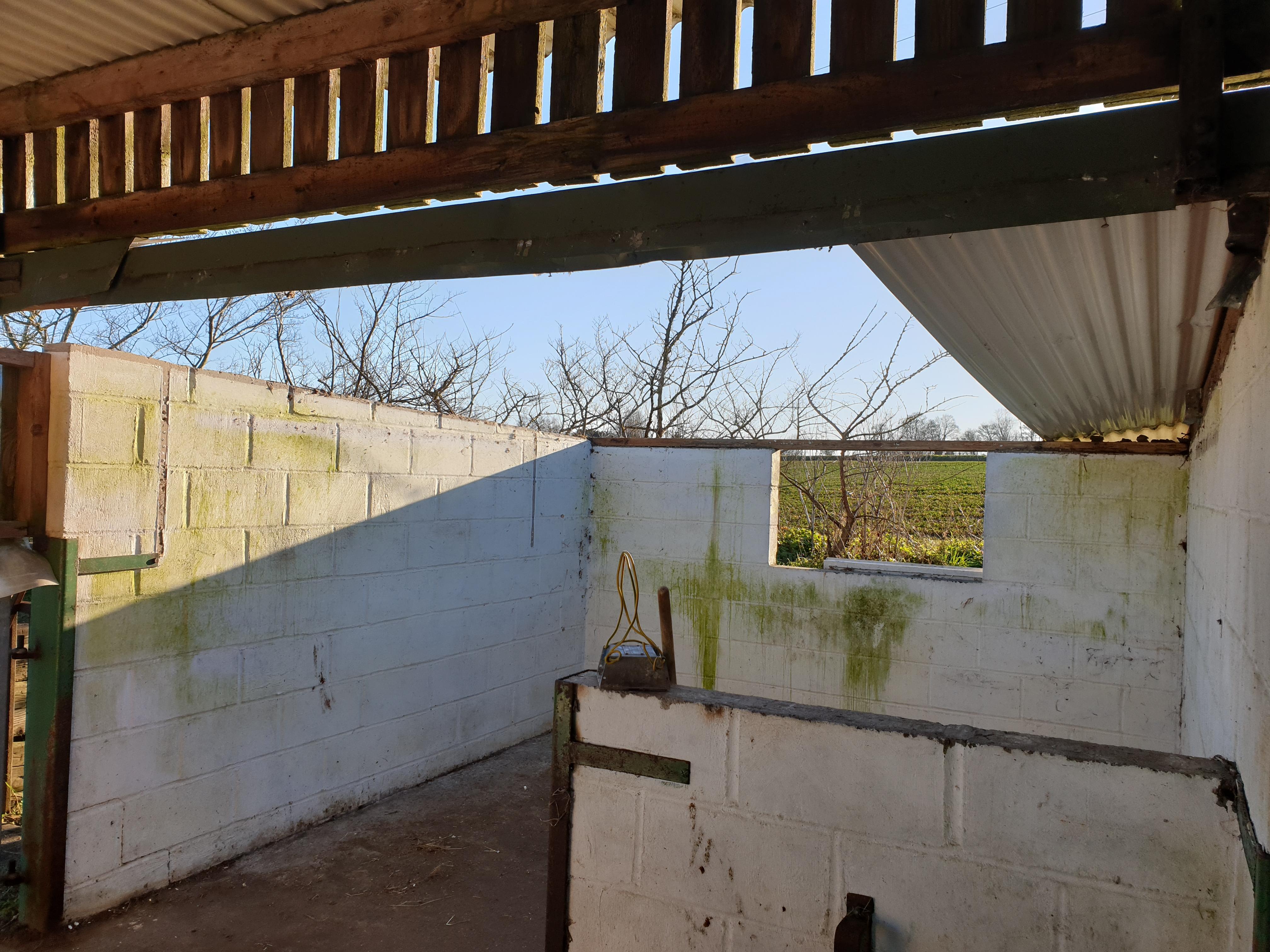

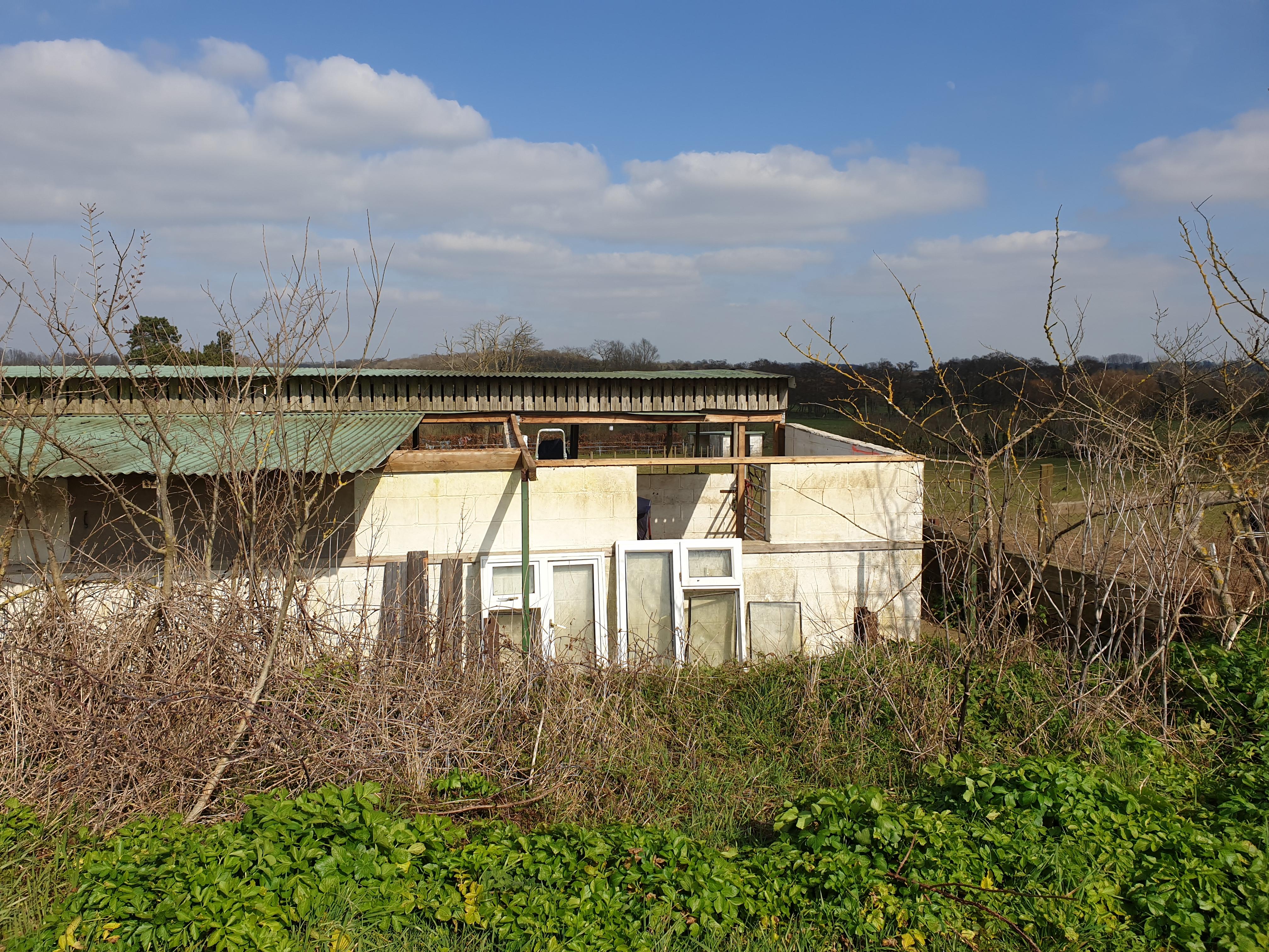

We then needed more sheets and some long lengths of wood to put a roof on the 2nd bike shed.  So, I had to take some off the roof of the barn to provide what we needed.
Not being a building expert in any way I was surprised at how much was involved in this, with battens, insulation, rafters, roofing sheets attached with lots and lots of long nails.
Also, after that more wood on the top of each wall, wall plates I guess, I thought that they would be one piece, but oh no, it was battens with 2 pieces in between, lots of mouse nests and more nails.

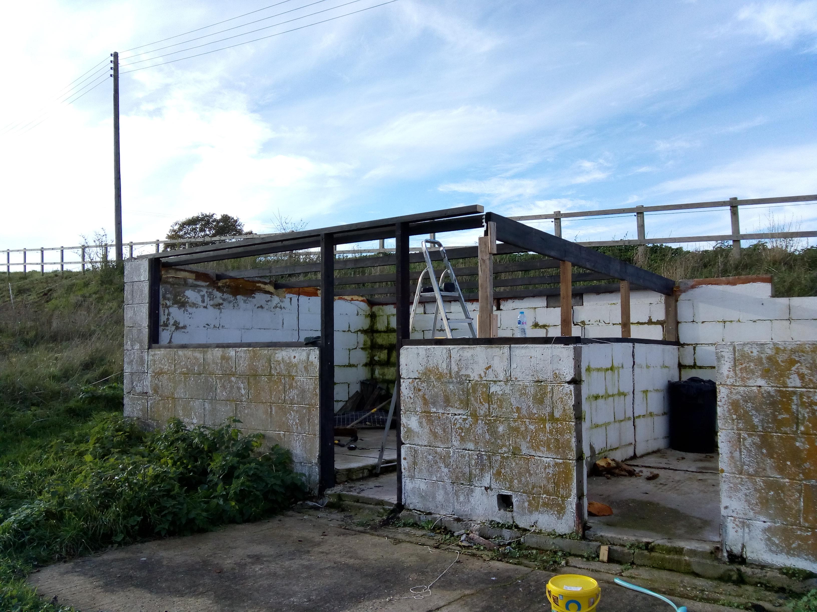

So, that's one shed, with the roof off, only another 6 to go and then the corridor.  Each roofing sheet is 20' plus and far too heavy for me to move so I remove the nails with hammer and crowbar and then get hubby to get the sheets off.
This week I've also removed the old gutters and what used to be wood holding them up.
It did make me wonder, this barn is about 50 years old and lots of the wood is completely rotten, so what protects timber framed houses.  I guess that they are just not exposed like this.
This side of the barn is south facing as well so gets lots of sun.
This lower roof that I'm removing at the moment will be raised to be the same height as the other part which along with digging out the floor will give us enough roof height at the lower end to pass muster.

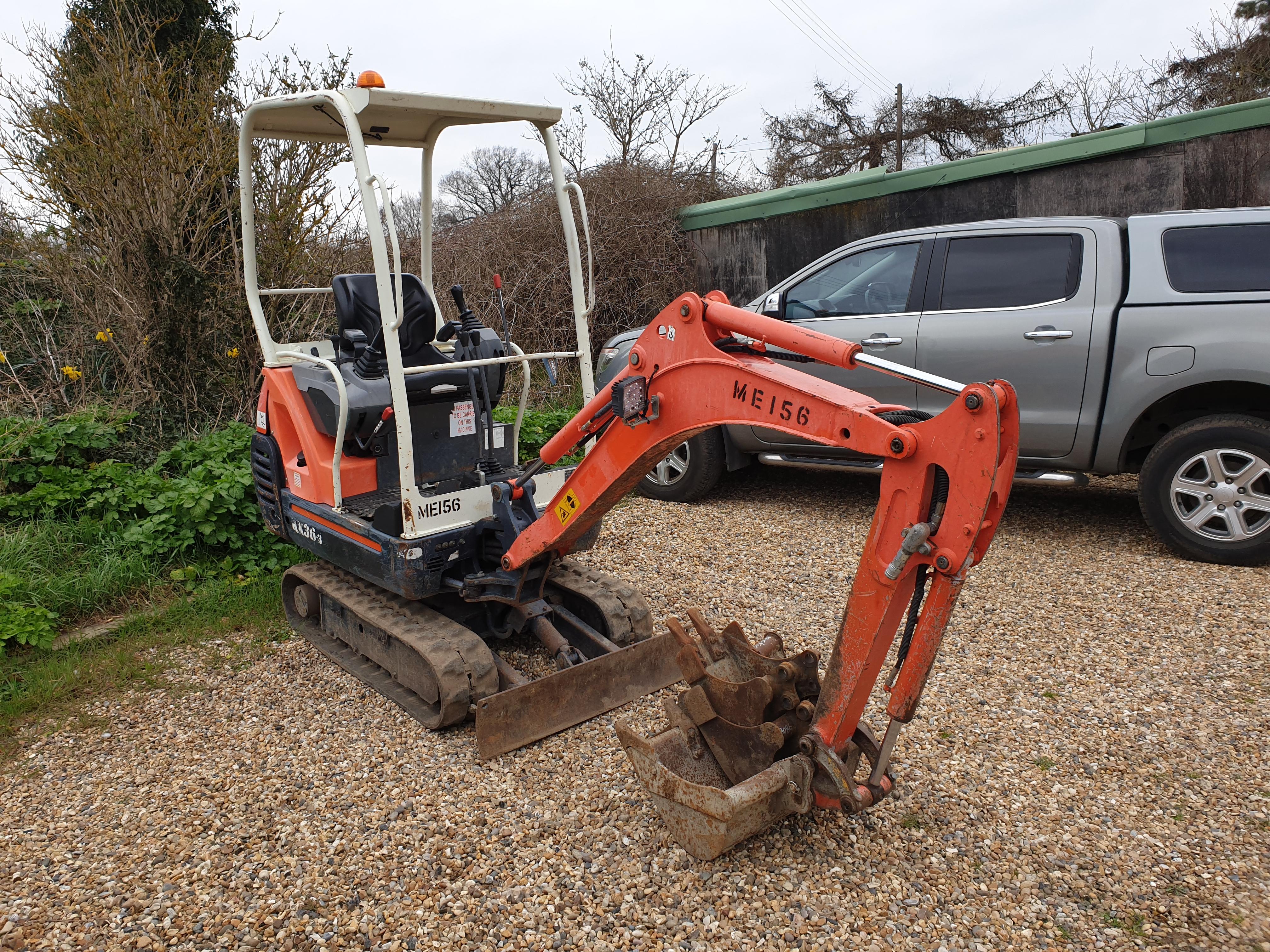

We also went shopping this month and spent a large chunk of our budget buying a digger, wacker plate, breaker, nail gun and some tiles.  All auction purchases at Cheffins plant sale in Ely.
We spent more on this than intended because of the VAT that we can't claim back, and will lose when we eventually sell it.
But, it's going to make our life so much easier.  The first task though is to dig out some huge troublesome brambles that have spread very quickly.  Good practice before we need to dig out the floor in the barn.  That will be done once I've finished removing the roof.

Good to see you making a start.  Make sure that digger is very well secured.  They are well sought after by certain light fingered types.
PeterW
Posted
Expand
Agree and putting a simple tracker such as one of the £20 GPS ones from Amazon is not a bad idea - they can go anywhere in the wiring under the plastic and work fine.
LSB
Posted
Expand
That's a good idea, we are going to store inside a shed, but even so if people see us using it they might decide to pay a night time visit.
With all the other farm stuff we have as well we could be in a lot of trouble if they take the whole lot.
LSB
Posted
Does anyone know re insurance, is the digger covered by the site insurance, which does cover tools, or do we need to get independent insurance for it.
TonyT
Posted
Expand
Best to discuss this with the insurance company...better to discuss now rather than argue later
PeterW
Posted
Diggers are classed as plant not tools - they get covered differently.
Also look at microdot security pens and systems - make it unsaleable to anyone else
LSB
Posted
thanks, I shall investigate that as well.
