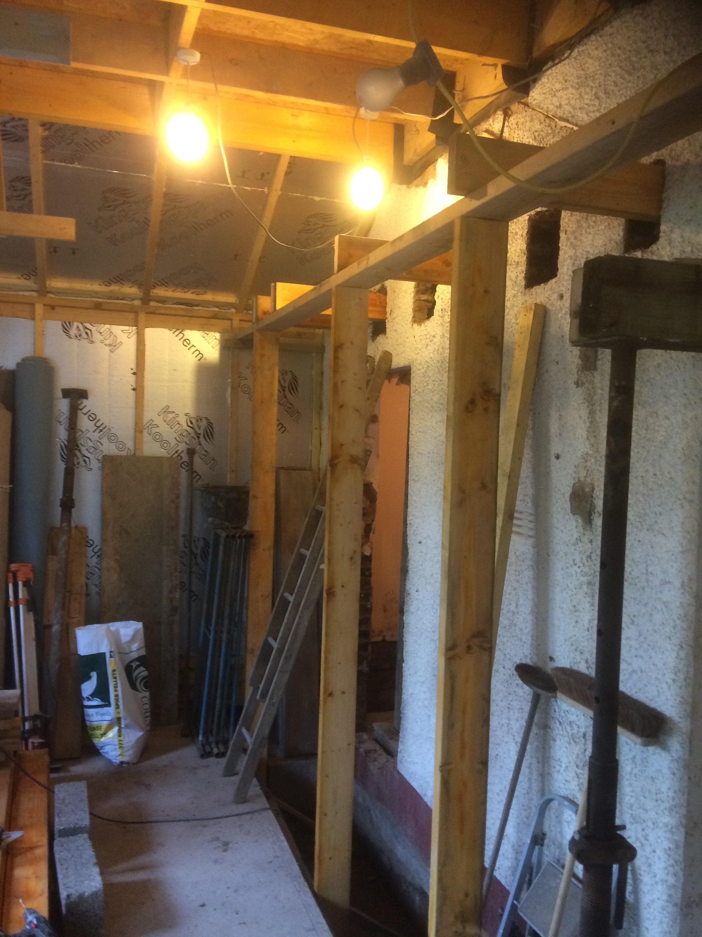

Photo 07 showing holes for the needles and the first few temporary works studs going in. The base of the studs are sitting on a sole plate fixed down to a temporary strip foundation. Part of the sub floor has been built up and concreted to provide a working platform.

In my case I have been dipping in and out of our project. I reckoned that I would need some 25 – 30 Acrow props for the temporary works which would take me about 4- 6 months as I was also mucking about with other bits of the build. To hire 25 props at £ 5.00 per week = £ 125 per week!
I could have bought the props but I would have needed to get rid of them after in my case, just gave up on that.  I have two or three old props that were used to help tighten up (pre load / stress) the timber propping.
The timbers 145 x 45 (grade C24) to form the needles studs, top and bottom sole cost ~ £350.00 ex vat plus a few screws (about 250 number  5 x 80 gold screws I think) to fix things together.
I knew that I could recycle the temporary studs to form a new floor we needed and that if I cut back the needles I could also use these to prevent the top steels from moving sideways. This is called simplistically “ lateral restraint”. Also, I used same needles to provide additional what is called “torsional”  restraint to the top beam ,  a slightly different effect, but is it to do with the fact that I used one beam with a top plate to support both the inner and out leaf of masonry which can be loaded in different ways at different times. These different loading patterns cause an uneven loading on the top of a single beam.. resulting in a twisting (torsional) effect. You can see more photos in post 01.

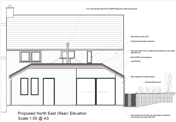

Fig A 01 showing proposed rear elevation.

Approximately 1.0 kN (kilo Newton) is ~ 100kg so 25kN/m is about 2.5 tonnes per metre run of wall. Thus if you put your needles at 600mm centres then each cluster of needles has to carry 0.6 x 25 = 15 kN (1.5 tonnes) and the studs supporting the needles at each end need to carry a vertical load of roughly 0.5 x 15 = 7.5 kN (0.75 tonnes).  These types of loadings are as about as much as you can “do” for this type of system. There are other ways but you need more height for timber needles.

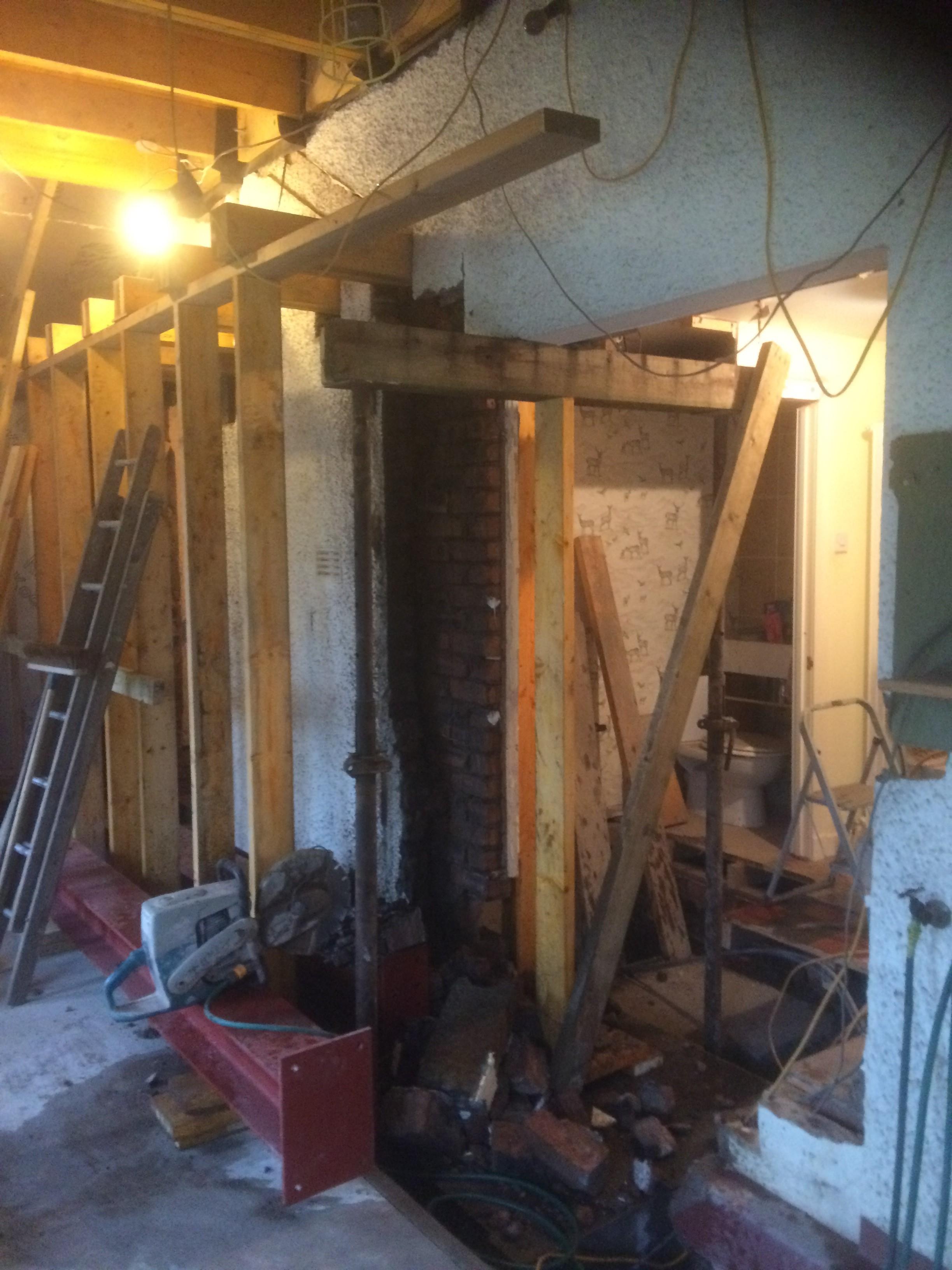

To make life a bit more difficult the window lintels on the first floor cause the load from the roof to be unevenly distributed so some needles need to carry more load than others. You can see from the photos that some needles are in pairs, some are a cluster of three.
In terms of the studs these needed doubling up in places and the whole lot horizontally braced at mid height with some diagonal bracing just to stiffen the whole lot up. While this sounds like a lot of work once you get going it’s actually quite quick.
This approach is a little different from using Acrow props. With Acrows you wind up the prop to preload the system so that the upwards force is approximately equal to load the wall you are taking away is carrying.
Aside,  If you are Acrow propping things then be careful not to over tighten the props as you can easily start to lift parts of the house accidentally!
Here, what I did was to use a combination of the spare props I had combined with timber wedges to pre stress the system, one set of needles at a time. The other thing is that over time the timber can shrink / creep a bit so I was careful to get the timber dry first and then monitor the system as I went along.
All sounds complicated but once you grasp the principles a lot of it is common sense and this is not a reinvention of the wheel. I know a few old joiners and brickies that still remember doing this when they were serving their time.

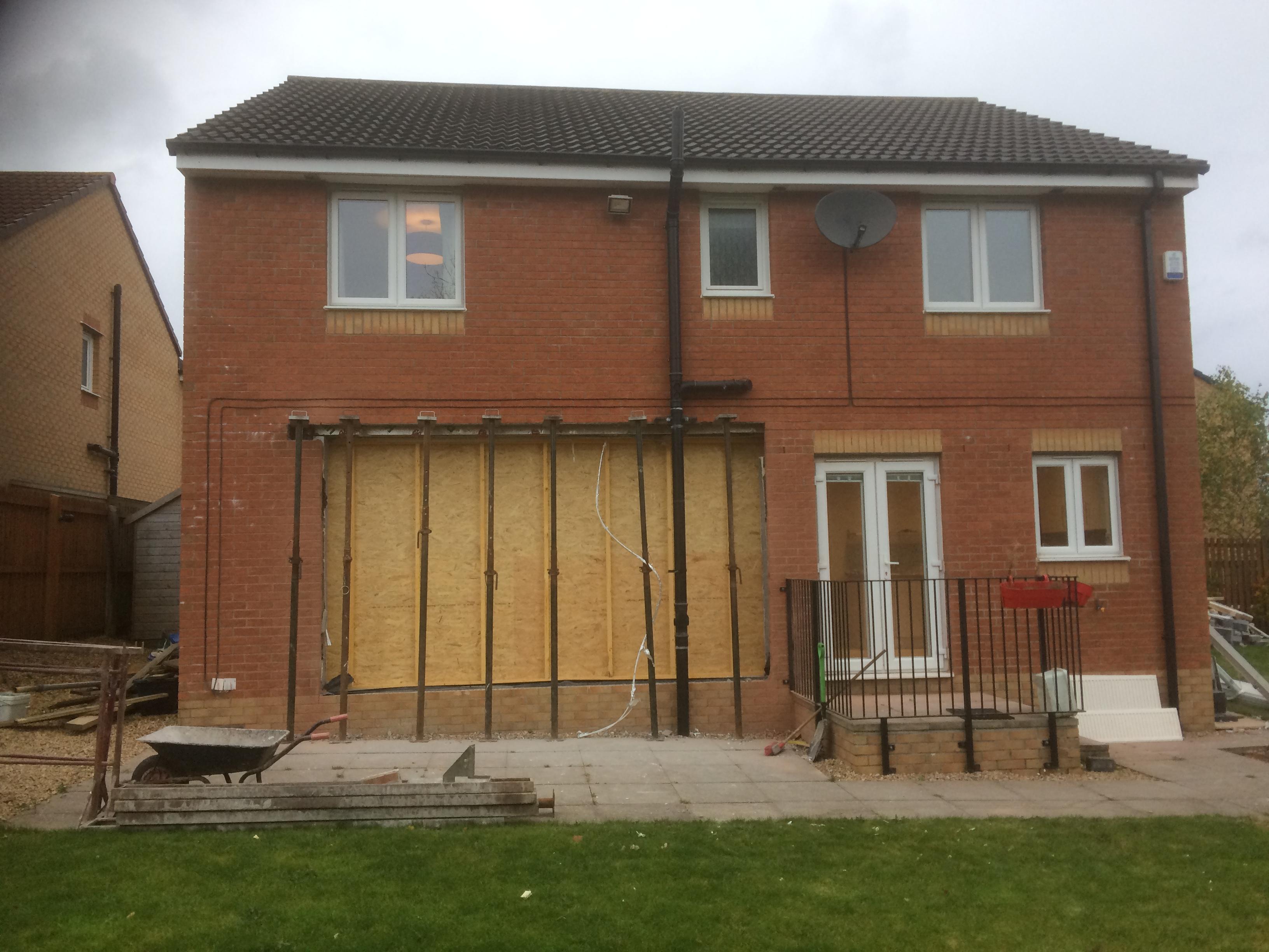

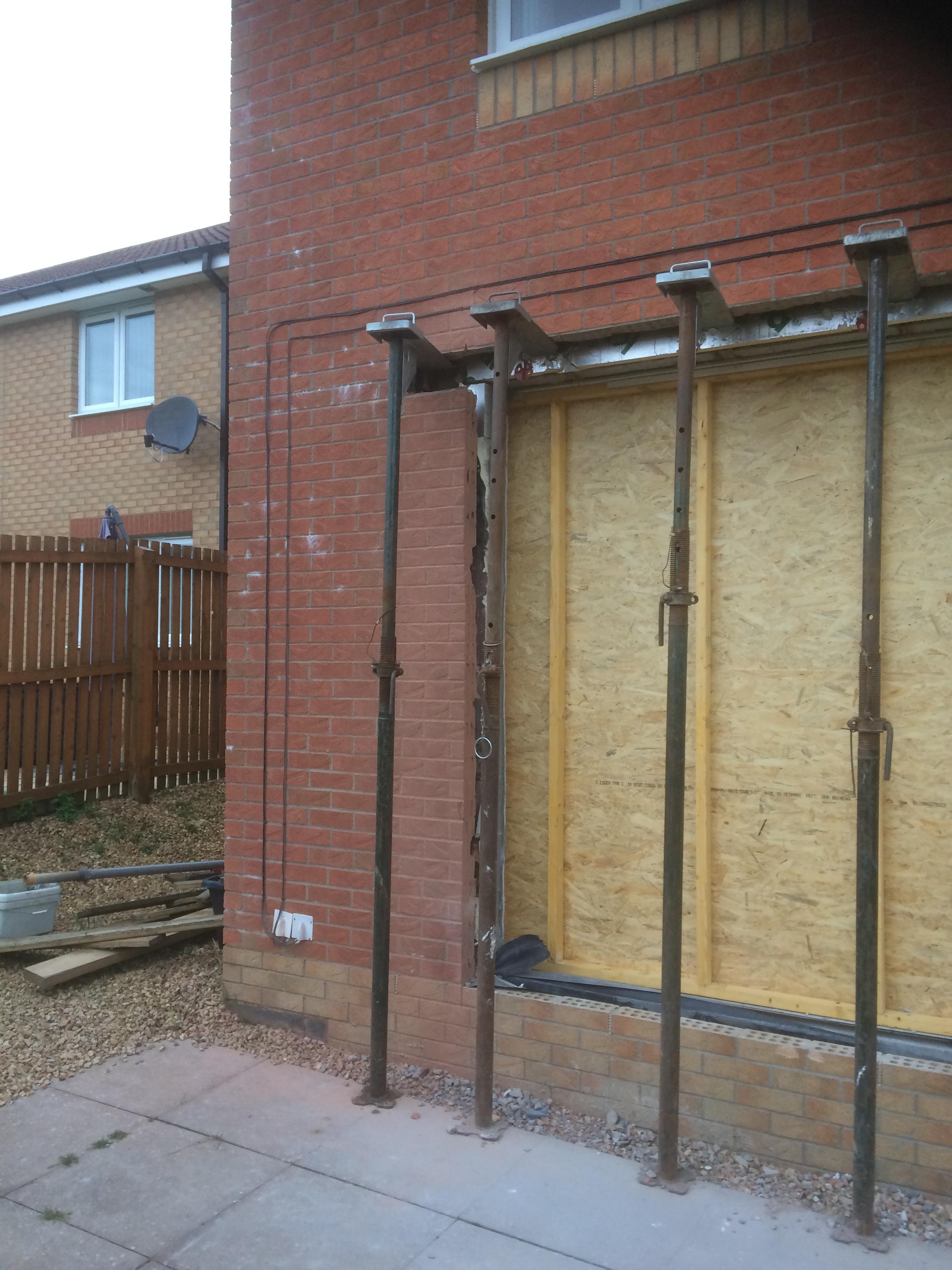

Below is a screen shot of part of a temporary propping design for a set of 4.0m bifold doors etc. There was another big chunk of the rear wall to come away at the same time which is not shown. The contractor here was stopped from working until remedial action was implemented.
image.png.2d3919bf2344e6faf9f41d0d6dbc569a.pngScreenshot propping.docx
Fig 02: The purple lines are the props and what is called the lacing / bracing system to stop sideways movement.
Work was stopped when this was discovered. Part of the contractor’s defence was that “he was insured”
Photo 08
Photo 09
A few points. The Contractor had not investigated the ground under the slab and the base of props can slide about. The site investigation had revealed this ground was very soft. Use of Strong Boy type supports at the head of the props.. these have a reduced load capacity and not suitable for the loads to be carried in this case. Props well out of plumb, no bracing.. further comments welcome.
On a finishing  note the timber propping scheme may look a bit rough but it was designed and executed with no unexpected movement.  If this approach may suit you then as always check with or be a competent person.

There were not many notes on the drawing, so the contractor should have read the one that said props no more than 25mm out of plumb!
How is the cross bracing normally done?  Scaffold poles?

@Mr PunterYes usually with standard scaffold poles which have an outside diameter of  ~48.3mm.
The top part of the prop (inner tube) is the same diameter as the scaffold tube so you can make 90 degree connections with a standard double coupler, angled (diagonal bracing) connections with a standard swivel coupler. The outer tube of the prop has a diameter of ~60.3mm so here you use reduction couplers.
