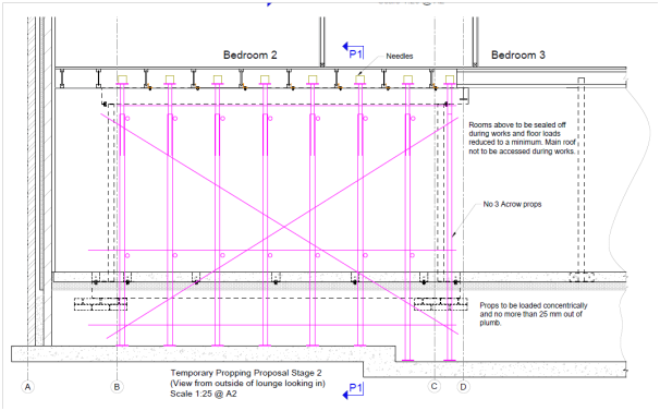

Below is a screen shot of part of a temporary propping design for a set of 4.0m bifold doors etc. There was another big chunk of the rear wall to come away at the same time which is not shown. The contractor here was stopped from working until remedial action was implemented.
image.png.2d3919bf2344e6faf9f41d0d6dbc569a.pngScreenshot propping.docx
Fig 02: The purple lines are the props and what is called the lacing / bracing system to stop sideways movement.
Work was stopped when this was discovered. Part of the contractor’s defence was that “he was insured”
Photo 08
Photo 09
A few points. The Contractor had not investigated the ground under the slab and the base of props can slide about. The site investigation had revealed this ground was very soft. Use of Strong Boy type supports at the head of the props.. these have a reduced load capacity and not suitable for the loads to be carried in this case. Props well out of plumb, no bracing.. further comments welcome.
On a finishing  note the timber propping scheme may look a bit rough but it was designed and executed with no unexpected movement.  If this approach may suit you then as always check with or be a competent person.

There were not many notes on the drawing, so the contractor should have read the one that said props no more than 25mm out of plumb!
How is the cross bracing normally done?  Scaffold poles?

@Mr PunterYes usually with standard scaffold poles which have an outside diameter of  ~48.3mm.
The top part of the prop (inner tube) is the same diameter as the scaffold tube so you can make 90 degree connections with a standard double coupler, angled (diagonal bracing) connections with a standard swivel coupler. The outer tube of the prop has a diameter of ~60.3mm so here you use reduction couplers.
