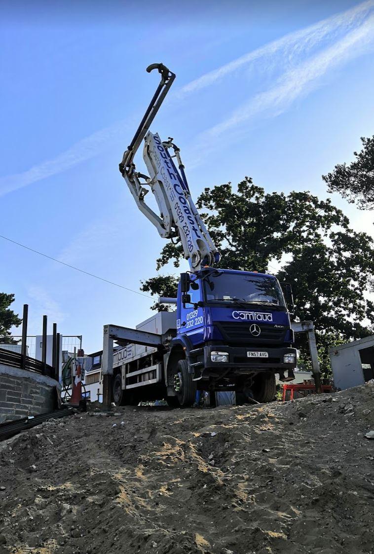

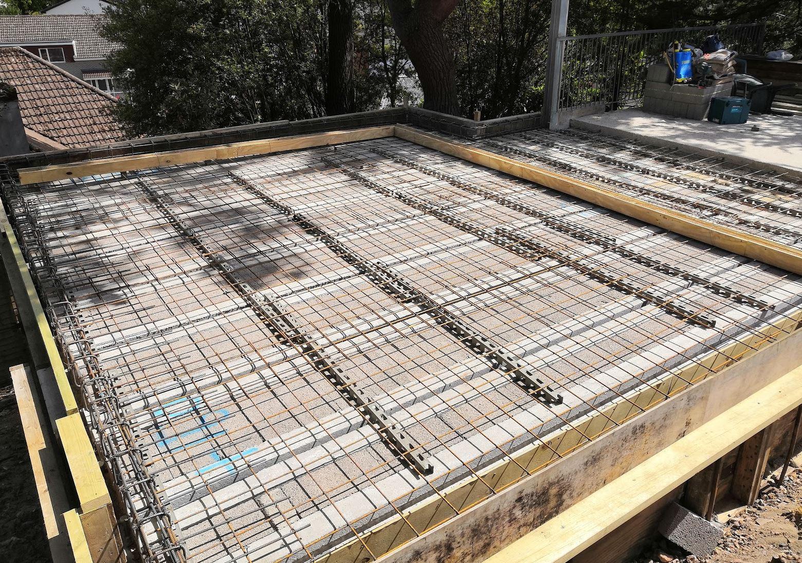

The interesting plot has 2 downhill aspects ? One is the main garden and the other is to the left/front of the house where we will have an elevated parking area - there is an earlier entry describing the build of the metal structure and helical piles etc. This pic is after the beam & block & rebar just before the concrete went in.

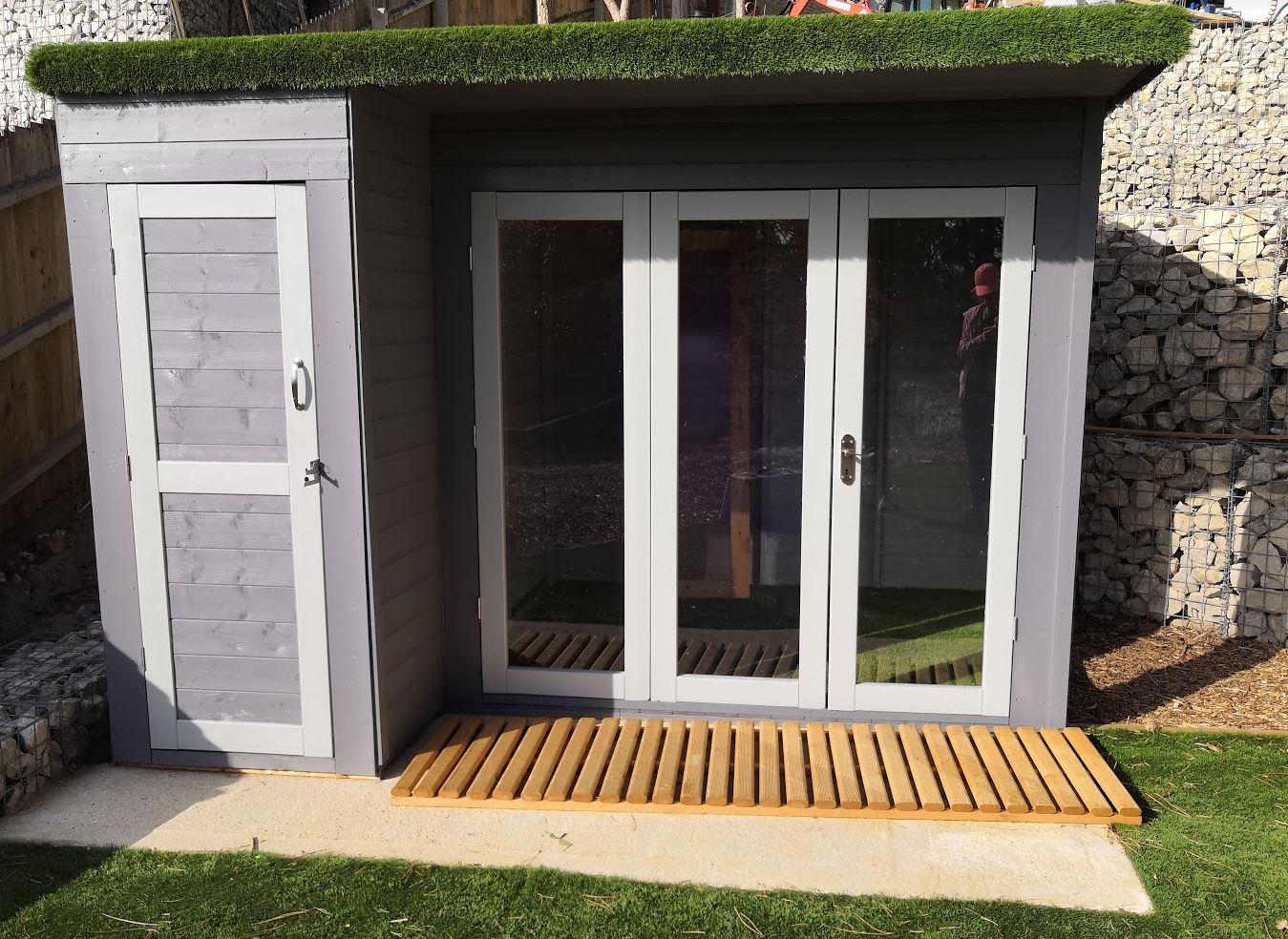

Back in the garden w finished the lawn and built a shed. About a day to build and same again to paint, sticking some lawn on the roof means it will hopefully blend in well with the garden when seen from the house (& our neighbours!)

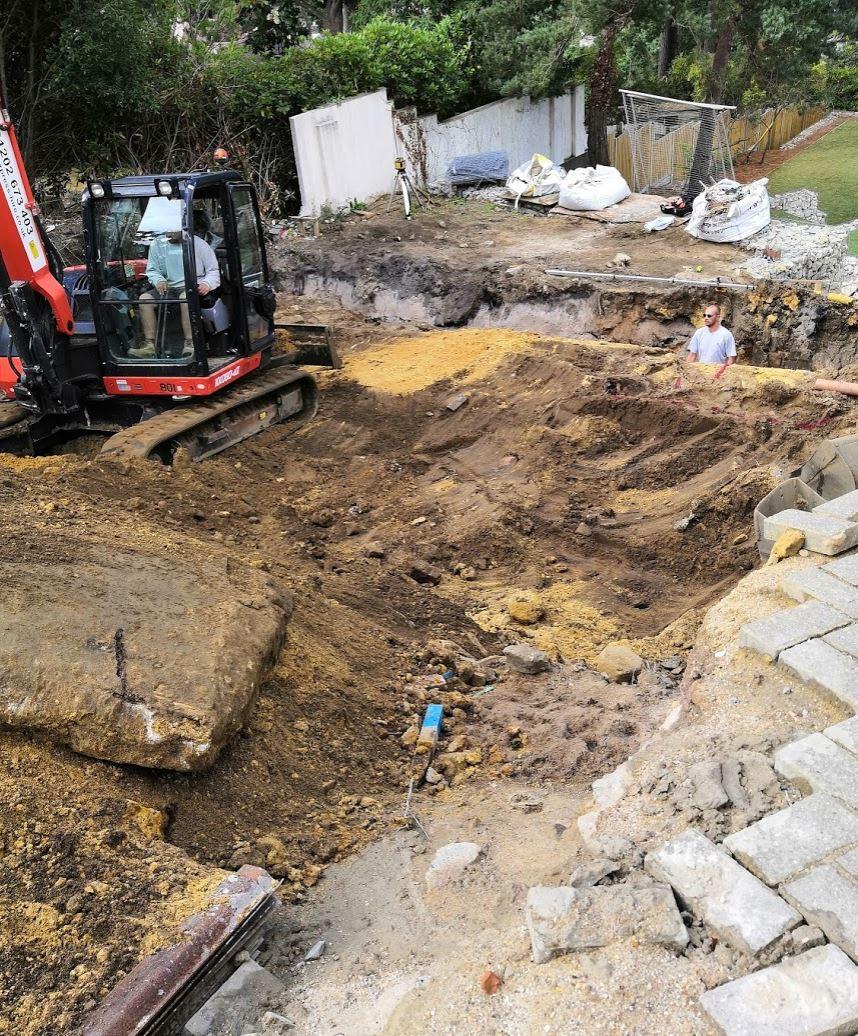

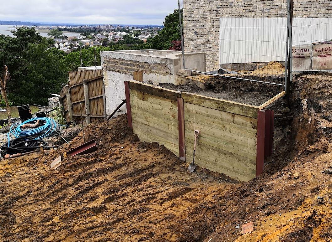

On our boundary we hoped the ground would be stable enough to leave exposed for a while but unfortunately not as it was all made ground and not the lovely compacted sand we expected! So a little extra bit of work for a retaining king post wall - steels 6m in the ground. The excavated level needed to go down about a meter from what is shown here

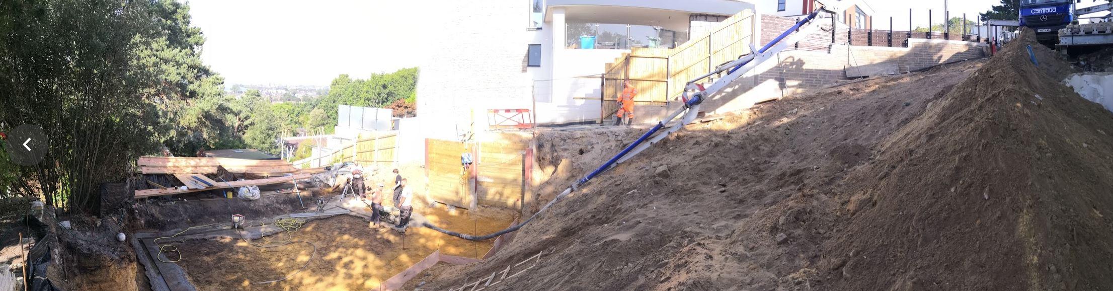

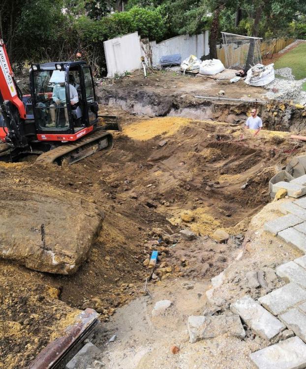

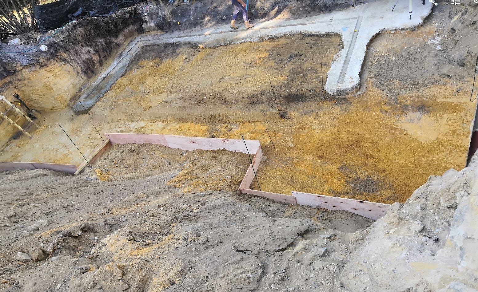

Moving on up we could finally start in the basement floor excavations - here is the 1.5m deep trench getting dug. The basement is a reinforced concrete raft 300mm across the centre with edge thickening to 450 and a LOT of rebar. Next pic is the deep trench filled and ground almost ready for a concrete blinding layer.
We had a beautiful concrete pouring day!

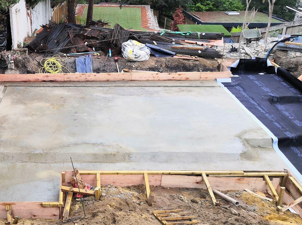

Blinding layer poured no problem - you can also see in that pic some of the 10T of rebar for the basement floor and walls + the start of the waterproof membrane install.
