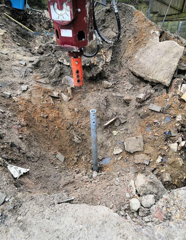

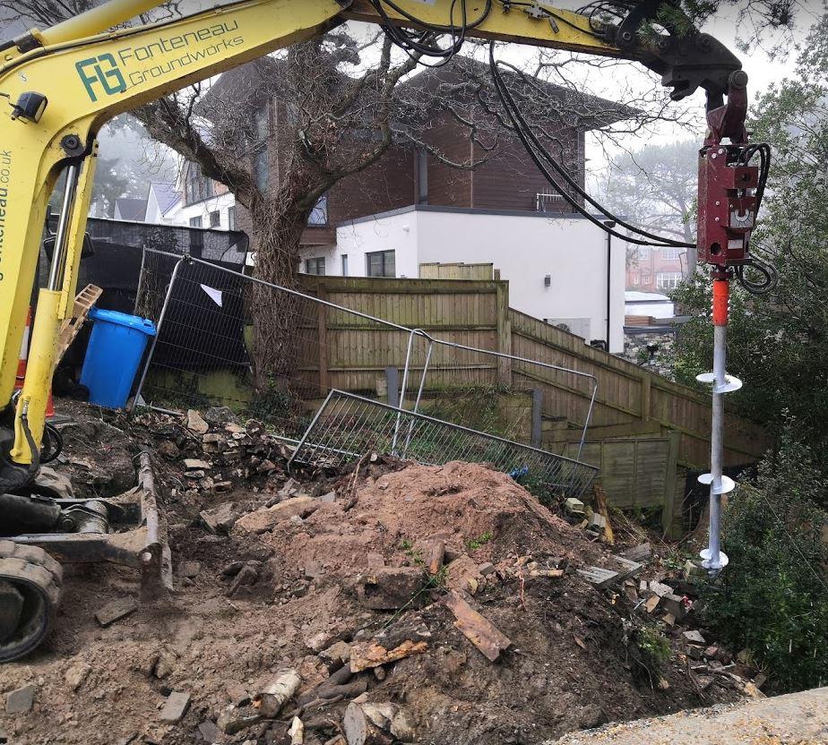

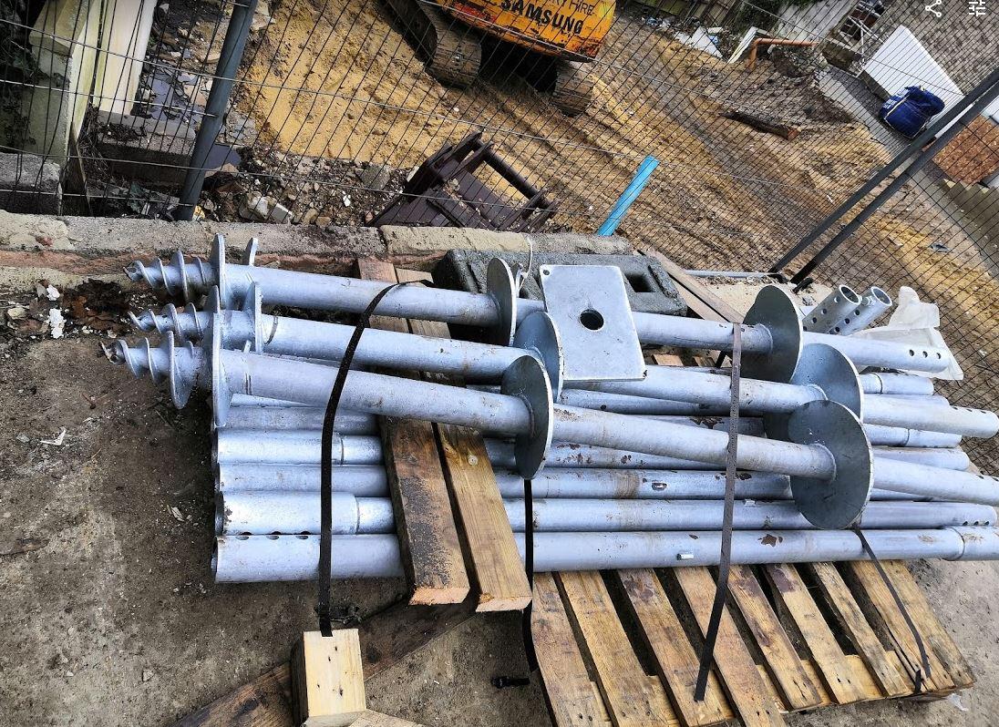

As our house is on a steep hill and limited space for materials etc up top, one of the first things after demolition is to build out the new driveway. This runs out across a slope and near some trees so the best option seemed to be screw piles. After much research and calculation (is it cheaper to manage the separate parts of this vs getting a contractor for the whole job) I went ahead this week. By having an excavator on-site with the ground workers (currently building garden walls etc) it saved hiring one in so total cost for the piles/ steel structure + the beam and block + the concrete top should come in about 60% of the quote received from a contractor for the whole job.
Piles were delivered on a pallet 5 piles at 2m long each + 2 x 2m extensions for each should they be needed + the excavator attachment with torque readout.
No dramas - all installed in half a day with each pile OK for a 375kN loading. Didn't need 5 of the pile extensions as hit the torque needed at 2.5 to 3.5m so that's some cash back ?
Next bit is tomorrow when I have the steel fabricator out to measure/design - all being well the frame should be in place in 2 weeks and a week later all ready to use.

Note that the piles will be cut at ground level and flat plates on a socket fitted on top. All steels galvanised and rock tips used - ground here is compacted sand/sandstone.

Looks a challenging site, but a lovely one once you have finished.
I wondered where you sourced the screw piles?  When I looked at them they were prohibitively expensive versus driven piles - typically twice the cost.
Link to comment
ABC Anchors, dealt with Megg who was mega helpful. Quick supply and can provide on site support if needed, which I opted for as we used our own digger.
Link to comment
14 minutes ago, Mr Punter said:
@Adam2 Is it the case that these will only be suitable for the driveway or are they going to be used for the house as well?
Yes just for the driveway, house will be in a concrete raft or 2.
