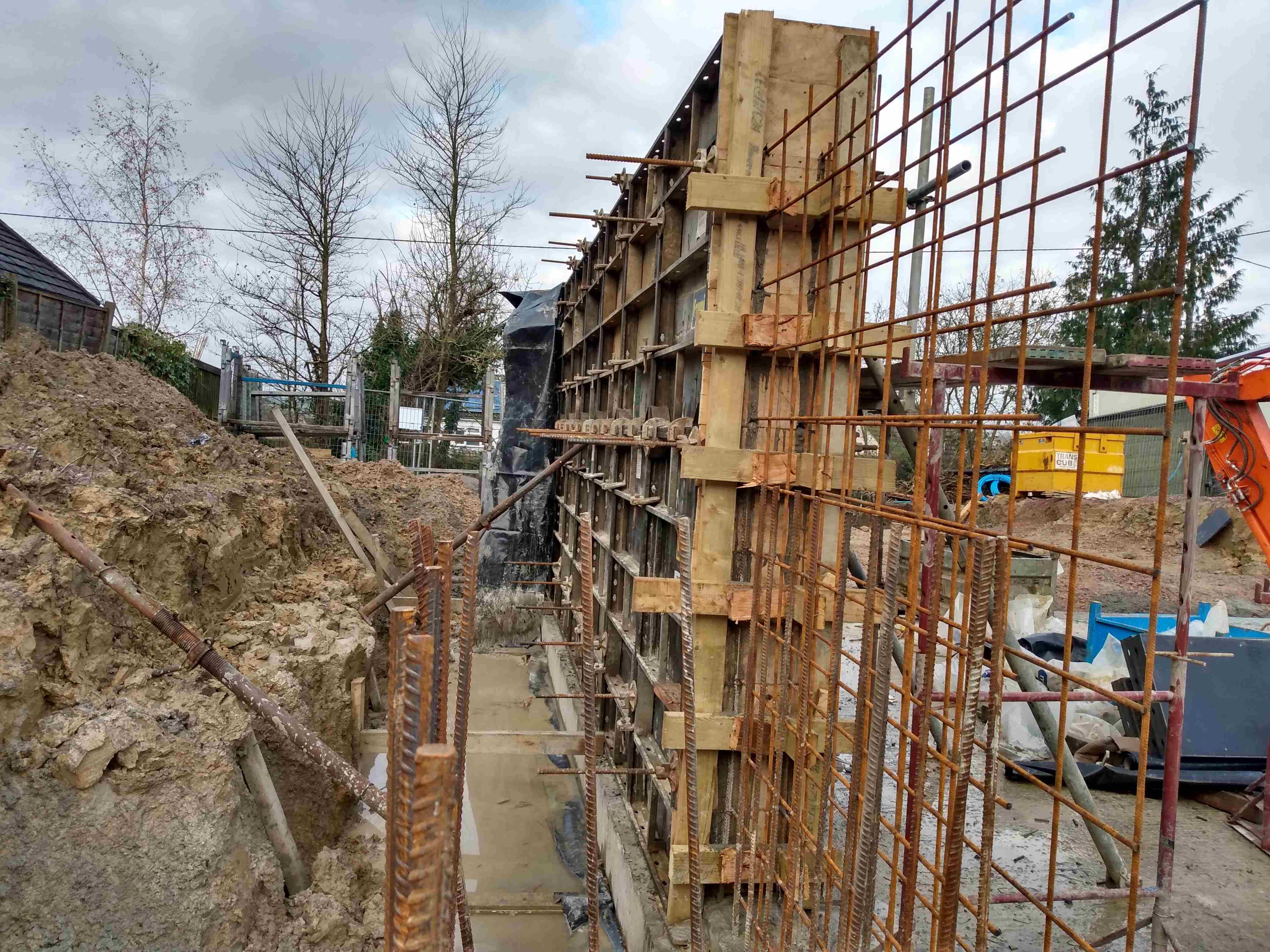

As you can see in the video this week they built up the shuttering in layers; first the outside, then the steel in the middle of the sandwich and finally the internal shutter.

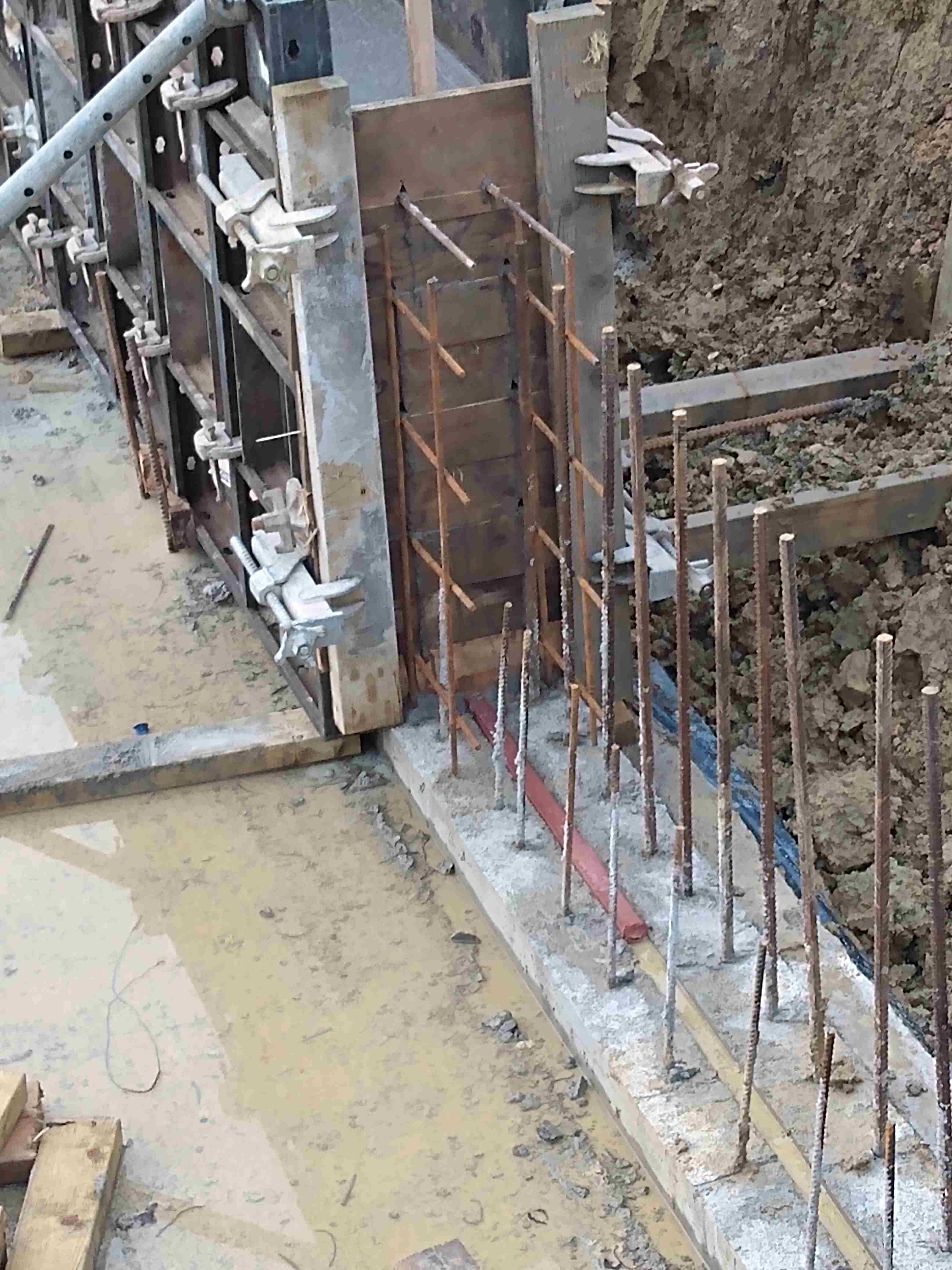

Also along the bottom they cleaned out the kicker and laid in a waterbar / waterstop (that brown bar in one of the photos) in a pre-formed channel, this forms a seal and prevents any water coming through the joint between the walls and the floor.

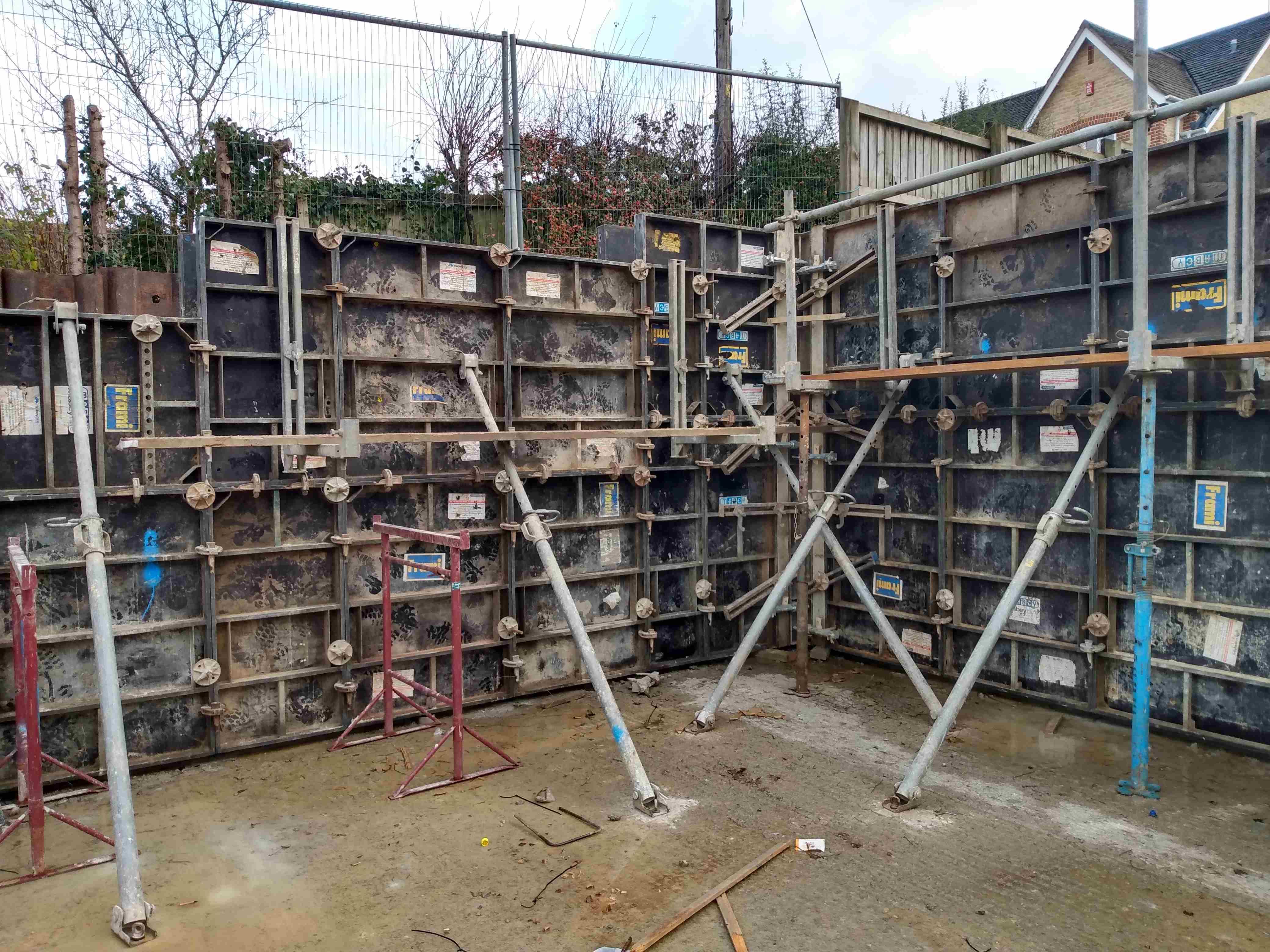

They bolt the two halves of the shuttering together with steel threaded bars inside a foam sleeve so that they can get the right thickness and hold the shuttering against the weight of wet concrete. The steel bars come out when they strike the shuttering and they waterproof the holes. IMG_20191130_112653548_HDR.thumb.jpg.8f540e5b086cedefdaa7d148f47be002.jpg

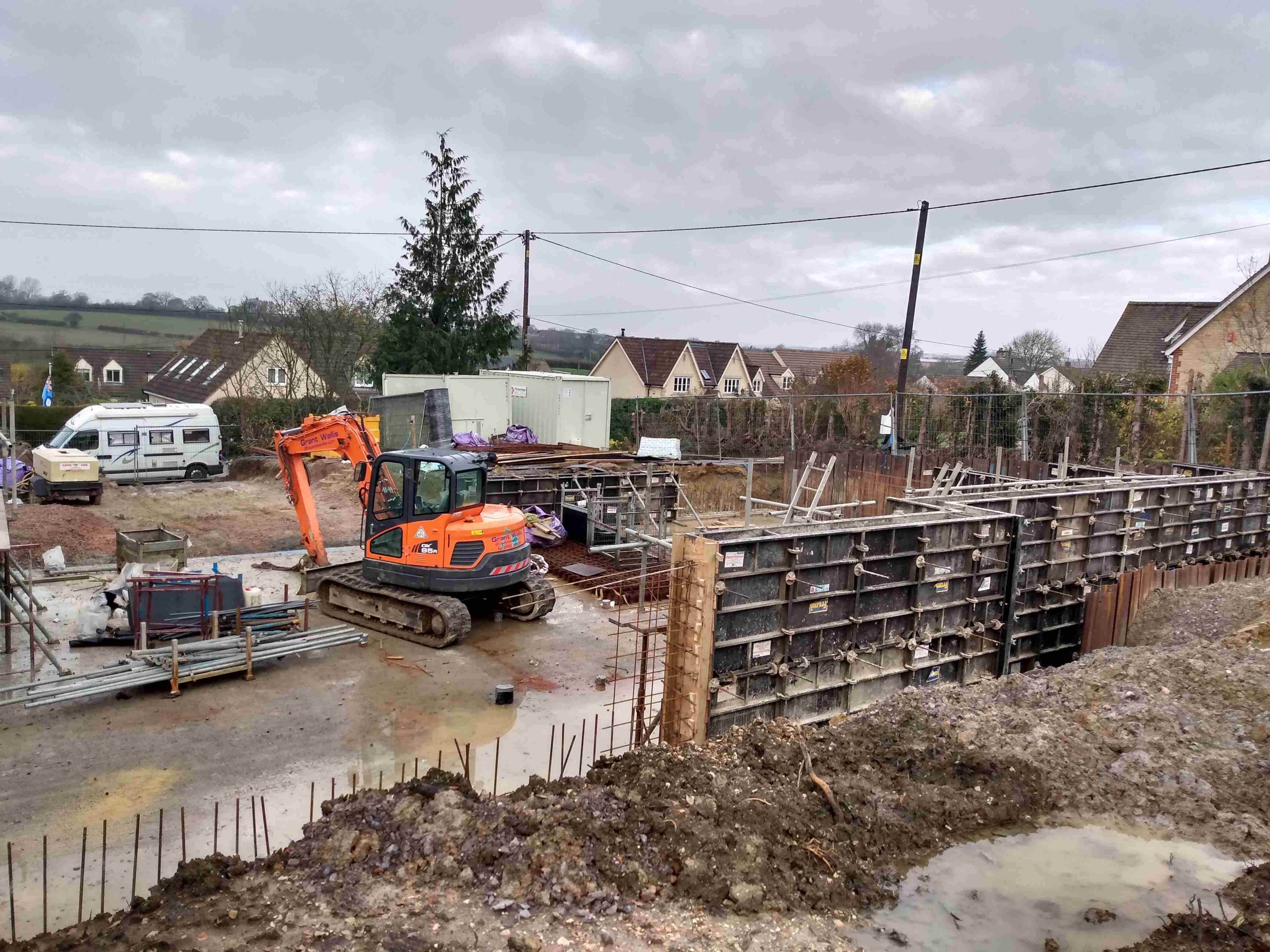

As you can see they didn't pour all the walls in one go but built alternating sections and will do the infill next, I think this is partly down to cost  of shuttering hire, and partly down to the sheer weight of concrete. The steel shuttering is really solid and well braced so there is no risk of collapse or burst and wet concrete spilling out everywhere like you sometimes see on GD's.
It was a bit of a wet week but they pushed on because the waterproof concrete and pump was booked for Friday, and they had extra manpower on site as my contractors brought in a couple of guys from the shuttering hire company who really do know how to put up shuttering fast! Sometimes it pays to get in the experts who do just one job really well. I had an interesting discussion that groundworks like this is often seen as a pure manual labour job rather than a skilled trade like sparks, brickies or chippies. In fact, at the level our guys work at, it is really a highly skilled trade and they are working to really fine detail and tolerance, plus you only ever get one shot at poured concrete! We have nothing but admiration for them - they are doing an amazing job in some pretty dreadful weather.

We also went with shuttered concrete - out team did all the steel work first then built the shuttering, they explained that the concrete needs to go off for a good few days before new concrete can be cast against it so we had a similar 'staggered' wall pour with 1m gaps between them which were poured last. You should have vertical water bar in these sections also.
Is the water bar channel full of water? Our guys were made to dry it out with a blow torch before using a mastic to hold the waterbar in place (Sika products) the rep, who issued the warranty, even came out to check this and they sent him photos every day from site.
They also used nifty expanding rubber plugs to seal the bracing holes, effectively a rubber bung on a thread that is screwed in to compress and expand the bung. Then cement to seal the hole.
