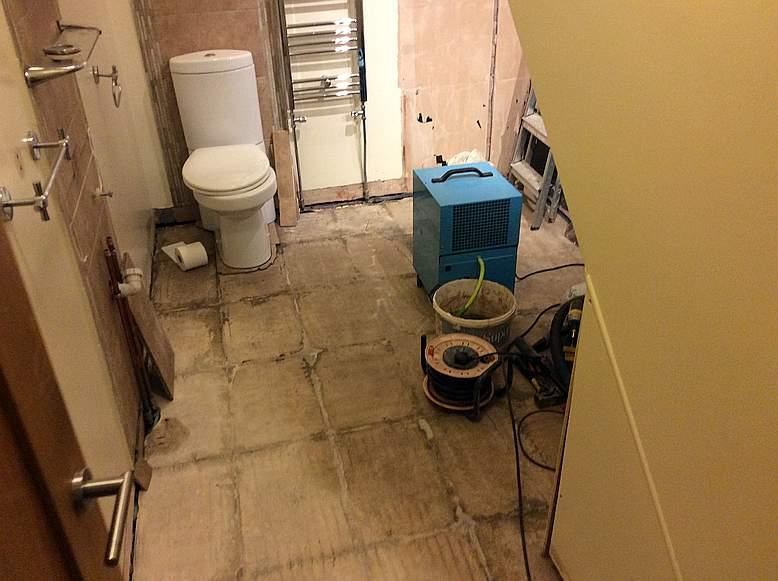

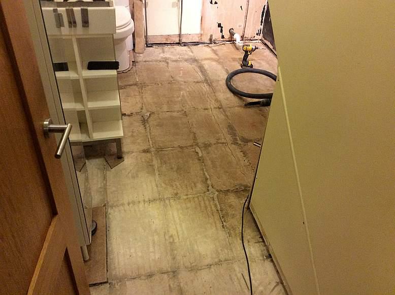

Damp patch in screed caused by plug-disconnection. And secondly, a huge crack in the sand-cement screed - caused we think by expansion-contraction as the ufh cycles. Fibres, Fibres, Fibres !
Davina the Dehumidifier doing her thing.

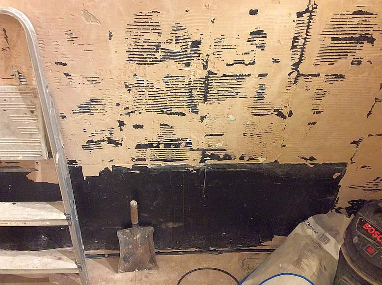

Thirdly, for some reason the chap had painted the wall behind the bath with some kind of water-impervious gloop, which guarantees that the tiles were not very well attached as the strength is that of the weakest layer.

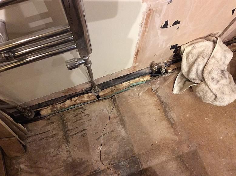

And fourthly, there was an interesting recessed trench round the end of the screed, perhaps for pipe-tidy and "flat floor" reasons.
And that photo shows a better view of that crack.
