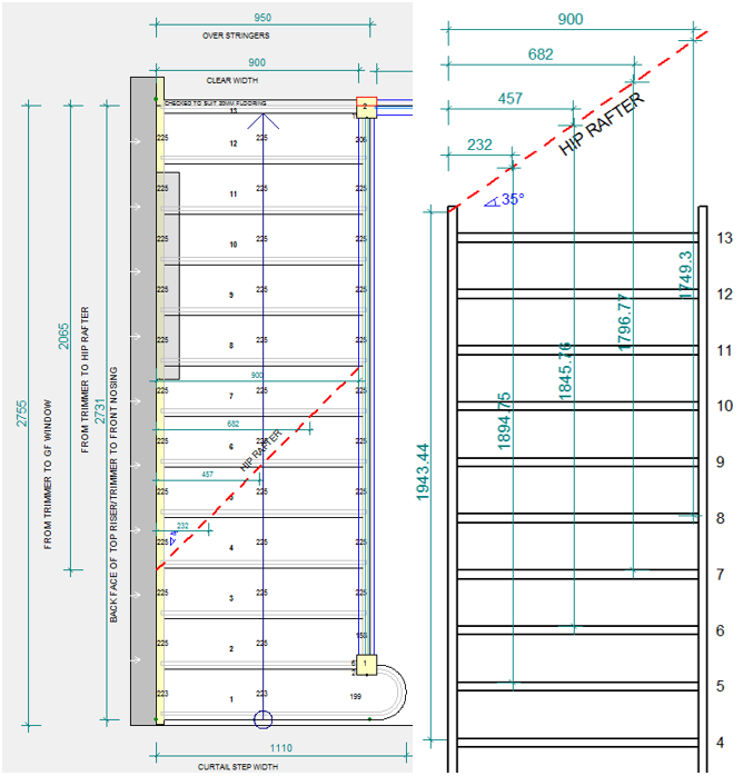

They will check things like the gap in the spindles and if it's open tread that gap. To stop little ones falling through. Same goes with the height of the Bannister. All health and safety aspects. Bound to be more though.

This saga has gone on since late July, staircase company were out and did measurements, there was a problem with the pitch 42.545 instead of 42 degrees, architect came up with a solution and was to contact firm direct, I thought this was all done and contacted them a fortnight ago for an eta only to be told plans hadn’t been finalised! After much toing and froing between architect, firm and joiners yesterday I received this plan which on first look made me think it was all sorted however the accompanying email has me worried, it states-please note the trimmer was double sheeted and this will have to be removed before fitting stair,
I don’t know what that means, I have an idea what it means but with all the plastering done I hope I’m wrong! Any ideas?
