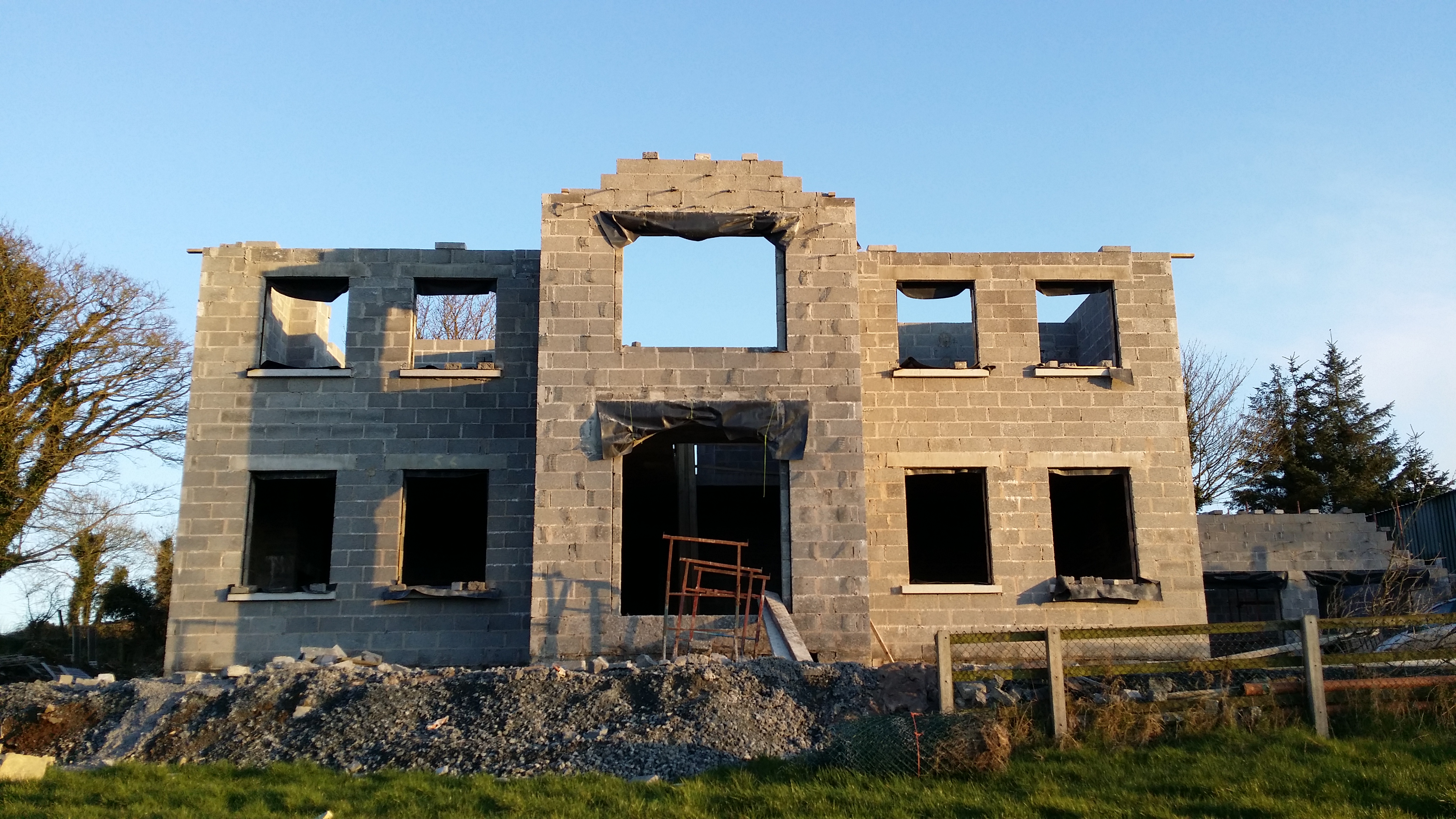

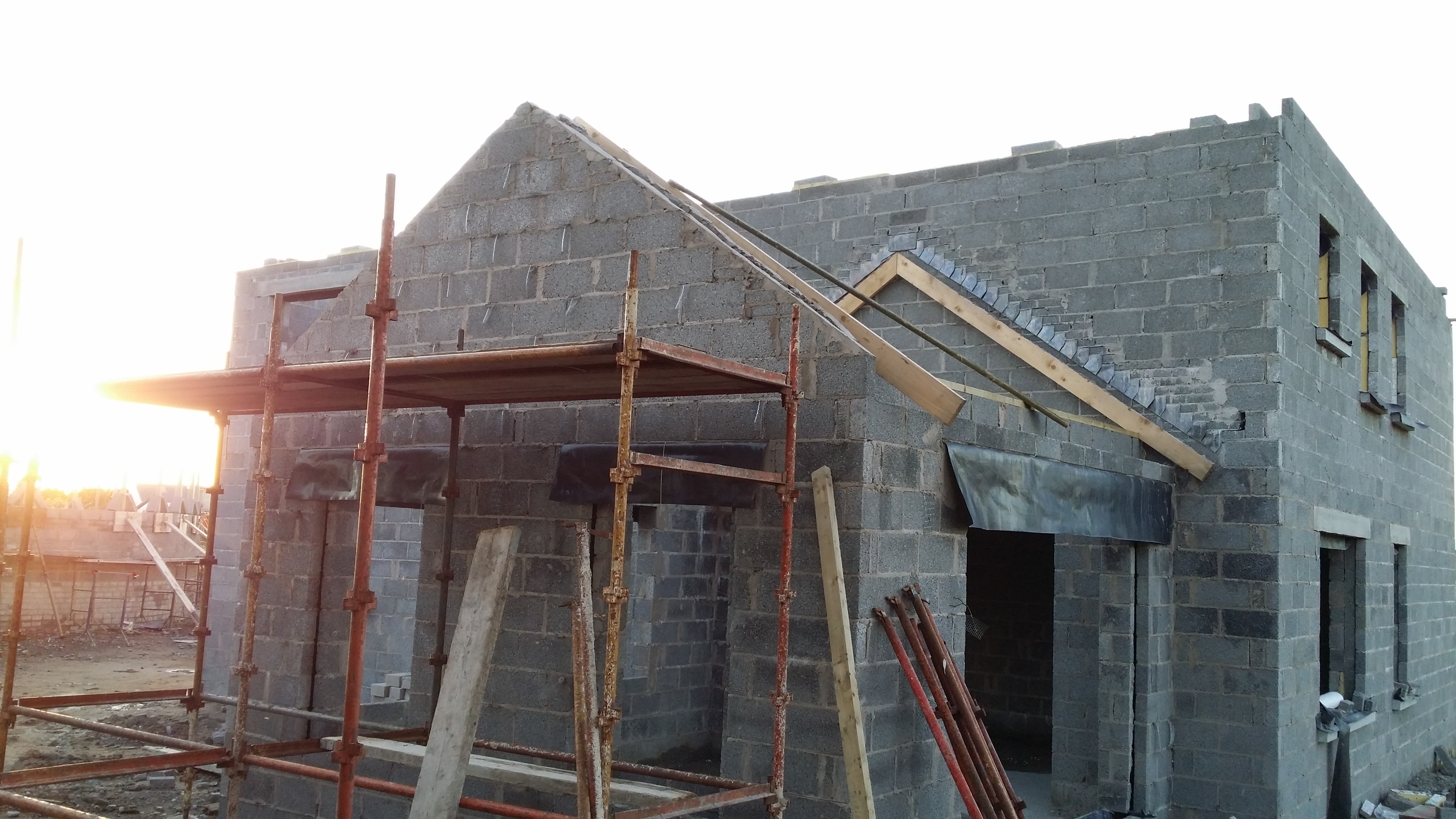

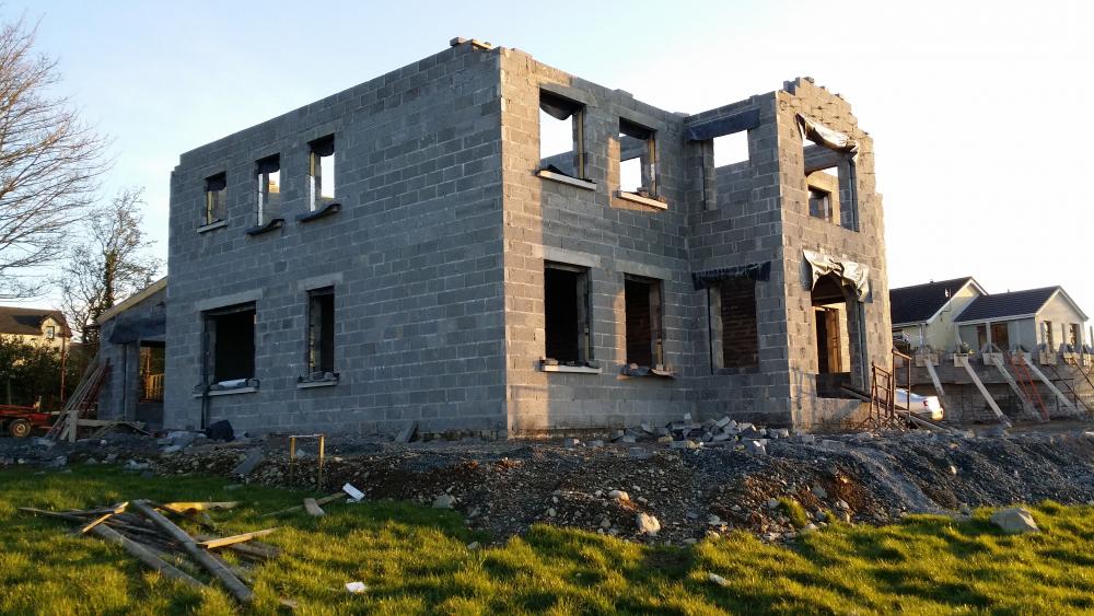

So things have stalled quite a bit over the last few months.  Block layers have left site as they don't want to do the peaks without roof supports.
Trusses have been measured up wrong which has caused some amount of delays.  Also having issues sourcing scaffolding but finally have that issue resolved.  Just need to get the scaffolding to site.
There have also been some issues with our window cills.  Got measured up for windows and window rep informed me that the cills weren't level one side of the cill being closer to the DPC and the other being further into the cavity.  This would lead to some potential issues for water ingress and air tightness so needs to be rectified before anything else gets done.
There is also an issue with the height of the inner blockwork at the cills. The inner blocks are currently sitting around 5-10mm higher than the cill level so these need to be cut down a bit.
Hopefully there is nothing too major required to sort this out.
I also have some threads up about a potential problem with our hotpress (its only 850mm wide)  and also possible solution to our 3m sunroom opening (Pivot door)

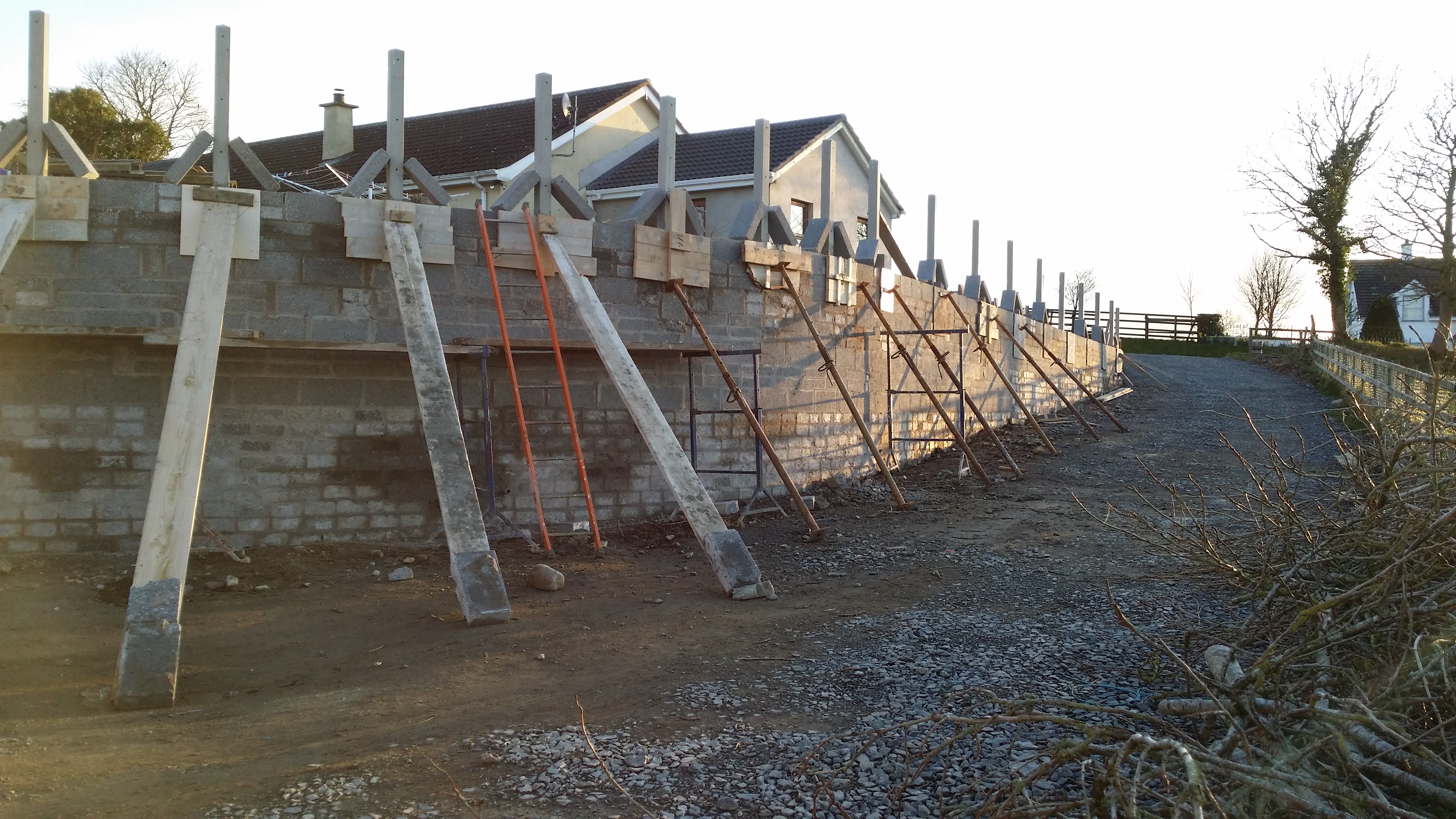

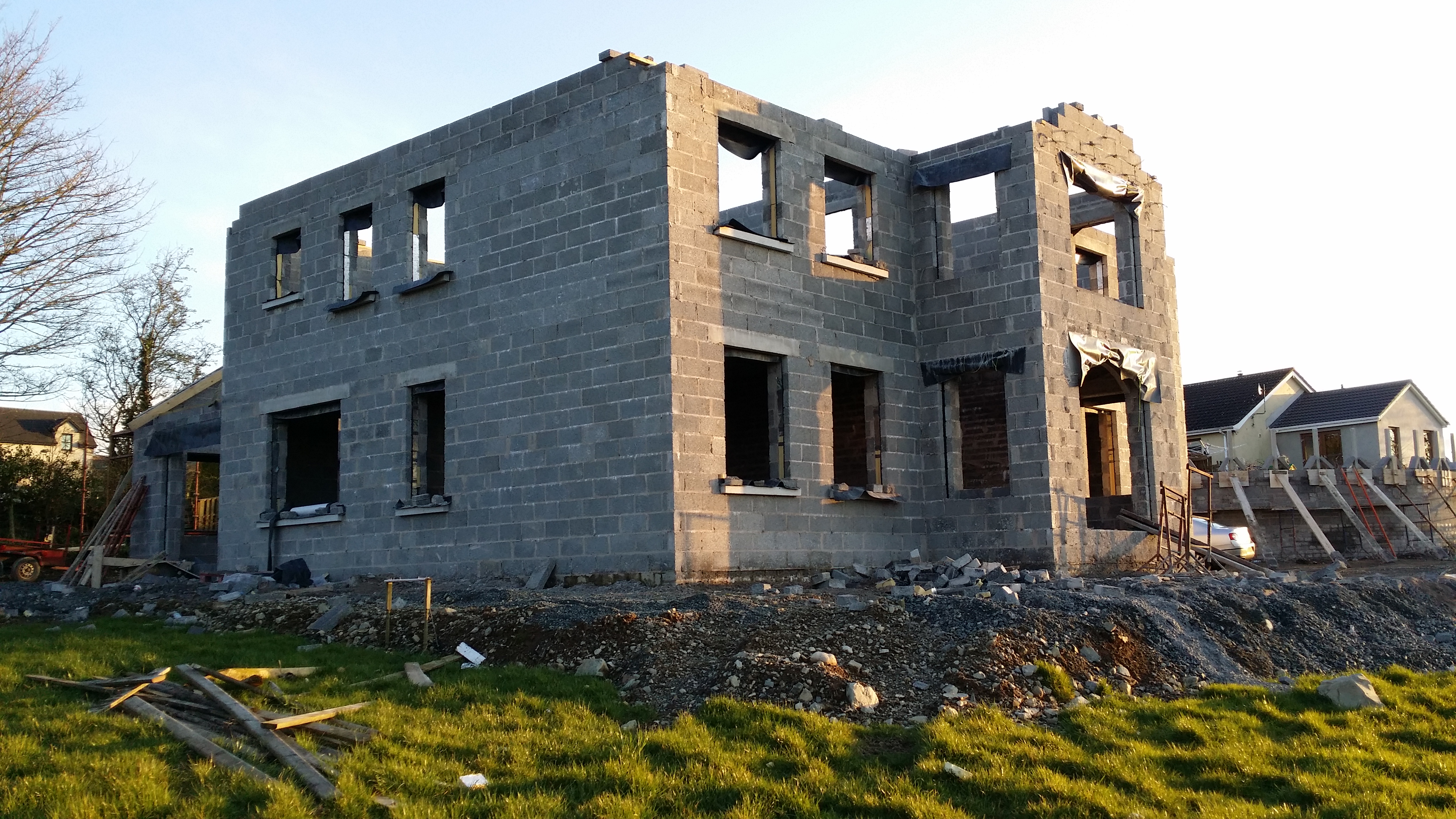

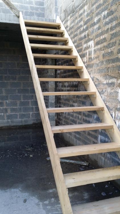

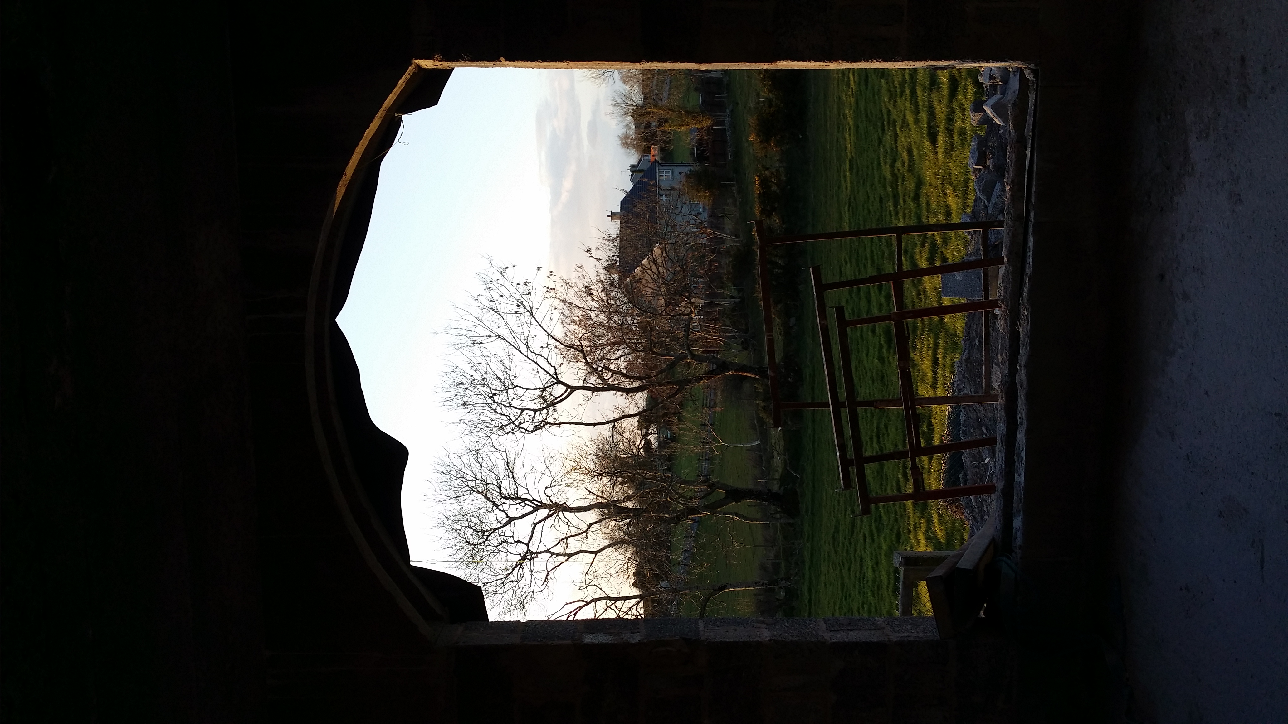

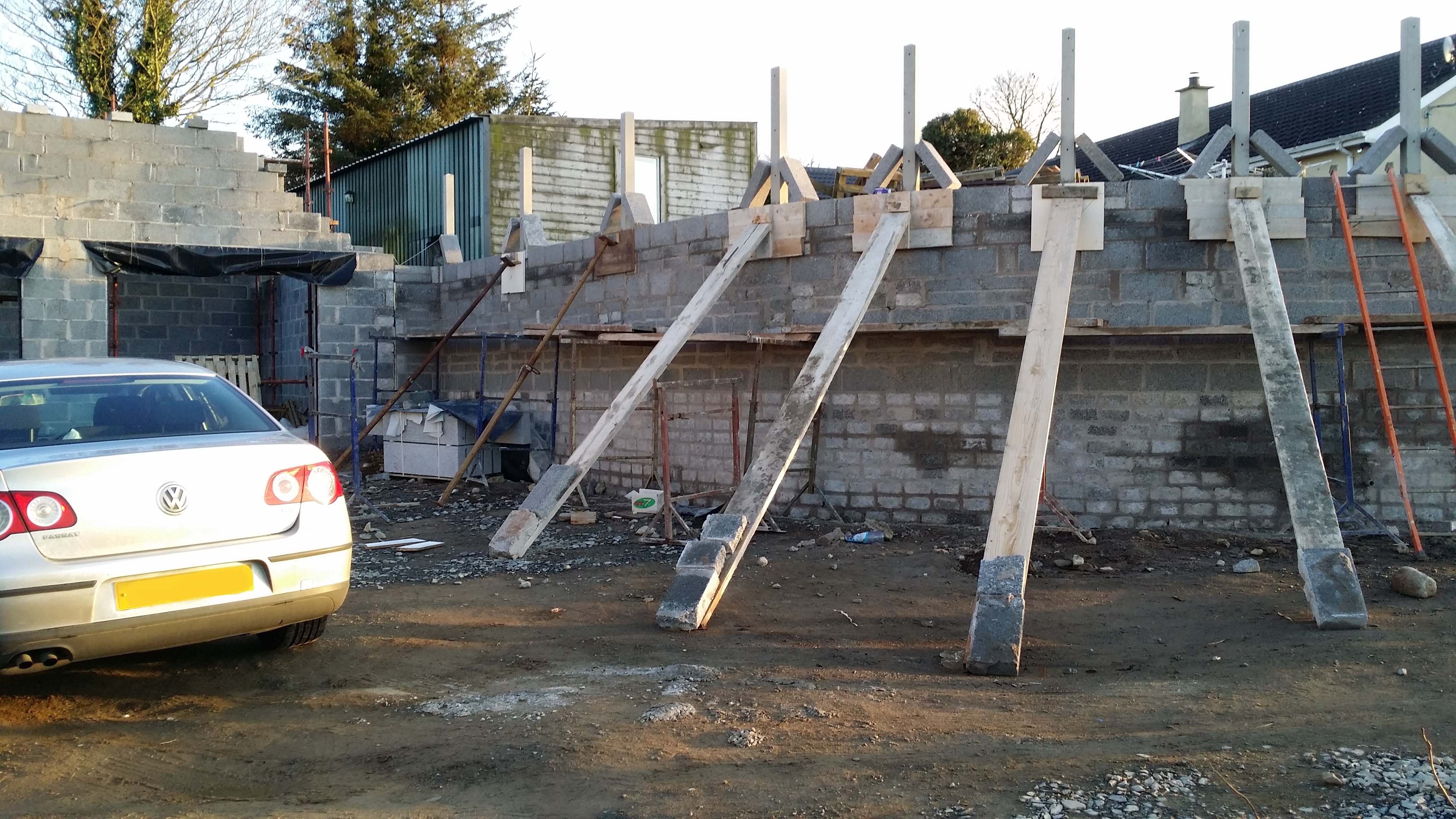

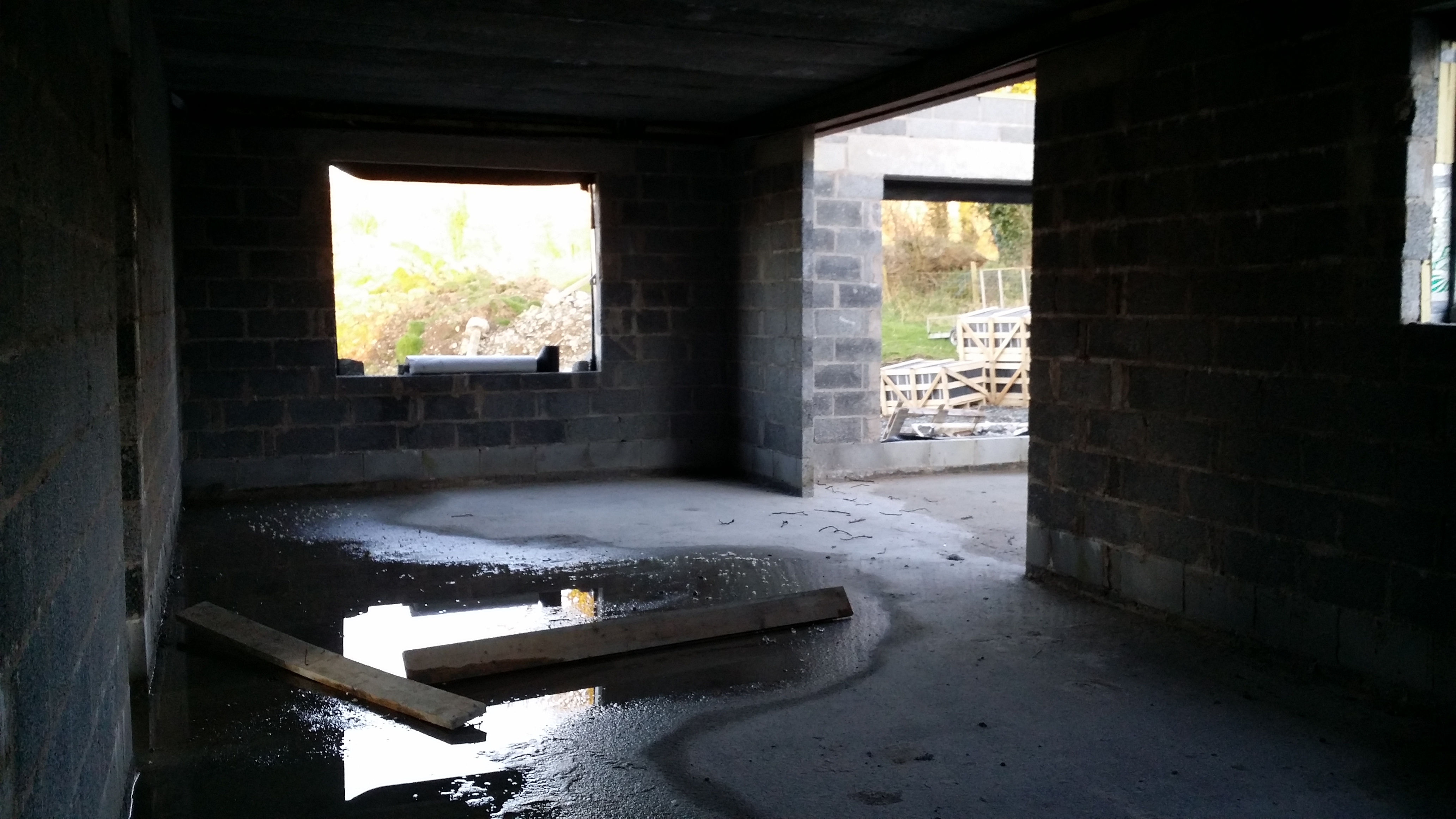

This is how the house currently looks.  There has also been a rather large wall built to retain my parents garden and line our driveway.  This gives my parents a much bigger garden as this was previously a rather large bank.  Oh and my father built a temporary staircase, just means we wont have to be up and down ladders.  Also should save the proper stairs, as we wont need them in as soon.

What windows I can zoom in on seem to have a soapbar built on the back. Couple of wacks with a hammer and they will break off and give you enough room to put insulation on the back of the cill and fill up with concrete. Easy job to do.
I made a similar stairs and used them till the house was plastered out. Got scrap carpet of a local guy and covered my steps once it went in.

Decky said all the windows had the inner skin higher than the cill.
And the kitchen one has the wonky cill but you cant see that from the photo.
I'll try and get close up pics of them and add to this.
