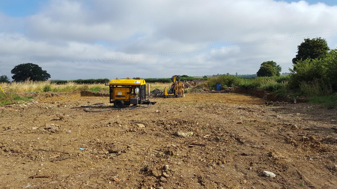

The piles started going in today and it was a glorious sight to behold after so much waiting and anticipation.  It was, in fact, very understated for piles; these are, after all, mini piles, but there was so little fuss and hassle that it was almost underwhelming.  Not quite, though.

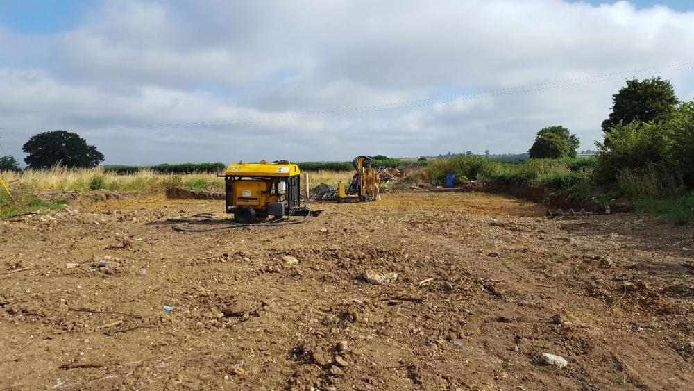

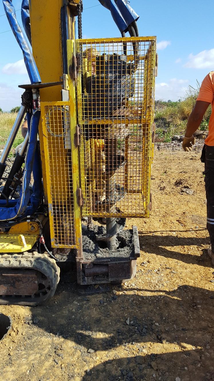

First up, the rig is moved to the piling position and the hole is augured out to the specified depth, with the augur being cleaned of debris as they go.  Because my clay is so dessicated, it came away from the drill with no problems and no difficult cleaning was needed.  The spoil was just shoveled out of the way of the piling positions.

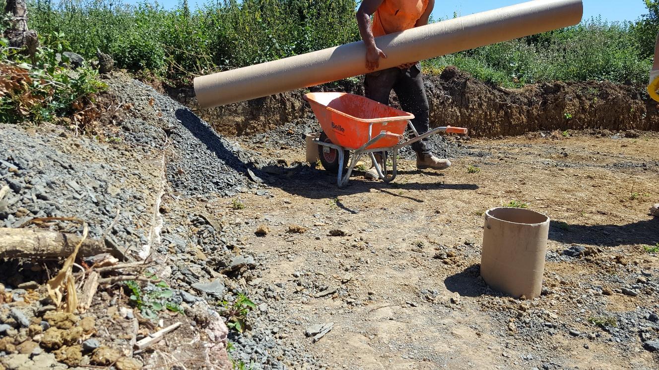

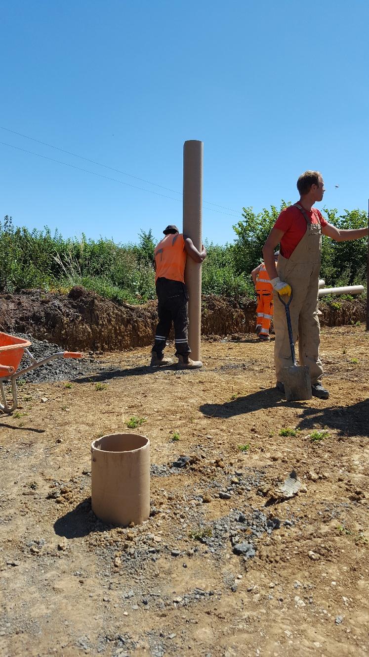

The top 3m of the holes are lined with an anti-heave sleeve - this looked like a giant tube of plastic impregnated cardboard and I suspect that's exactly what it is.  I understand that they can, at times, be tricky to put in.  The team tried to put the first one straight into the hole and seeing someone balancing on one of these to try and squish it in was quite amusing, but ineffective.  The solution was very simple - before inserting the sleeve, it got wetted down with water and they dropped right in.  The sleeves are a few mm smaller than the hole, so still a tight fit, but the water lubrication worked well.

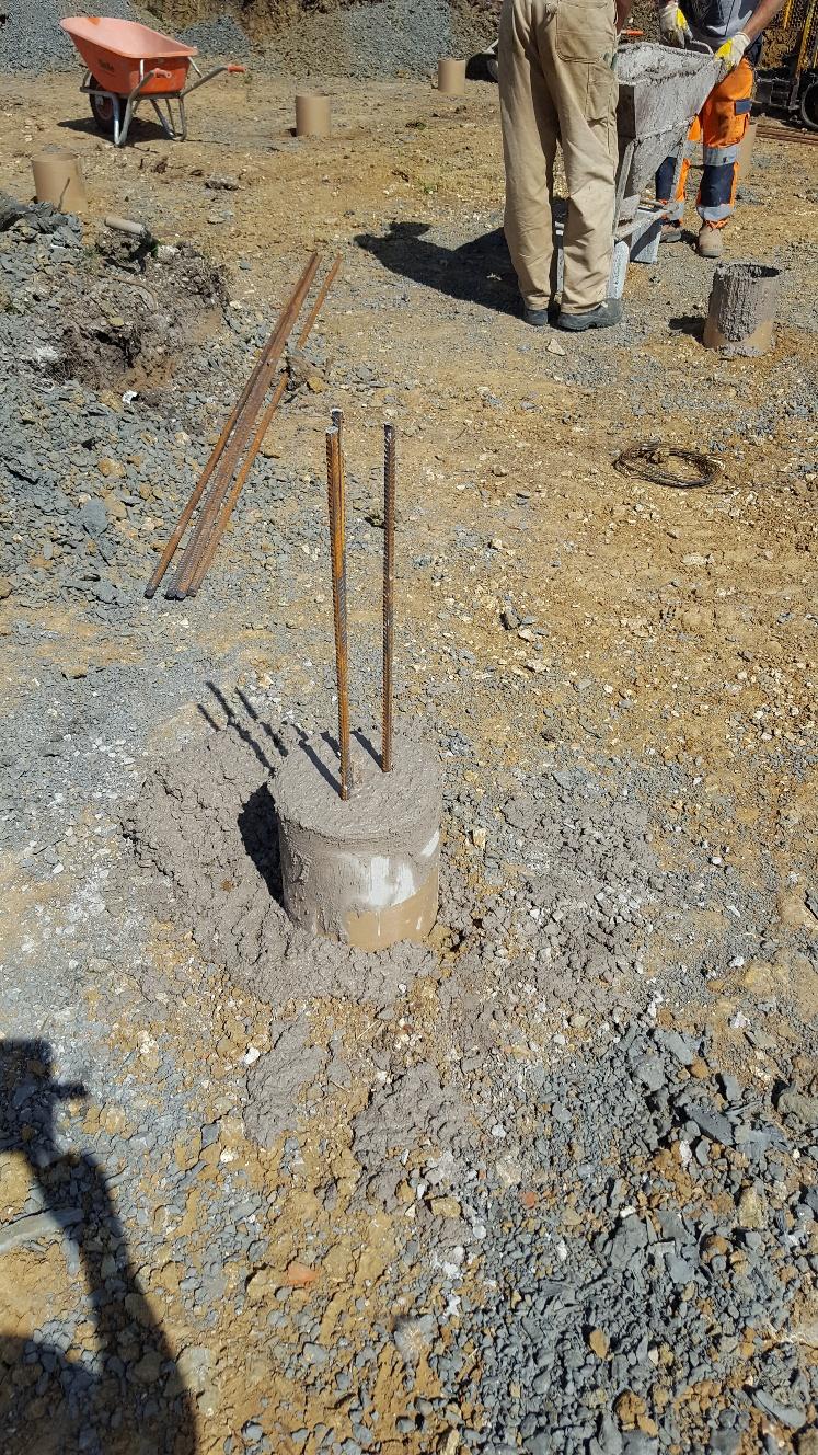

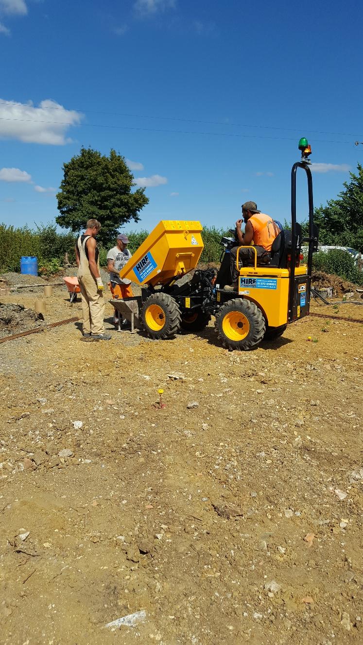

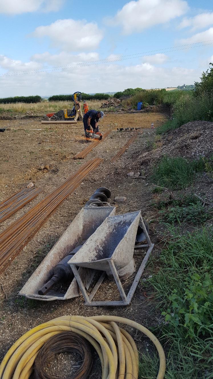

The concrete lorry turned up mid-afternoon.  The drilled holes and sleeves aren't left open overnight, they are always poured and filled by the end of the day, with the rebar inserted.  The concrete pour was equally straightforward.  A dumper truck gets filled with enough concrete to fill one pile position up to the top of the sleeve, the rebar then gets inserted, tied and pushed in all the way. Rinse and repeat until all the positions are finished.  Once the concrete has gone off, the rebar will get tied into mesh.  Judging by the rate they're getting through the work, the job should be finished on Thursday or Friday morning at the latest.
I will add a word about the dumper truck and, in general, the diminutive size of the equipment.  Because everything is on a smaller scale, they were able to negotiate the site and all the piling positions that were down and I only saw one squashed pin.  Larger equipment would have run the risk of burying everything, if only to manoeuvre around, but this system was very nimble and capable.  The combination of smaller kit and the dry weather also meant that I was able to completely avoid the need for a piling mat, which wouldn't have been cheap.
