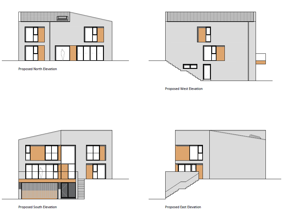

The first decision to be made with the new architect was how to change the external house design to remove the lack of head height in the roofspace, but stay within the existing footprint.
In the napkin sketches, the architect had suggested two mono-pitched roofs to replace the existing dual-pitched roofs and we immediately liked that design. However, he didn’t immediately just go with that design and at the start of July 2016, he sent us through a couple of options, one with a flat roof and one with a sloped roof. Before giving his preference, he wanted our opinion:
Option 1:
Option 2:
I initially preferred the flat roof option, whereas my wife preferred the sloping roof. I'd be interested to hear what others think and I'll share what we went for in the next post.

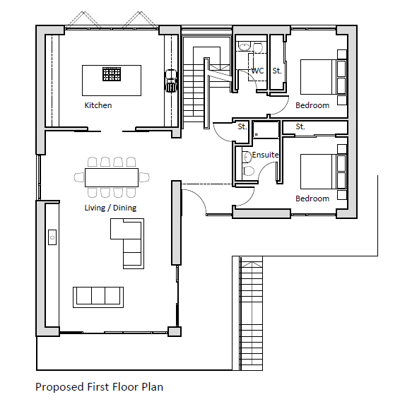

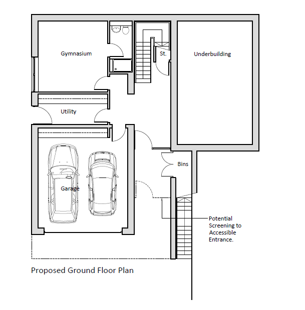

Here were the revised floorplans at that time:
We liked what the architect had done, but, as is often the case, its not until you see something in front of you that you realise you want it changed, so we did go back and make some further alterations to the internal floorplan. I'll cover those in a future post.

Much improved :-). My comments on *this* iteration, if I may, to encourage continuation of the novel.

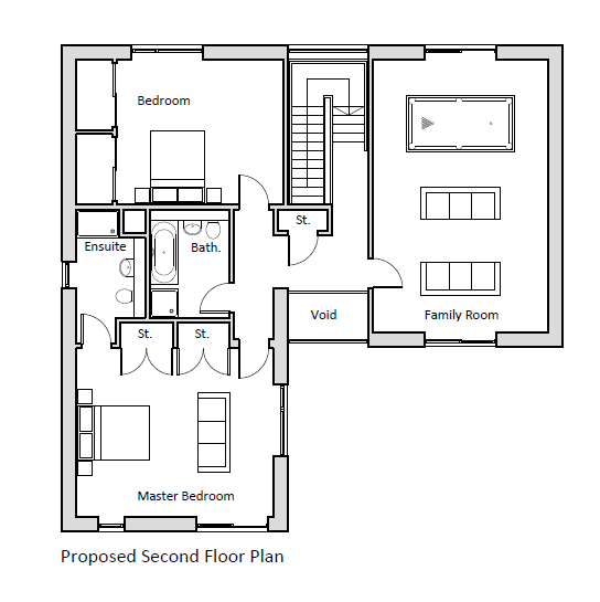

Where does the person in 1st Floor back bedroom take their shower ? :-) I stand by my off list argument on those rooms.
I bet this is coming in chapter 7, but it doesn't seem to make full use of EW elevations, light and sea views for some rooms.
The front entrance is much better resolved, but is that enough dustbin space? We are about to get dustbin number 4.
LIke the full length windows, but I would sweat some blood on the precise arrangement. I am not sure about the levels on that stair window. It seems to be that there is more window on the basement stairs than the 1st Floor Stairs, and the floor level vs window relationship on the stairs may be odd ... would need to see a cross section. Or make the stair wall entirely glass.
I would say perhaps put a window at 1st floor stair half landing level with a window seat. Nice views from landing, and sparrows and trains.
And I am not sure about 2 sets of N facing patio doors from the kitchen. Might be inclined to lose one of those and have a sink facing the back garden through a window rather than the indicated Rudyard Kipling sink ("Watch the Wall My Darling").
How will you get heavy stuff e.g. ton of manure, and friends in wheelchairs, into the back garden and house :ph34r: ?

Thanks once again @Ferdinand for your thoughtful input. You're right that some of this is coming next, but I'll answer here too.
1st floor back bedroom and shower - with this plan, they'd have to go upstairs to the family bathroom, or use the en-suite on that floor - neither ideal, but a future change mitigates this.

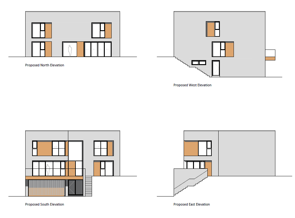

E/W elevations - we've houses either side (one existing, one in planning) and we have a Planning Condition relating to that
"No windows or openings shall be formed in the east or west elevations of the dwelling hereby approved"
We also had to change the the Dining Room window to a high height narrow window - it was either that or obscure glass.
Dustbins - probably not enough space (we already have 4) so we'll likely use the space outside the marked area (with a screen at the front, in line with the garage) and then use the bin space for tools/bikes (behind a lockable door).

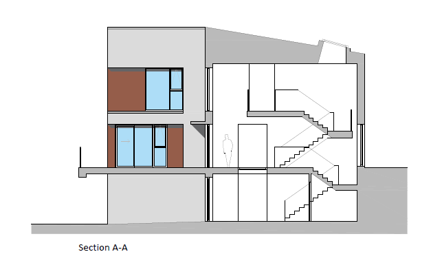

Placement of rear window - good spot, and you're right that the avatar on the drawing is misleading. Here's the section from a later drawing:
I wanted full height glass here (the original design had this), but our architect was adamant it would cause overheating and he liked the drama of the window placement with the landing - I'm still not convinced. There's not a view as such out the north elevation (occasional train and school playing field) but if we're going to change something (and we'd have to go back to planning) this would be near the top of the list.
Kitchen doors - the original plans had exactly what you've suggested, with the sink on the north wall in front of a window and a side door leading around to the garden, but we made a conscious effort to change that as we like to BBQ and wanted direct access to the back garden. We also very rarely stand in front of the sink for anything other than a minute or so.
Rear garden access - this is a bit of a concern of mine - not so much for smaller items, but for during the build, particularly due to the slope. Re. Wheelchairs, we've been advised by our architect that we're passing accessibility regs (we'll see) but i accept its not easy to get someone in a wheelchair up to the living level. We did briefly talk about incorporating a lift (as per a previous comment) but the cost...

Will return to this after errands, but does that PC mean that you have lost all those windows on the West Elevation?
Especially the one in the 1st Floor Living space.
AliMcLeod
Posted
We queried that, but that's ok - its just badly worded. The "hereby approved" refers to the house with those window as designed, but we cannot add any more.

>Placement of read window - good spot, and you're right that the avatar on the drawing is misleading. Here's the section from a later drawing:
I think the basic point here is that you are the Client, and he is the Architect. What do you want when you are leaning on the banister in your pyjamas or walking downstairs? It is your building and you will be living in it for 20 years.
IMO one of the benefits of the dentist and teeth like process you are documenting has been that you have learnt (and are demonstrating) how to get such decisions right balancing many different factors. Have the courage of your convictions, in context, whichever way you decide.
Heh. Perhaps you need to have the architect explain how a North facing window (ie no sun) in a house built North of Edinburgh (= cool climate) on the Scottish East Coast (= cool air) with a largely glass South facing facade (= maximum cause of overheating if there is any) is going to cause a material increase in 'overheating'. With calculations and/or models. Peraonally I would be a little skeptical.
If you need to manage the excess sun on your North facing window (or even the South facing ones) there are things like effective transparent solar film available. Have discussed recently on here.
A couple of comments.
To my mind the wheelchair etc issue is not really about tickbox regs, but about your lifestyle and the possibility of your friends who are eg in wheelchairs and yourselves being embarrassed in that situation. Or what happens if you or your partner breaks your back and ends up disabled? In that situation you would not want to be forced to move house.
On the lift, I would argue for the *possibility* of incorportating one in future rather than adding 25k to the budget now. That is things like designing your structure so structural beams are not where the hole in the floor would go, putting a more robust element in for the anchor at the top etc, leaving a suitable space on each floor etc. That may not be prohibitive.
On the garden access, mitigation is straightforward, but full access is slightly more tricky.

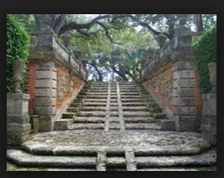

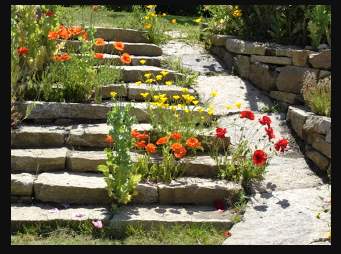

1 - Incorporate a wheelbarrow / bicycle ramp into your side-path stair design. Something like this, which could be sunken as well as proud:
(Credit: https://www.yelp.com/biz/vindels-construction-san-diego
or this
or this
(Credit: http://wallswithoutcement.blogspot.co.uk/2006/12/steps-and-wheelbarrow-ramp.html)
How you do it depends on your materials and path width and step design, and should cost not too much extra. At its simplest you just mortar in an angled brick upside down to each step, or put a groove in your mini wall at the side.
IMO the ramp really wants to be wide enough for a sack trolley, and you want an anchor point for a portable winch at the top.
In your setting I might be tempted to finish white concrete mini-side walls in embedded beach pebbles on top so I have a low friction surface for an inclined plane which would just need a board, a cable, and the aforementioned winch. Or put grooves in the top for rails.
At its simplest you could incorporate a small depression at the bottom where you wedge a 5m piece of gutter cut to length when you want to use a wheelbarrowm with a couple of stabilising pegs somewhere - which could be a batten to wedge in the path and 2 six inch nails.
I would say make the steps as shallow as possible to make barrows easier for smaller people (or it will be delegated to you), and make half landings long enough to fit a bike/barrow and a person who want a rest - say 1.5m.
2 - Make a straightforward path through the house wide enough for whatever - always a good idea when difficult access. Suggest 900mm which is sized for a Type III Mobility Scooter or 800mm which would take a "doorway" sized digger. That depends on your lift to work, and appropriate floor finishes and kitchen layout, but there's no point making it impossible when you do not have to. :-).
