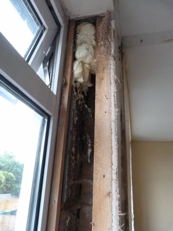

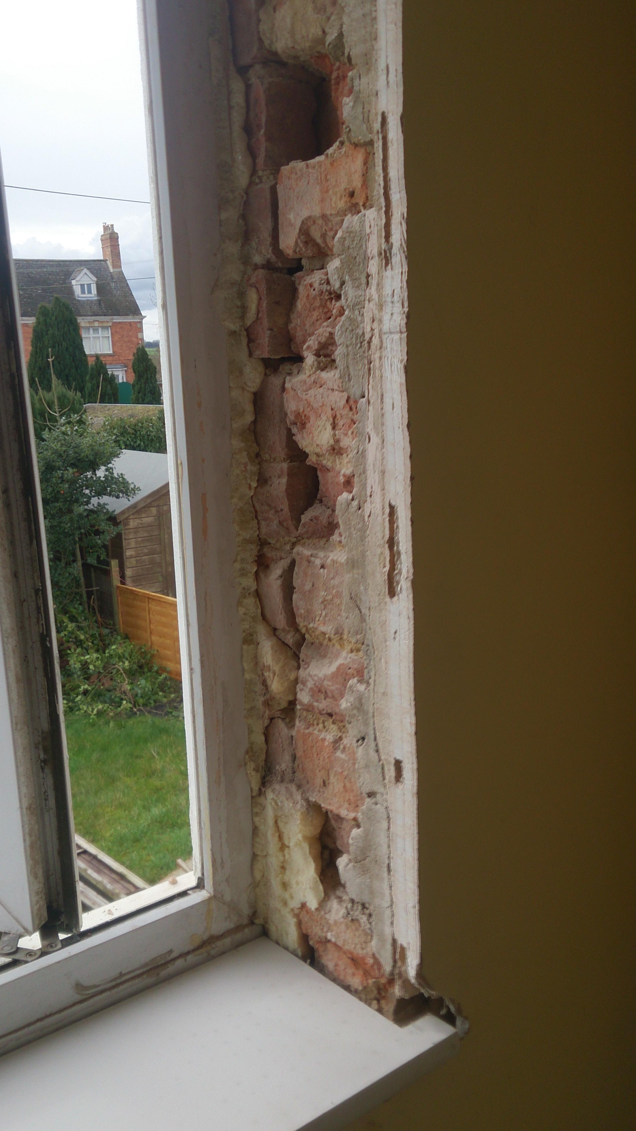

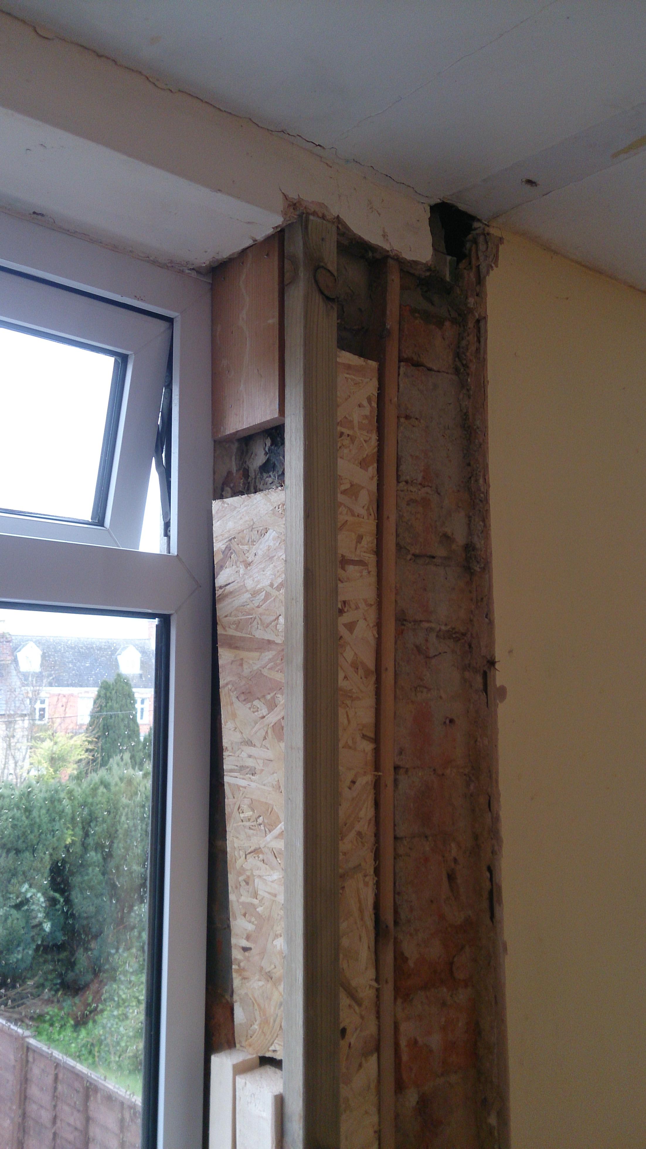

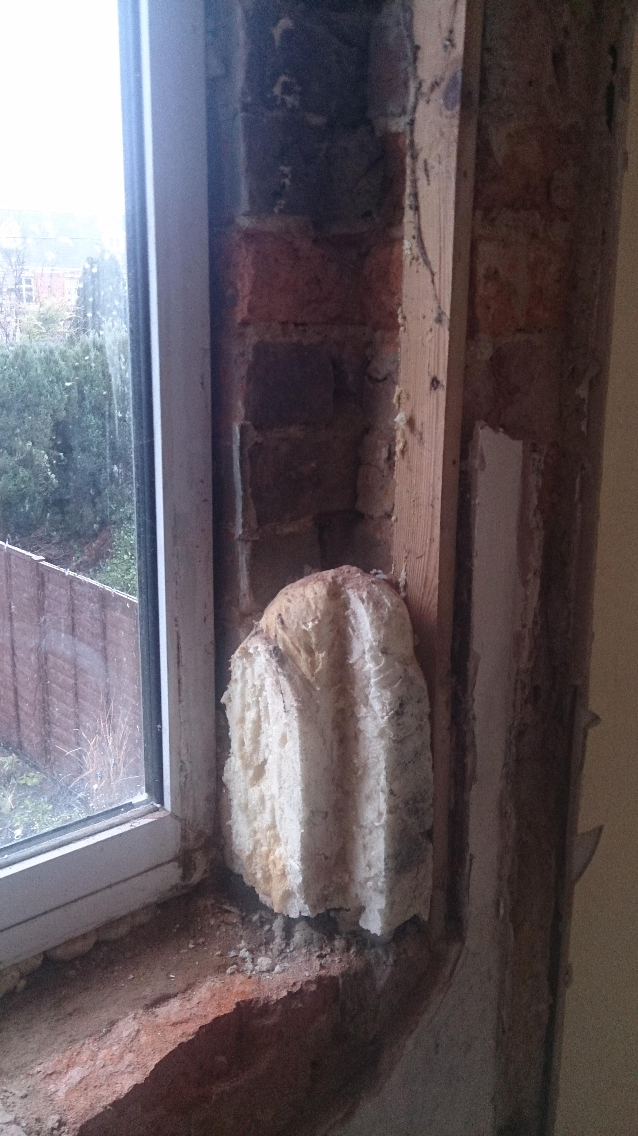

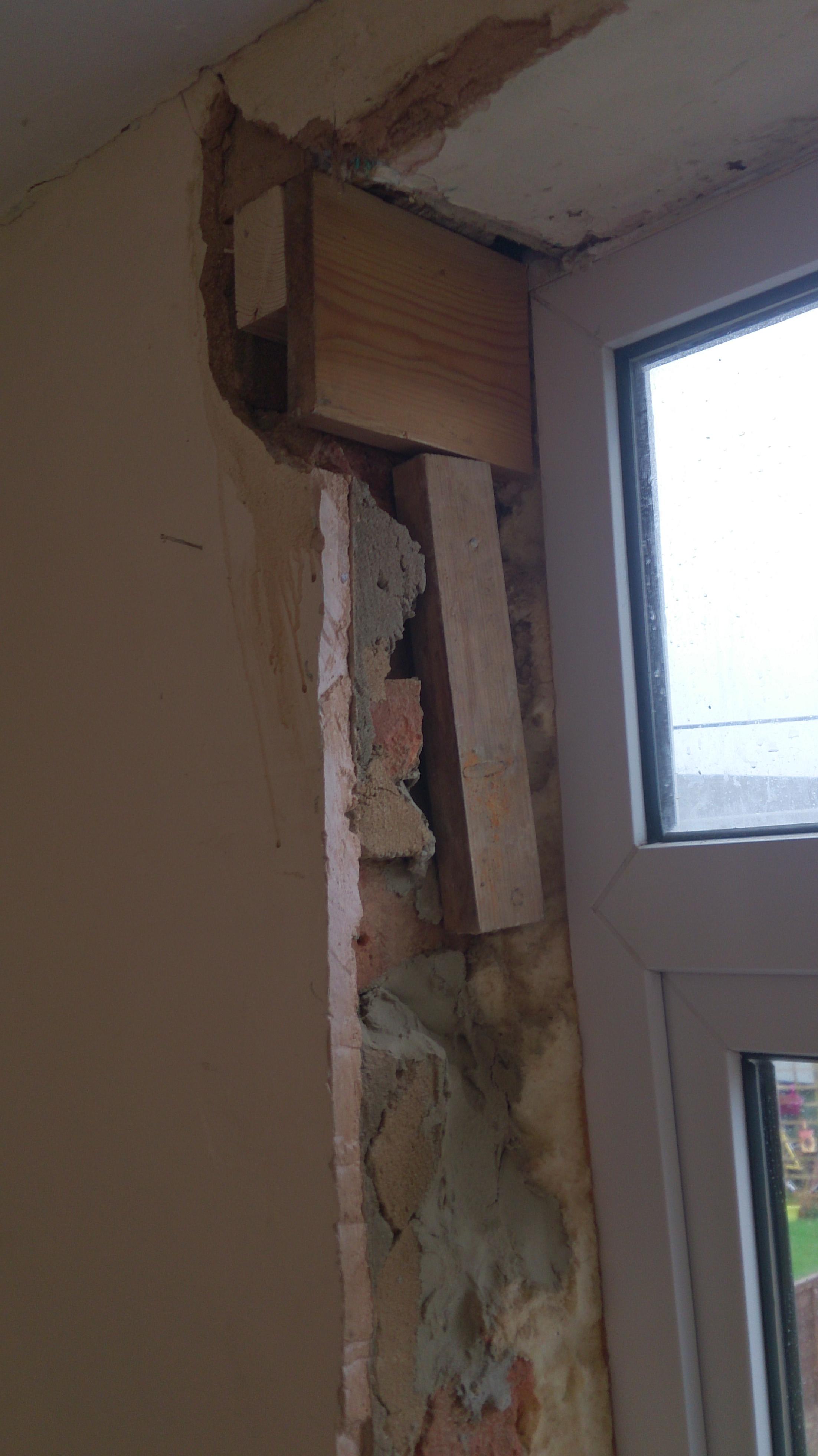

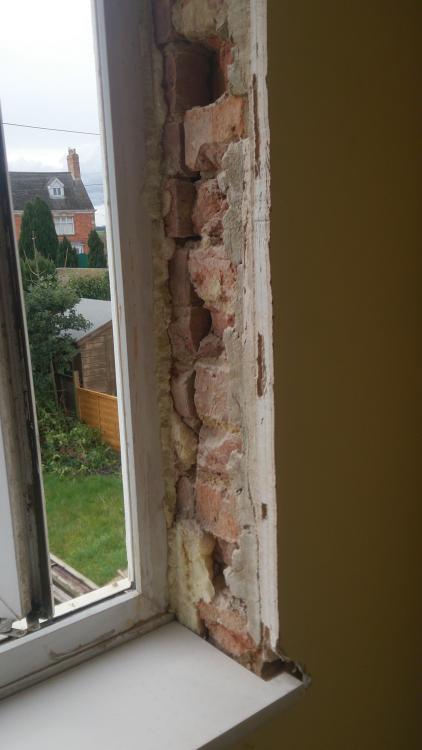

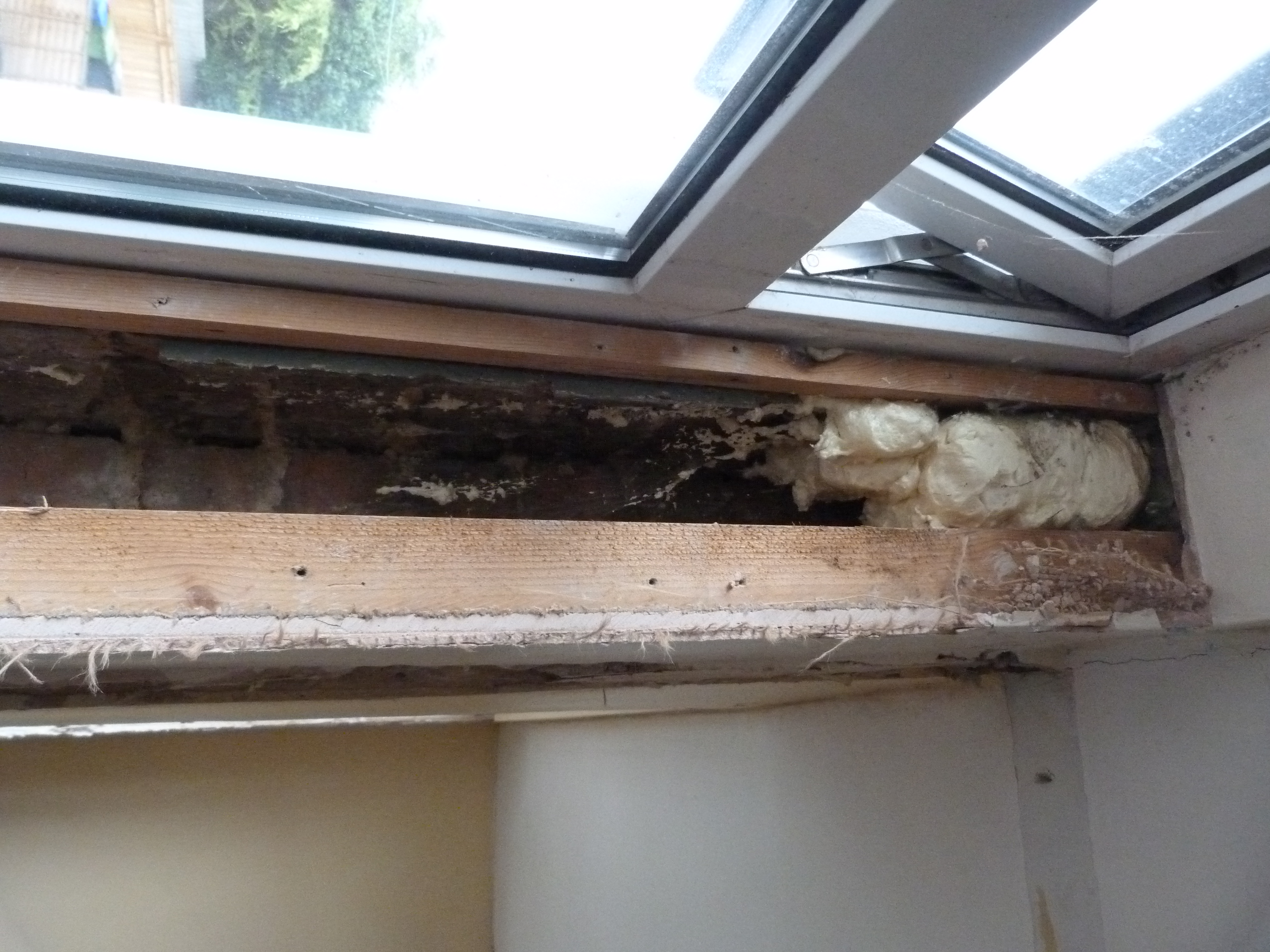

The surrounds of the front bedroom windows were awful and I ended up taking the plasterboard and various bits of foam/wood and brick from around the sides and bottom of the frames, to enable me a) to clean the frames and b) to actually see a frame.  It looks so much better and in one part, there was a huge hole behind the plasterboard
P1100208.thumb.JPG.f4d98bb2e3e3511abddfbaffd007b7bc.JPGDSC_0921.thumb.JPG.eb571fbd3017a79353dbc047934d769d.JPG
and I ended up building a column of half bricks in the cavity to help fill it up.
I then used low expansion foam to fill in the gaps (I could see daylight at the top of one side) and stuck some pieces of wood at the top of each side, thinking that at least they now have something to screw into if the new owners decide to fit blinds.

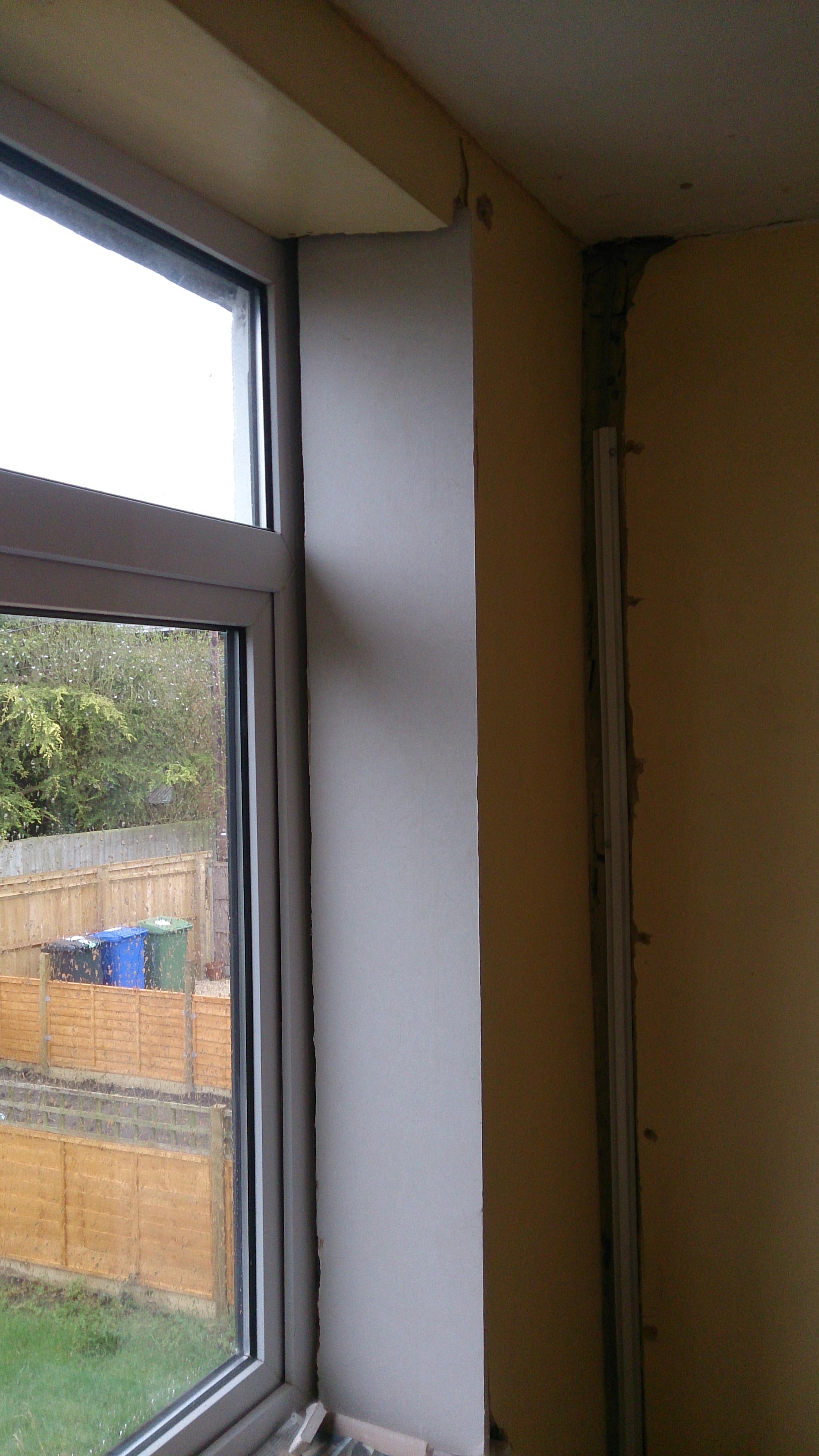

It probably looks a right mess as I used spare bits of wood stuck to the foam to fill out the spaces before fixing the plasterboard to the sides, having already fitted the cills, using the Soudal foam to fix it in place.  That worked a treat until the foam gun stopped working!
The OH spent a good hour cleaning it all out, using the Soudal cleaner that came with it.  but when we put the gun back on, the foam oozed out in a trickle!  Then when we disconnected it, the foam suddenly squirted out all over the place - and its very sticky!!!  It was all over the floor and us.  O.o
Eventually, he gave up and we binned the gun - he really did clean out every single bit of it but still it just oozed.  So I ordered online some hand held ones which come with a straw and were much cheaper than buying them at the BM - but thats another post!
They arrived the next day and I had a go - I was not happy as the foam just oozed out too, till I remembered that I had to hold them upside down and then it worked great. (that wasnt the reason the previous day, we were doing it correctly then)   So the windows now had new sides, completely covered in plasterboard and they look pretty good, if I say so myself.:D  And we can see most of the frame too.

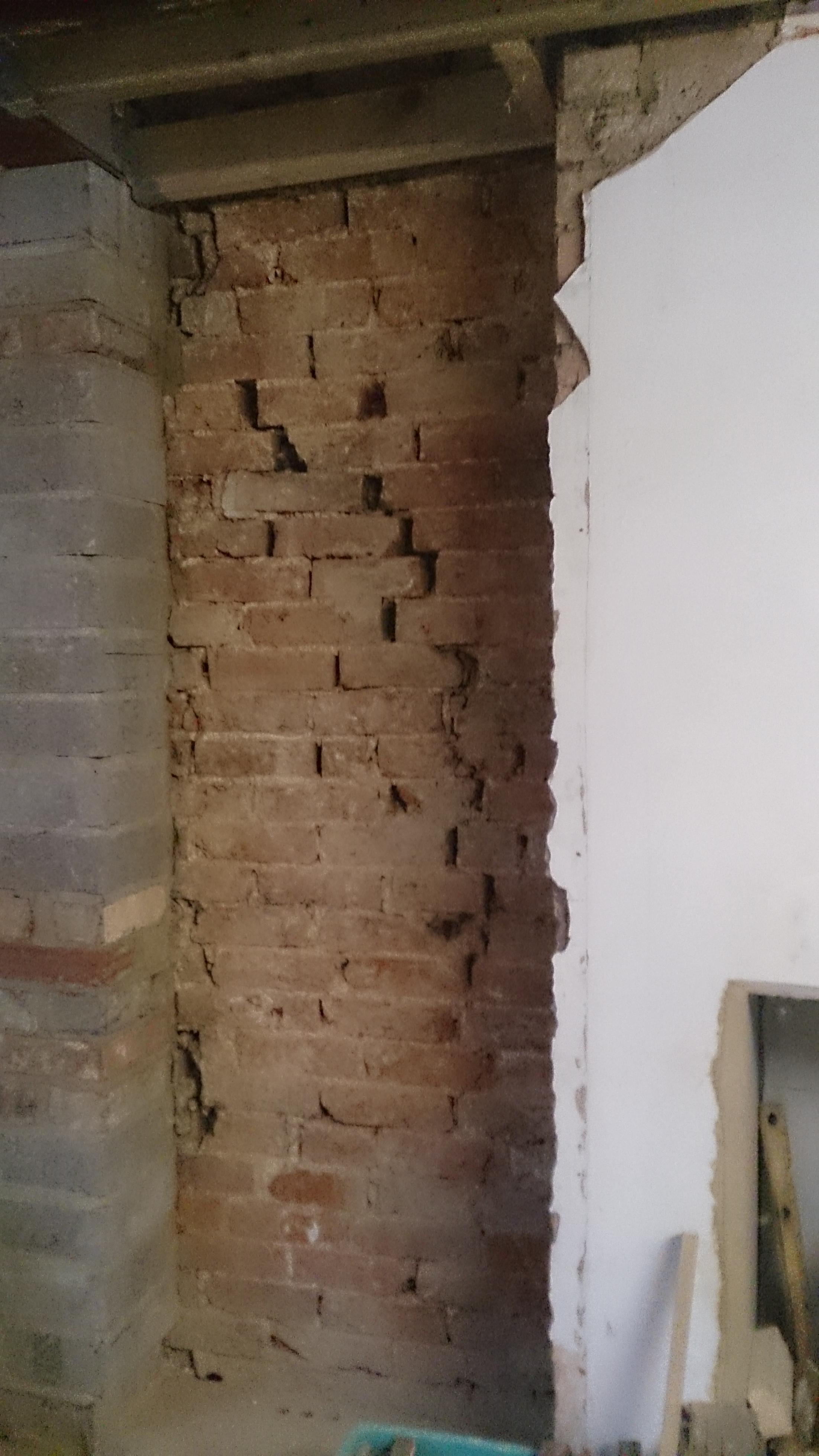

Following the advice from a plaster post here, I have been experimenting with plaster and adhesive, to try to make some repairs to the walls.
Downstairs, (actually in most rooms) more of the plaster was loose so had to be removed.  but this revealed rather a large crack.  This is a wall between us and next door, and next to the chimney breast.
The pillar on the left is the new one which holds the RSJ's between the kitchen and middle room.  So I dont think the crack is too much to worry about - I cant see that wall disappearing anywhere - apart from into the cellar beneath!  Oh dear, hadnt thought of that,:/ So it was out with the pva then I patched up all the holes with hardwall plaster.  I plan to practice my plastering skills on that wall, once the wires are in for a socket  or two, when the OH gets round to those. Maybe we'll take a look at the foundations under that wall in the cellar and make sure they exist......  I dont want to spend all that time plastering it, for the whole thing to fall into the cellar.

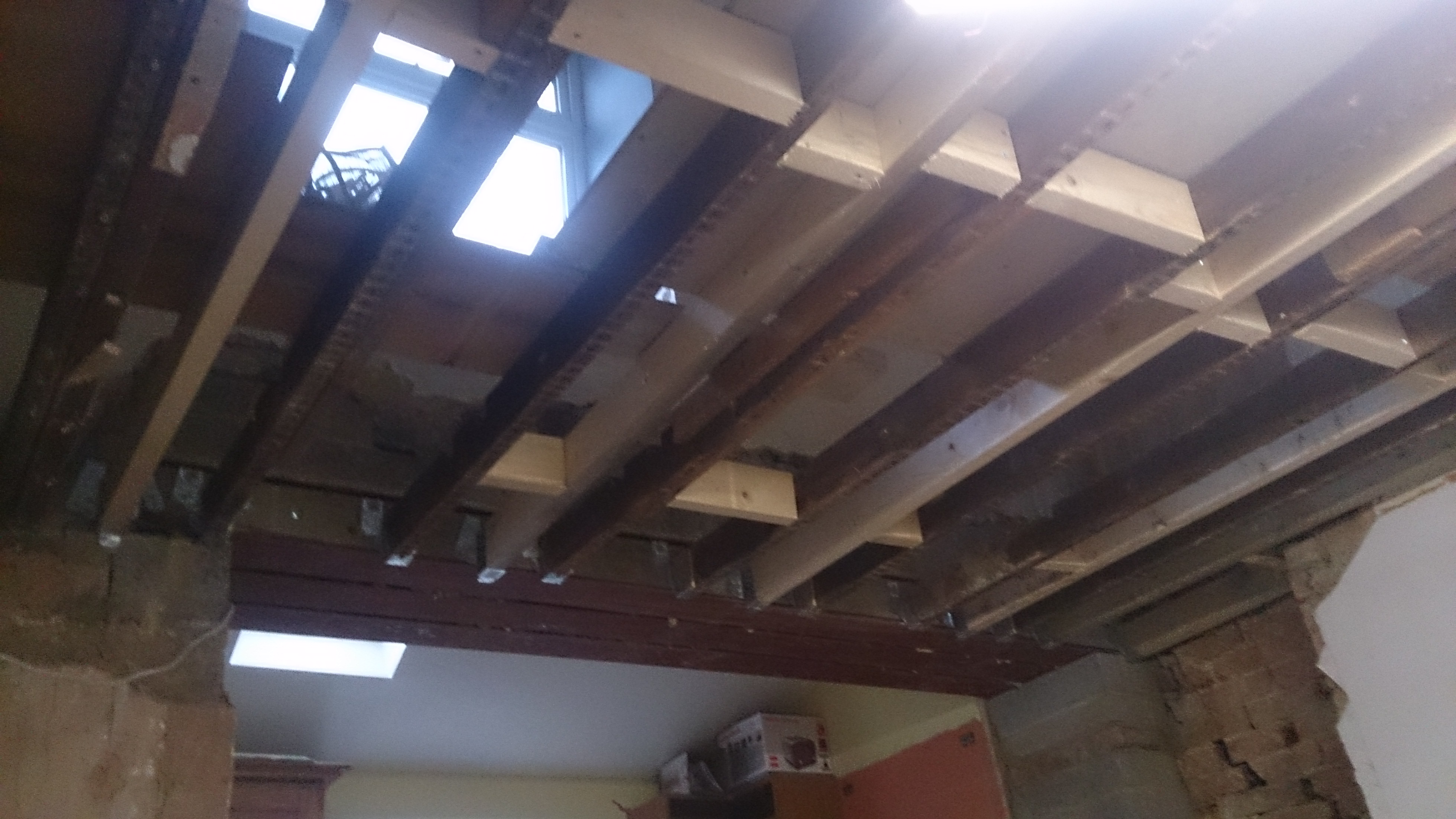

One of the things we were concerned about was the way the rear bedroom floor bounced - it was quite a lot..  So we bought some extra joists and the Sawmill kindly cut them down to match the old size of the new ones.  I thought the price was quite reasonable - £12 per length - is that good?  110 x 50mm x 3metre.
We added them to the old floor, typically adding one every second old beam.  Once the noggins were fitted, the bedroom floor scarecly bounced at all!

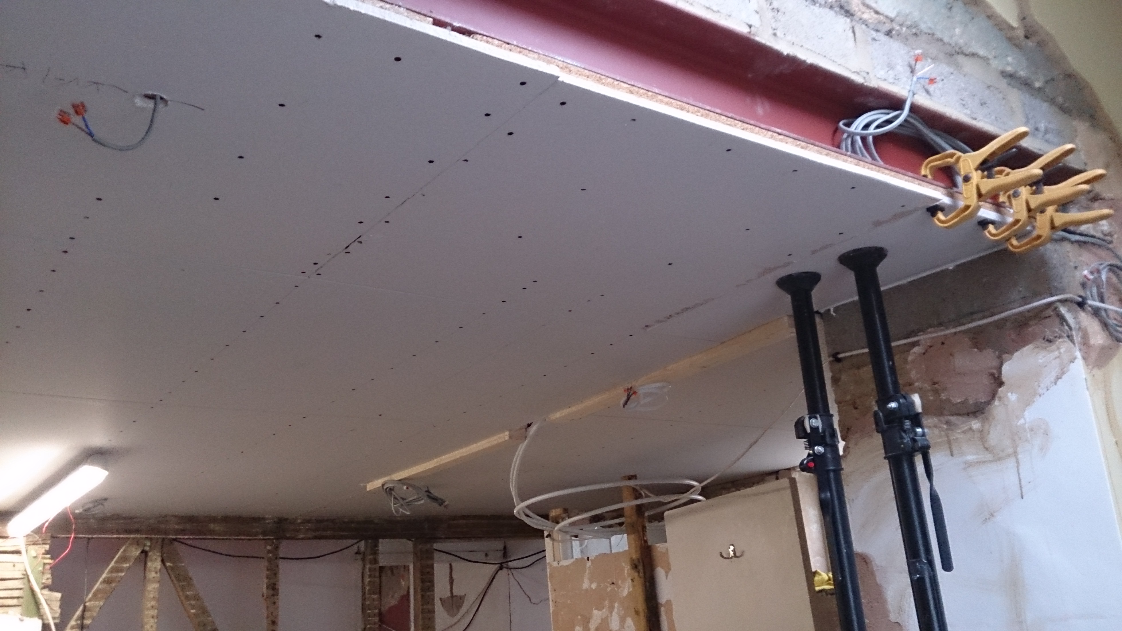

One of the big problems were are having with the renovation is deciding in which order to do things. I couldnt sort out some of the walls till the floor is on place.  We wouldnt fix the bedroom floor will we have all the lights fixed in place for the rooms below and I cant fit the insulation into the fllor space till the lights are in.  we couldnt fix the lights till we had a dining room ceiling so it was time to get the ceiling done now that the new joists were in.
I was a bit worried about doing this as we discovered how heavy PB is when we did the top of the stairs ceiling - my arms were aching holding the boards in place till they were screwed in.  I did fnd a large wooden post that I could jam under one end while I held the other but it wasnt ideal.  The decision was made to buy 1800x900mm sheets to make it much easier on ourselves.  and we also managed to borrow a couple of props which were brilliant.  It may not be the best ceiling plasterboarding but it works and I am quite proud of it - for our first attempt (not including the small landing ceiling)
We have even managed to cover the RSJ - using a sheet of hardboard, to make up the difference in levels and give us something to screw the light fittings to, then one of plasterboard.  CT1 worked brilliantly!  We left it overnight and it was absolutely solid by morning.
The props youu can see are under a small corner bit left for me to do today.
