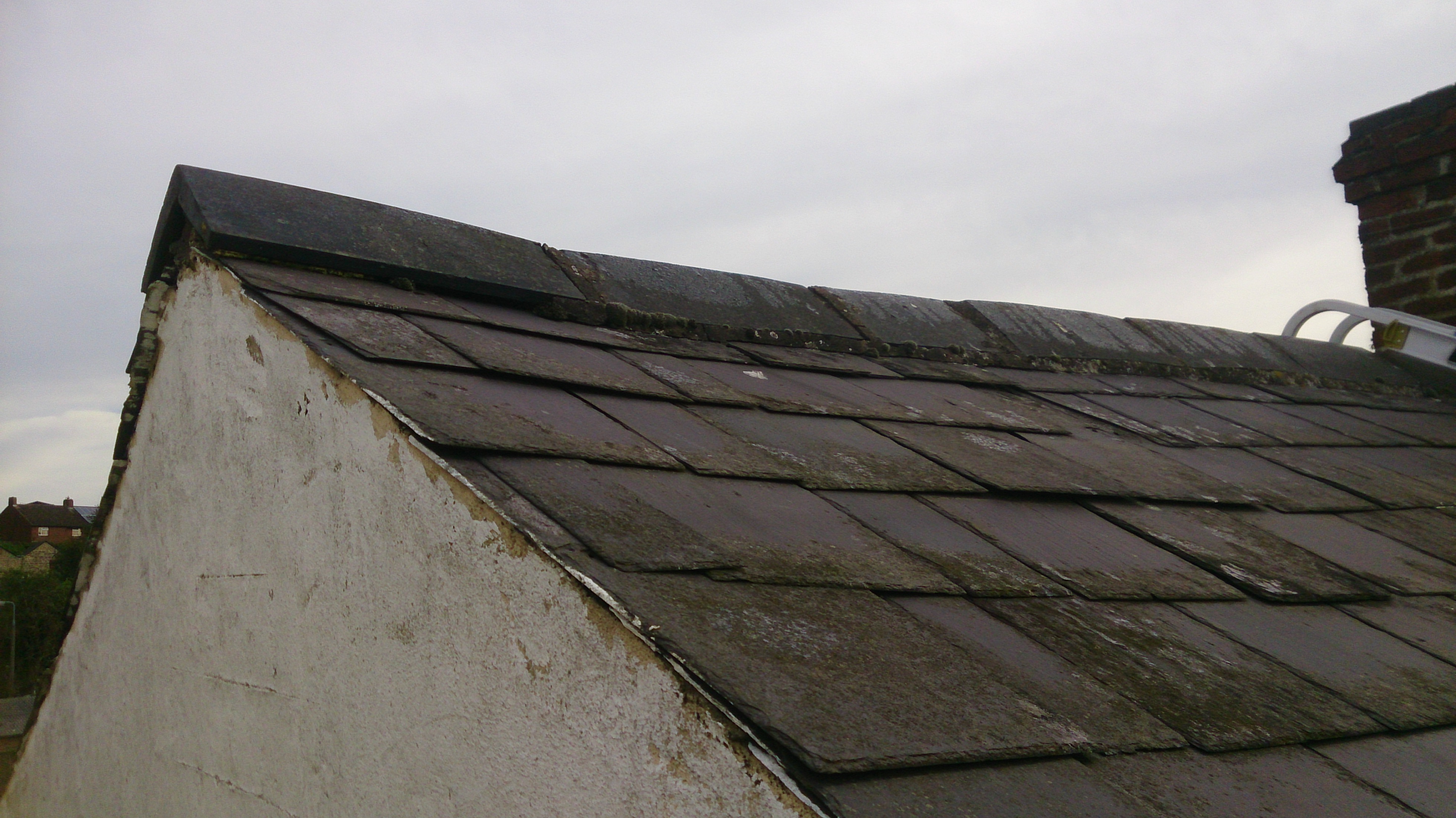

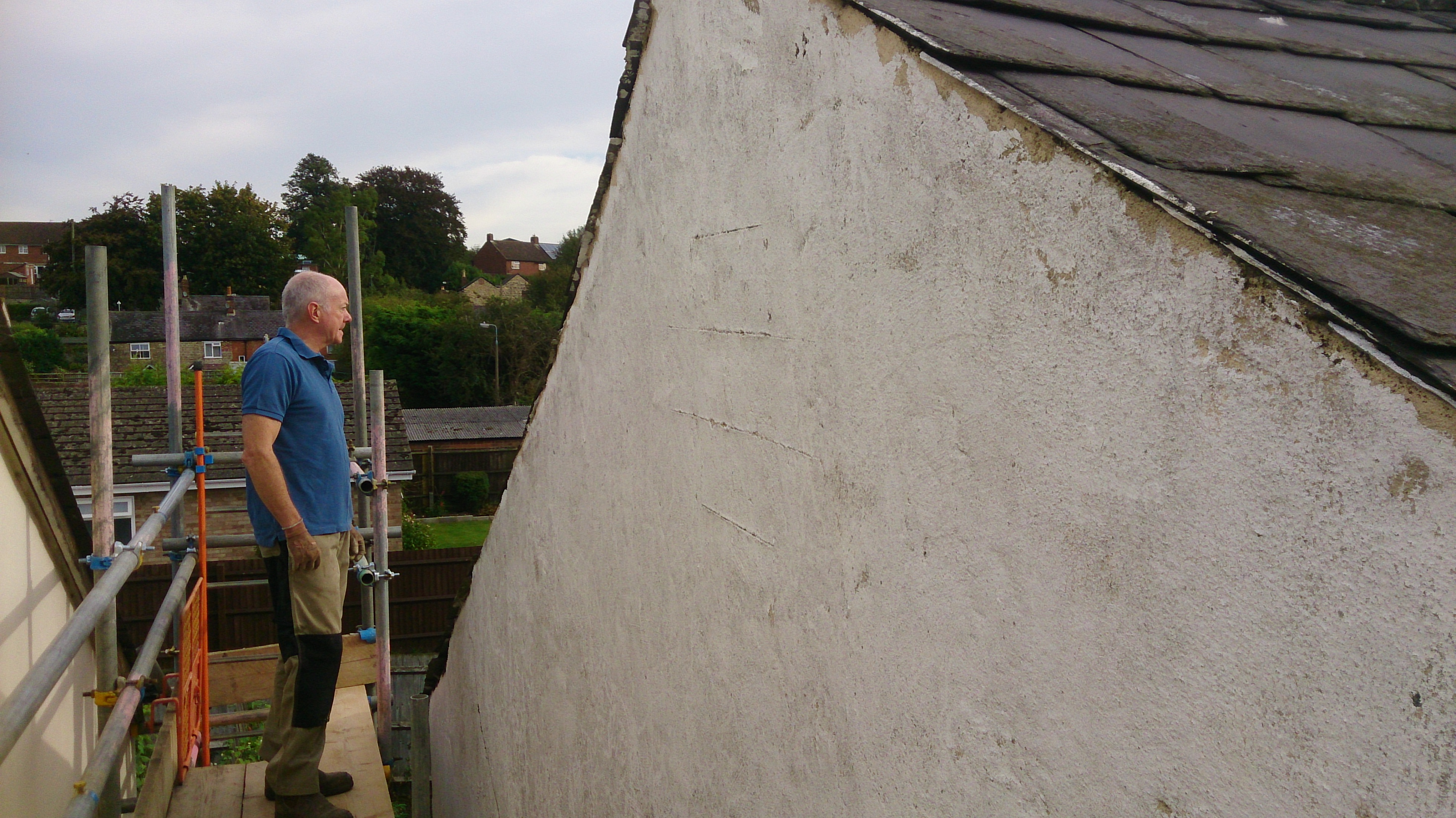

We have been doing various things, fitting in with our usual work but nothing major; we are waiting for the builder to arrive to start the outside work. the scaffolding has been up for 2 weeks and the builder should have been there at the beginning of the month but its nearly the end of Sept and no sign yet.  I have been chasing him up and he promises to be there tomorrow......
We want him to repair the top of the gable wall and add an internal pillar in the attic to support the single brick wall, repair the render and check the overhang of the roof, which isnt too good.  As well as repoint the chimney breast.  The great thing of having the scaffolding is that we can get a better look at what needs doing.
There is one point where we can see the wooden battens, there is a gap of about 2 inches at the worst place.
the end ridge tile is completely loose and the next two look like they'll be loose too. there is quite a lot to check but hopefully not too much unexpected.

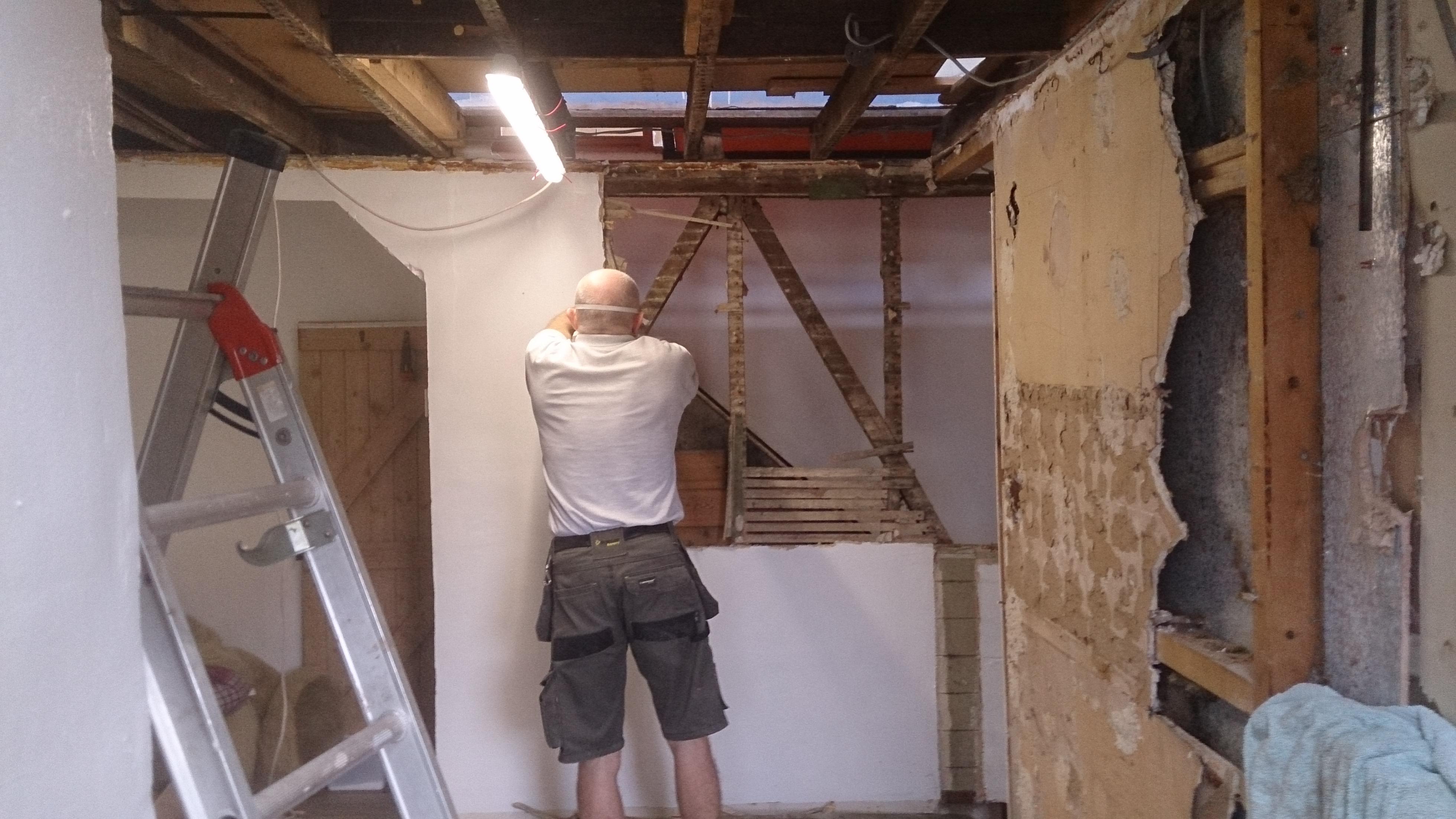

We have tried it in all sorts of places but for various reasons, it just didnt work anywhere. And after an Estate Agent came round, we are reasonably happy to leave it on the ground floor, next to the middle room. He was not too concerned and said that while families would rather have a bathroom upstairs, it was less of a problem for young couples, which is likely to be our target market.  However, that then created a problem in that the middle room is quite dark and small and it does not work with the small kitchen. The obvious solution is to remove the large pillar and wall between the two rooms.  But as it holds up the whole of the thick rubble back wall of the house, its not an easy undertaking.
So as well as maybe removing the pillar to open up the kitchen and middle room, creating larger, more usable space, we plan to add a sunpipe to the top of the stairs and then open up the stairs into the middle room.  That way, there will be loads of light coming into the centre of the house which we hope will add to the sellability.
It didnt take the OH long to open up the stairs.  and it looks great.

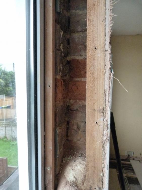

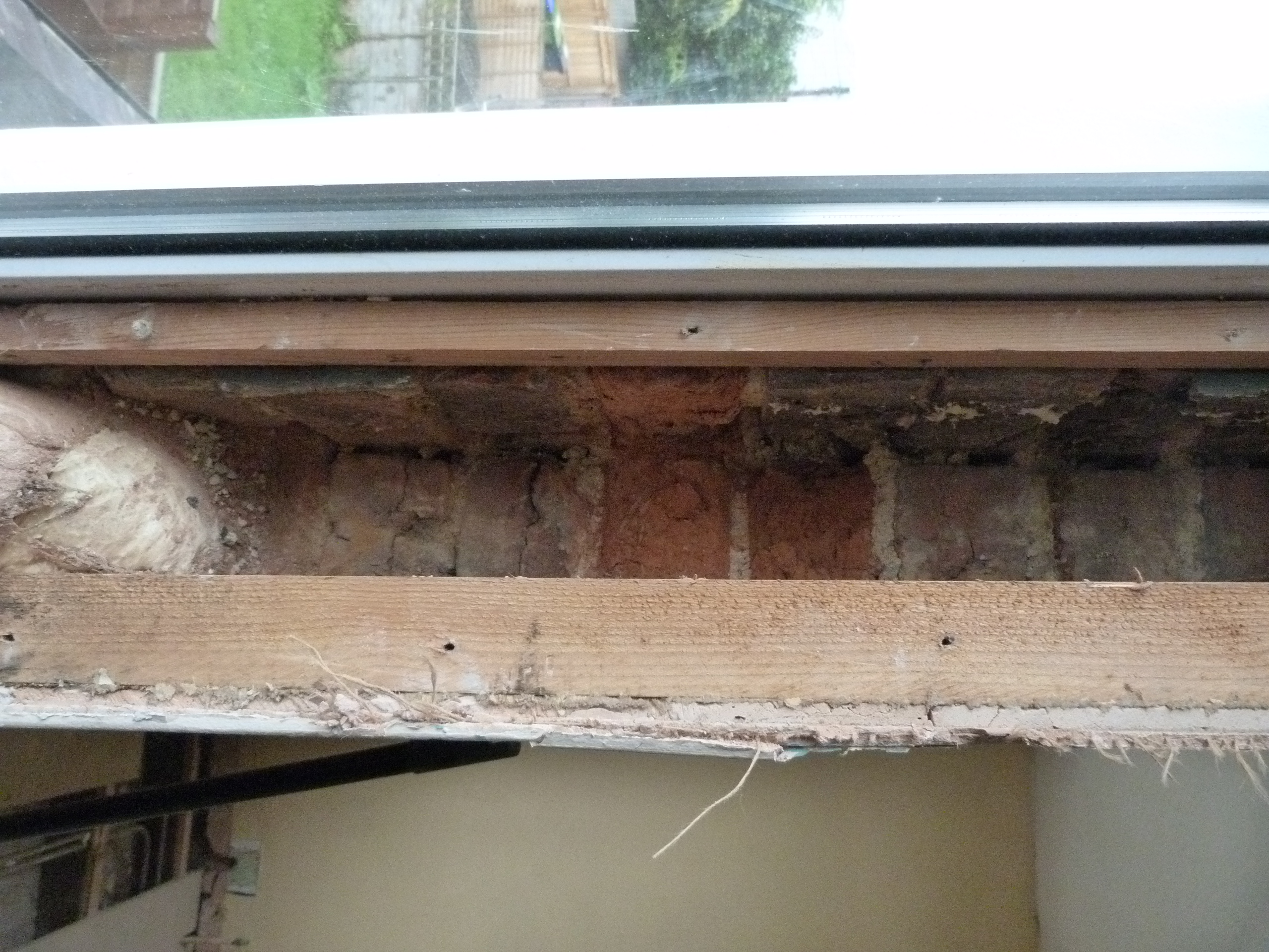

One of things that amazes me about this house is the fact that it is still standingO.o.  Almost everytime I remove some plaster, I find holes - lots of them. And loose bricks/rubble.  This is the top of that pillar between the kitchen and dining room - the one holding up the whole back wall of the house.
There are bits of wood, gaps, loose bricks!  And below is the upstairs front bedroom window.  I assume someone changed the size of the window and bricked it up - but why didnt they brick it up both sides, rather than just the outside??

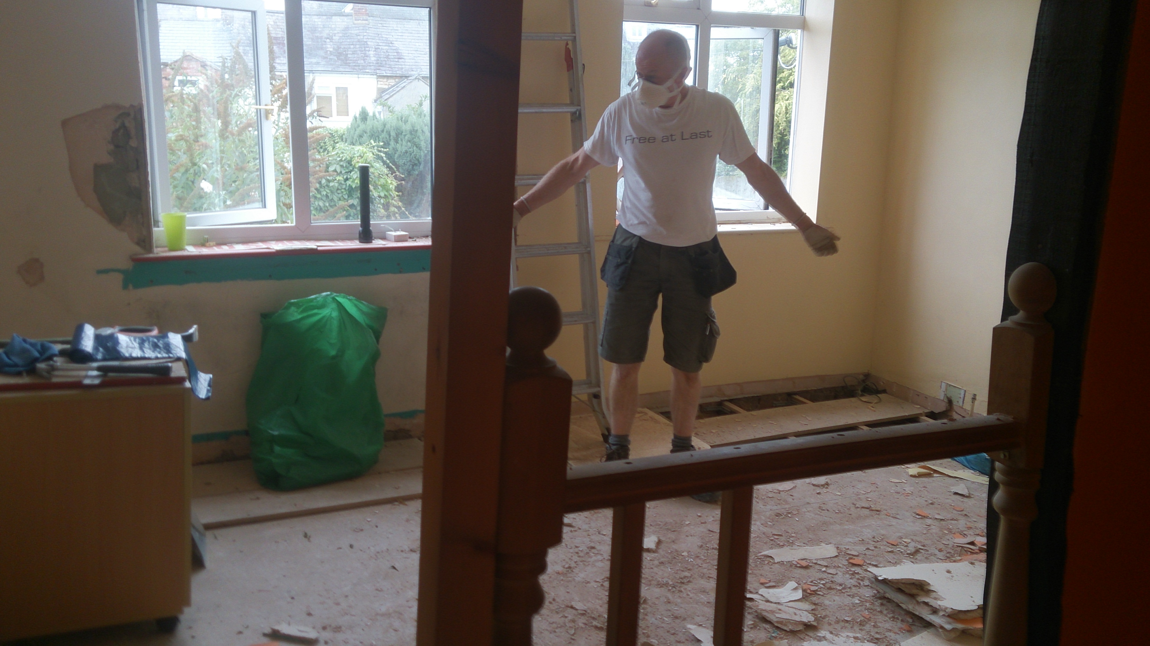

The last thing to report is that we now have a 2 bedrromed house instead of the 3 bedroomed that we bought.  We had great fun the other weekend, removing the stud walls from between the front two bedrooms.  Both were too small to be of any real use and openign them up has created a lovely large room.  The estate agent agreed that two large bedrooms was a better idea for this house - it will not be bought by a family that needs the extra bedroom and if whoever buys the place really needs it, they can always put the stud wall back again.
