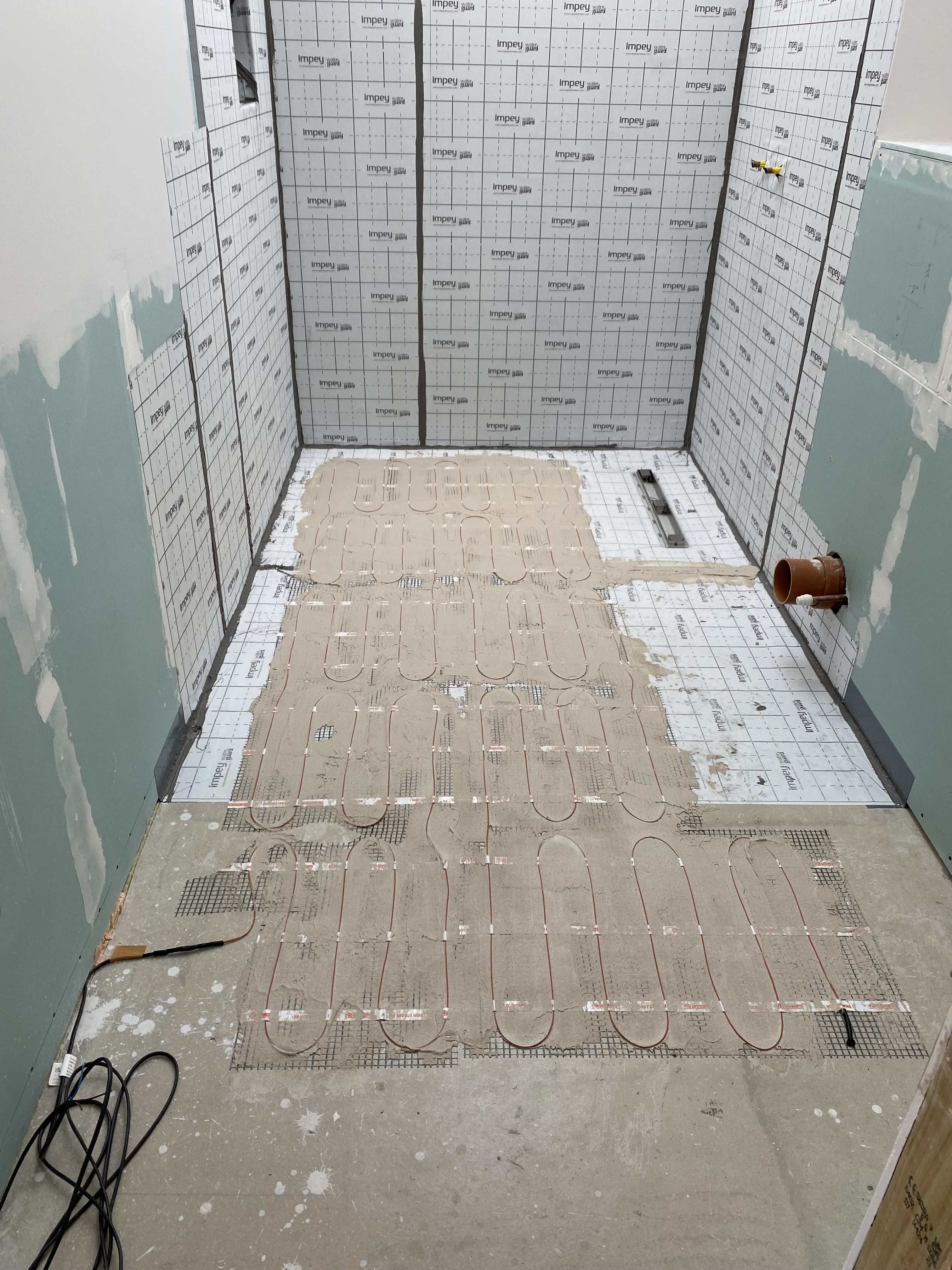

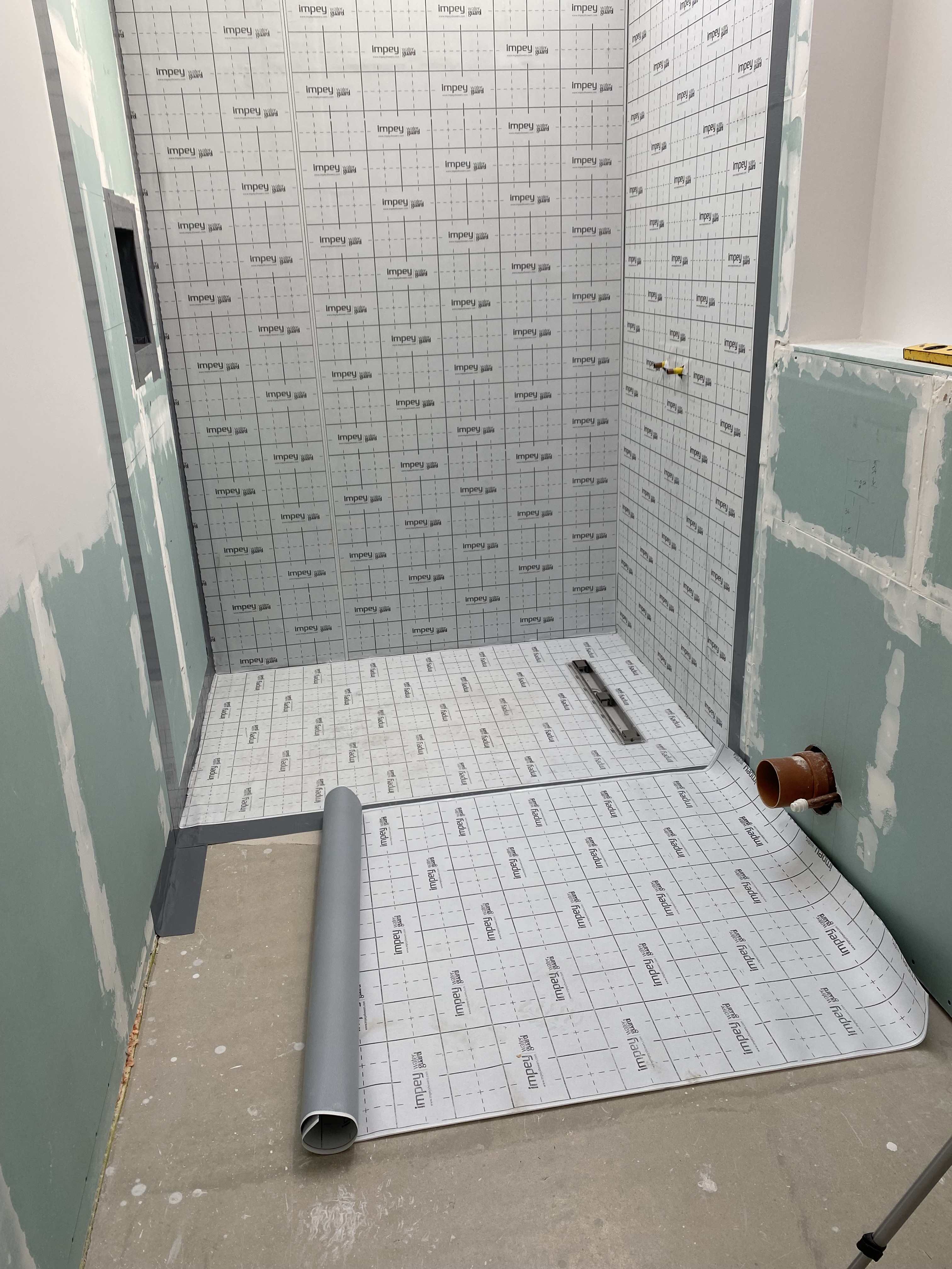

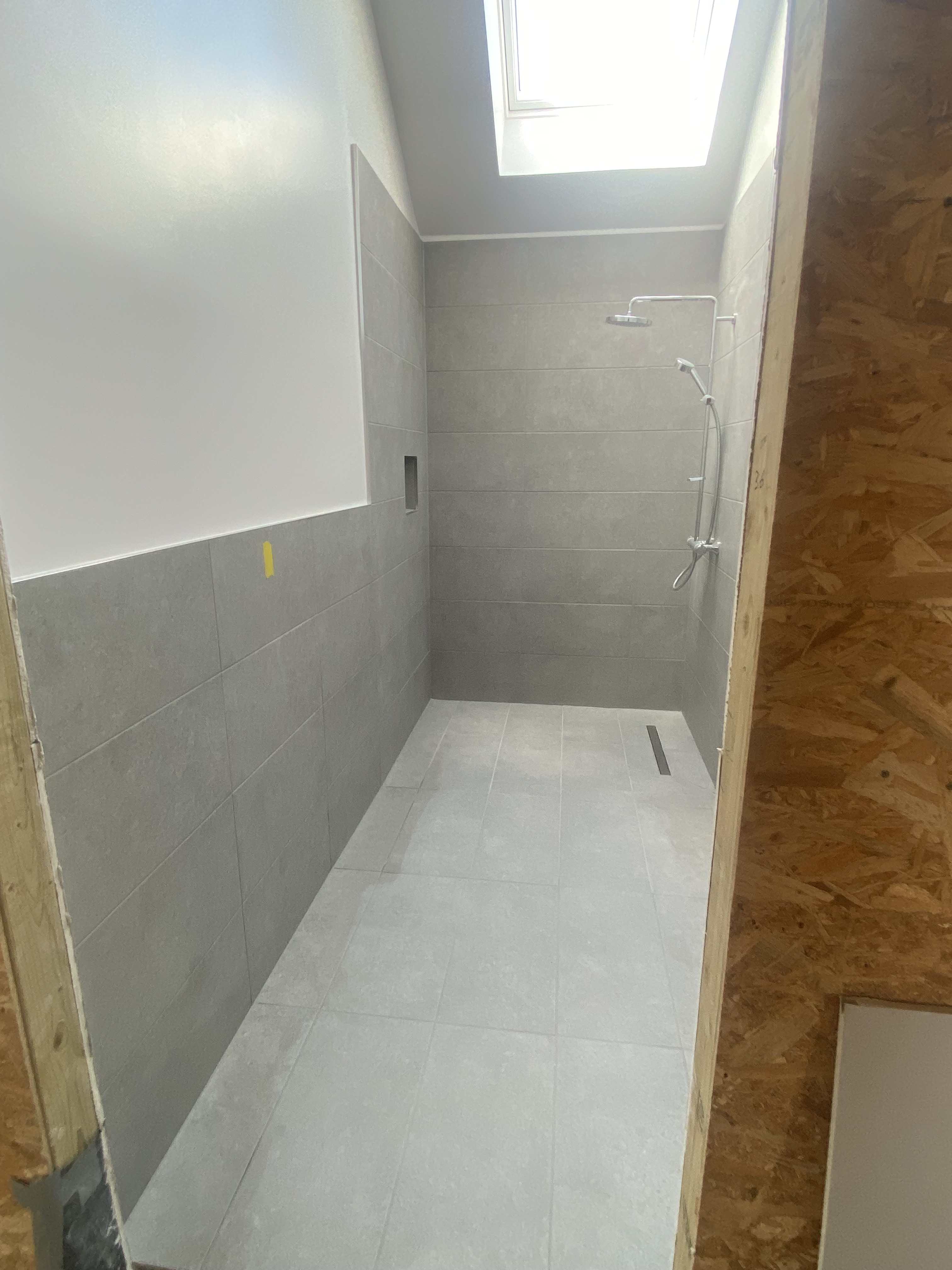

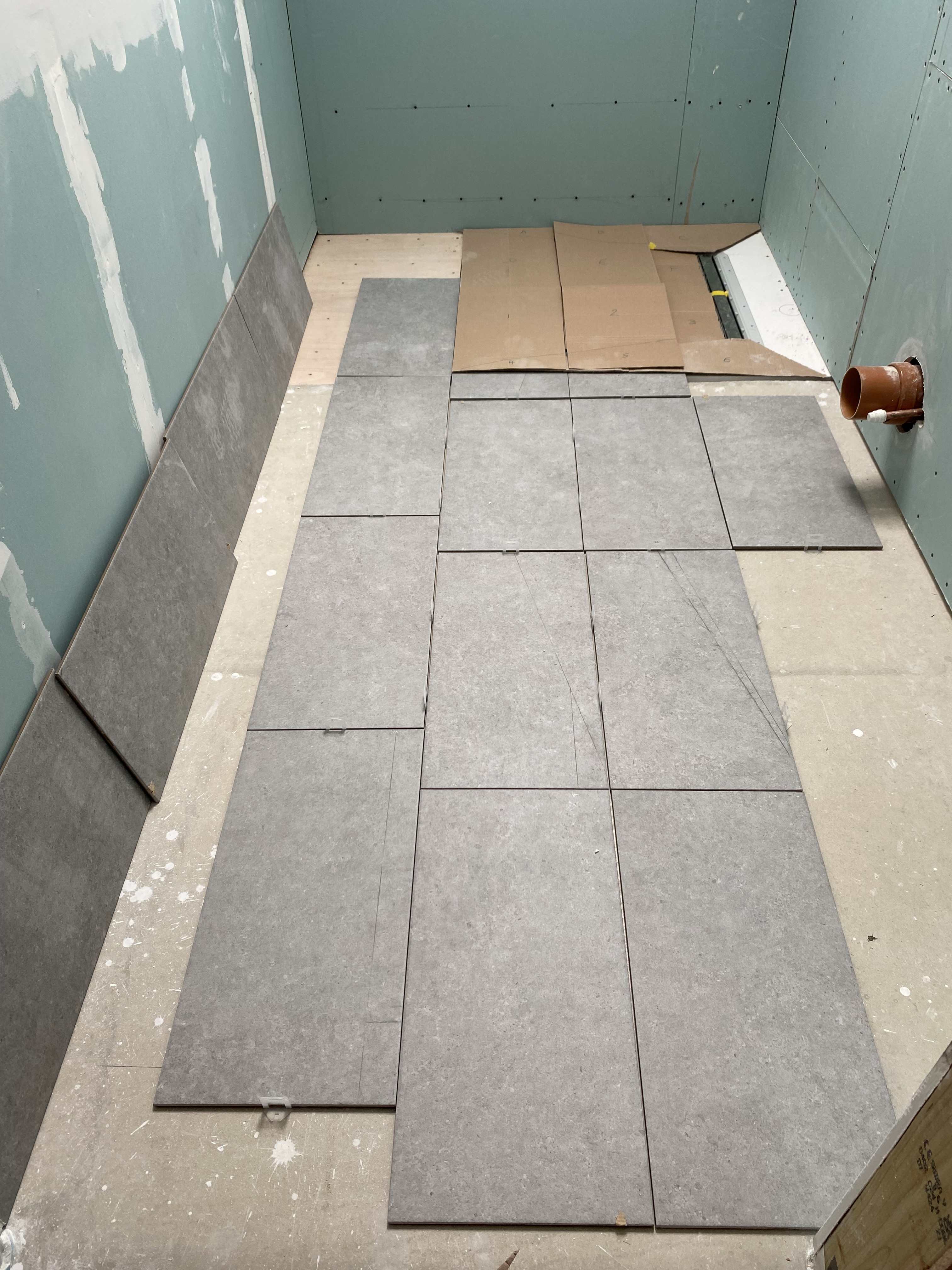

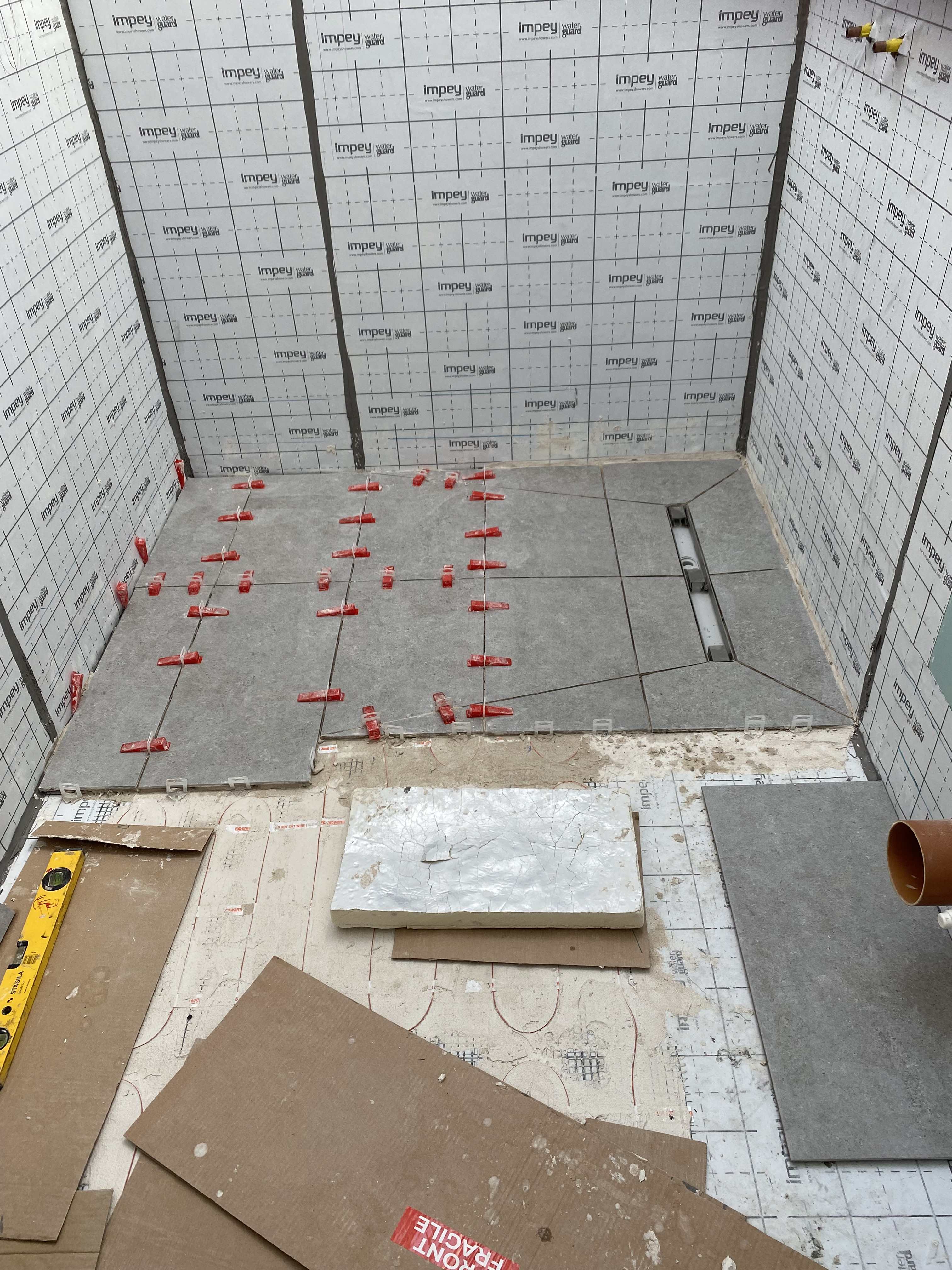

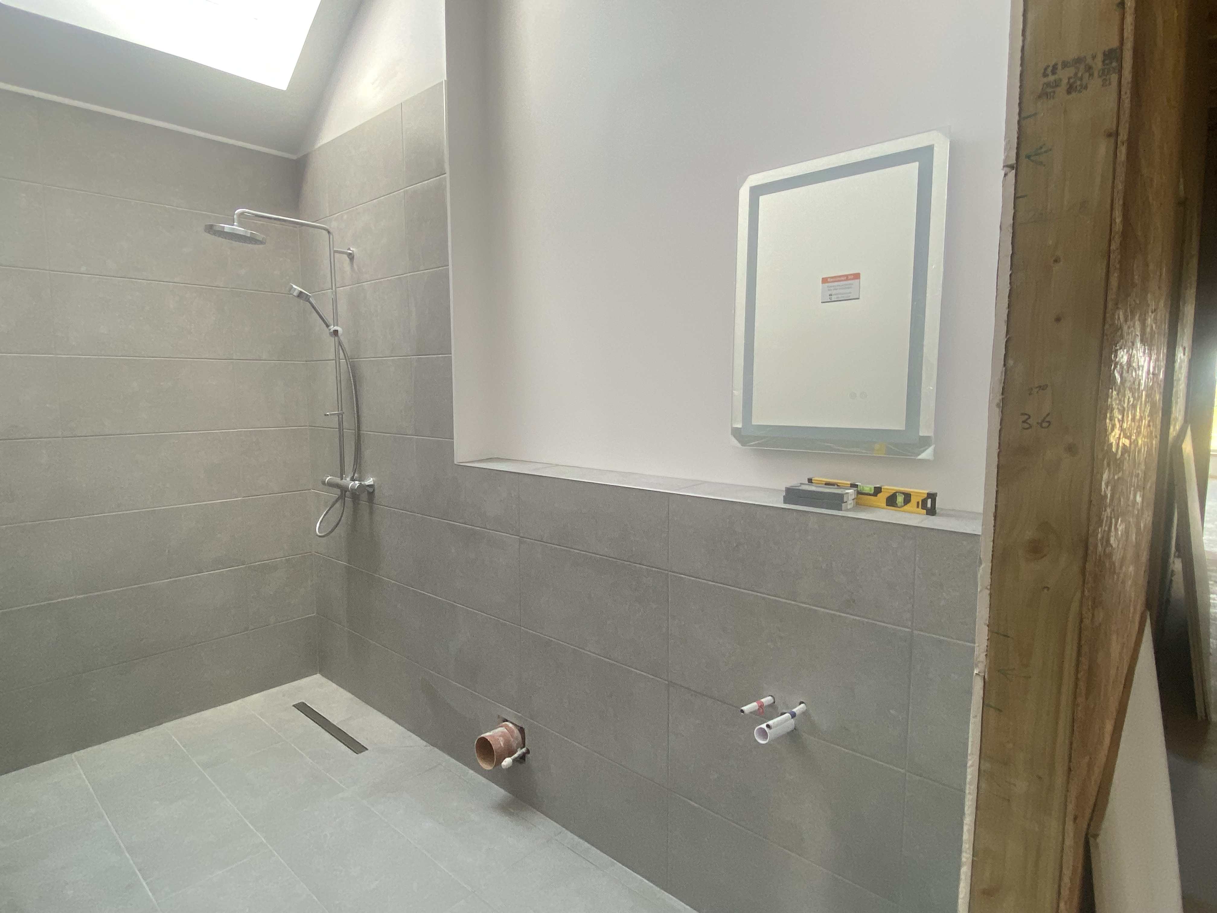

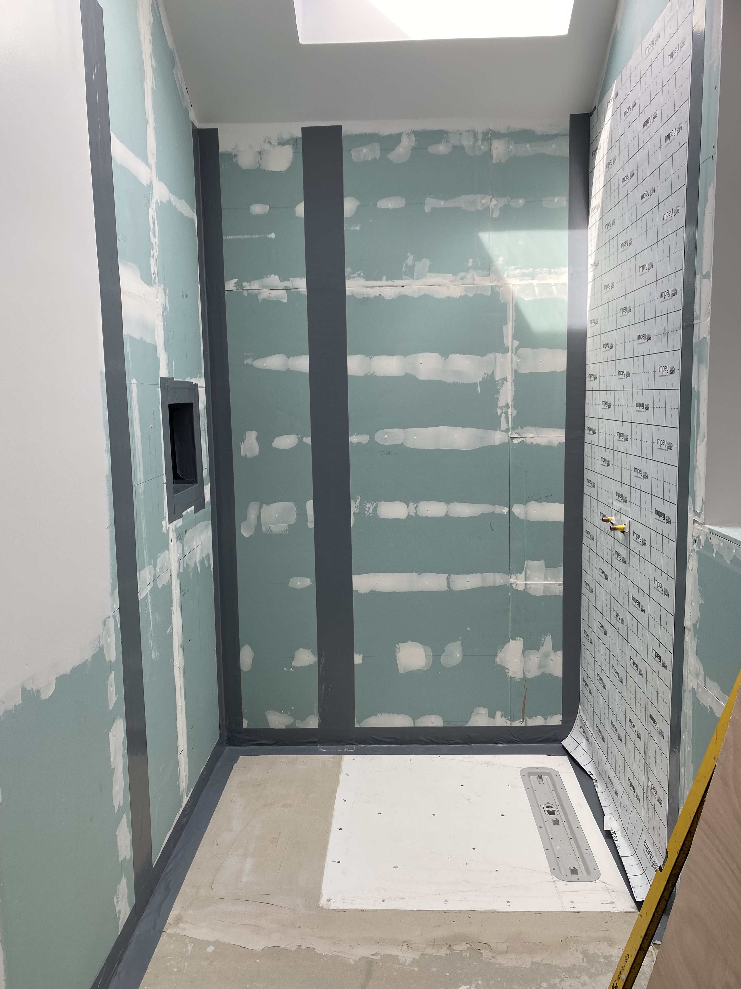

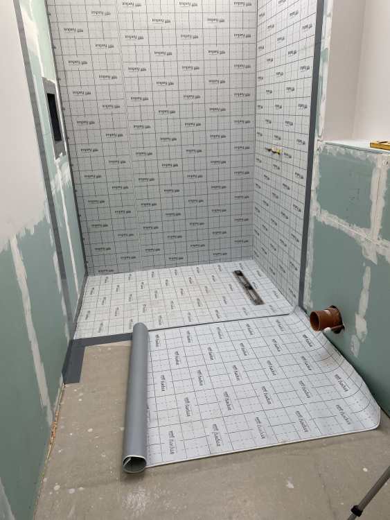

In May we started in the Bathroom.  It took us almost a month to first fix plumbing inc wet room former, create stud wall behind sink and toilet, plasterboard, tape and joint and then paint.  By mid June David handed the bathroom over to me and I was dry laying the floor tiles out it took me a while as you may remember the plant room floor was the first floor I had ever tiled and I was about to cut larger, heavier, more expensive and diagonal cuts, Oh and it was a wet room.  Once I was happy with the tile layout I used Impey water guard system on the walls and the floor.  I chose Impey because the former has a sort of backup weep system in that should any water get through the grout on the floor it will drain on top of the membrane and has weep holes in the long trap to escape.  I was a bit nervous about unrolling a sticky membrane on my own but I found that ok with the laser for guidelines and just removing a bit of the backing at a time.  The sealant that you use in-between the membrane joints on the other hand was the most sticky and messy sealant I have used.  Particularly on the floor I could not help getting a bit of tile  on the floor/wall joint or the toes of my shoes (when kneeling down) in the sticky sealant days later.  I had read on Build Hub about this being sticky but had not comprehended how messy compared to other sealants. On the 24 August I handed the bathroom back over to David to fit the shower, toilet, sink and mirror.

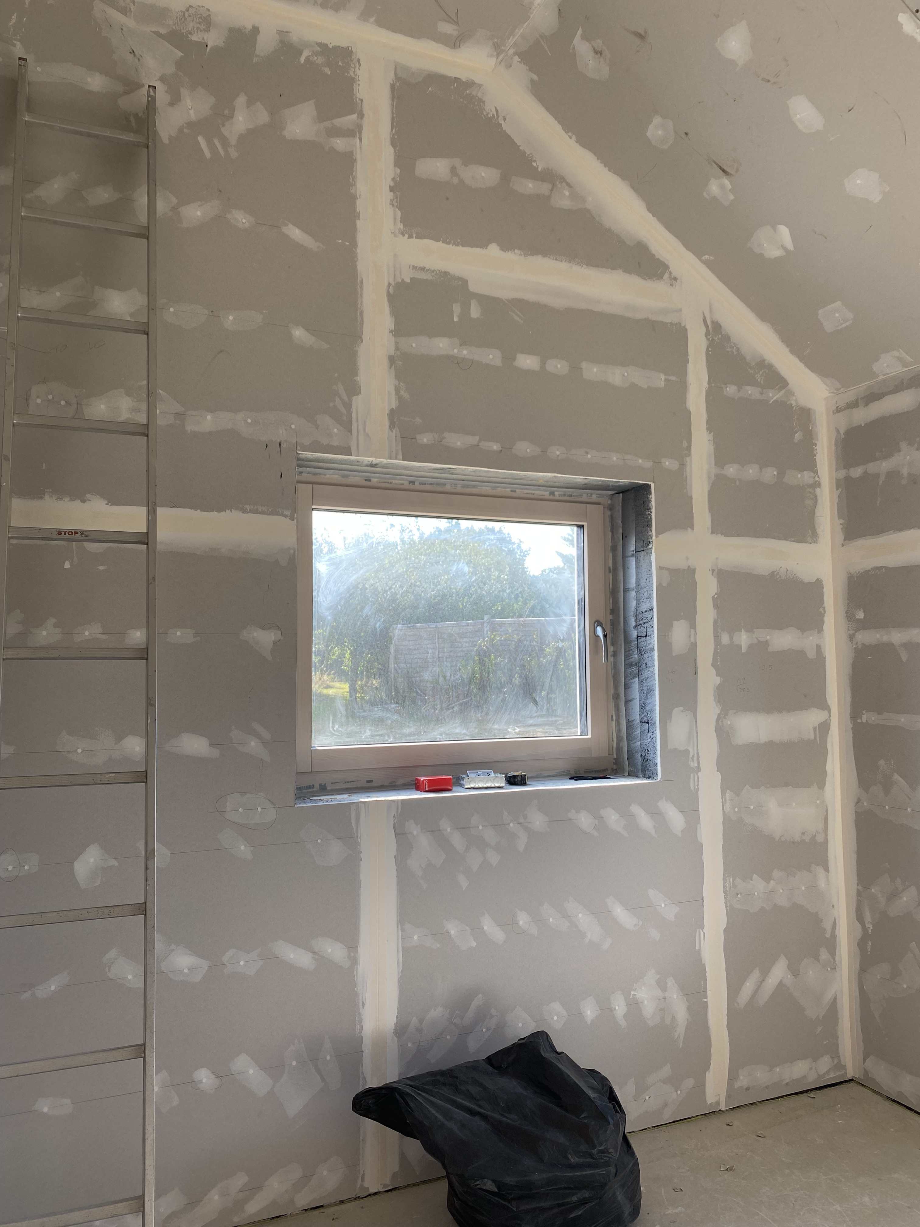

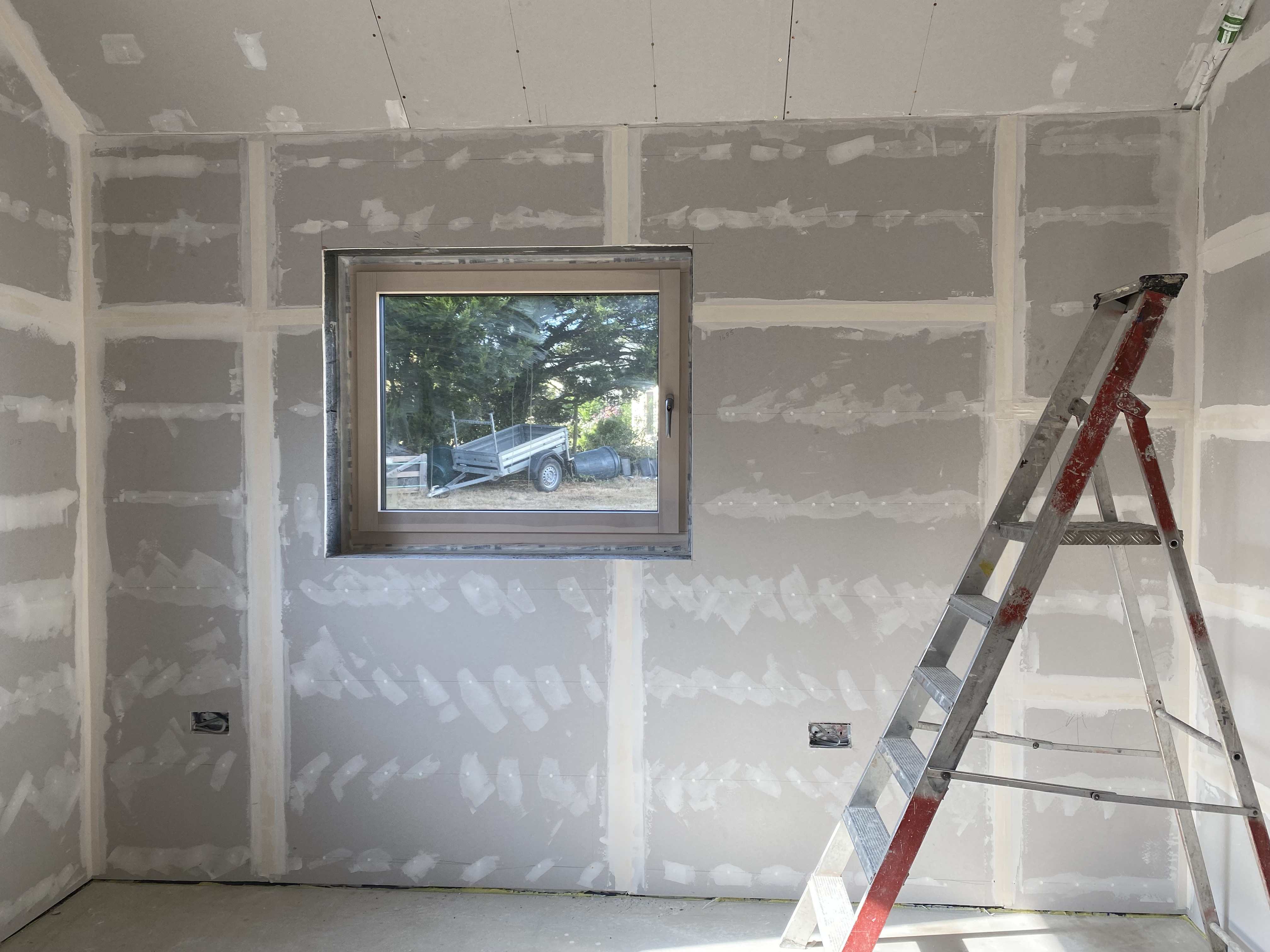

Whilst fitting the bathroom David and I also put the plasterboard up in the front bedroom so that once the bathroom was finished I could move straight onto another room with the plasterboard jointing.  I have started this and the photos are the end of the first coat so tape not covered yet, screw heads one coat.  Could be a while before I carry on with this.

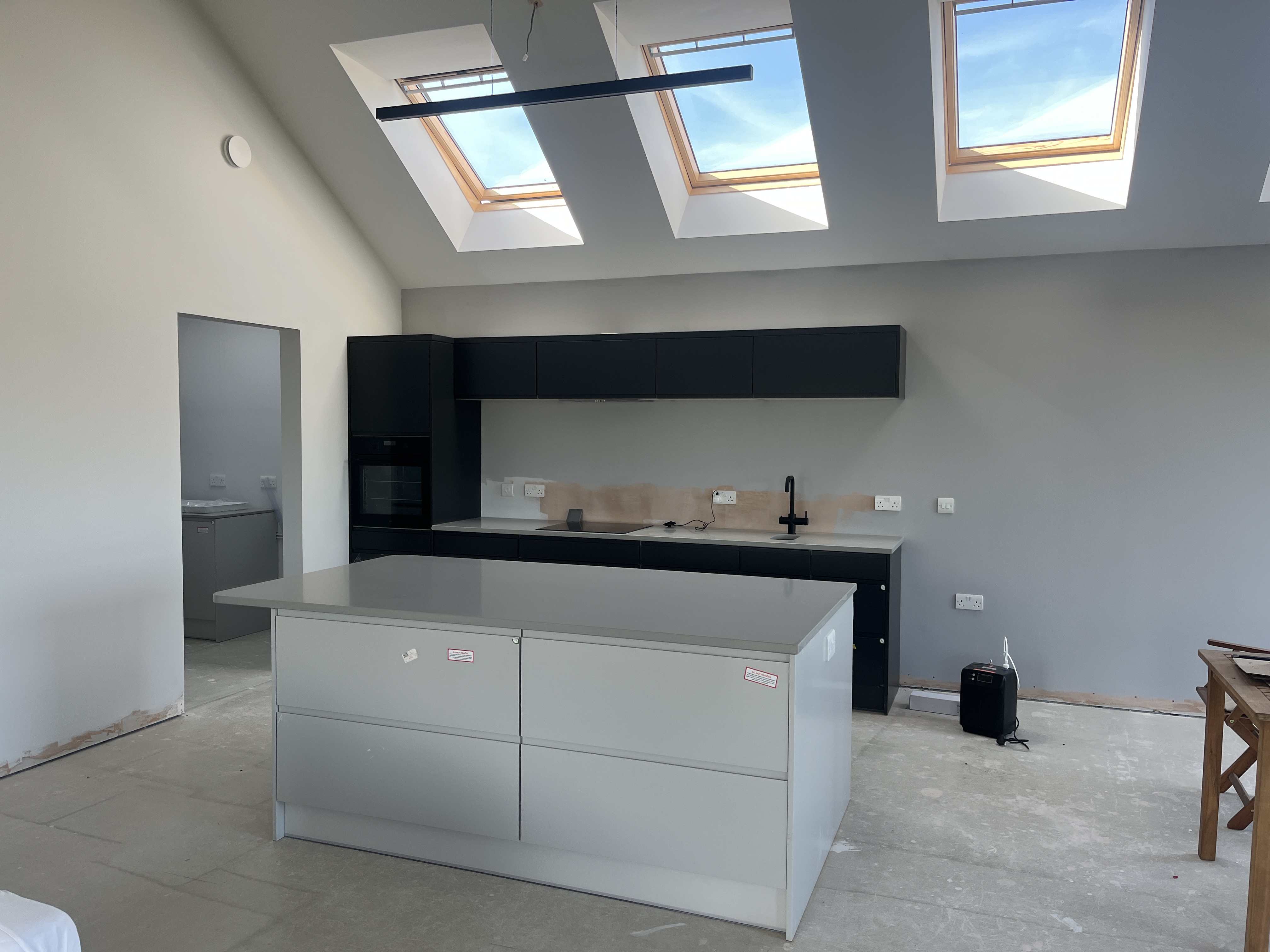

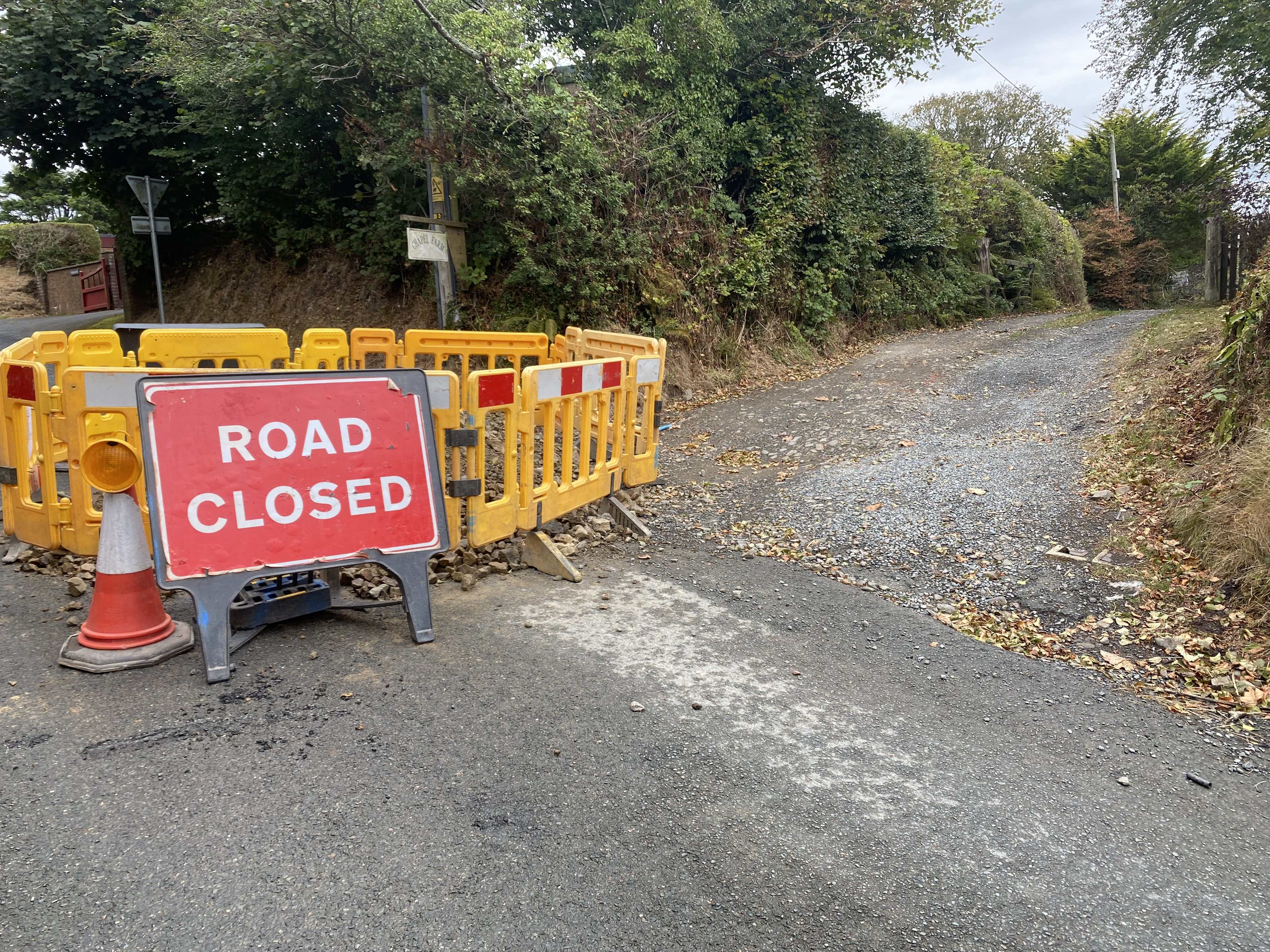

David has fitted the kitchen and pantry and the worktop was fitted by Wren.  Our water connection has been completed this required a small road closure which had to be completed during school holidays as its the main route the children use who walk to school.  The 3 phase electric supply has been moved from the temporary location into the house and we will now start looking for our supplier.  We are still temporary connected to the house we live in as the solar on the new build is feeding the old house this will be changed to feed the new build hopefully only a few days  before we get the supply connection.  Openreach are here at the moment installing our line.  The original plan back in 2023 designed and plotted by Openreach was to connect to an electric pole on the border with our neighbours where our electric also comes from.  The electric company have recently stopped new connections to their poles, (I don’t know if this is everywhere or just local) so although its been coiled up at the pole a few years from when we made the temporary electric connection, we now had to find a new route.   This meant finding our existing connection that was underground (from a different pole) breaking into this and pulling a few meters of cable back from its coiled up position to a junction box with the existing house cable, or digging up the shared drive and laying the cable back to another pole that already had a connection on it.  The timing of this meant we had only just dug a trench down the side of the drive for the water, had we known earlier about the change made on new connections to poles we would have obviously laid the cable at the same time as the water.  A big thank you to open reach who I think felt sorry for us as had one of my emails been answered in June (when I wanted to check were still putting copper in the ground)   we could have laid a cable down the drive, unfortunately new connections sent me round in a few circles but the current solution is ok for now.  I guess eventually we will pull a fibre cable in and presumably they will use the copper cables to pull the new fibre though.

Can I ask what might be a daft question - why do you need to tape and fill the boards so carefully if they are getting plastered later?  Is it an airtightness thing?

Only the open plan area got the skim coat of plaster, that was due to its height and it would have taken me forever to tape and joint all on my own.  All other rooms are getting tape and joint by me then painted.  When I have taped and properly completed all the jointing and sanding stages I think it’s as good a finish as the skim plaster.  Not every one will agree with that but I believe in Scotland it’s mostly tape and joint and in other countries particularly Canada that’s pretty much all they do.  It’s definitely won’t change the airtightness as we are ICF so our biggest airtight challenges are the eves, service penetrations, doors and windows.
Square Feet
Great, thanks. That makes sense.

Well done. Amazing work. That wet room is fantastic! I have one yet to do on the ground floor, and have drawn inspo from your beautiful tiling :)

It took awhile to choose the tiles as we wanted Grey in an R11 slip rating and for UFH. It’s the same tiles on the walls and floor but the Velux makes them appear slightly different.  We got quite a few small samples posted to us then less than two months later the tile we chose which also had an accent tile to match they stopped making the accent tile. Luckily we hadn’t ordered so just went with the plain tile for walls and floor in a size I could pick up and it worked. I will probably choose R11 again as they do feel good underfoot.
