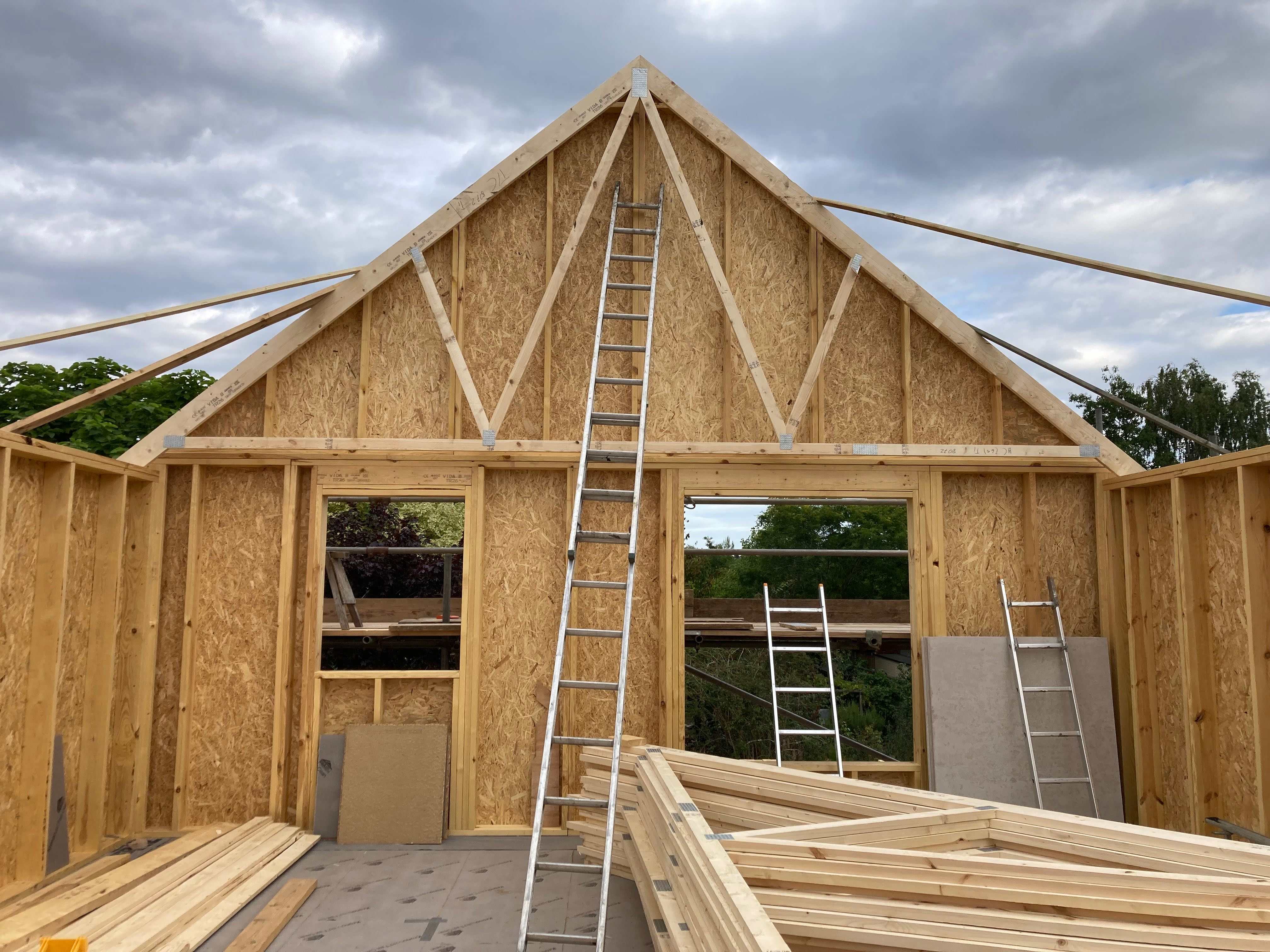

On Friday we were ready in good time for the roof trusses, all 19 of them. Two powerlifters from Andy the boss arrived just as the lorry backed onto site.  It’s almost like it was planned.  They took one look at the job, shook their heads and took up positions.
It worked like this (after a couple of false starts):
Driver on lorry pushes ends of truss to edge of lorry.
Shortest guy on site grabs end furthest from house and has the job of stabilising the truss.  It’s at this point I realise why I need platform steel toecapped boots.
Short tempered power lifter grabs end of truss nearest the house.
Truss is run towards house like a pole vaulter on speed.
At last second short tempered power lifter pushes his end of truss skyward.  Shortest guy at back of truss grunts and struggles to keep truss upright whilst swearing, profusely.
Truss end is caught by other power lifter (the smiley one) just before it lands on the upstairs floor.
Smiley power lifter drags truss upwards as shortest guy is dragged along the ground with it still trying to keep truss upright.
Rolly and smiley place truss neatly on rapidly growing pile.
In total there was 31 minutes between lorry arriving and the truss pile being completed - if my pics weren’t time stamped I’d not now believe it. That made even the short tempered power lifter grin.
IMG_8579.thumb.jpeg.6d50cf64dcb29c210ecda03941698aca.jpeg     IMG_8578.thumb.jpeg.bfeaf42738851e3035d970d9f47fc908.jpeg
To finish the week while I continued fitting cement boards Rolly prepped the first truss for a test fitting.  Getting the first truss up felt good, really good.  That made me grin.
