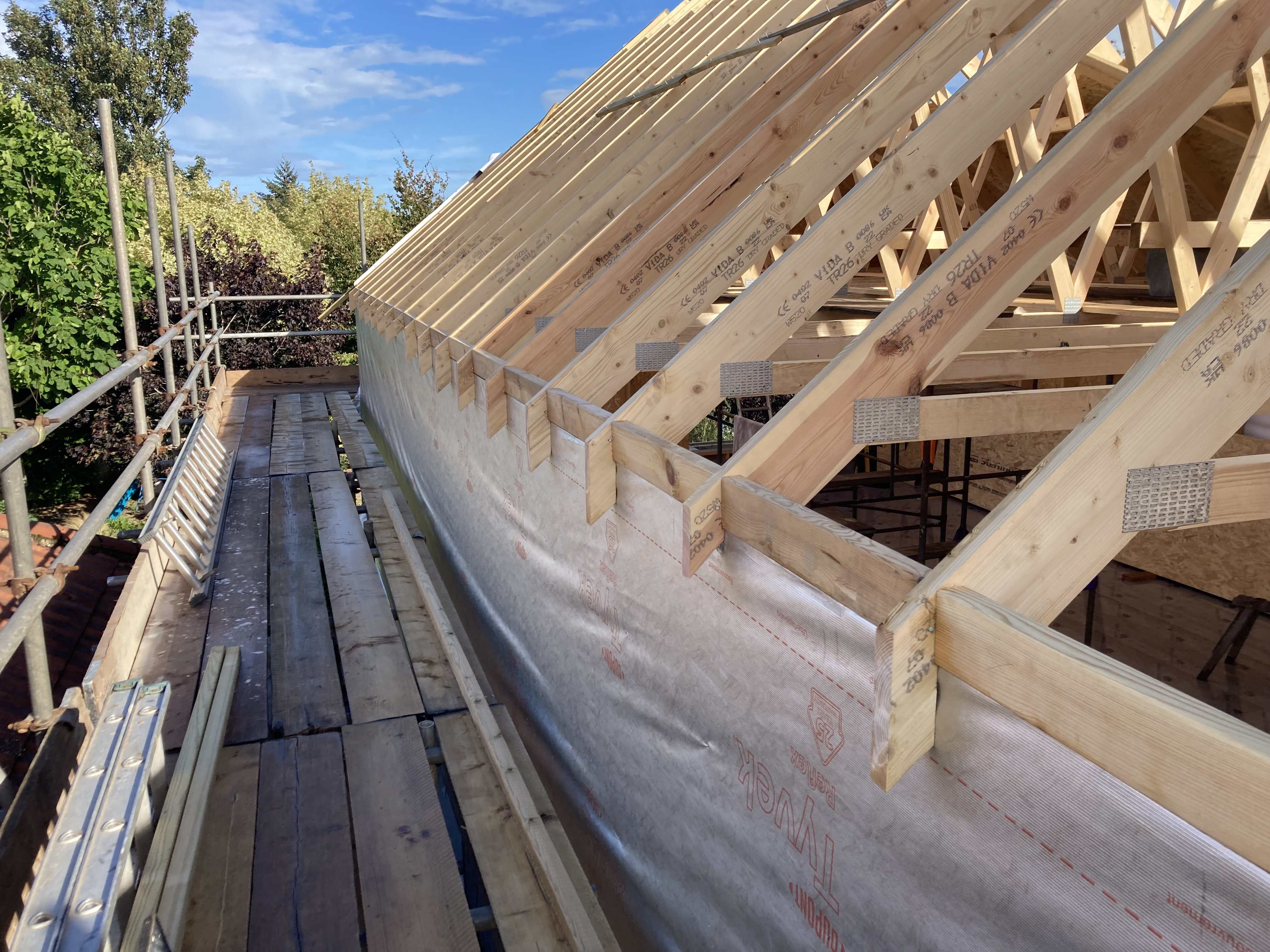

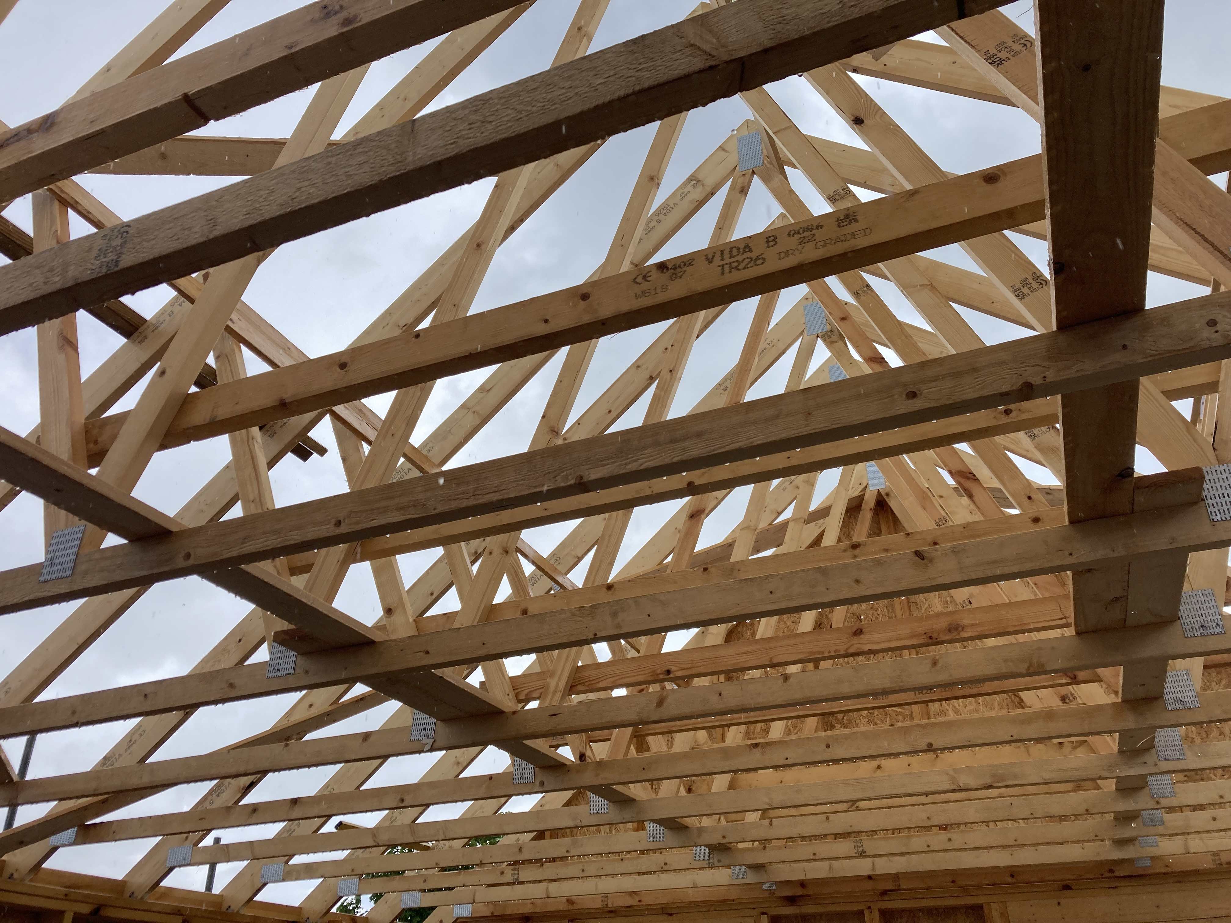

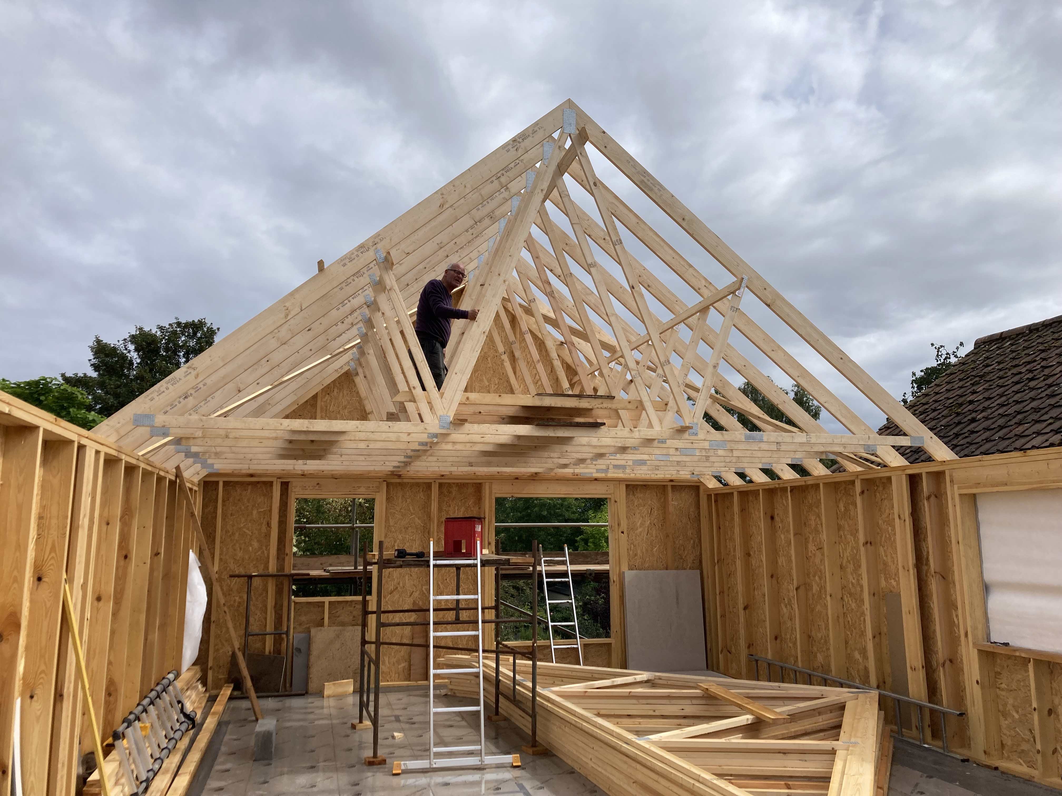

In the case of our design ‘a head’ meant a full set of trusses, all braced as per, a layer of OSB (a softy southerner version of sarking), anti everything mesh closing the continuous ridge vent, the eaves bunged up with timber, and the flue hole cut and the attic bits of the flue in place and the final length ready for erection.
Rolly the chippy and I had discussed in great length how to put the trusses up.  They were in a pile on the upstairs floor needing the bird’s mouths to be cut.  We concluded we needed more hands to do it.  At this stage we both nod, look round, remind ourselves that we are alone, then stay silent till one of us gives in and says “shall we give one a try anyway?  See how we get on?”.
That’s the danger of two peeps working together who each refuse to believe they can be beaten.  So, Rolly cut the bird’s mouths on three trusses while I pointlessly thought through different lifting options for a pair of old codgers whose combined total age is 140 years.  If only I’d bought a chinook.
Anyway, there we stood, each end of a truss, silently psyching ourselves up.   That was brought to a close by a series of half sentences, which we took turns to utter.  Things like “well, we could lift this end onto the plate, then, ummmm….”; “would a rope, sort of….”; “could the scaffold tower help with, maybe, erm….”.  We were facing certain defeat, or at least, the need for help.  Where was my octogenarian neighbour when we needed him. Visiting friends in Europe, actually.
So we did the only thing left to us, we applied good, old fashioned BF&I.  (A core skill of mine, as it happens.)
We fluffed it twice, each time returning to the starting position.  I’m not sure an onlooker would have been able to discern any difference in approach between the three attempts, apart from facial redness growing by each failure.  But attempt three worked.    Hussah!
We sort of repeated the same process, each time making small changes.  By the time the eighth truss went up, as I mopped up the blood (I’d bashed my nose) I wondered what on earth we’d found so difficult.
Rolly then did his orang-utan impression, while nailing the bracing on to give us a firm set of trusses to build from while I tidied and generally fussed, pointlessly.  It’s amazing how a couple of well nailed cross members stiffen an otherwise wobbly set of timbers.  That done we continued getting more trusses up.  With each one it got easier with practice but harder with less room to work with, ending up with three trusses bunched at each end that we walked to their position once all was up, Rolly on the scaffold outside, me on my tower inside.  Simples.
By the end of that day we had got all the trusses up and braced enough to get through the expected storm, v pleased.

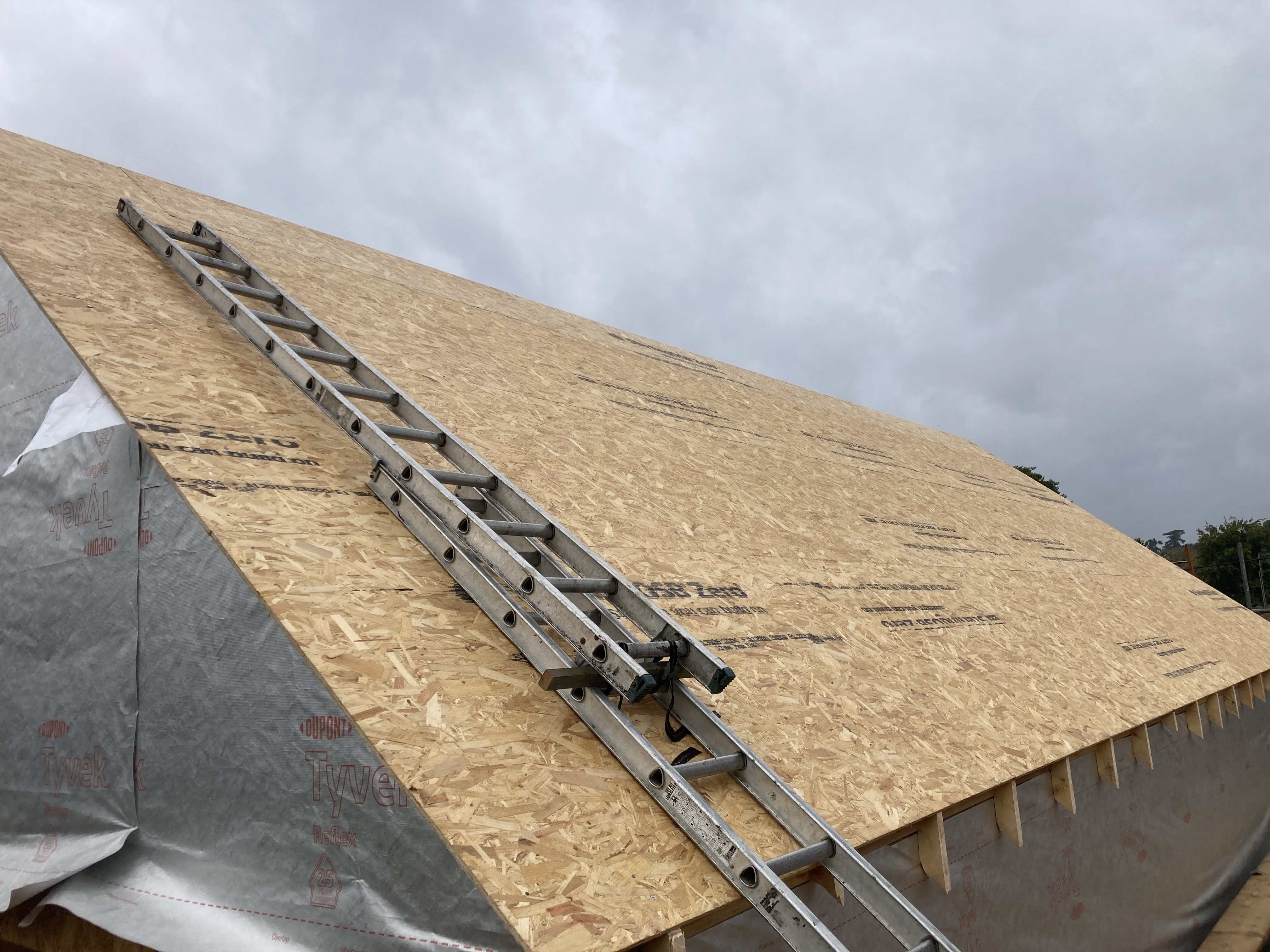

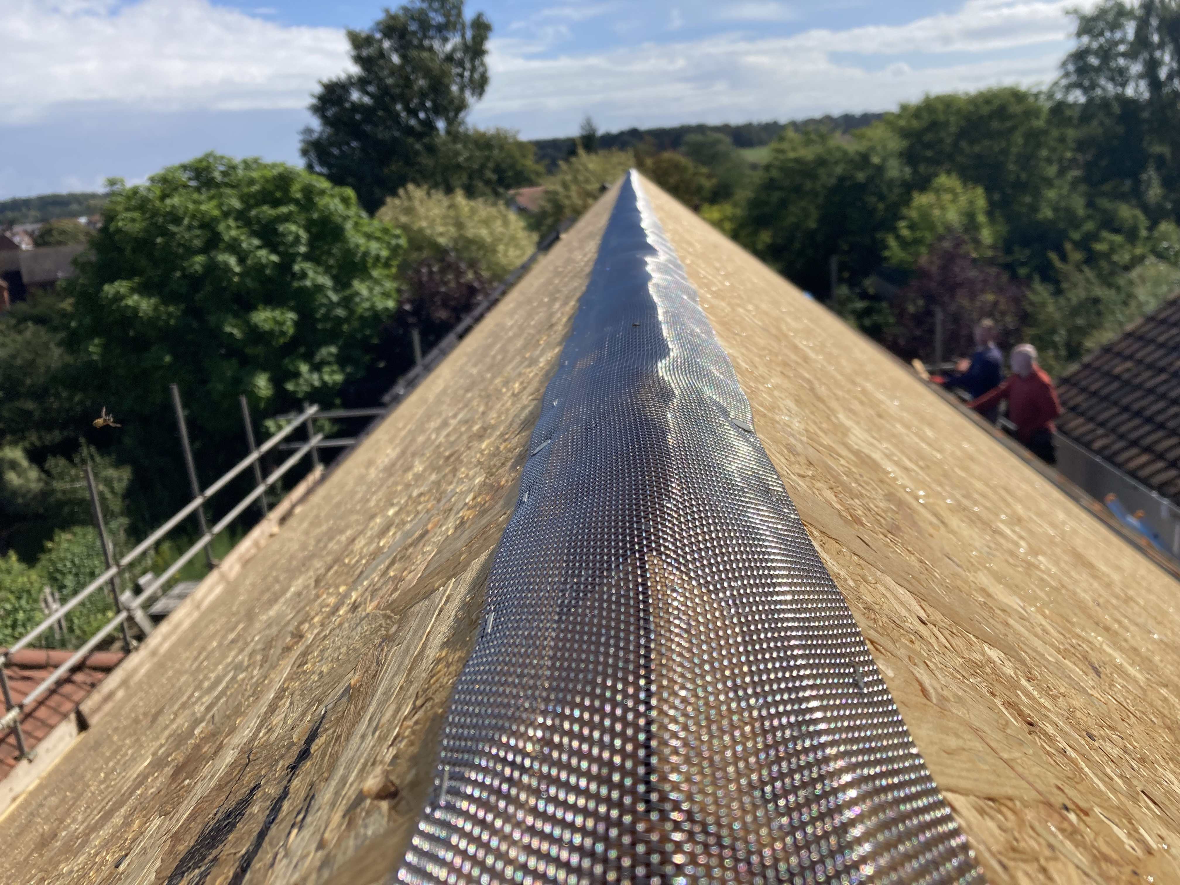

Dean and I got a bit of the OSB sarking on when it dried up, while Rolly closed the eaves, so it wasn’t a complete wash out.   Next day Rolly and I got a rhythm going and got loads of sarking up, using ropes for security, leaving just the top rows each side which were thankfully half bits.

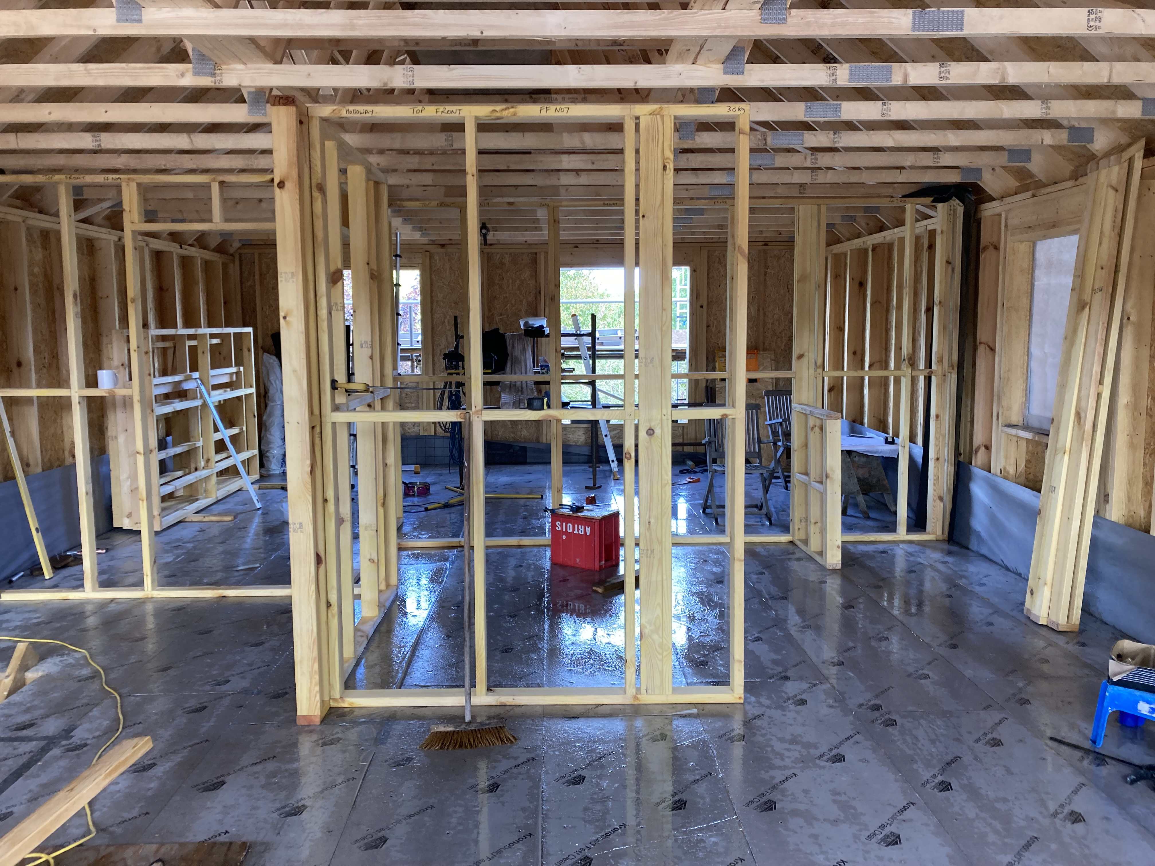

So next day, with nearly a complete layer of OSB on, we discovered how useless sarking is at keeping rain out.  Cue yet more depressing sweeping water off of the upstairs floor.  Yet even in such circumstances illumination is to be found.  Tony trays.  You thought they were just for keeping the air in, but no! they are far more versatile: they keep the rain in too.
With a flat surface like an upstairs floor however fast one sweeps torrential rain towards the stairwell much of it reaches the walls. When it hits the Tony trays it is skilfully guided round the end of the joists and then down the inside walls.  Of course, this is good news especially when one has carefully stored lots of stuff out of the rain, neatly stacked round the edge of the downstairs walls, as all that dry and dusty stuff gets a good cleansing rinse in pure rainwater.  All my paslode nail boxes are now papier-mâché, which doesn’t bloody help.  The best laid plans and all that.
And the delays meant that the plan was starting to look too tight.  We had a day to get the rest of the sarking on and a few other bits and pieces done to be ready for the roofer.  Cue the cavalry - which in Suffolk can be a helpful neighbour.  Rolly did the clever woodworky bits while Dean and I got the top rows of sarking on.
Our scaffold is v thin on one side as we are so close to our neighbours, so I could only safely lay a ladder up the roof on the other side.  We’d used a roofing ladder for the lower rows but that didn’t work for the top row as the hook was in the way of fitting the boards.  So we laid a normal ladder up the roof, and then I laid on the roof, feet atop the ladder, while Dean attached each sheet to a rope and pulled it up to me to fit in place, first on my side then on the other.  Worked a treat and with Dean holding the rope we had a backup against the gusts of winds which was never really used but was a comfort to have anyway.
IMG_8603.thumb.jpeg.9fa58626f348059fde20248a6bc01b56.jpeg     IMG_8614.thumb.jpeg.6ac2f66b9324a78257db9a63f2086bfe.jpeg
Actual safety verses perceived safety is fascinating.   As I lay on the sarking getting ready to pull up the next board, waving at a regular passer by (who took another picture), Dean took one look at me, perched on the top of the ladder and asked if I was sure it was safe.  “No”, I said, “I’m at significant risk of bashing my thumb with my hammer”.  If fall off the ladder AND I didn’t keep one hand on the top of the last fixed board I’ll collect the odd splinter as I slowly slide down onto the scaffolding.  Our 40degree pitch means one cannot walk on the OSB but it did mean I could hold myself in place with one hand very easily.  OK if I did slide I’d swear a lot but we’d have a laugh about it after.  If I was monkeying about on a felted and battened roof the risk of falling through would be massively greater and much more dangerous.
In reality I was much more at risk of injury lifting panels on the slab - back injury, crushed fingers, etc.  But Dean saw height and that triggered his ‘oh my’ function, (he’s American so he says things like that and “do the math”, and “oh shoot”, etc. bless him), whereas he and I lifting panels didn’t bother him one bit.  Peeps (no names, no pack drill Rolly!) constantly leave stuff about which constitute trip hazards, and I’m regularly kicking them to the side or picking them up as I fear peeps tripping and the resultant injuries, which depending on what is there to fall on could be really nasty.  Hence my obsessive tidying and my Tidy Fridays.  It took me a while to realise if things get untidy I get a big knotty ball of anxiety in me that I just couldn’t turn off.  But everyone else wanders past the mess oblivious.  So my perhaps irrational trigger is disorder.  Go figure, as Dean would say.
Once I’d put the last bit on I treated myself to a sit down with a view, on the ridge.  I had been looking forward to that moment for many, many days.   My favourite place in our current house is on it, on the ridge to be exact.  The view is spectacular.  Turns out the new pad’s ridge view is just as good.  Sitting there, looking across the river towards the ancient burial mounds, even with the rain starting again, felt like the Pooliverse (any Perishers fans out there?) was telling me that it’s all ok, this is meant to be.
IMG_8633.thumb.jpeg.b8e0ef4523535037e3baf9fcfe49135a.jpeg     IMG_8631.thumb.jpeg.869909683b901581ba14b239cf68315f.jpeg

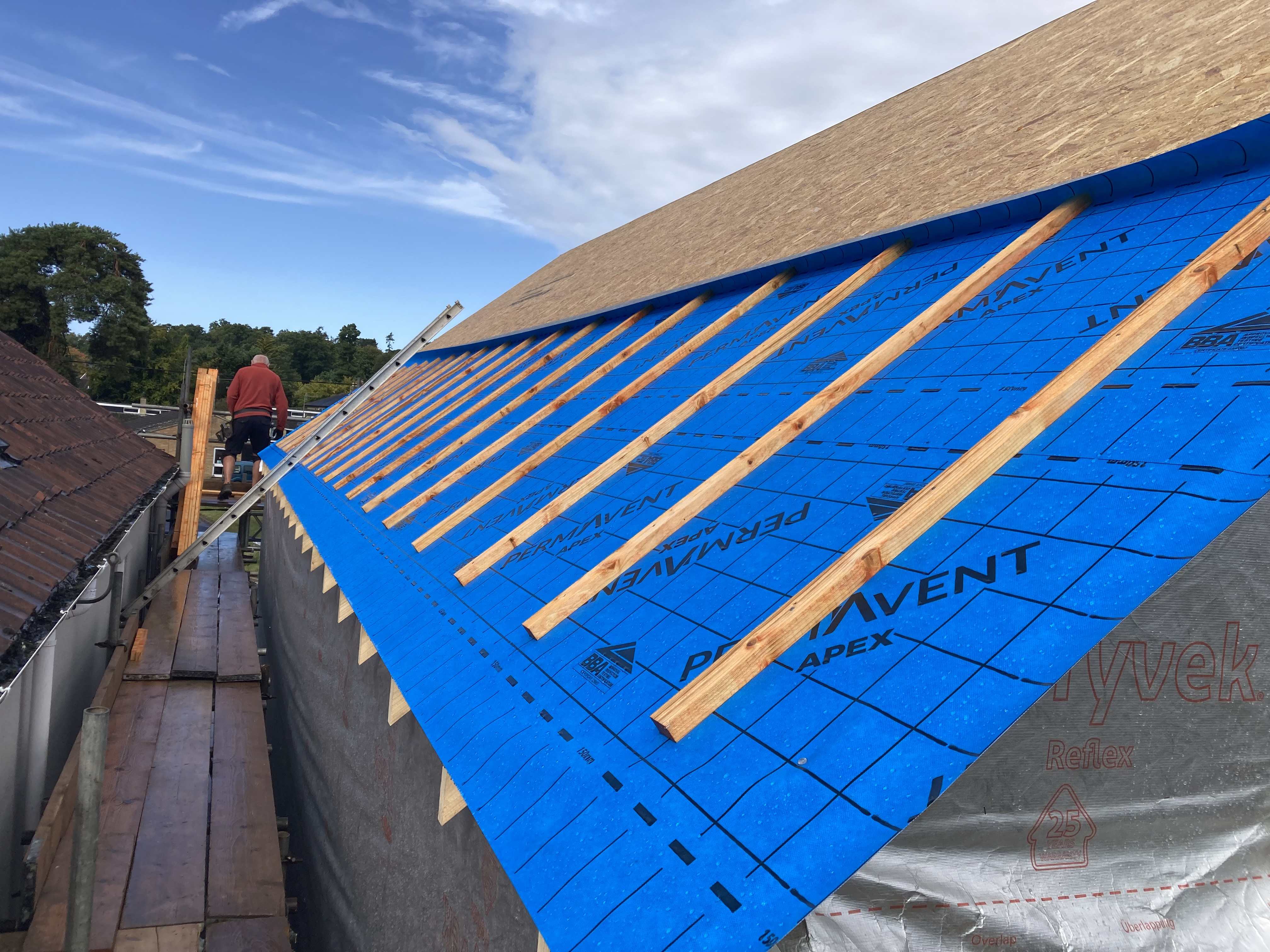

As the roofer arrived next day I was back laying down on the job, this time fixing stainless steel anti-everything mesh along the gap at the top for the ridge vent.  I was very glad to see him, until that is, he asked about the gable verge and soffit details.  They are as we agreed, I said, happily.  Only it turns out that he had no memory of our previous discussion and anyway he’s a visual sort of guy, rather than a discussion with drawings, sort of guy.  So I’ve simply no idea what he thought he was agreeing to the previous week, but we had to do the whole discussion again, this time with wood to mock it up.
Fortunately the end result was very similar to my original design, but sometimes trying to plan ahead and get things nailed down in advance in the building industry does feel like trying to buy spirit level bubbles - impossible, and at the same time a source of great amusement to others.  That discussion was had on the scaffolding in bright sunshine.  But grey clouds were on the horizon so that time wasted was bad news.
Two strips of felt later the heavens opened in one last assault before we put our hat on.  I guess the Pooliverse has a sense of humour which is hard to appreciate as one sweeps and sweeps and sweeps endless puddles away.  But the rain stopped and the roofer got back up there and we finally weren’t topless any more.

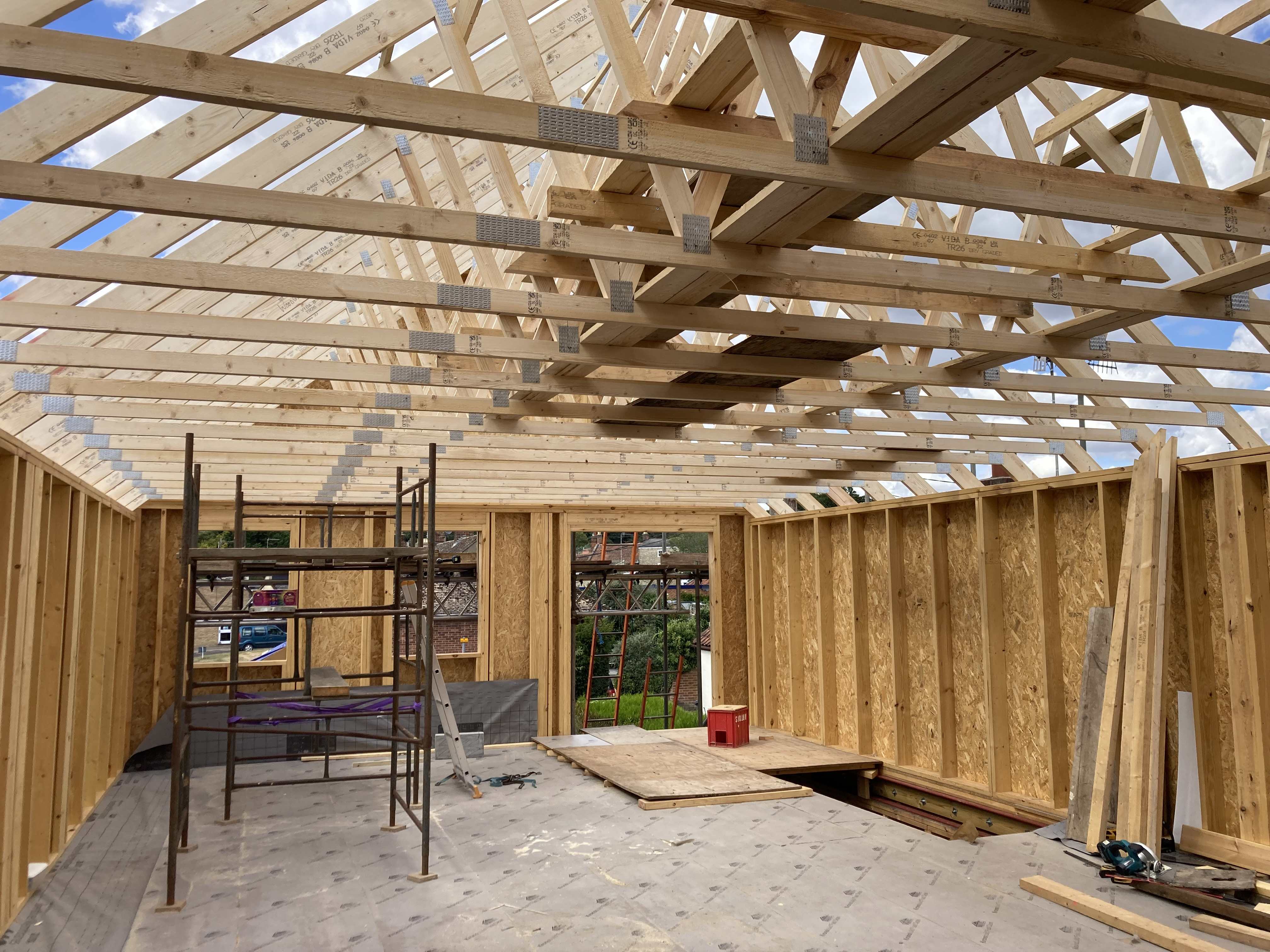

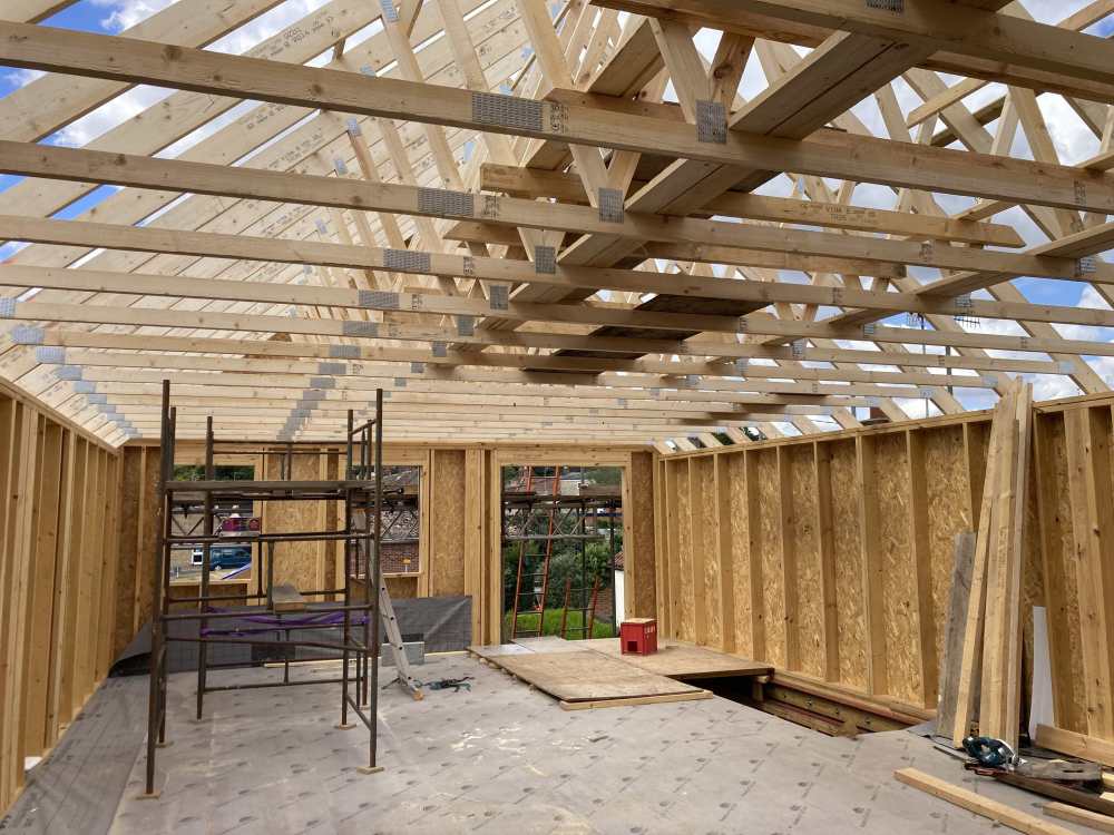

While the roofer roofed I carried on setting out my flue and while my back was turned Rolly threw up our internal upstairs walls.  Perhaps he wiggles the end of his nose, that would account for the speed.  We were slowed a lot by the joists being slightly not where I thought the plans showed them to be, (“what do you mean I can’t cut through a pozijoist?  I’ve big saws, of course I can!”), but a small (40mm) wall shift sorted the flue run and suddenly we’ve gone from wooden cathedral (micro version) to embryonic home.  Albeit a damp one.
