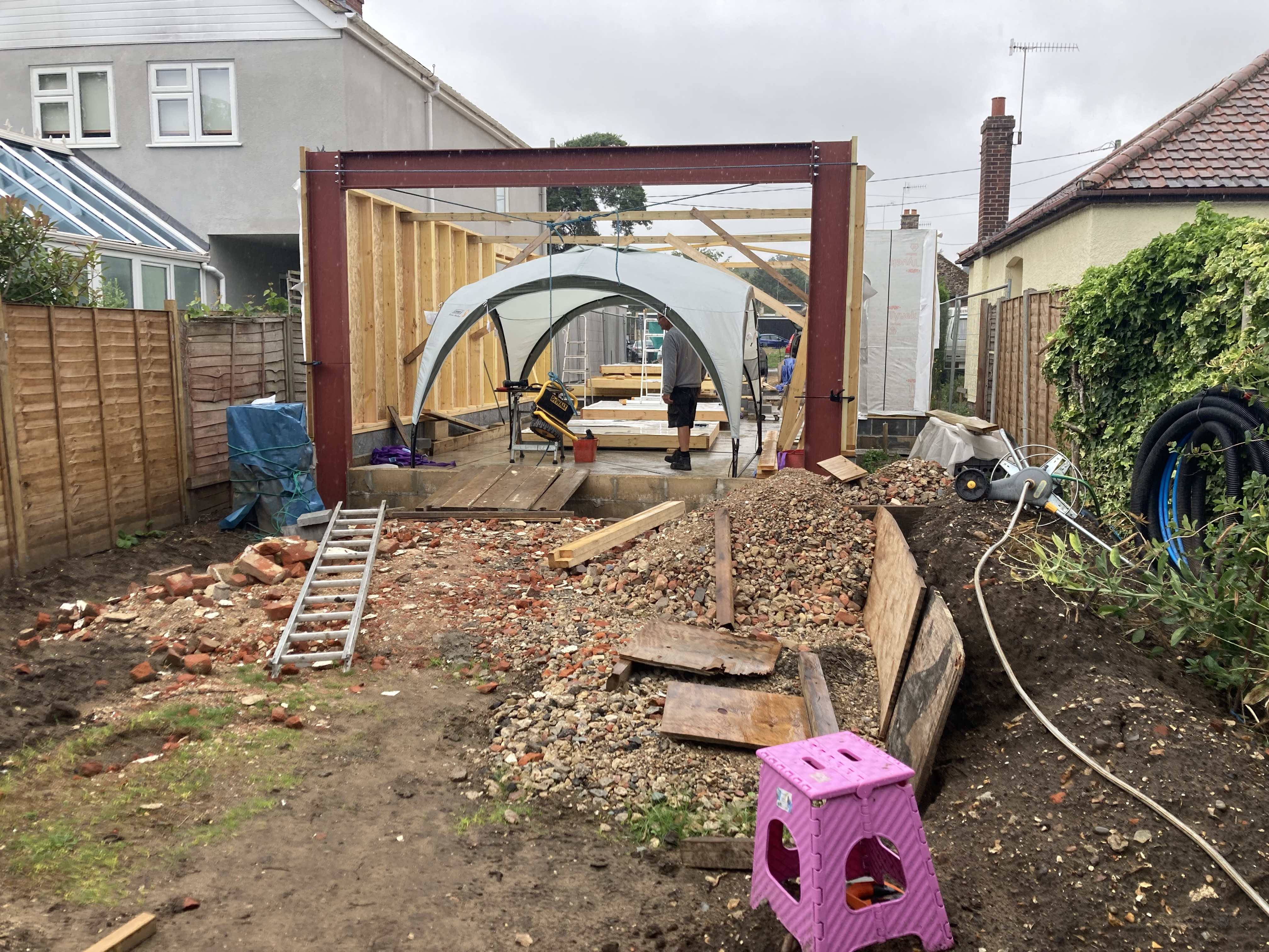

Our site is oversailed by next doors telephone and mains cable, and the front of the site has both kinds of wire strung across it too.  That’s why almost all of the timber frame companies I talked to at the self build show wouldn’t quote.  Just one SIPs company would but they gave every impression of not caring about minor details like feasibility, perhaps because with the prices they charge they could hire a Chinook.

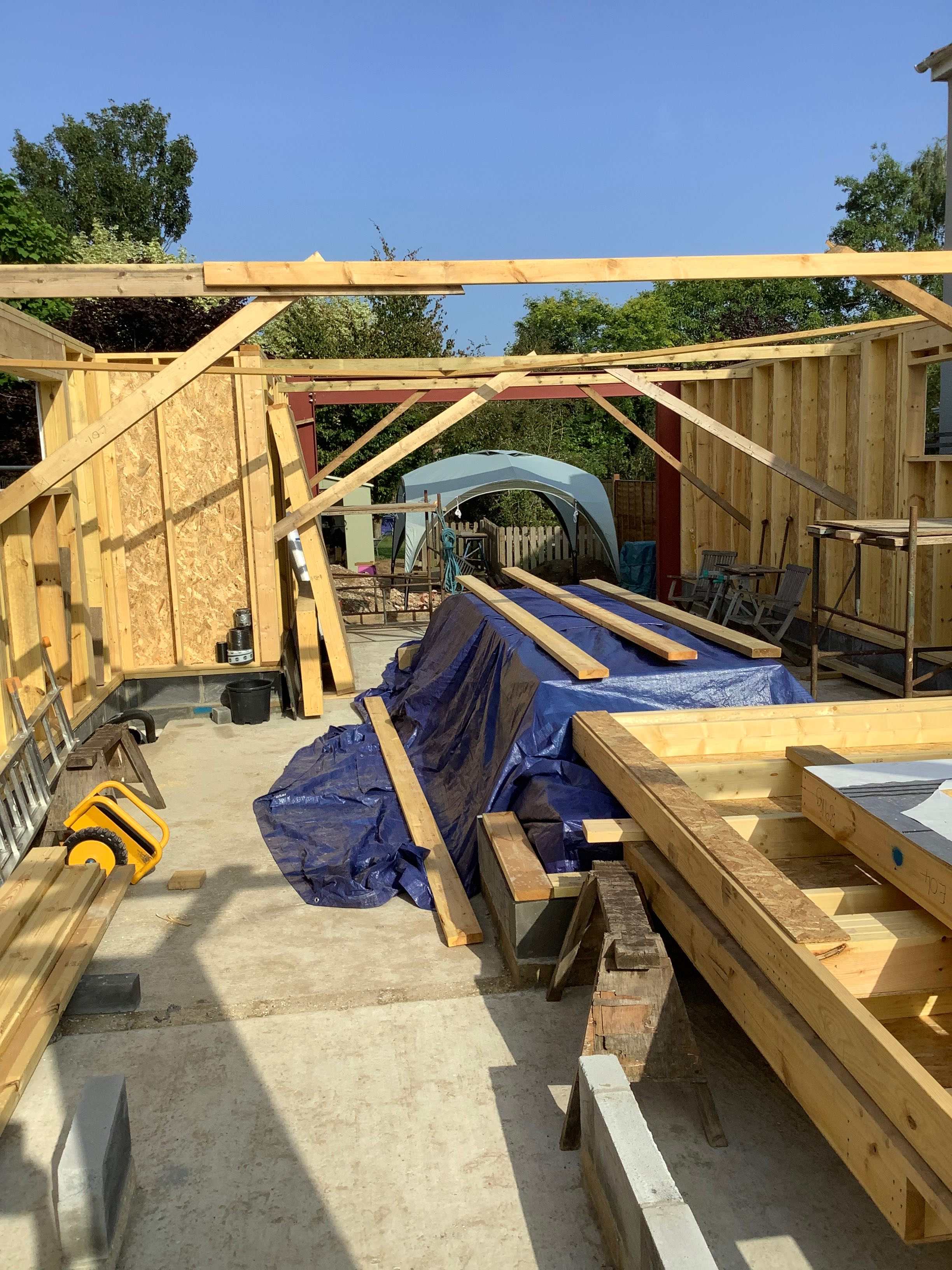

To start with it really did resemble one of the old sliding tile puzzles I used to do as a kid. Only with tiles that don’t slide and are up to 8’ x 11’ and weigh up to 135kg.  It started getting better when I took some time one evening to ship as much possible down to the man cave slab at the bottom of the garden.

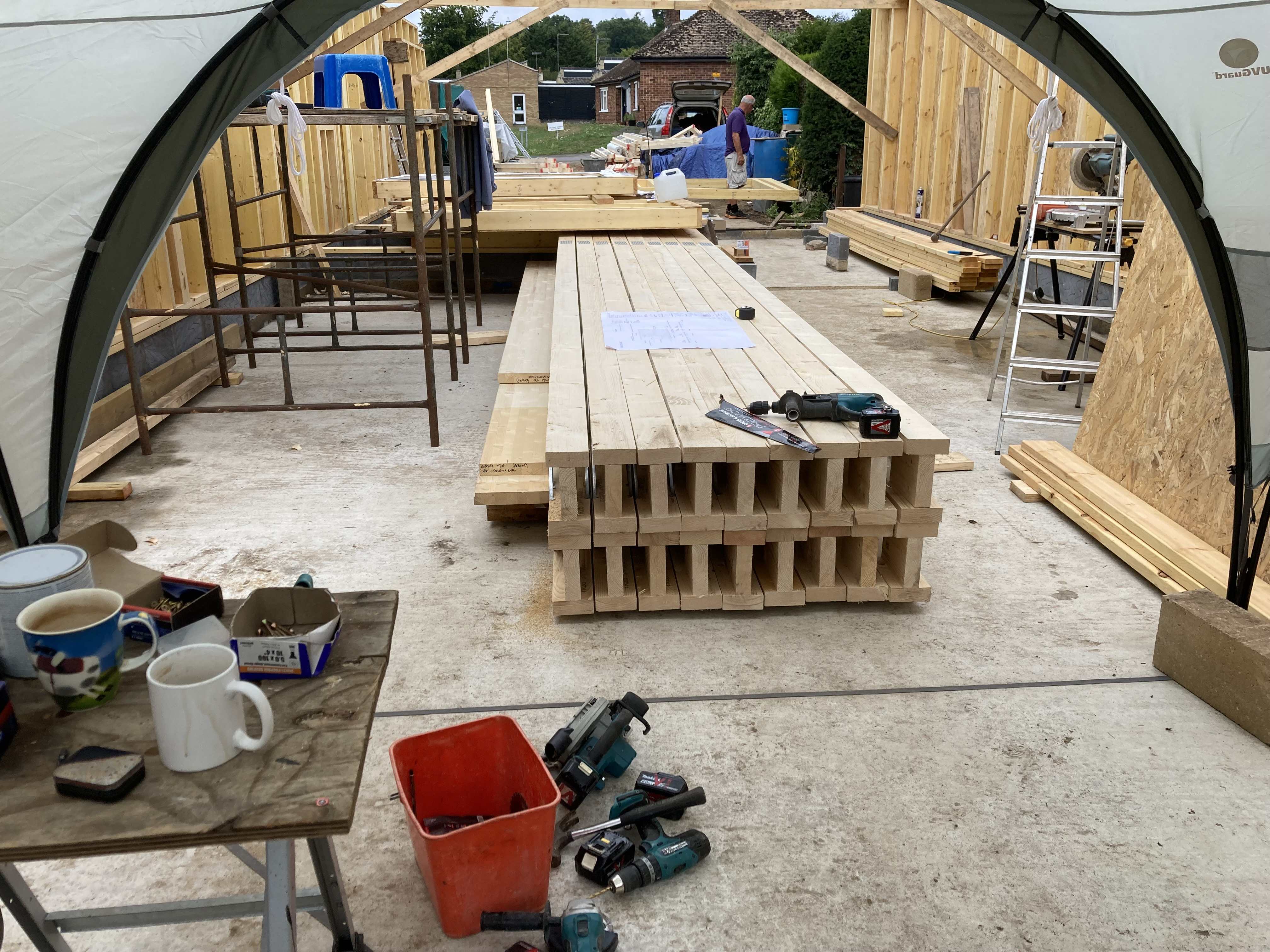

With each panel it got easier and we steadily accelerated.  Happy days.  Not so happy when it rained though, but we erected the little camping shelter I had in reserve which gave us somewhere to sit and plan in the dry and it gave us the chance to deploy my table saw, which is useful.
On the Friday the joist delivery and subsequent stacking took me most of the day.  The delivery driver was about 4 decades younger than me, a foot taller, looked strong and was brilliantly helpful.  At first, us moving 6.3m 47kg posijoists from the lorry to our slab saw me running to keep up.  After the first few he slowed down to match my speed, or so I thought.  A few more and I found myself wondering why we were going so slow.  I’d worn him out.  By the time we’d finished he was visibly wilted, but we’d done it.

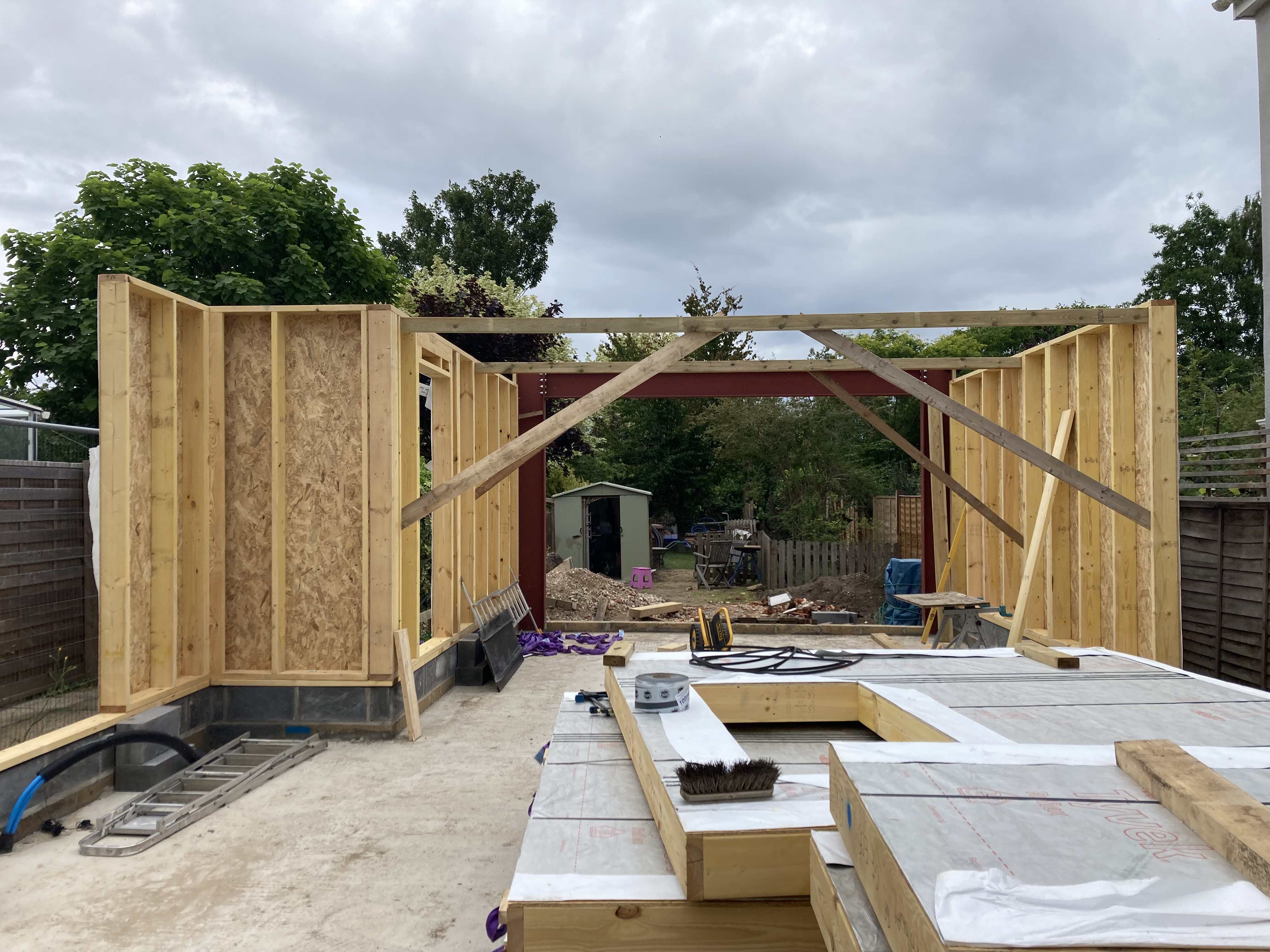

By the end of the week we’d got the two sides mostly done.  I stood in the back garden and looked back at the pics of the site when it was first cleared.  We’ve come a long way.  It was a needed boost.

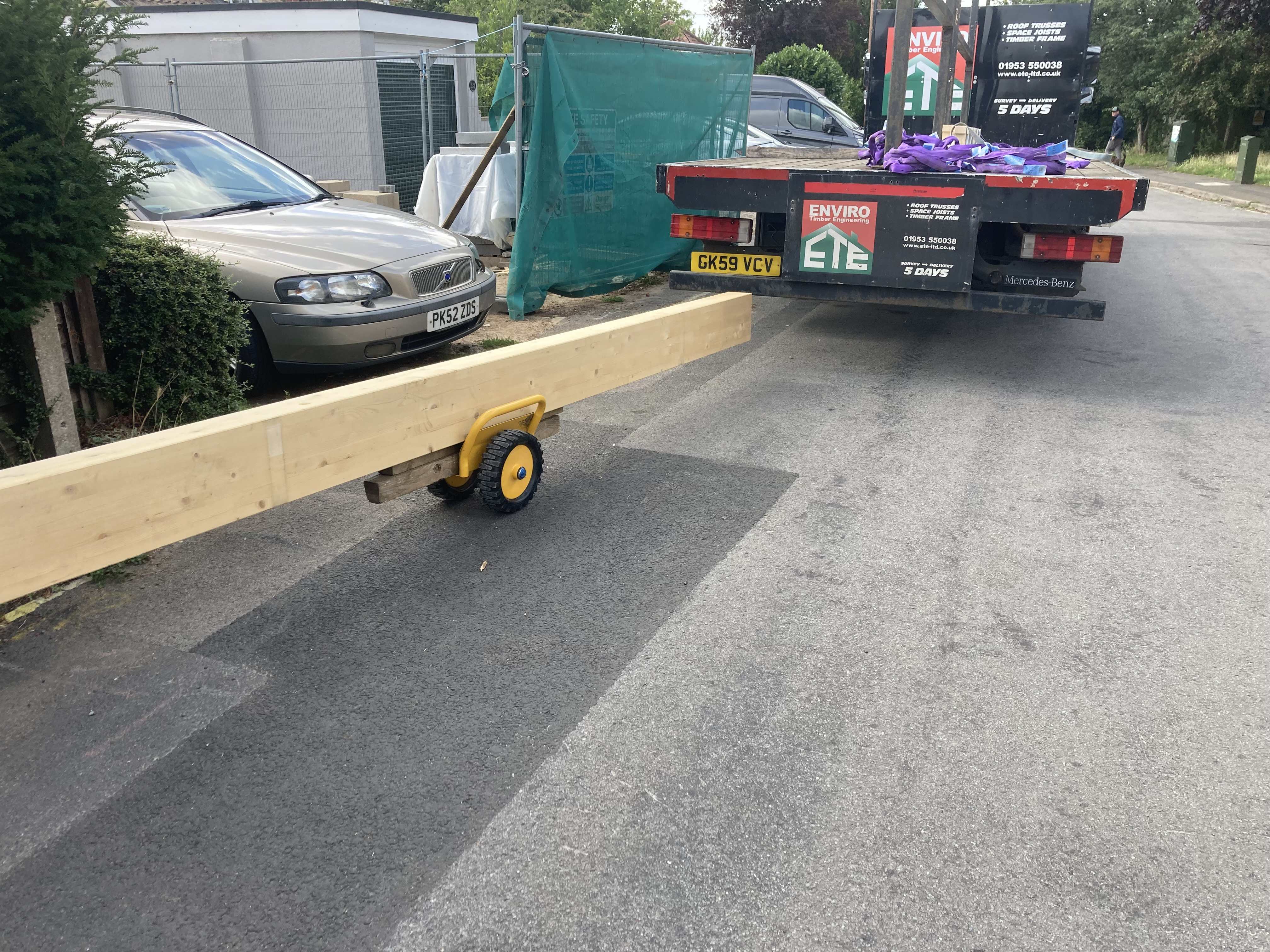

The next Monday our big glulam arrived, easily transported on my super useful little trolley.  I’ve been laughed at and teased about my trolley, but it’s moved an awful lot both on the slab and up and down the garden.  Rolly’s little board with casters is better for moving panels on the flat slab but my DeWalt trolley is the bee’s knees otherwise.
By the end of Tuesday we had all load bearing panes (external and internal) up, with header plates in place so we were ready for the metal men to come and instal about 800kg of steel atop the panels.  So Thursday Rolly and I rechecked everything was still plumb (small adjustments needed) after the weight of the steels had landed and then it was time to focus on getting ready for joist hanging.

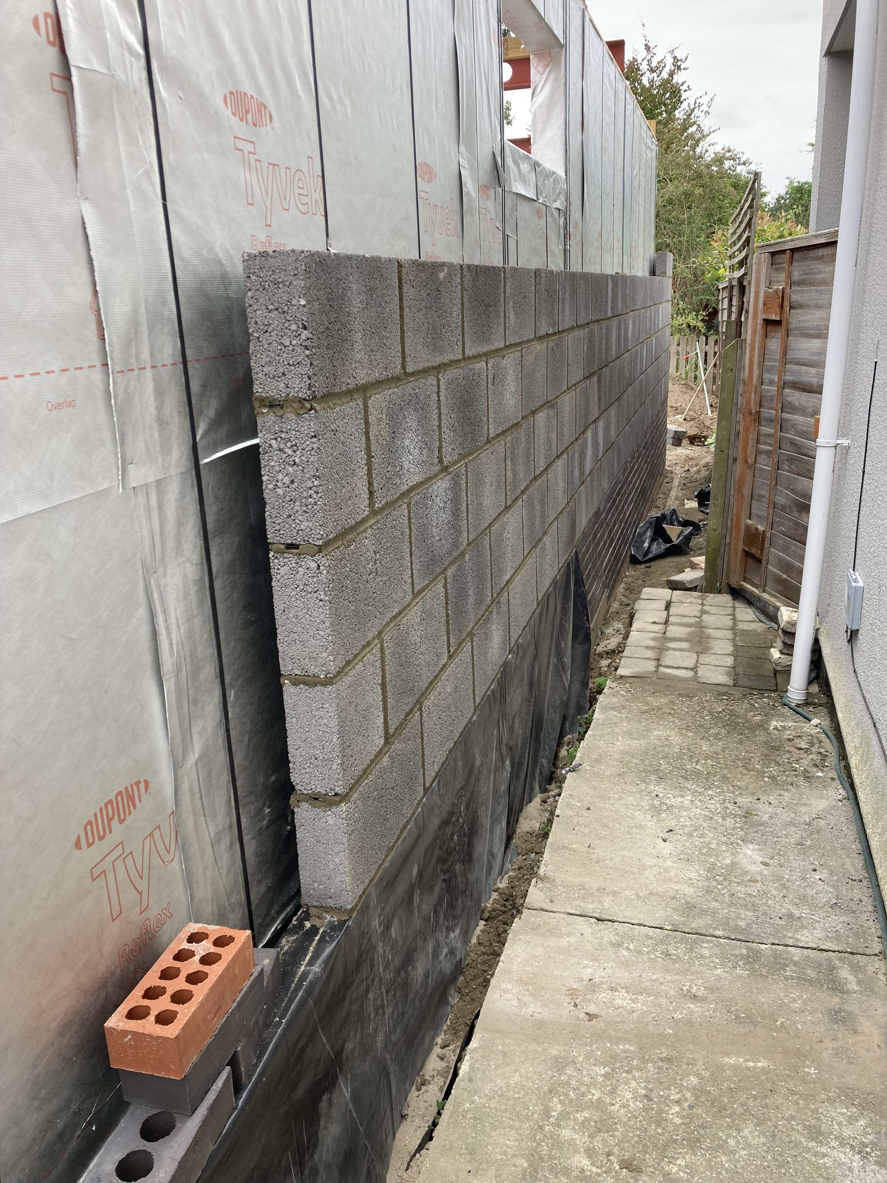

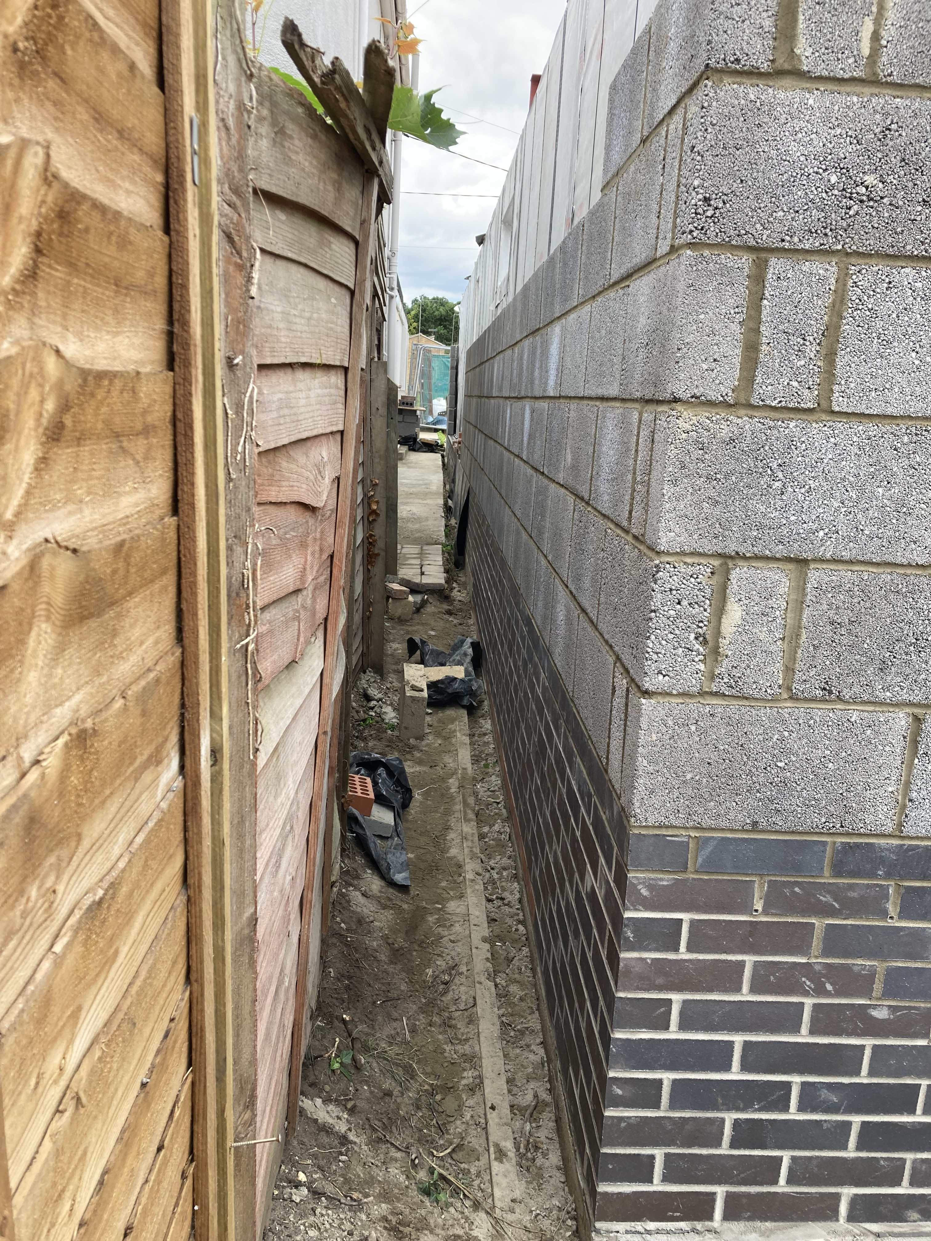

Friday saw the arrival of the same team of brickies who saved our plant based bacon equivalent two weeks previously.  They are a team of celebrity look alikes: Pete Townshend; Paul Weller and Charles Branson.  Despite this they are a whirlwind.
It hadn’t occurred to me that hitherto I’ve only worked with builders, not brickies.  They are brilliant at what they do, but they only do brick and blockwork.  So I needed to ensure that all was done/planned ready for them.  That meant sorting all the breather membrane on Friday late afternoon ready for the brickies’ Saturday shift.  J and I worked late to do enough to be ready for them and whilst we managed it, with only a modicum of tetchiness, I now realise, that looking back, I really needed to stop and carefully think through how the brickies would work in with the project.
They are a force of nature.  Light the blue touch paper and dive for cover, but in a good way.  Sort of.  Once they start things happen so fast that there s no time for me to think, and frankly I wasn’t ready.  I think we’ve just avoided cocking up but only by overusing J and my combined brainpower and if I’d been on my own the project would now be in trouble.
It isn’t helped by the fact that they’d offered to do two days to sort the plinth bricks.  That bit I was ready for.  But then they announced that they could stay till the house blockwork was all finished, so things I thought were a good few days away were suddenly NOW!
