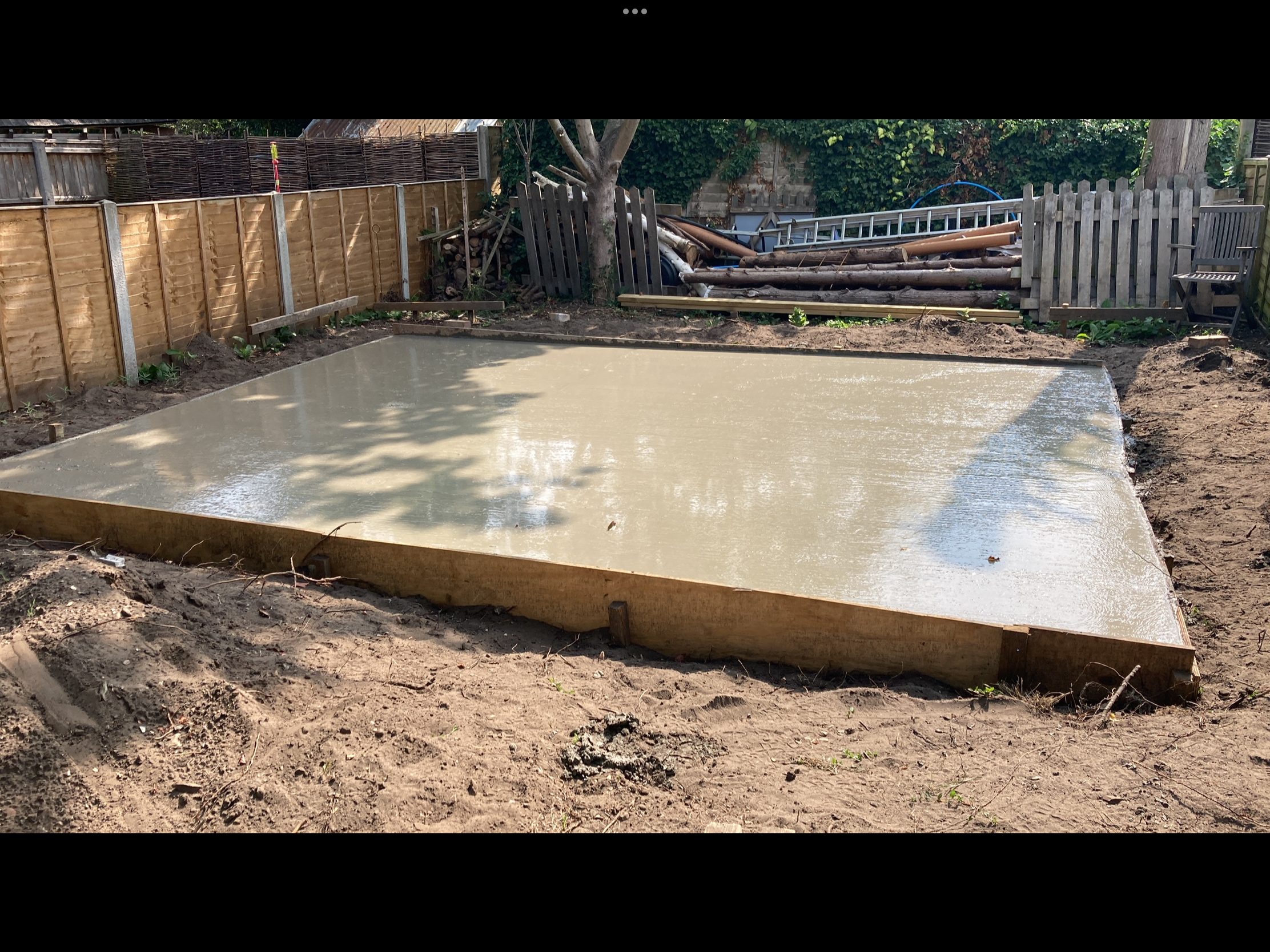

But blocks laid, we went on to the Hide, and we got most of it shuttered up and we laid the A393 steel mesh (2.4x4.8m bits of that are heavy!), so we were ready to concrete the raft so I hired the dumper.  But then Steve had to have a few days off.

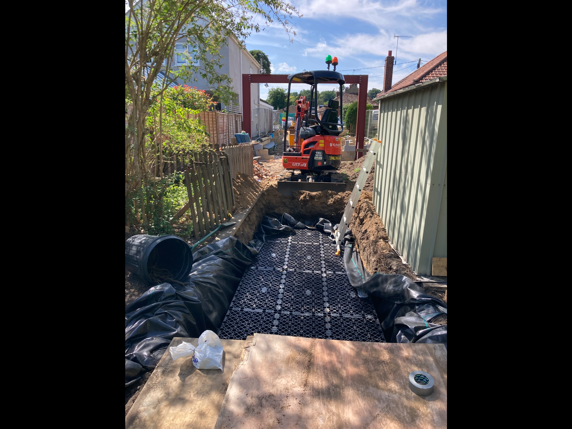

So I pressed on as well as I could.  I had no digger or dumper driving experience and frankly it showed in the glacial progress.  When I started digging the soakaway hole, if it was being filmed an advisory would be needed at that point to say “those of a nervous disposition please look away now”.
But I managed to dig the soakaway, put the topsoil aside, fill the dumper with load after load of subsoil, dump it by the road, install the crates wrapped in the odd fabric, and put the topsoil back.   Exhausting, especially constantly jumping from one machine to the other, but rewarding despite there being no visual evidence after the event except on my phone.    Our BCO has since approved our soakaway from the pics, which was a relief.

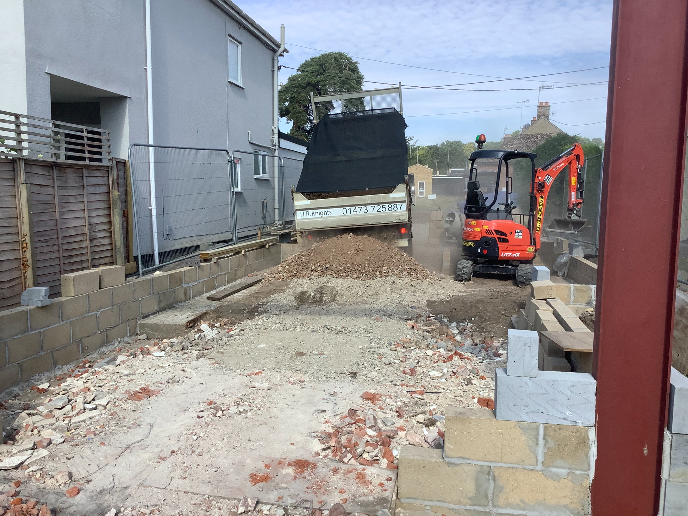

30 tons of crush sounds like a lot.  However, when faced with a 9 ton load dumped near the front of the site ready for me to drag it onto the slab it feels like an awful lot more than a lot.  So days were spent moving crush, some with the dumper to start with but that only worked for so long so the dumper became redundant.  I did get a bit faster on the digger, eventually.
Originally I had thought about using a line pump but was dissuaded.   Apparently there was a fatality some years ago in our area and it appears amongst many in the trade concrete pumps are the bogeymen.  But as there was no sign of Steve returning it was time for a replan - saved again by Andy the Boss.  So the dumper was returned and the pump was booked and I carried on with more loads of crush.
The second 9 ton load enabled me to create a sort of ramp so by switching to another local company who had a smaller vehicle I hoped to get 4 ton loads dumped direct where they were needed.  It sort of worked.
He reversed down the site and over my foundations and tipped onto what will be our lounge.  V good.  But then he had trouble getting back up the slope and at one point we were shovelling crush to unstick the lorry.  Not good.  After a few goes he got out, to my relief, but I was told that the remaining two deliveries would be tipped front of site.  Damn.

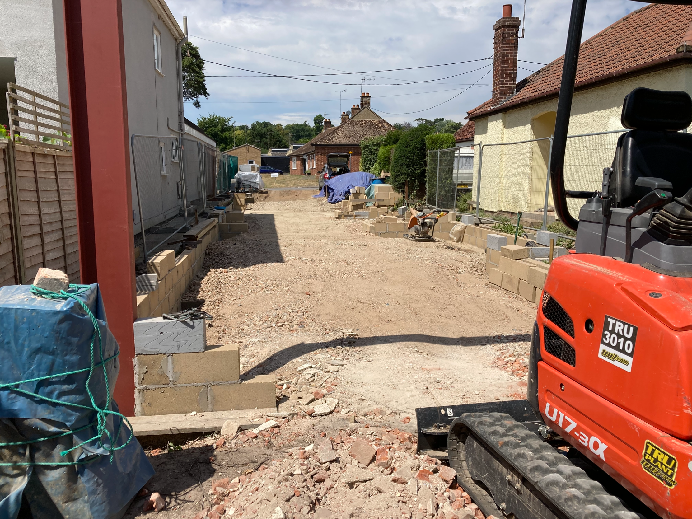

So I leapt on the digger, and used the hour between deliveries to redo the slope, whackering down the crush in places to help.   When the lorry returned the driver got out, looked, nodded, jumped back in his cab and reversed all the way again.  Result.  Same for the final 4 tons too.  Saved me hours of diggering.  Peeps do seem to try even harder to help when one is building your own home.
Such a small world though.  In conversation with the driver it turns out he delivered the bulk of the aggregates to us during our build 34 years ago.
Another day of grading and whackering and the digger was finally finished with.  I sort of enjoyed it a bit but one can have way too much of a good thing.

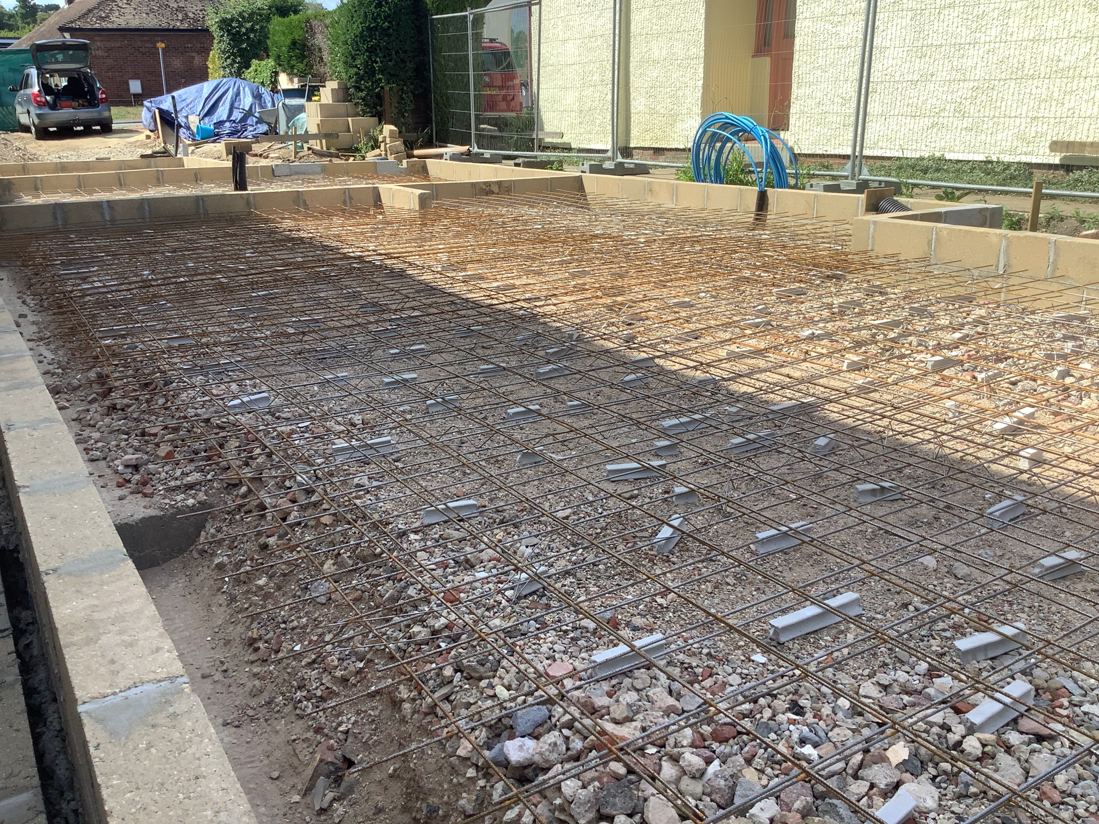

On our return we learnt that Steve was grounded until further notice on medical advice.   We had two days on our return to get the A142 mesh in - which was not enough time for me on my own - especially as I had to go get different spacers for the mesh as I’d cocked up my planning.  Carrying the 2.4x4.8m sheets on my own was really weird.    The weight wasn’t so bad but they waggled so much that it destabilised me so had to stop and ground them to reduce the risk of a fall.
So Saturday morning (the pump was booked for Monday first thing) the cavalry arrived in the shape of J who had re-researched how to do the mesh/spacers/tying in.  We flew along.  Relief.
IMG_3734.thumb.png.f598ed7c4caef9f9ff37ef32f47984ad.png    IMG_3740.thumb.png.511c977d07463943cba5e3fdcdc4247a.png
On Monday the pour was uneventful.  I learned that the fatality was due to a fall where a chap had his hard hat on backwards - nothing really to do with the boom that was there at the time but legends become self sustaining.

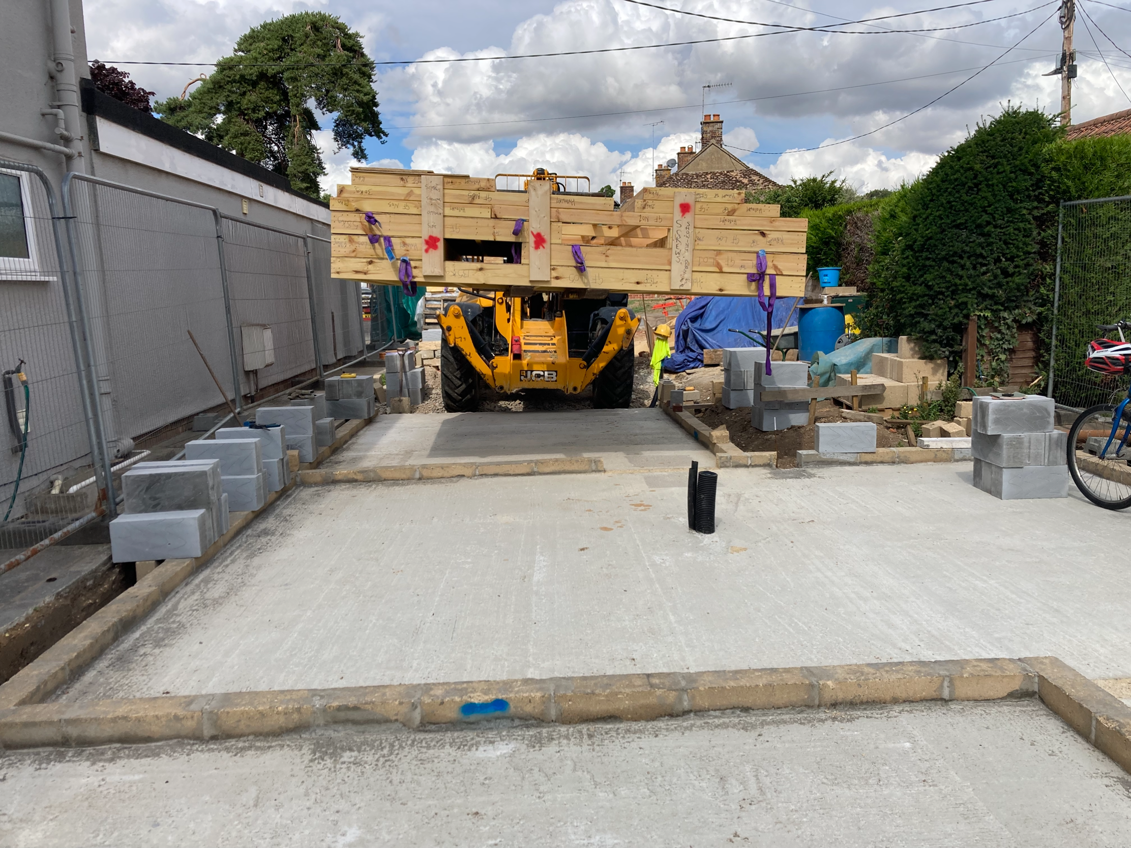

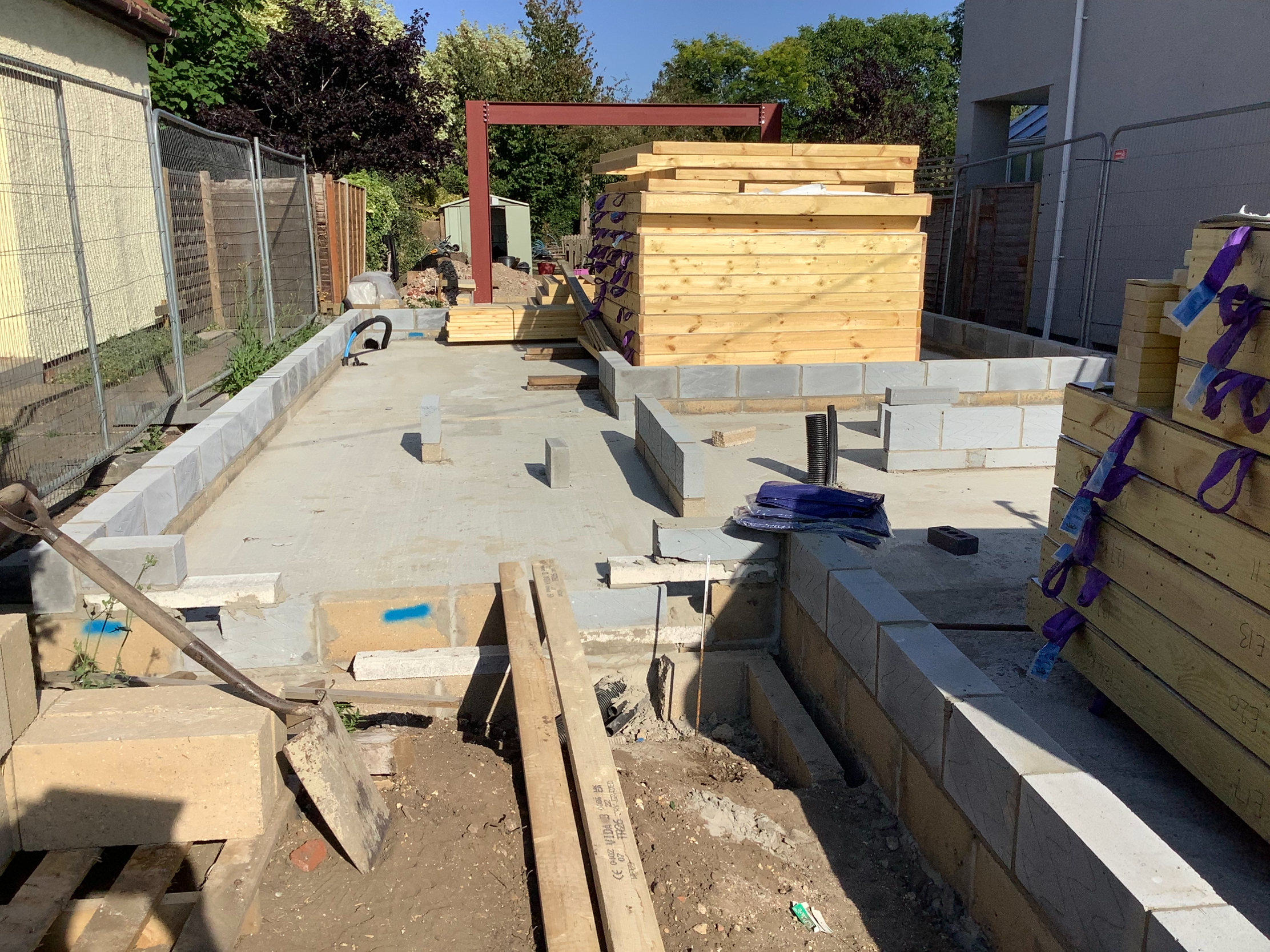

On Thursday it was pointed out to me that a pile of crush on site could form a ramp which would allow the telehandler to get on the slab and place the panels in the best spot.  Sweating profusely with my spade and rake was a good way to learn to appreciate a digger.  But by the time I wobbled home site was ready.
Friday morning started badly.  Scooby - my dilapidated and beloved Skoda bought a year ago for the build - was booked for an MOT - my mindset was that it was more ‘the last rights’ than it was a routine check.  So I loaded my pushbike on top, drove to site to drop off my tools only to find that without warning, the road was closed.  Annoyed.  Stressed.  We’d had to give 12 weeks notice but apparently Anglian Water decided the day before despite it being planned in in advance.
I dropped Scooby off at the garage with a lump in my throat and peddled like mad to get back to site.   The water board guys agreed to let our delivery through, much to my relief.   On site I wanted to recheck all my levels and move some stuff to be ready for both the delivery and the brickies.  I’d just got that done when Andy the Boss turns up in the telehandler.  The delivery lorry, however, took one look at the road closed sign and drove off somewhere random to give me a call.  Several gritted teeth calls later and I managed to talk him in (why hasn’t anyone invented Satnav?) and we then did lorry and telehandler ballet, with a support act of irate drivers blaming me for the road closure - more gritted teeth, smiling from the nose down calming and redirection of a succession of stressed senior drivers.
The first pile of panels fell off badly placed bearers, after which Andy the Boss followed my signals rather than those from the well meaning driver.  (An hour of manual panel shuffling later revealed no damage - thankfully - but they ain’t easy to move on my own as some of the weigh OMFG kg).  The rest of the offloading went ok.   Deep breaths.

The brickies turned up exactly on time and in a couple of hours on a burning hot Friday afternoon laid a phenomenal amount of blockwork beautifully.  Their job was made harder by having to wiggle round the piles of panels but they just took it all in their stride.

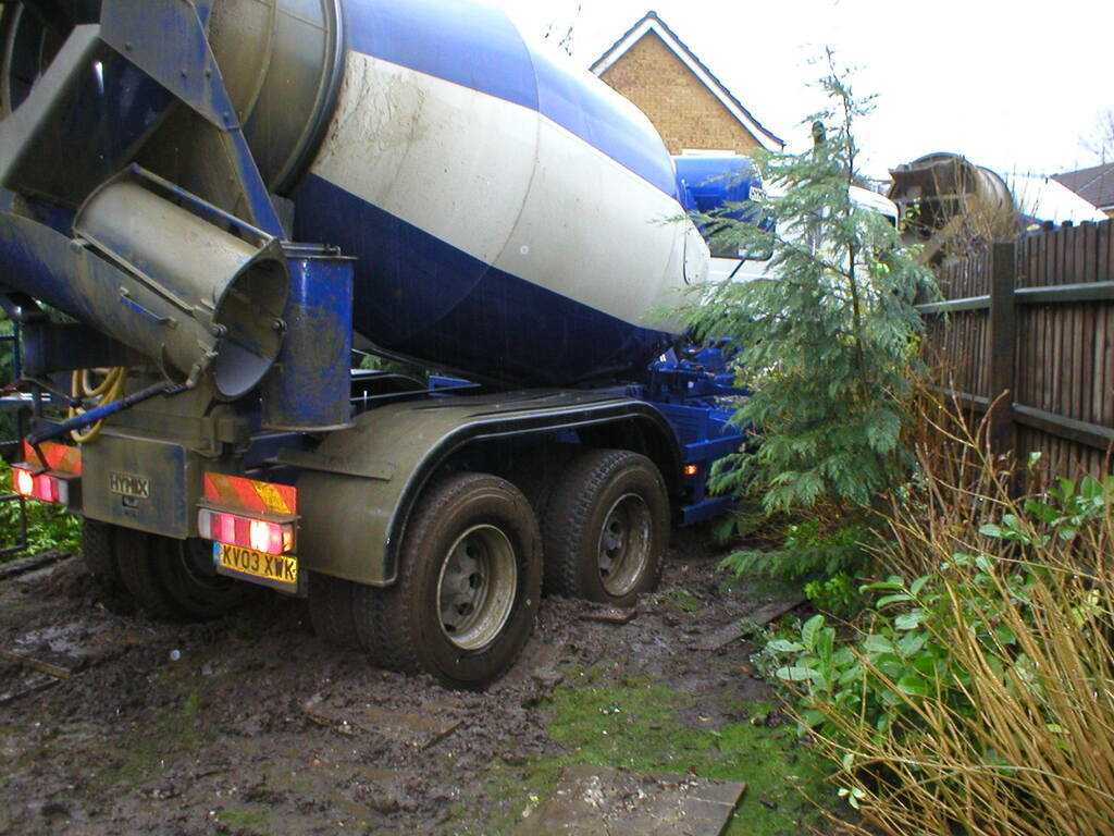

Excellent progress - getting vehicles stuck on site is fun................
One of my treasured memories is getting a cement lorry stuck in my back garden after delivering 15T of concrete and it buried to it's differential casings due to driver not understanding that spinning the wheels from the start was unlikely to do anything other than dig a really big rut.
Seeing it pulled out by another one - happy days.............
