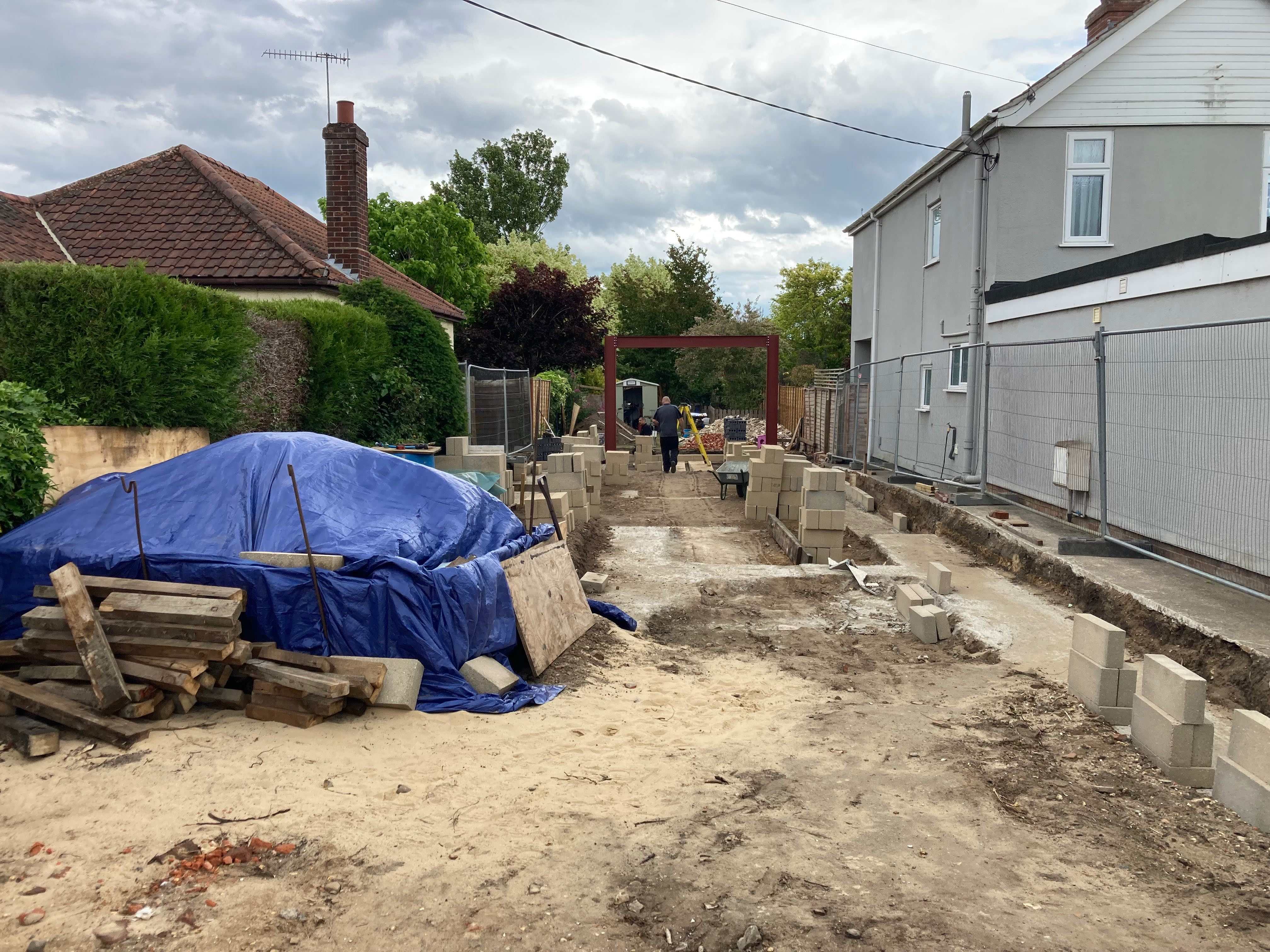

Well, sort of.  Working physically hard is sooo emotionally easy compared to the frenetic whirlwind of strip foundation digging and filling.   If that means that to you, I sound an emotional fruitbat then I commend your perceptivenes.  I find it impossible to predict in advance the bits that will be most stressful.   In the last two weeks I’ve had all but two days on my own on site, as Steve has been on his hols.  So it’s background organisation tasks and planning for the most part.  T

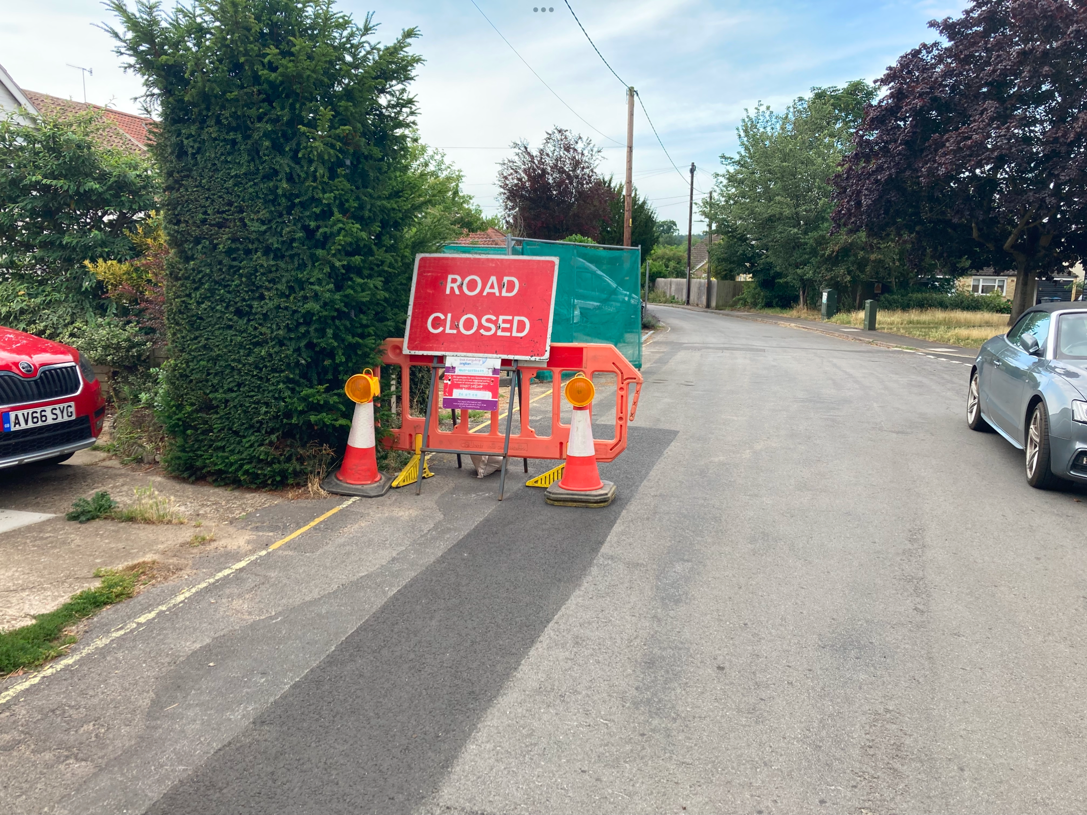

We start the week with the latest quandary: how to show the warranty surveyor enough trenches so he can confirm he’s seen 50% of them.  He saw some last week and if we dug the rest of them then that would add up to enough.   However, if we did that we’d have a massive issue with spoil and we would not get the concrete lorry on to pour, so it would be barrows.   Apparently pumping is an option, but we’d need to close the road which is a lot of cost and a great deal of time wasted.   So,
Clearing the site…   (Last weekend I didn’t think there was enough for a blog entry.  But this weekend, after a week and a half at groundworks it turns out I had more in my head to clear out than I realise, so it’s a bit longer than expected…)   After the grunt and sweat and fatigue of manual demolition it felt like one big ‘Hurry Up -Wait!’, the wait partly imposed by Steve (semi retired builder) being on holiday.    The plan was to start groundworks at the beginni
