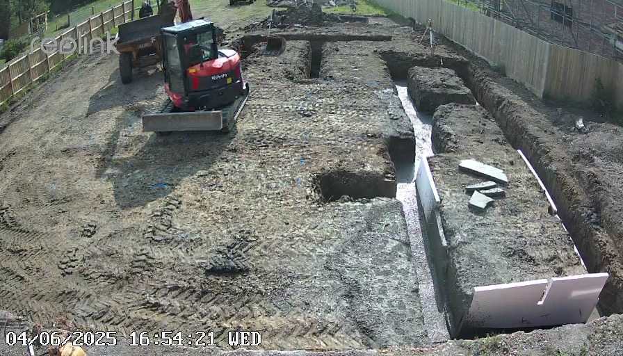

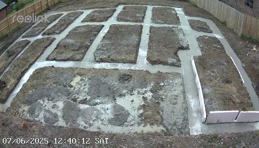

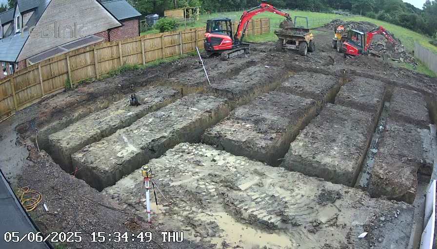

The excellent SE we contacted on Thursday to design the depth of our foundations came back on Friday with the answer - deeper than we wanted at 1.95m in the corner closest to the neighbouring oak (15m away) but his quick response has saved the schedule.  We need to add clayboards in the corner nearest the tree but overall it could have been a lot worse.
His rapid turnaround was brilliant and it meant we were able to crack on this week.  The groundworkers had already discounted Monday as I suspect they thought they’s be waiting for the SE but through the rest of the week dug all the trenches and on Friday we had 7 lorries of readymix poured.
The only issue was they hit a shaley layer at the bottom of the deepest trenches, so with the BI’s agreement they poured a couple of loads of concrete in on Wednesday before digging out the rest of the trenches.
So now we have all the foundation trenches filled with concrete.

They did well to stop the clayboard floating up in the concrete.
They pinned it into the clay. You can just about see a couple of pins  in the extreme bottom right of the second pic.  Not sure what they were tbh thin plastic rods maybe.
Mr Punter
Posted
Yes, we have used rebar offcuts in the past but the polystyrene is very buoyant in the concrete.

I've used tent pegs before!
