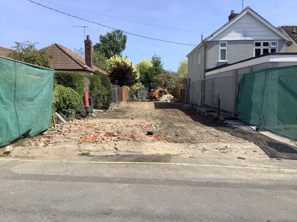

Over and over again I’m learning that the building world takes ‘just in time’ to the ultimate limits.  Days before we are due to start I suddenly get given several recommendations of good guys who will happily work day rate and so I arrange to meet some on site for them to have a look so I let Andy the Boss know that we simply couldn’t afford it.  Turns out being dead straight with peeps (which in fairness is always our intention) does pay. One quick phone call and it went from me saying “really sorry we can’t afford you” to “yes we understand the risk of day rates but we are really happy to work at those day rates”.

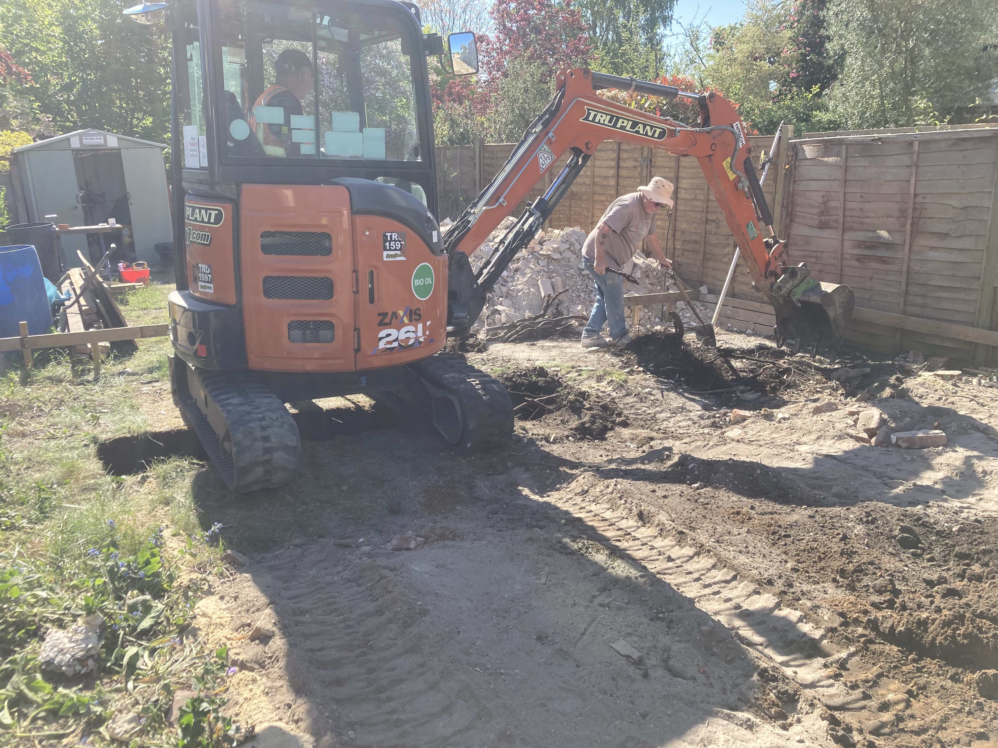

So on the 6th Andy the Boss and Kev the Dig turn up with a 2.5 ton digger.  Next day Kev the Dig and I start pulling up concrete and scraping off the site.  I say “and I” in a kind of loose, hanging round on site, tidying up a bit and wondering what exactly I should do, sort of way.  I wasn’t really needed most of the time.  I did dig to find the sewer pipe a couple of meters in from the road, cap it off and note position.   Will be interesting to see if I can easily find it again.
We discovered some bigger than expected lumps of concrete, which Kev dealt with by lifting one end up and dropping them. Later one of our neighbours shared the fact that they could feel those bits happening as they sat at the far side of their house.  Scary.
Kev suggested we take some of the big heap of stuff we’d saved for floor make up (which I’ve learned to call “crush”) and spread it at the front of the site as a sort of parking/lorry bearing area.  Damn good idea, I should have thought of that.  So I did have a role to play.  My role was from time to time to say “yes Kev”.   At least it made a change from “yes Steve”.
Kev was very considerate to the neighbours, stopping when he noticed excessive dust being created and sending me round to conduct neighbourly relations.  And our poor, dust covered, deafened neighbours continued to be rather brilliant and tolerant.  Another example of how fantastically lucky we have been.
Thursday lunchtime saw Kev suggest, politely, that I was in the F way (technical term), and that he’d be quicker if he could shut the fencing and not constantly be checking that he wasn’t about to flatten anyone.  So I went home and in truth not being on site that afternoon or the day after as Kev did his thing was tough.

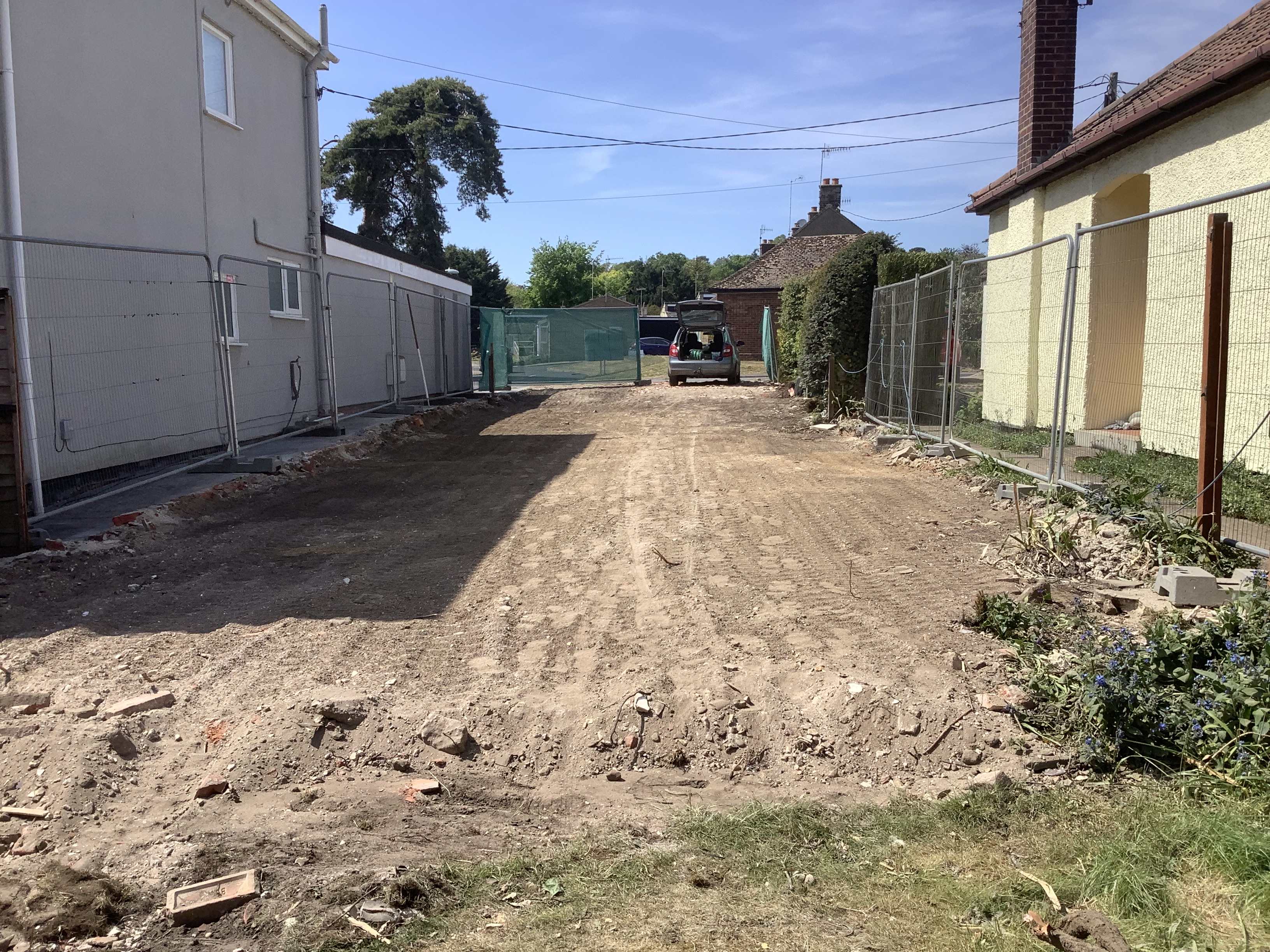

But when J and I went to site on Saturday it turned out that the world hadn’t ended without me.

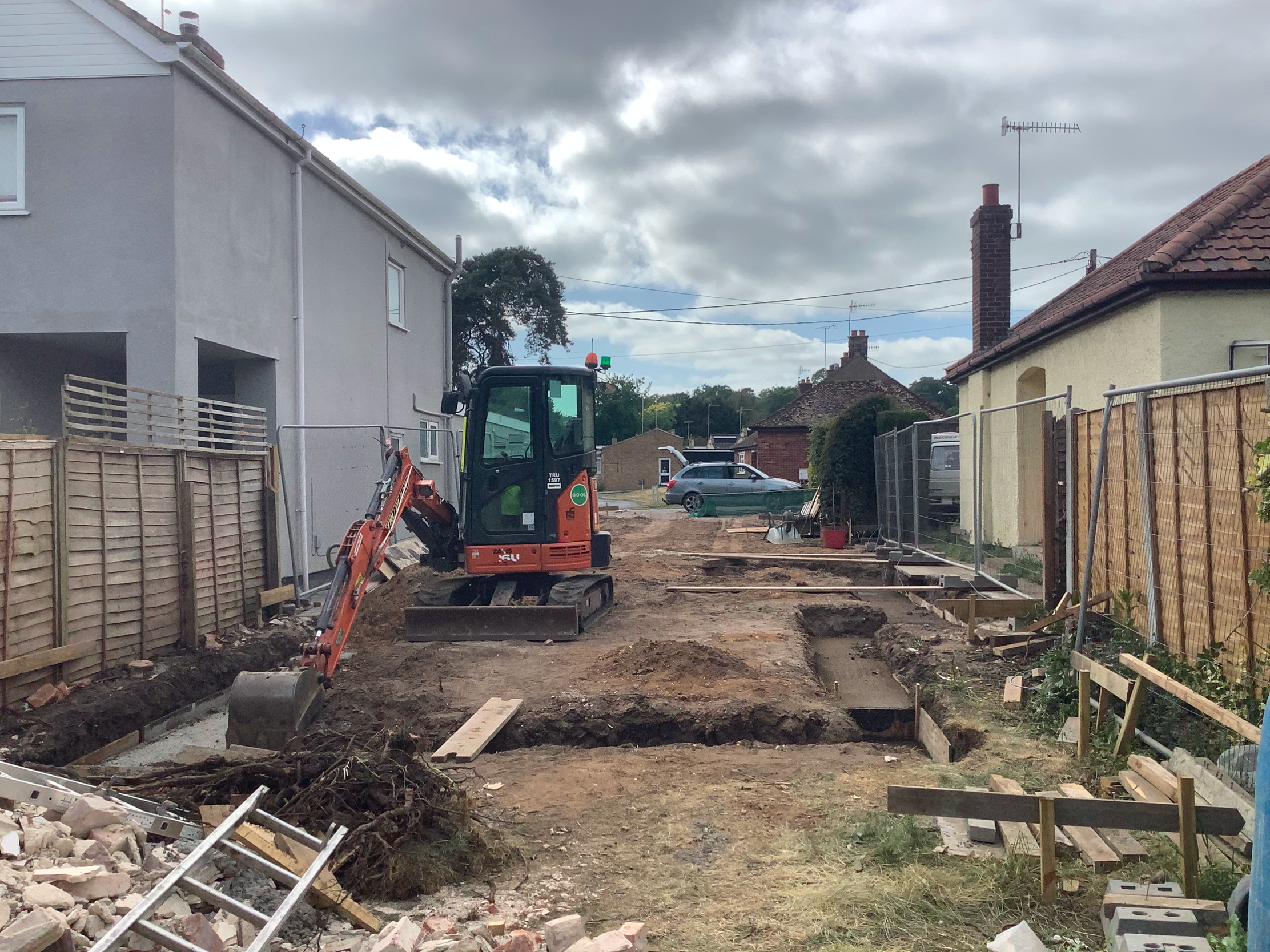

Actual founds…
On Monday Steve and I set out the profiles.  What a whole new experience, and I found it a lot more stressful than I had expected.   The implications of making a mistake just didn’t bear thinking about.  Steve sighed and shook his head at me on a very regular basis but we eventually got there.

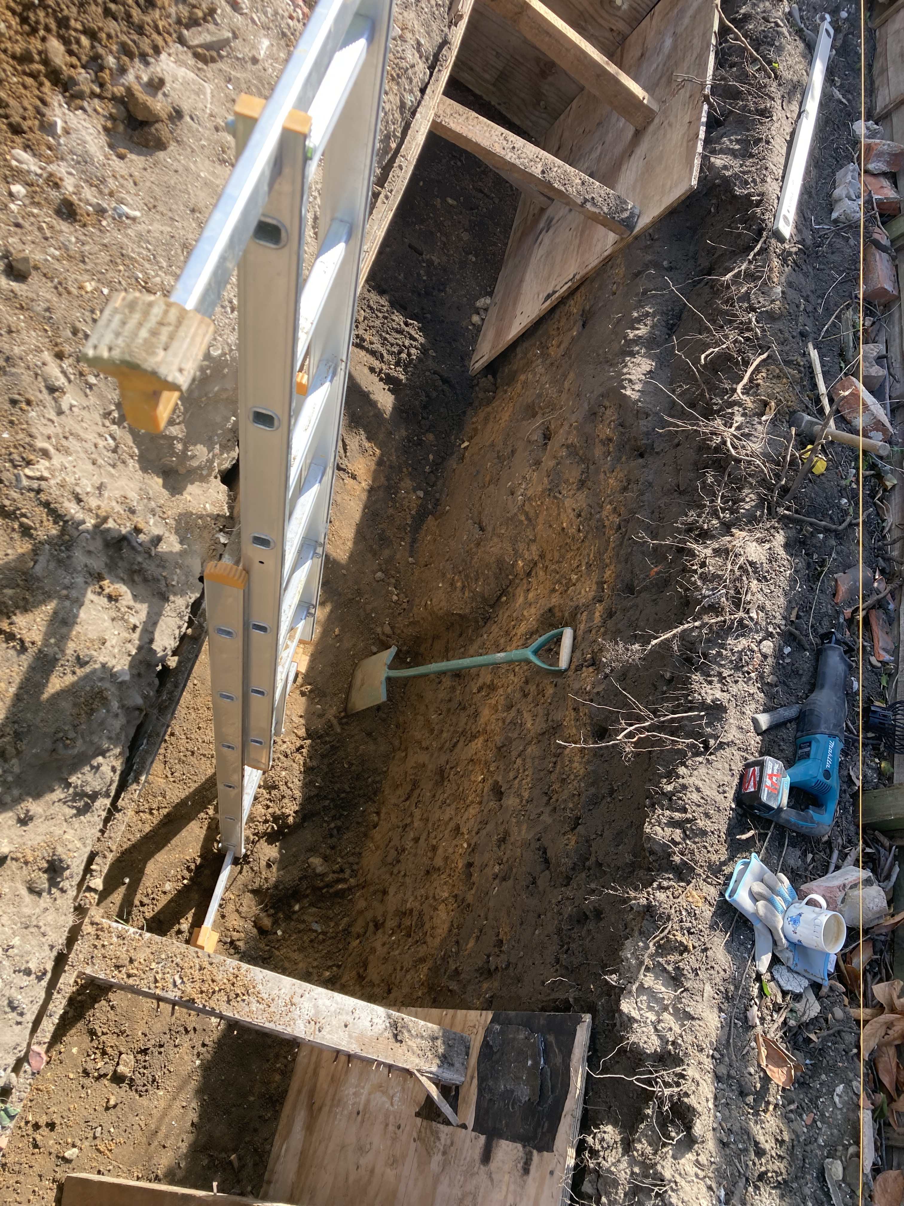

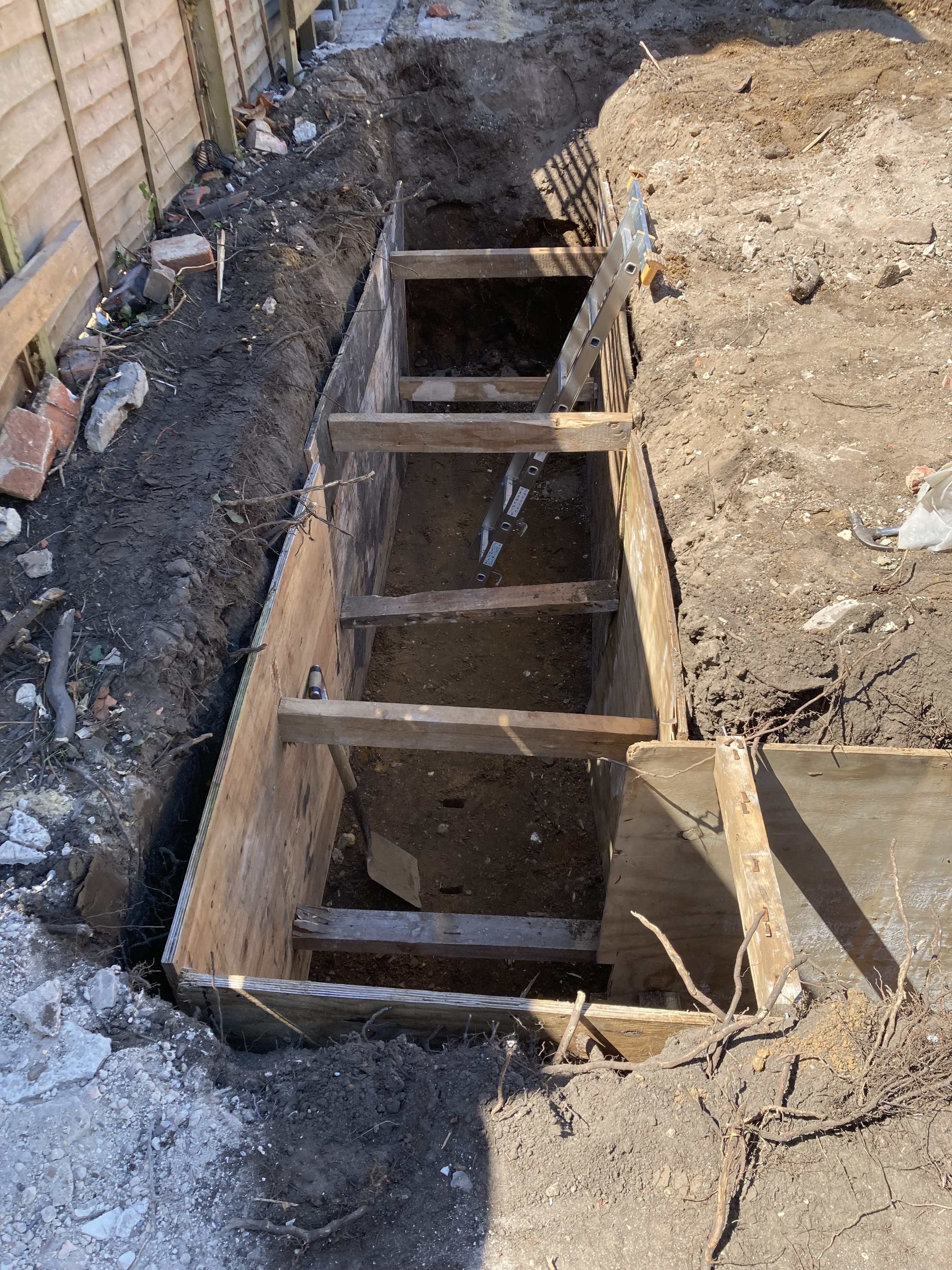

Then Tuesday Kev the Dig was back, so we started digging in the north east corner.  Exactly as indicated by the test holes we hit good ground just below the surface, excellent for our shallow founds.  Then the digger straddled that trench to do the south eastern corner.  Soft ground.  Damn.   We at first thought we’d just hit a soakaway, and we did pull out bits of concrete and pipe.  We had no choice but to fill in the north eastern corner trench again and get seriously stuck in to the other rear corner.
 IMG_8198.thumb.jpeg.e073adef37fe8a35bbfdb09680173cf2.jpeg      IMG_8201.thumb.jpeg.a5c95abf30d1bab327205bcc67d27eb6.jpeg
We went down about an extra 600mm, which in the scheme of things is not that huge, and the soft bit was less than two meters long though of course one digs more than that to make sure.

The rest of that day passed in a blur of digging and moving spoil to the front of site ready for a grab lorry next day.  As part of that we found an unexpected big lump of concrete underground, half of which needed gunning out.
I lay awake thinking about the build sometimes, well, mosttimes.  That night it occurred to me that during all that shenanigans we’d not rechecked the exact location of the founds.  Our outside edges are 900mm wide with the walls placed very near the edge. That means that the placement of those founds is critical - kind of a tolerance of +50mm/-0mm type of thing.
Next morning at site I annoyed everyone by checking.  100mm out on the deep bit, less further along which could thankfully be sorted with the digger, but not the deep bit.  Oh.  So, with a pour booked for the afternoon and Steve and Kev fully employed digging ready for that I searched the employee list for a mug to pop down the 1.4m trench, remove the shuttering on one side and manually spade off 4” and shovel that spoil out all in double quick time.   The options were somewhat limited.  It was either me or me.  That’ll be me then.  And after that it was my turn to attack the big lump of concrete with the breaker after Steve had done the first half.  Tough morning. But the humour helps, as illustrated by the message Steve sent J.  Humph.

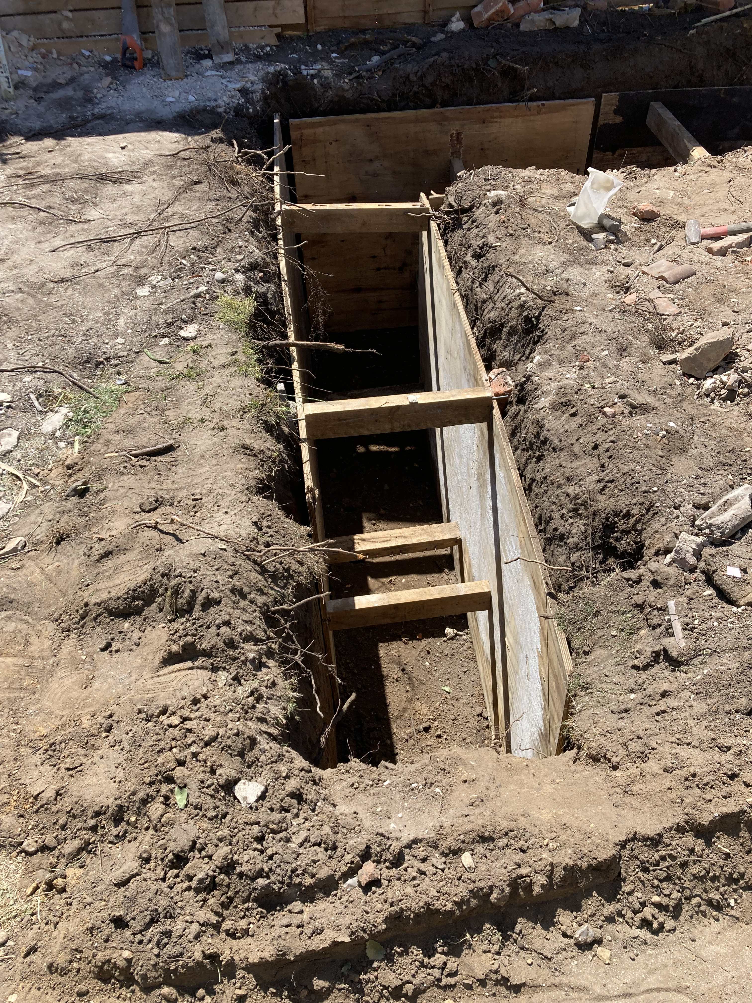

IMG_8211.thumb.jpeg.5fecfb679861a302e8bfe7de64583f39.jpeg    IMG_8224.thumb.jpeg.994ef97f01640903e3e2f560af68cccb.jpeg

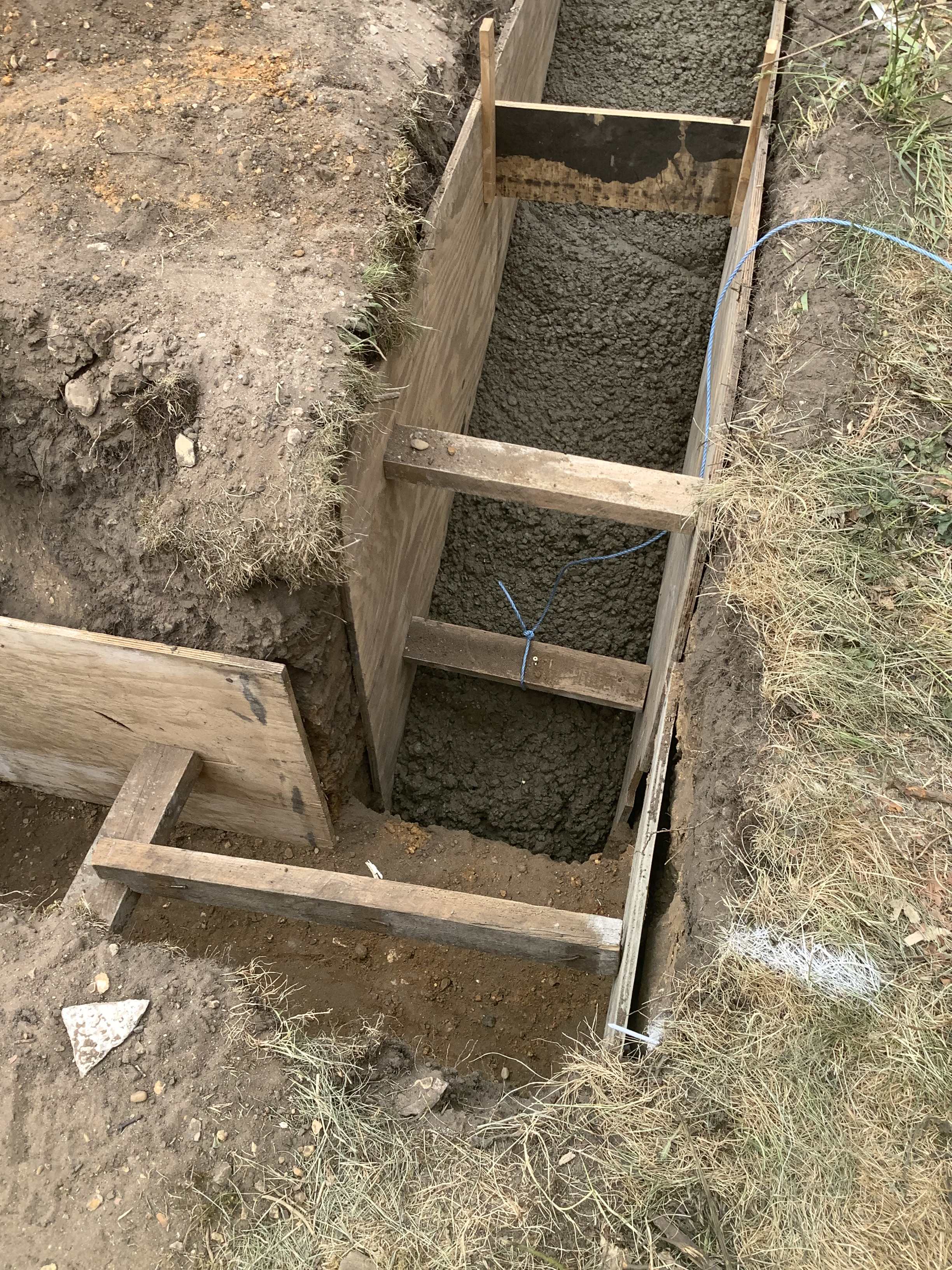

Getting that done, getting all the stop ends done ready with starter bars, etc. was more time consuming than we had allowed for.  But it was ok, I was in control, it was agreed that I would call when ready for the concrete lorry.  Only it transpired that Kev happened to be on the phone to Andy the Boss and he told him we were ready for concrete far earlier than I would have done.  Massive stress and much gritting of teeth and we did get there, but it was very touch and go.  Not doing that again.  Thankfully J was onsite to instil a little calm and perspective.  And to keep Steve chatting when I needed him to accompany me in running round like a headless chicken (and help me get the stop ends right!).   The thing is Steve knew it was all going to be ok, and that I was panicking over nothing.  Shame I didn’t!
The pour itself was über manic.  It was agreed by a majority vote that I was to be in wellies in the trench removing props. (Steve and Kev voted for it to be me, i.e. not them).  It’s a bit like an old black and white army film comedy where they ask for a volunteer and everyone but the prize idiot takes a step back while the officer looks away.
I had no idea concrete could move so quickly.  Struts I had hammered home with every ounce of strength simply slipped out of position as the concrete pushed sideways, but then had to be instantly grabbed and thrown out before being enveloped and lost forever.   Down the 1.4m bit was the worst by far.  Definite feeling of peril, even though all I would have had to do was stand up and let the guys pull me out -so only my wellies were in any real danger of being entombed, but still a bit scary.

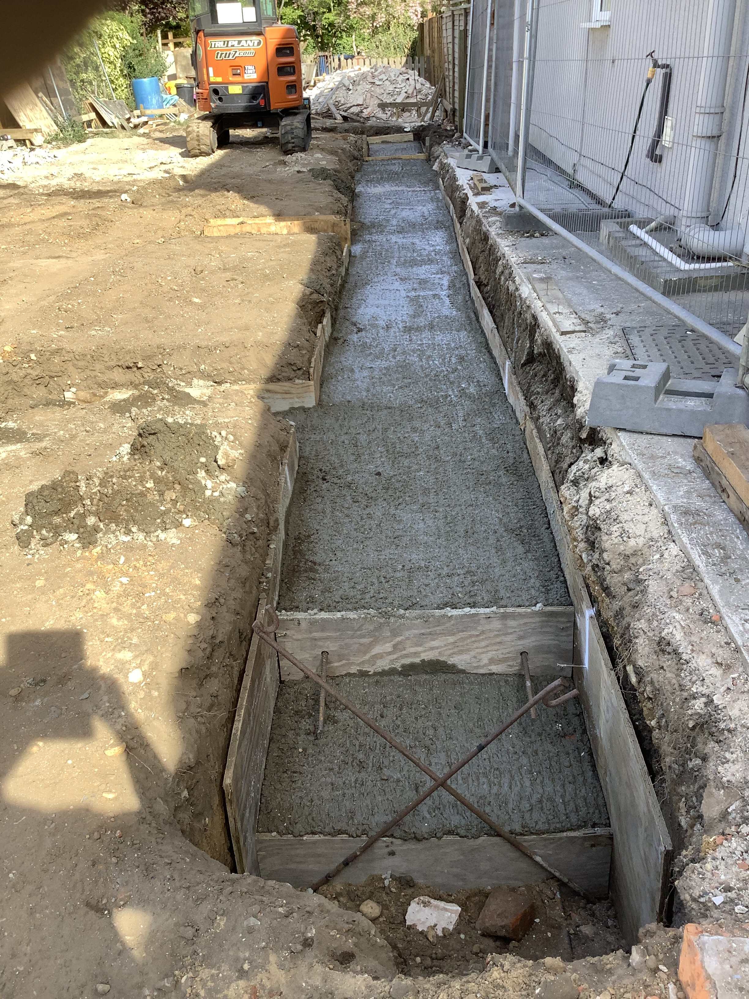

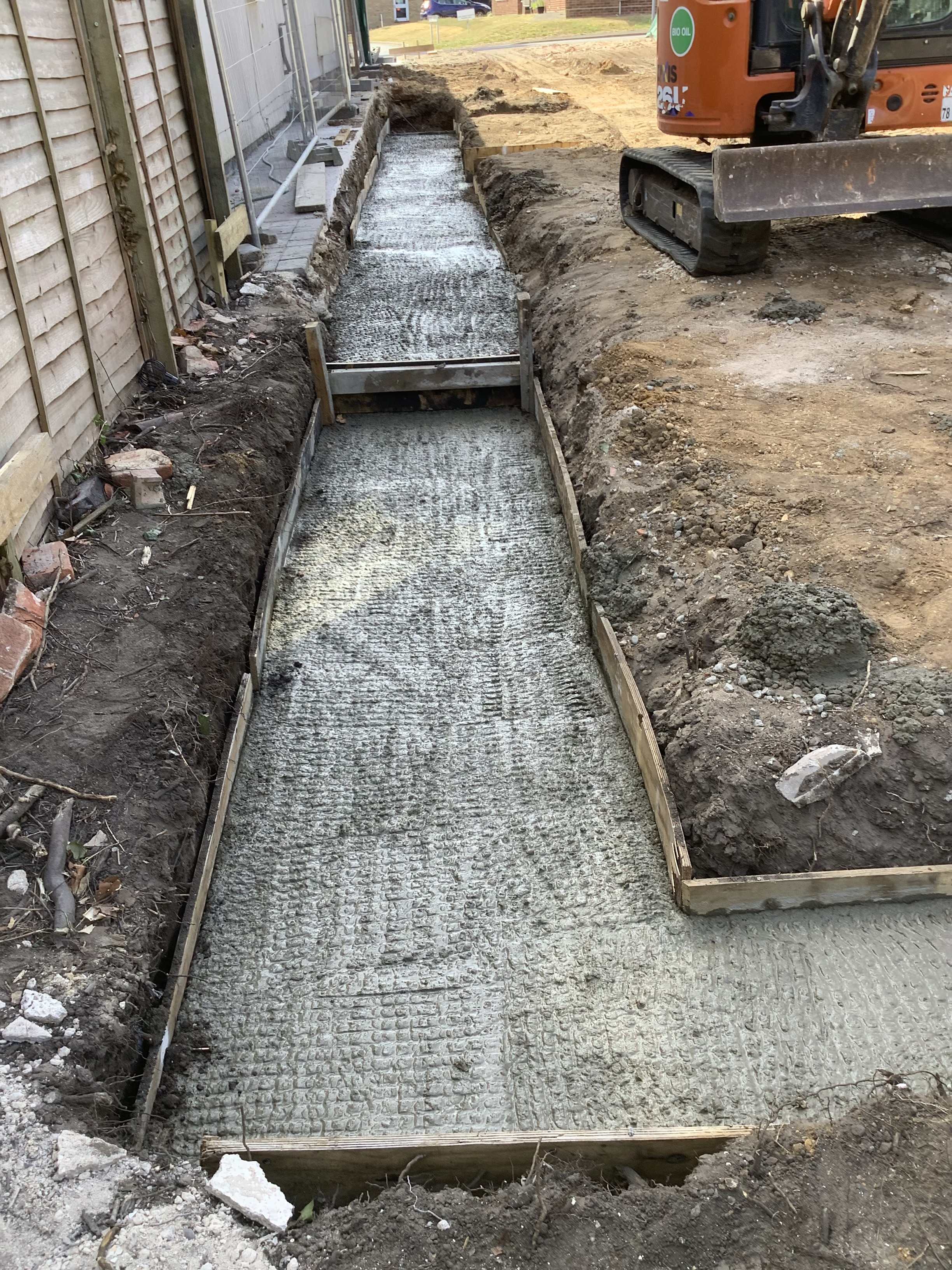

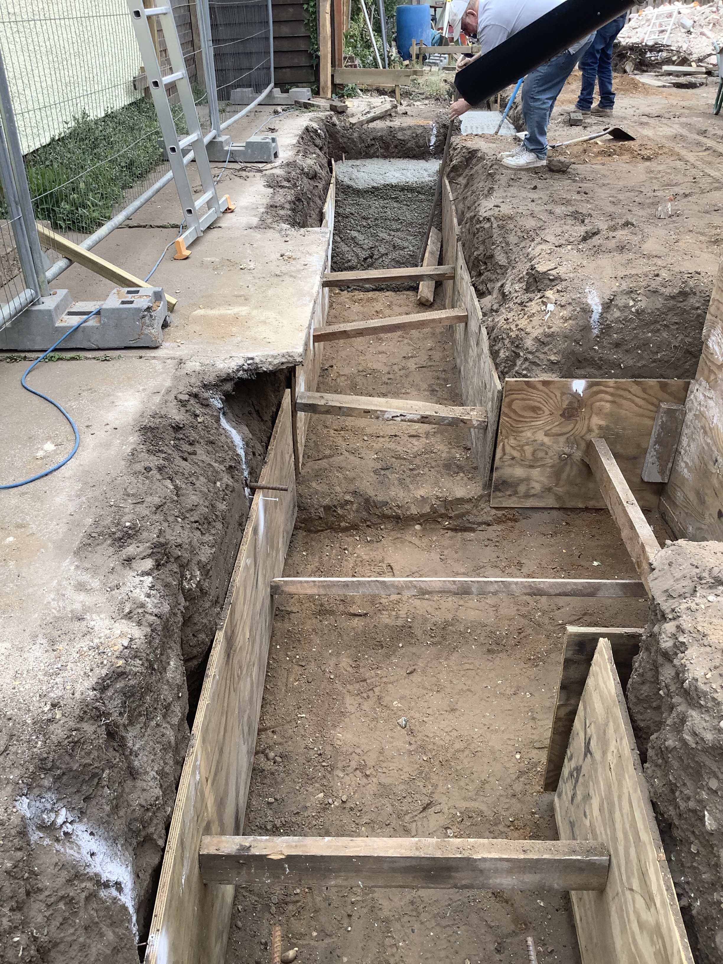

Because the concrete was ordered for 10:00 the next day we had ample time to prepare.  Only to find that they couldn’t get to site till 12:00.  There’s one thing more stressy than being tight for time for a pour, and thats dealing with two keyed up impatient builders for two hours with little that can be done.
Between the first load and the second we needed to dig a small foundation linking the previous pour to the current one, with the concrete from today’s first pour held back by ply.  That we did just in time (providing the stress fix that groundworkers appear to enjoy).  That ply did have to come out to allow the two pours of the day to meld, and that took a surprising amount of force.
After a late lunch with much planning talk, Steve set my homework (tidying, moving stuff, ordering), and even after that I got home a little earlier than usual, with two thirds of a set of foundations.  Behind schedule but still pleasing.
