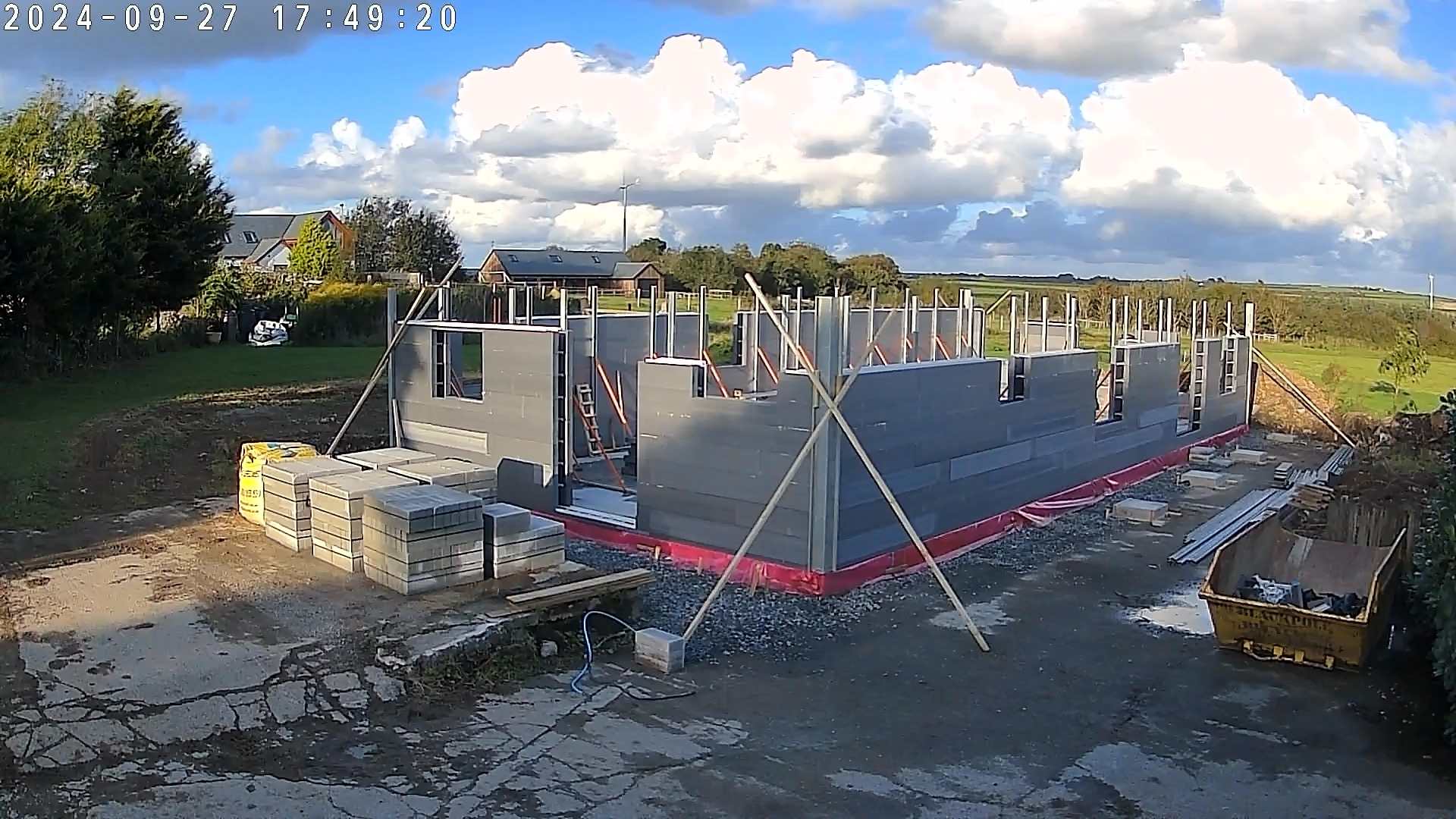

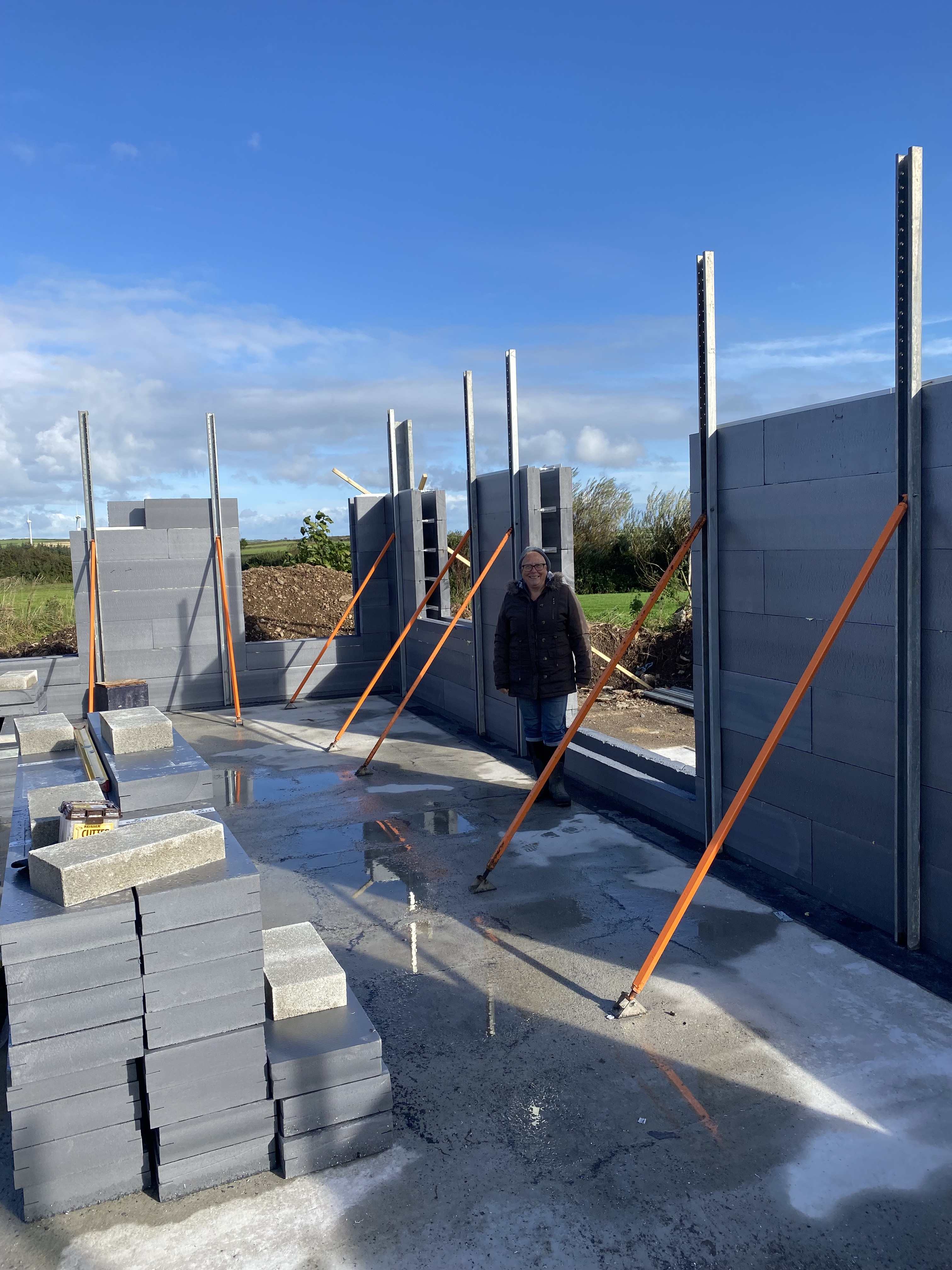

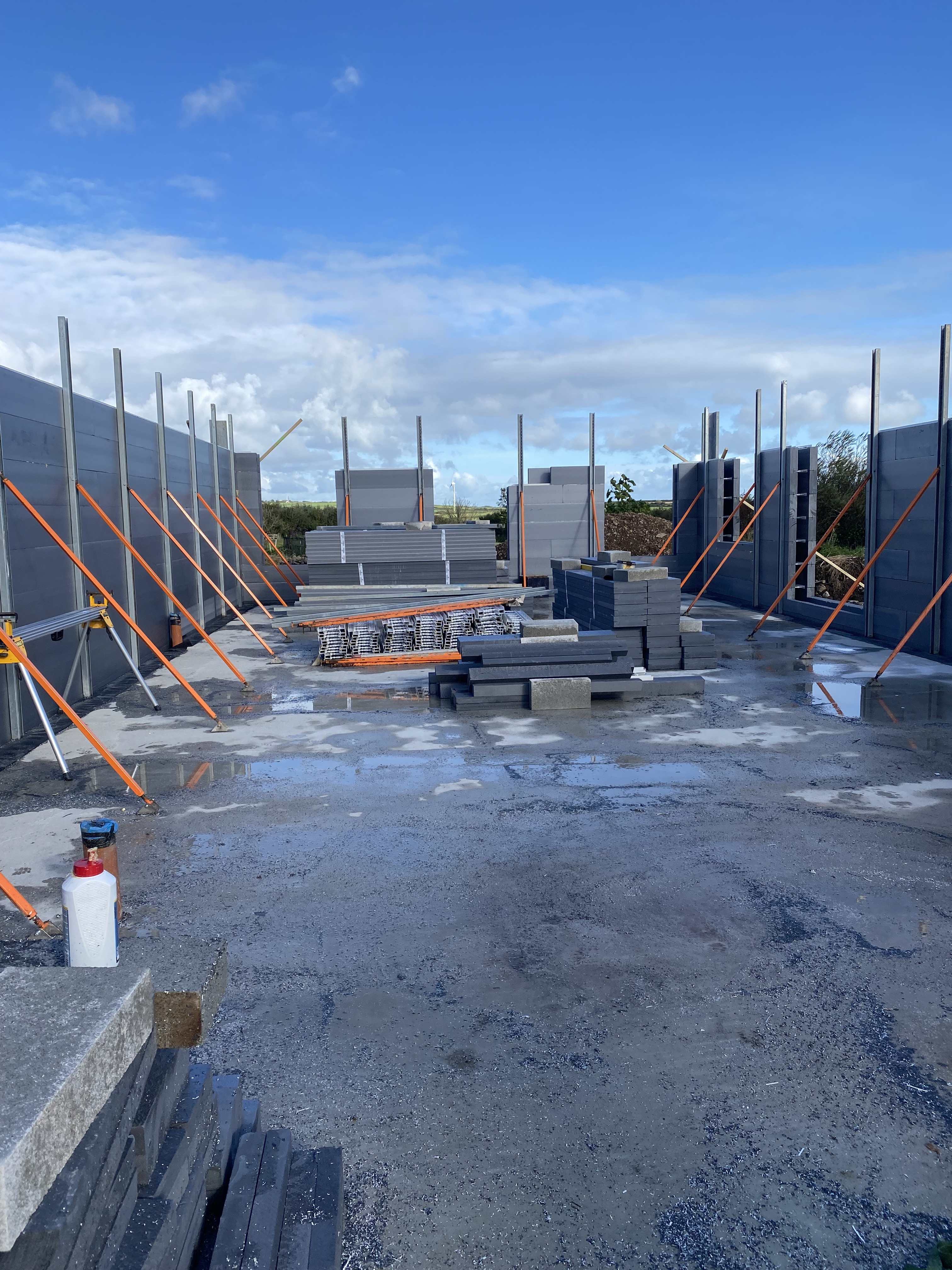

The last bit of soil pipe and inspection chambers that are close to the house are completed.

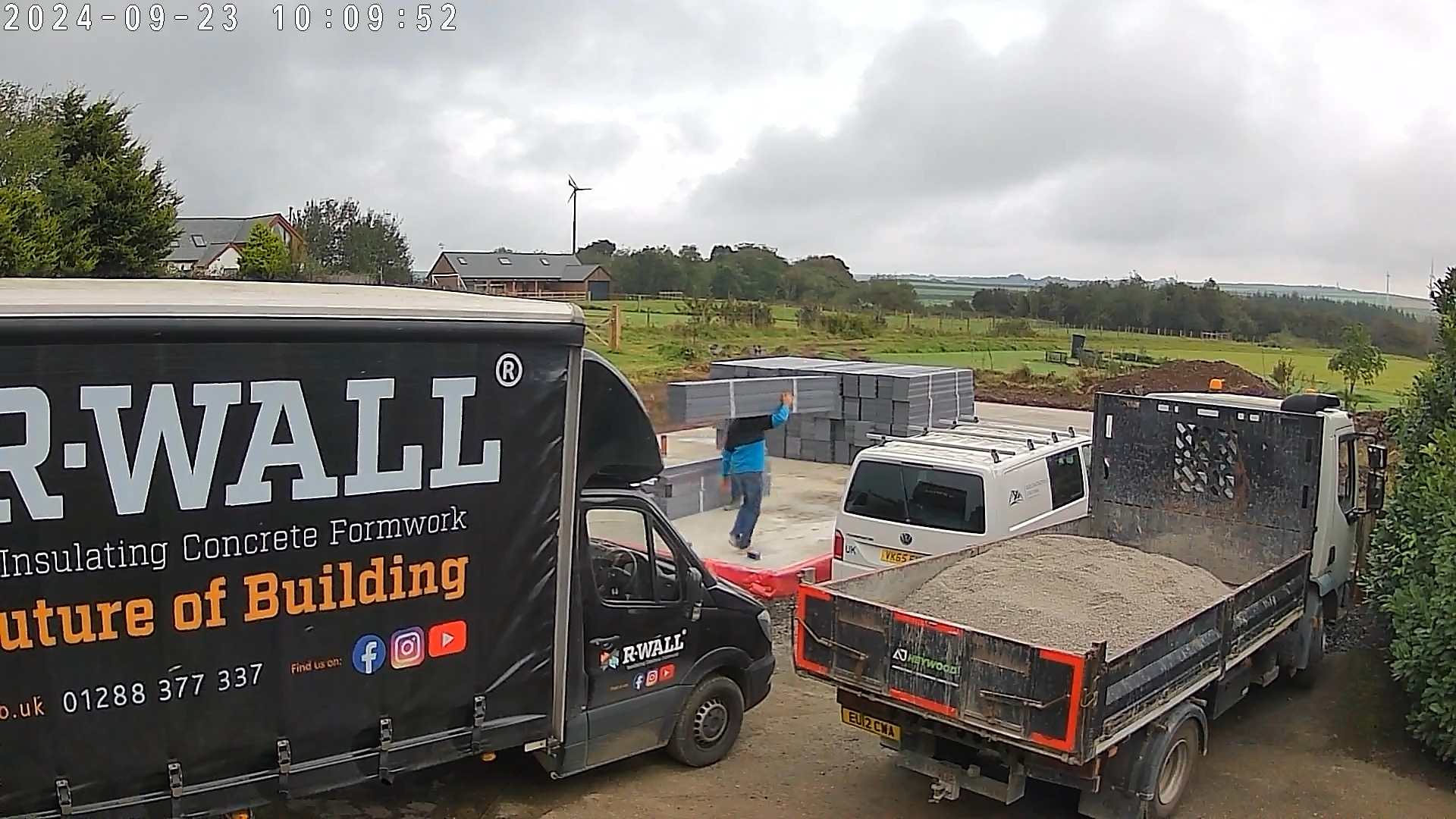

The ICF is delivered and by the end of the week we have the start of door and window openings.

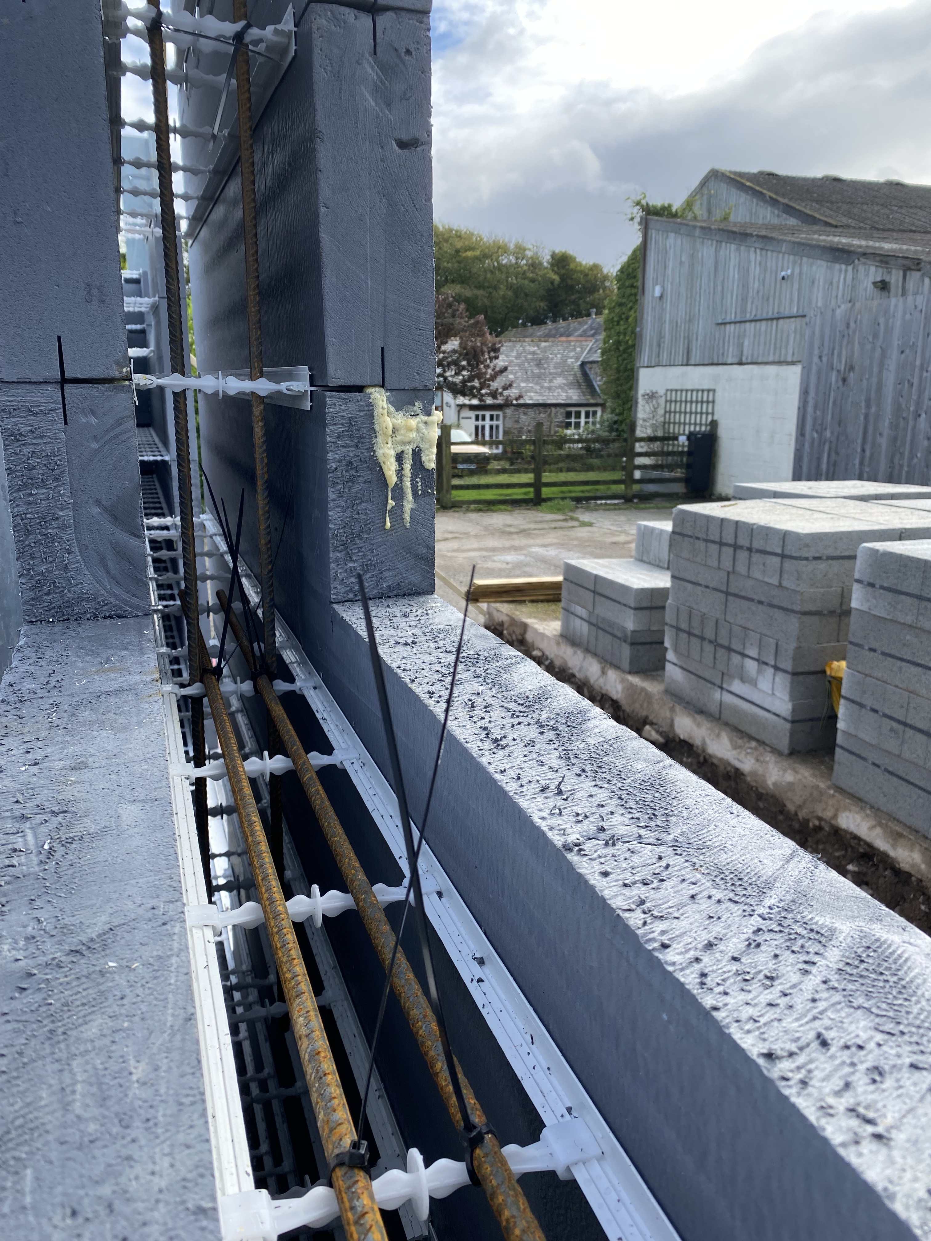

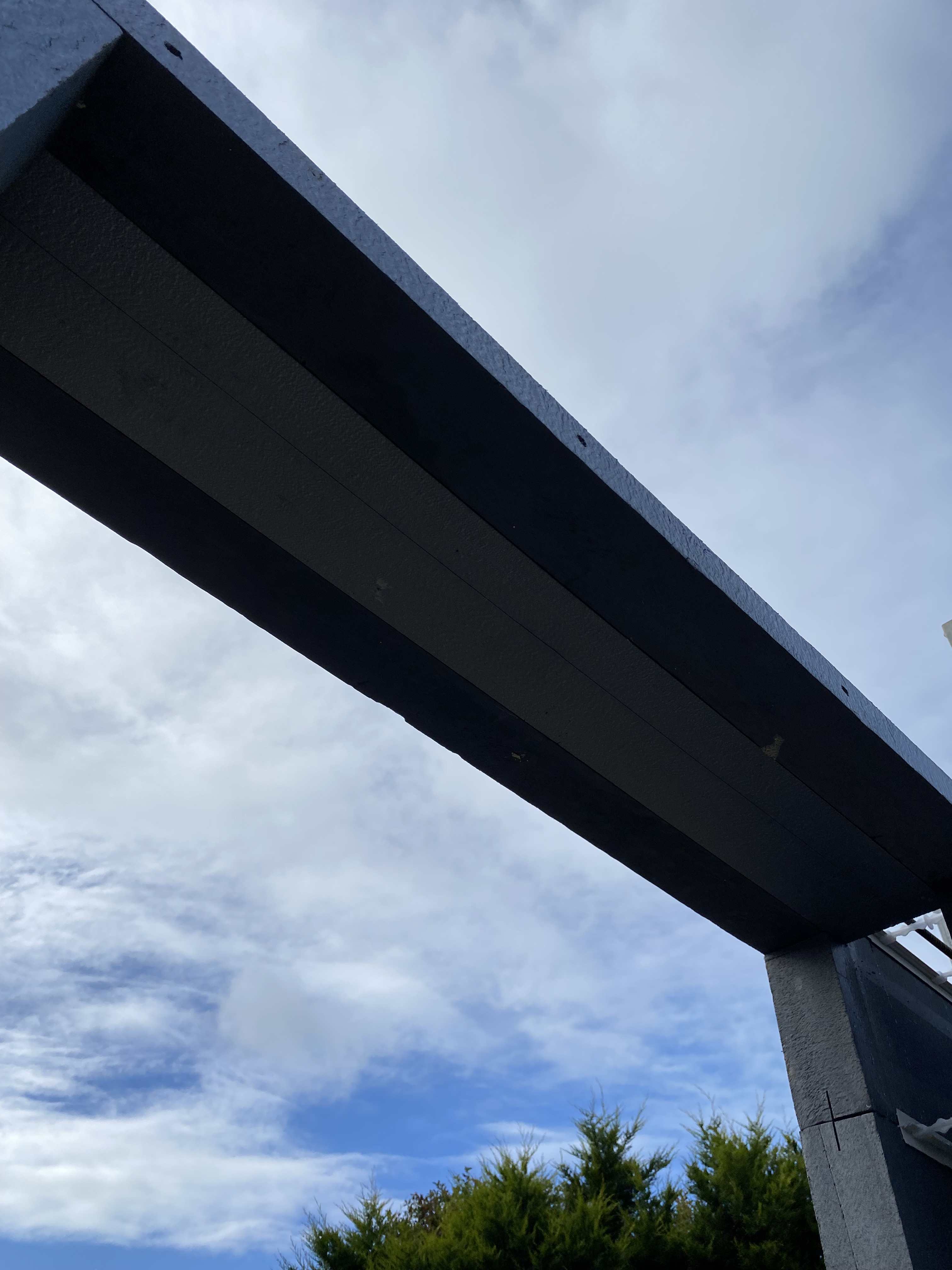

The insulation is extruded polystyrene XPS 100mm each side of the concrete cavity. U value of  0.14
The windows have rebar in them before 50mm insulation closures are added.
At the weekend we had a yellow wind warning for the South West, our home weather station recorded top gusts of 40mph. I’m pleased to say the R-wall ICF survived with no problems.
