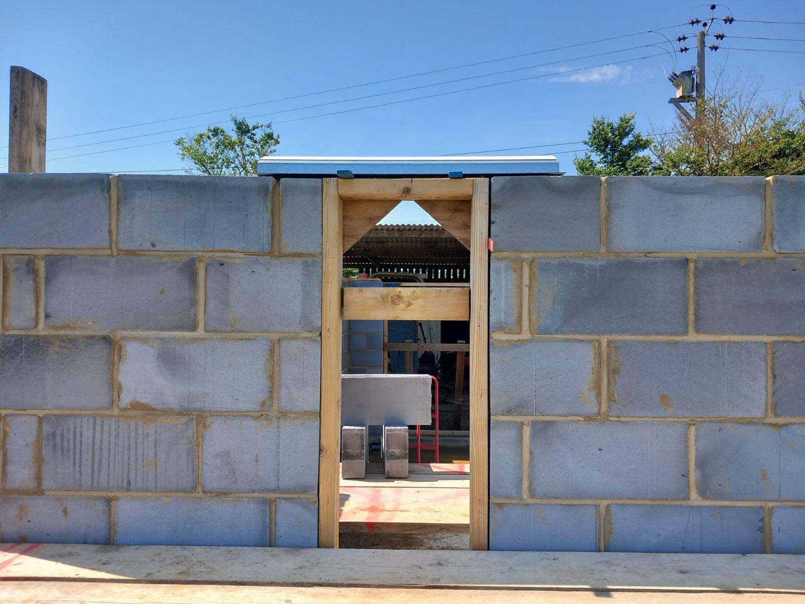

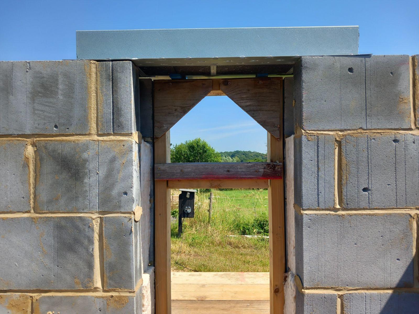

It's now ready for the lintels, which we waiting a month to be delivered.
This one requires some blockwork changes as the overhang is over a block joint.
This is the inside looking North looking down over the valley.
This is the outside looking in, again some block changes needed.
We used thermally broken IG lintels, which were on a 4 week lead time so to fill some of the time we have been prepping for phase 2.

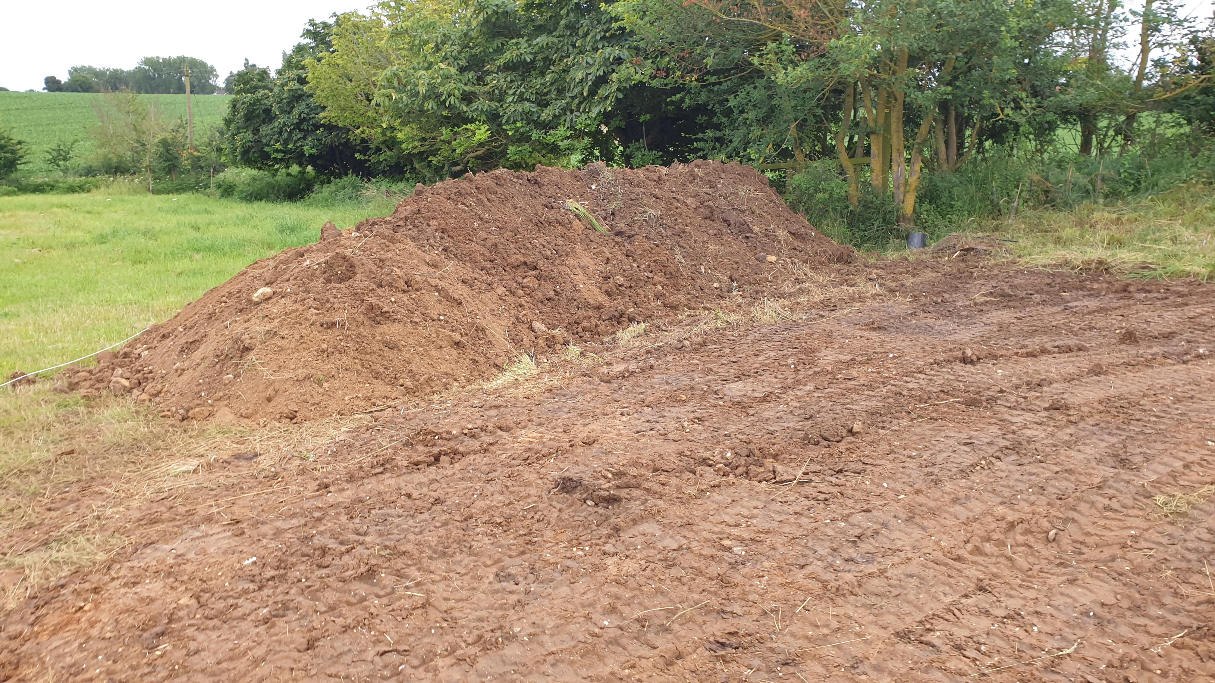

We realised we didn't have enough space for concrete lorries and storing the spoil so we moved the soil spoil heap further into the field.
This doesn't look much, but it took 3 days and countless repeats of load dumper, move and tip, and repeat !!!!

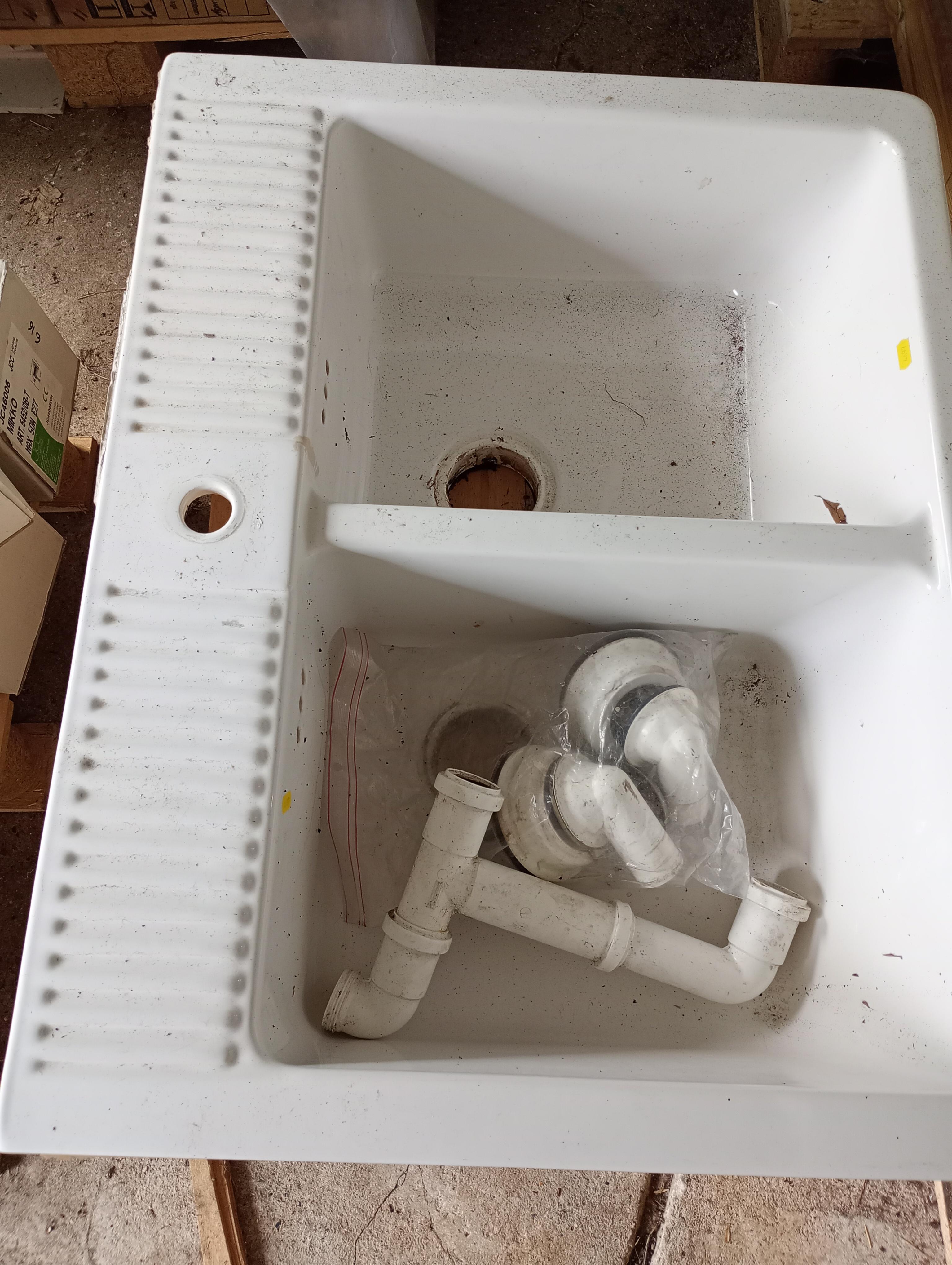

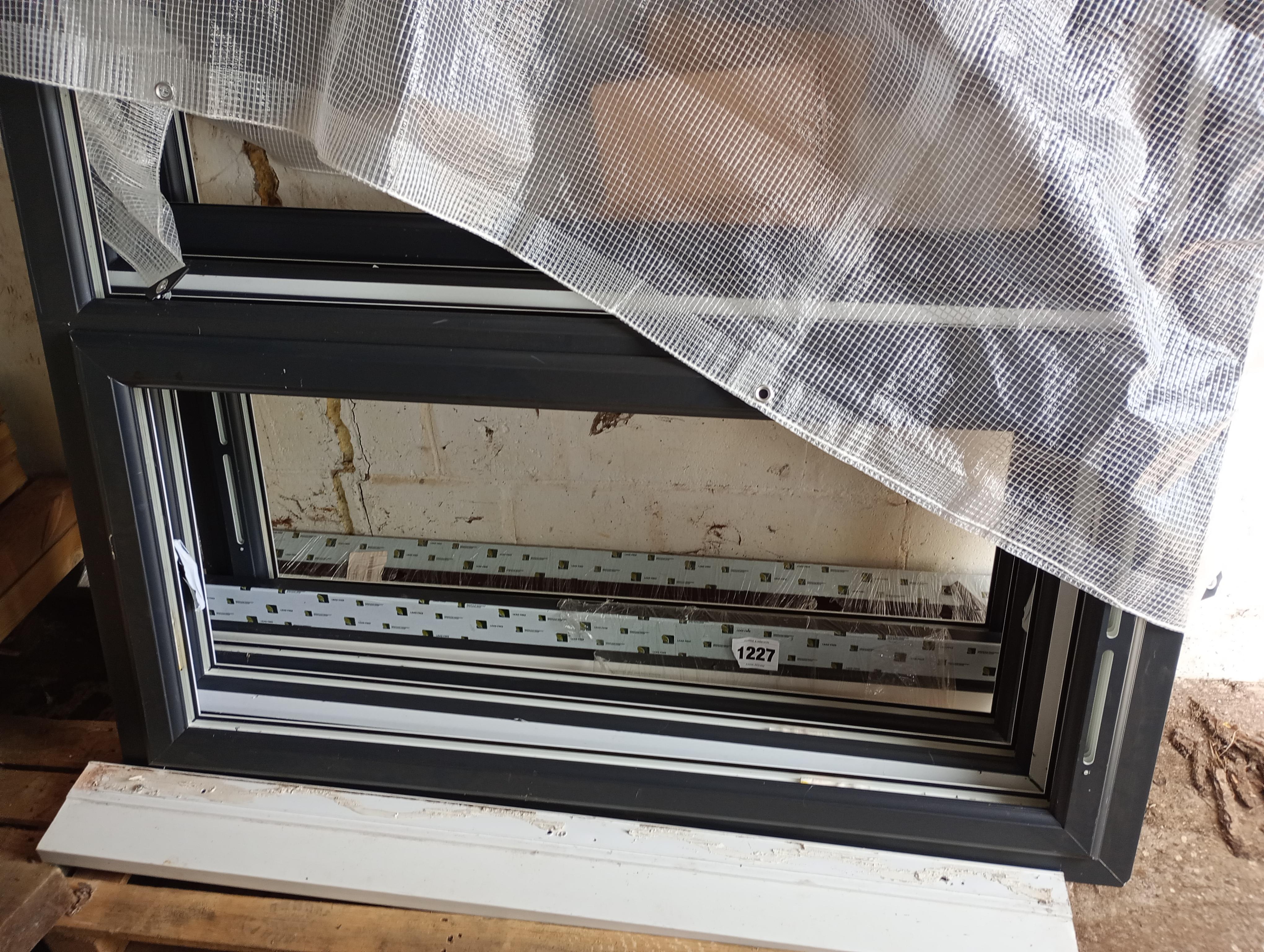

Apart from putting block on block and repeat we've bought a few items at auction.
We got some windows that are exactly the same model as we are ordering, maybe not the exact size, but we can make them fit.
Of course the cill will be replaced.
We also got a lovely sink for the utility room.

no cavity closers ?
much better job to build them in as you go for airtightness later on.
  • Like 1
Link to comment
1 hour ago, Dave Jones said:
no cavity closers ?
we have got them, in the storage shed and will dig them out, thanks for the reminder
