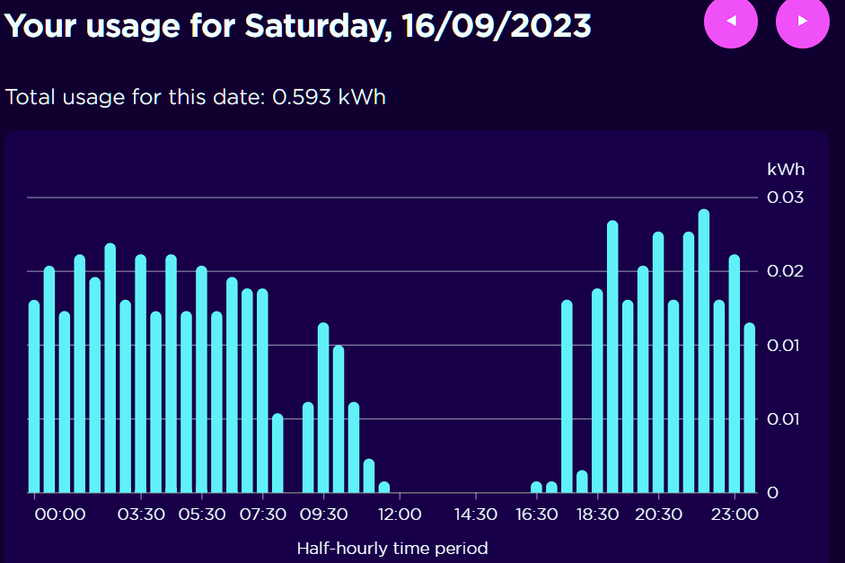

So at the last update I'd managed to get the power leakage down through an offset, and the whole system was a lot more accurate, but nonetheless still had a small amount of leakage throughout the day which was averaging around 0.5-0.6kWh, certainly not insignificant.

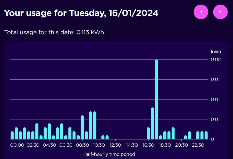

It turns out that not long after i bought this setup, Solis released a Version 2 of the inverter, which came with an external RS485 Meter, to connect the CT clamp to, and i believe this was done to improve accuracy, gutted i missed out on it, and theres no way of adding it without swapping the inverter, so thats a definite non-starter. I got back in touch with them to see if there was anything more they could do, and it was decided that I would move away from the firmware which supported the fixed offset (A1 branch), to the generally available firmware and ended up on version 17014, which was clearly much improved as now the leakage looks like this...

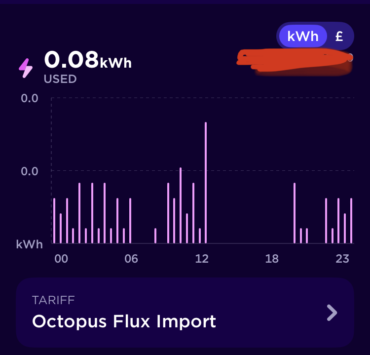

That leakage has improved even further since, why I’m not quite sure as the firmware is still the same, but my power curve now looks like this on a daily basis:
Having not needed to charge from the grid so far this month, from 1st to 12th I’ve only imported 1.38kWh, and the majority of that will have been small spikes over the max output of the inverter, which are few and far between but can happen on a real dark day which we’ve had quite a few of lately.
