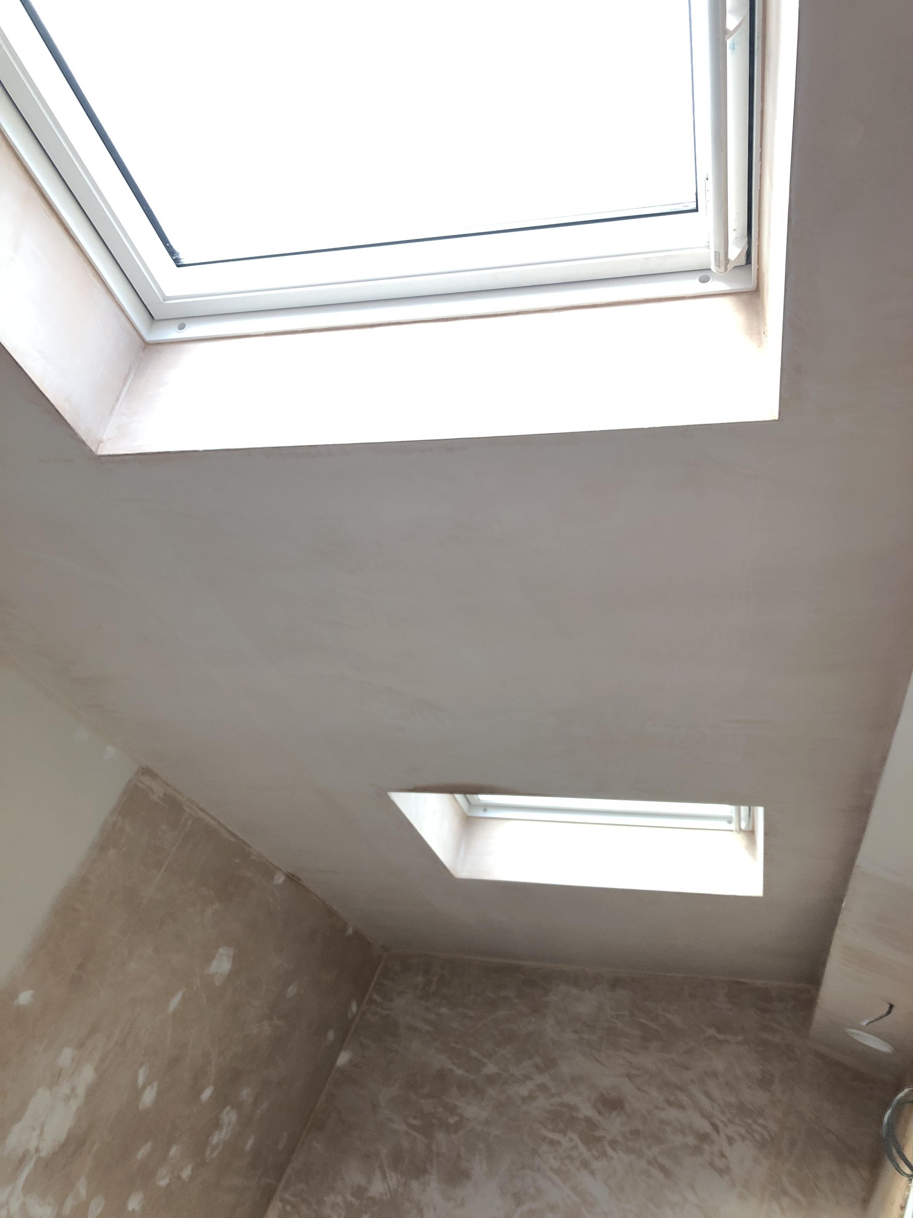

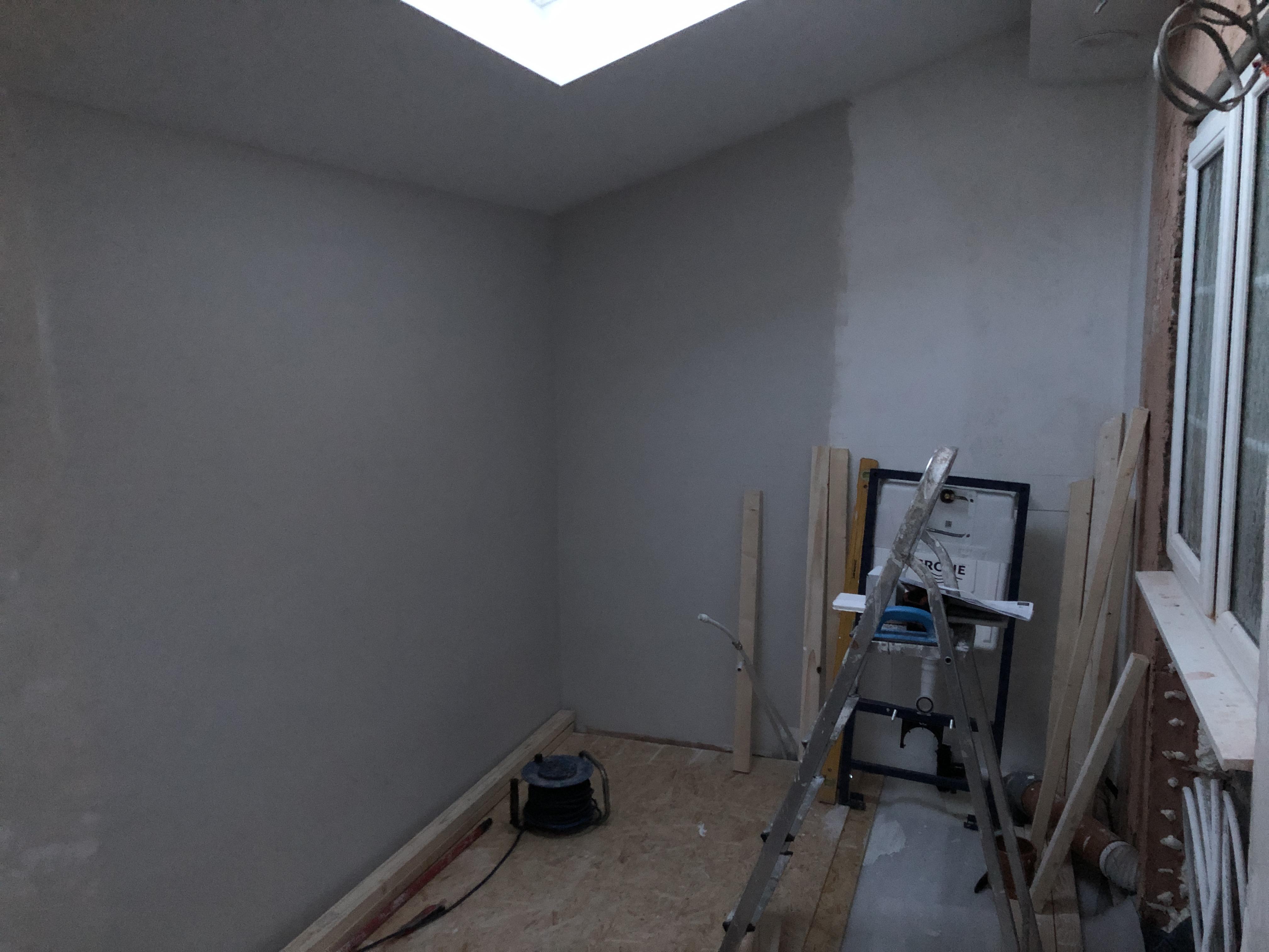

didn’t fancy tackling the ceiling for plastering in the new bit so got a pro in to do this bit for me, all done in a couple of hours which was nice.

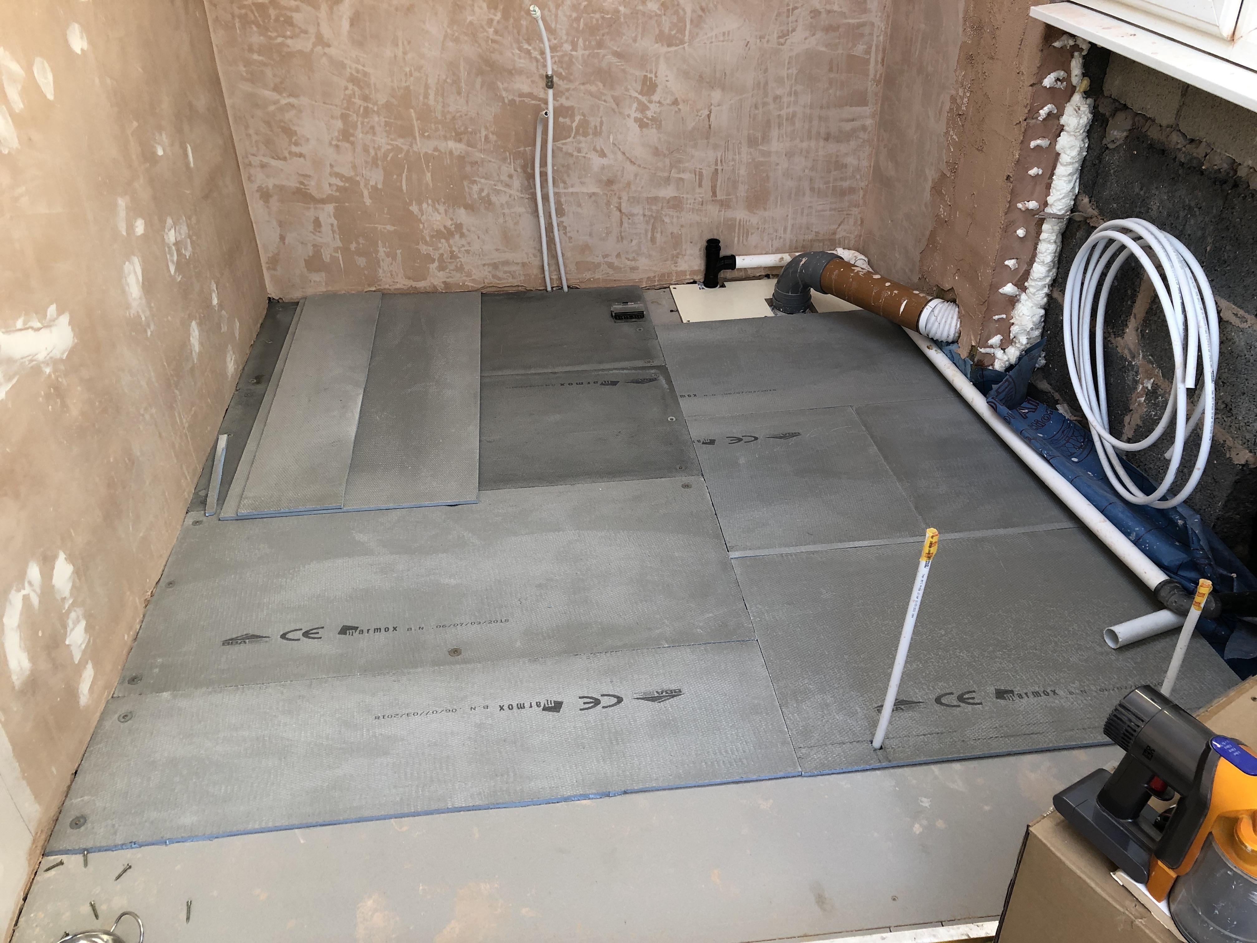

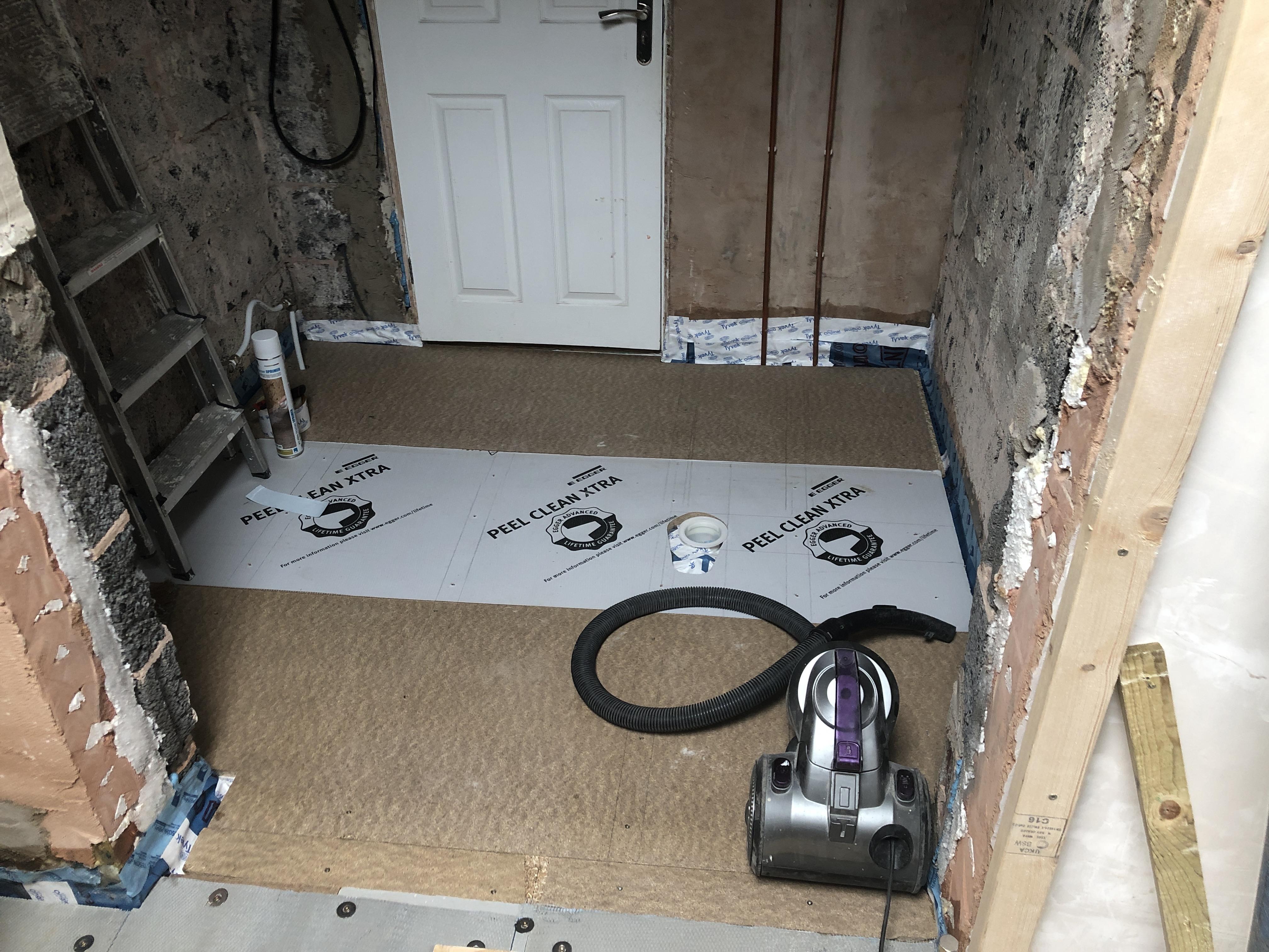

and made the most of the space and got the painting done after putting a layer of 10mm marmox board down ready to accept the underfloor heating mat

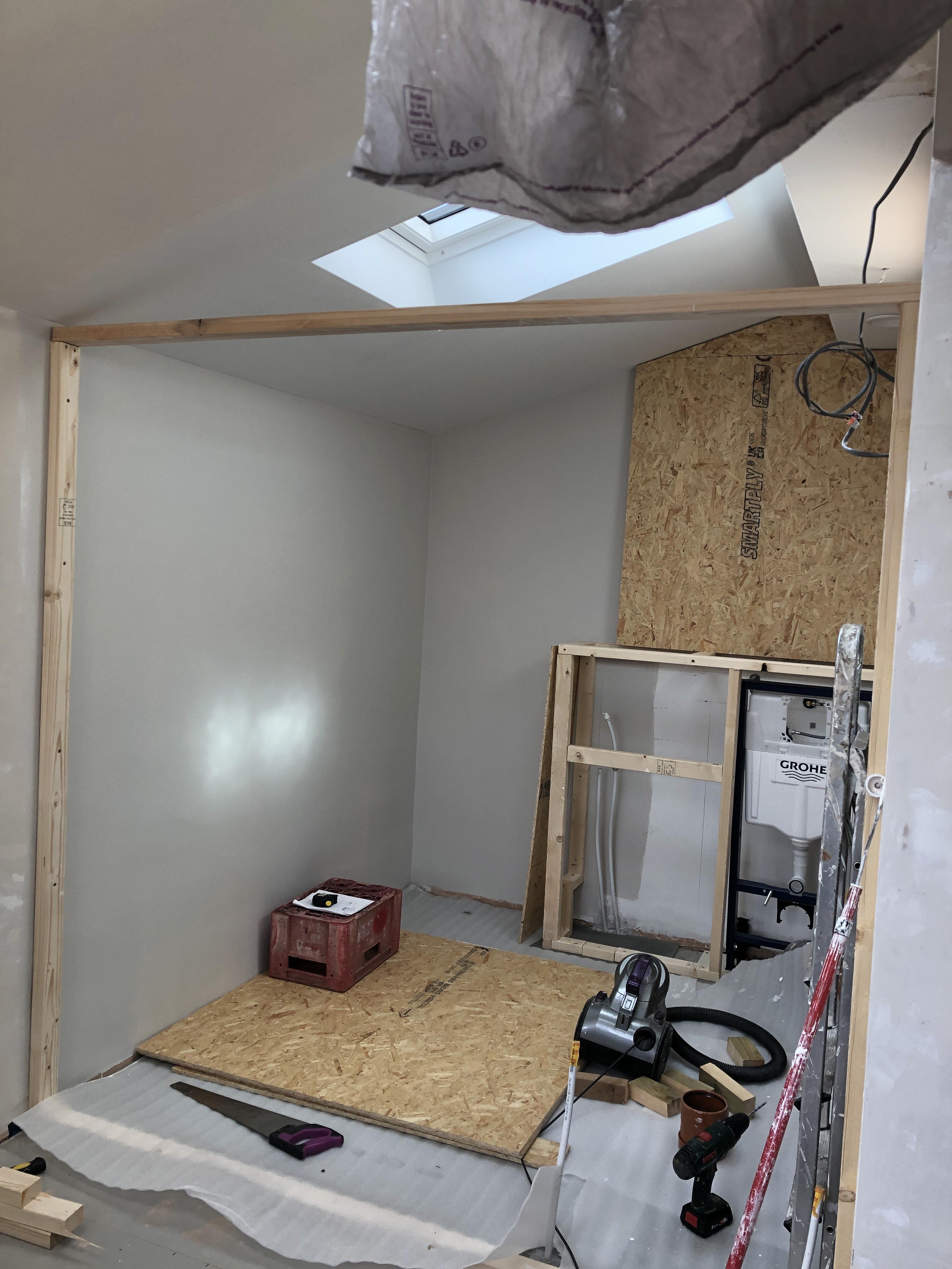

Next job was to start making a frame to hold the toilet frame and the sink and cabinet

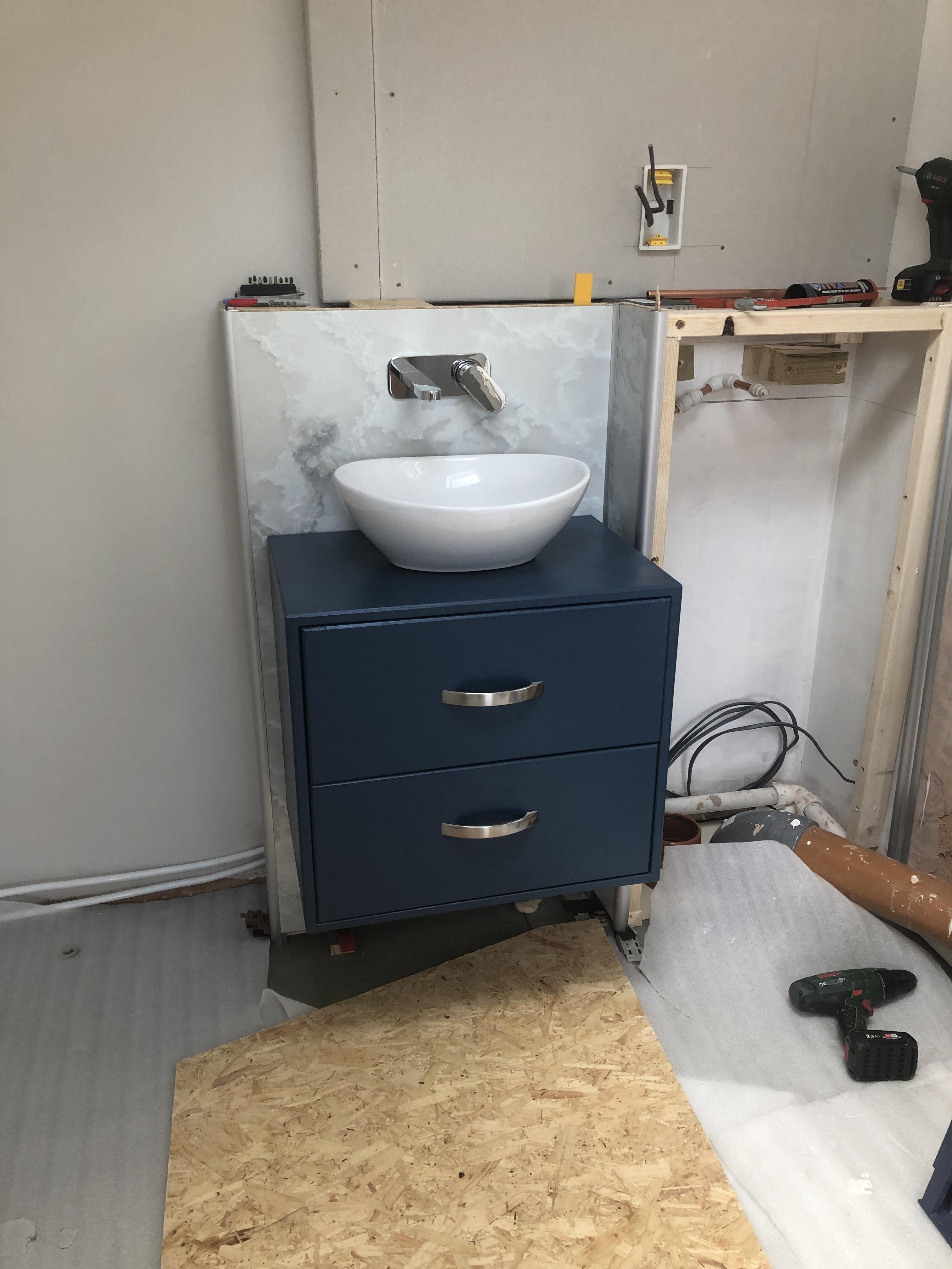

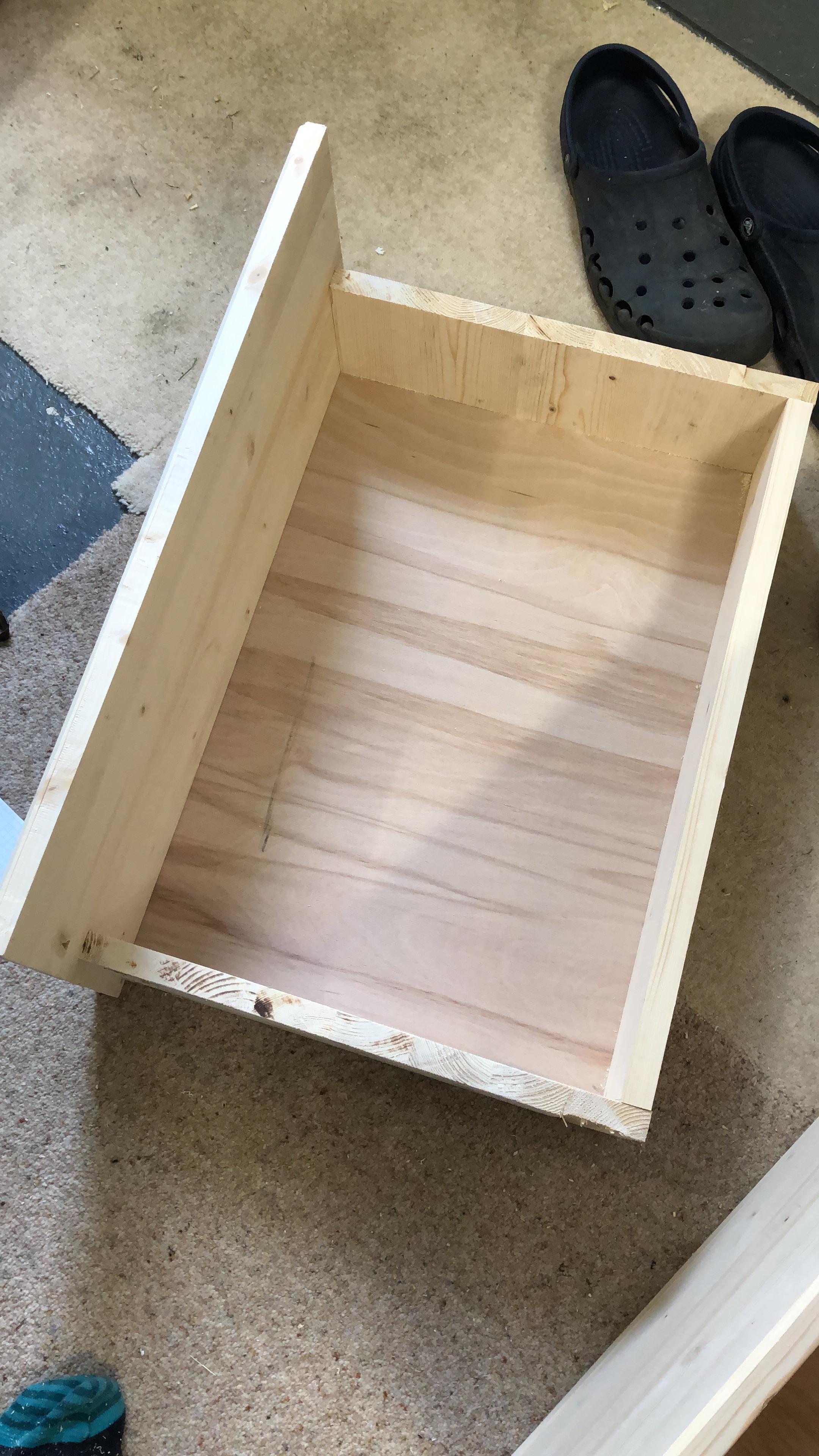

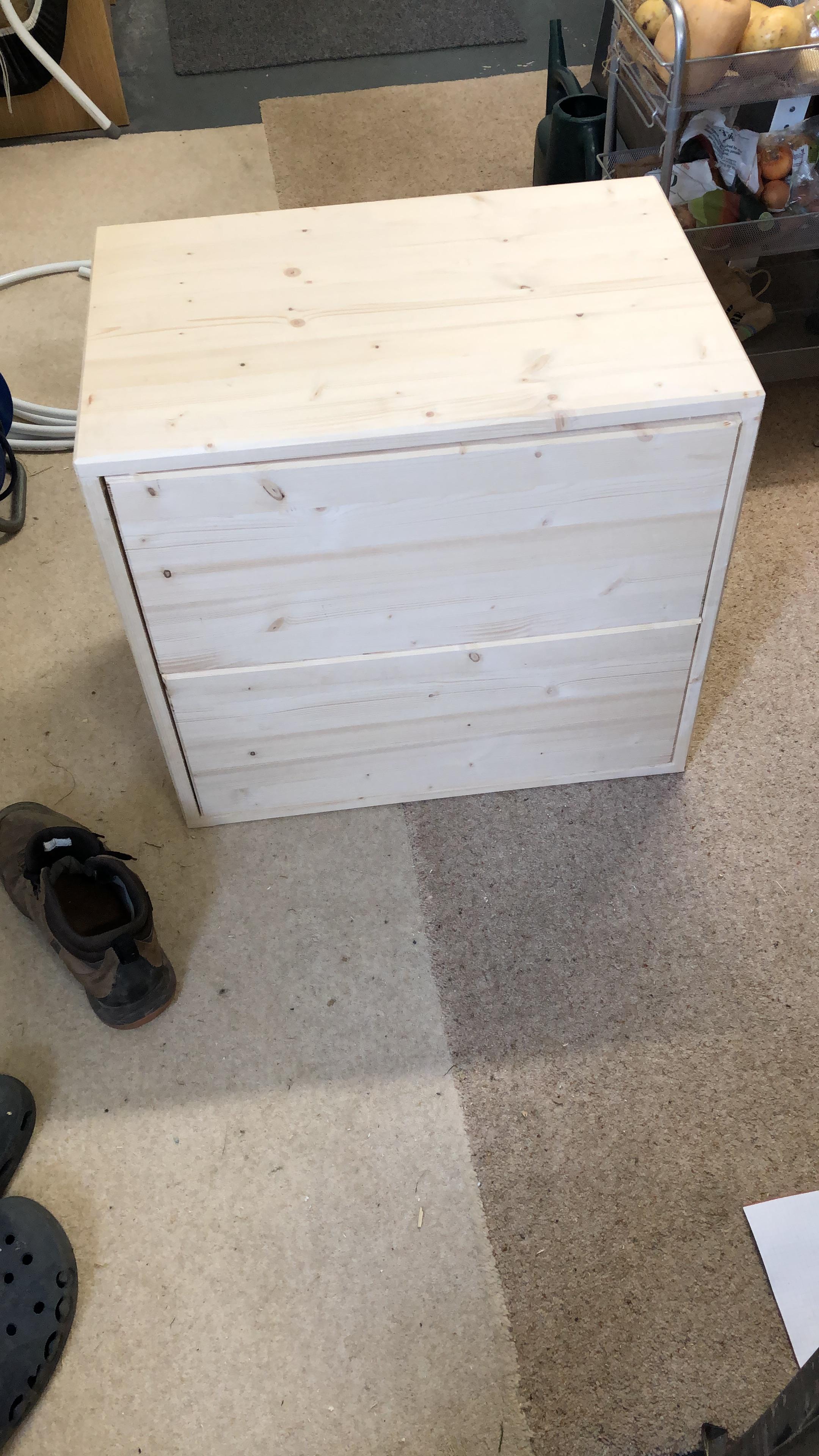

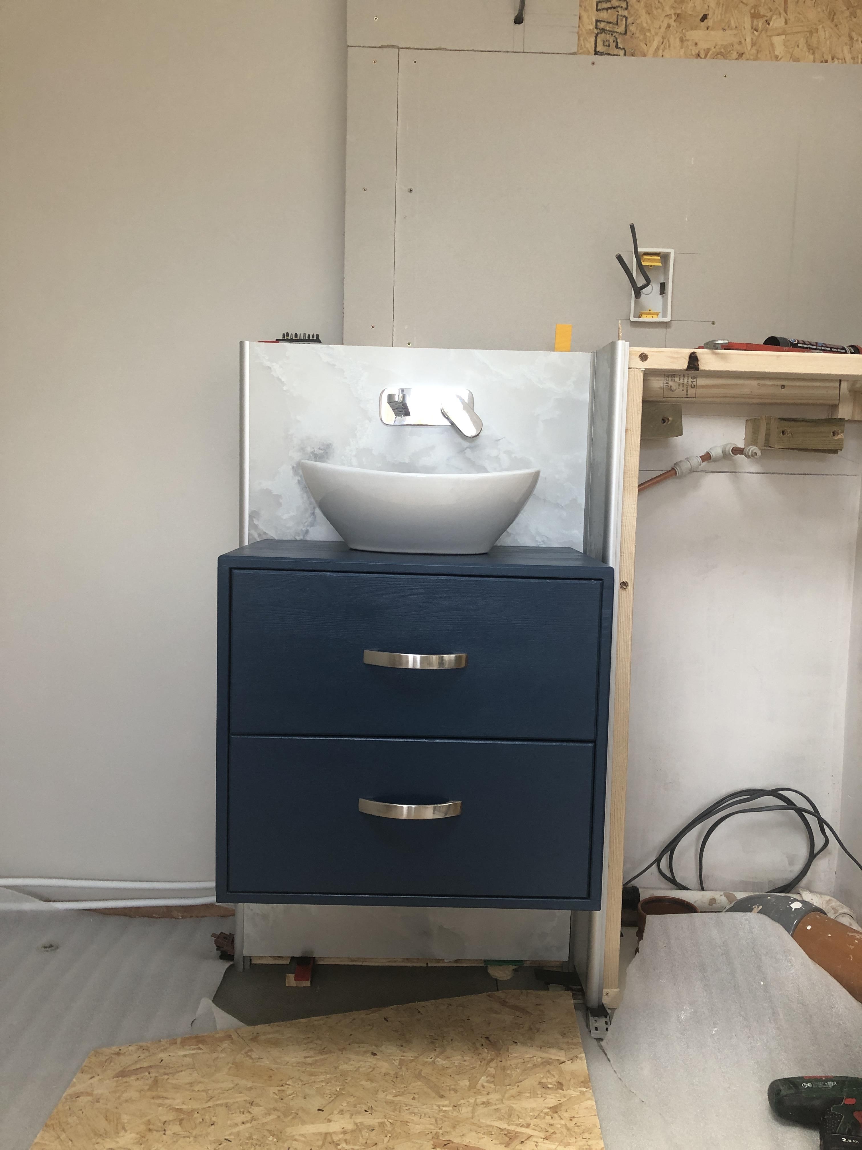

Decided on making my own cabinet rather than paying silly money for an MFC one, got pine furniture boards, a pocket hole jig and a new router and came out with this which I’m pretty happy with

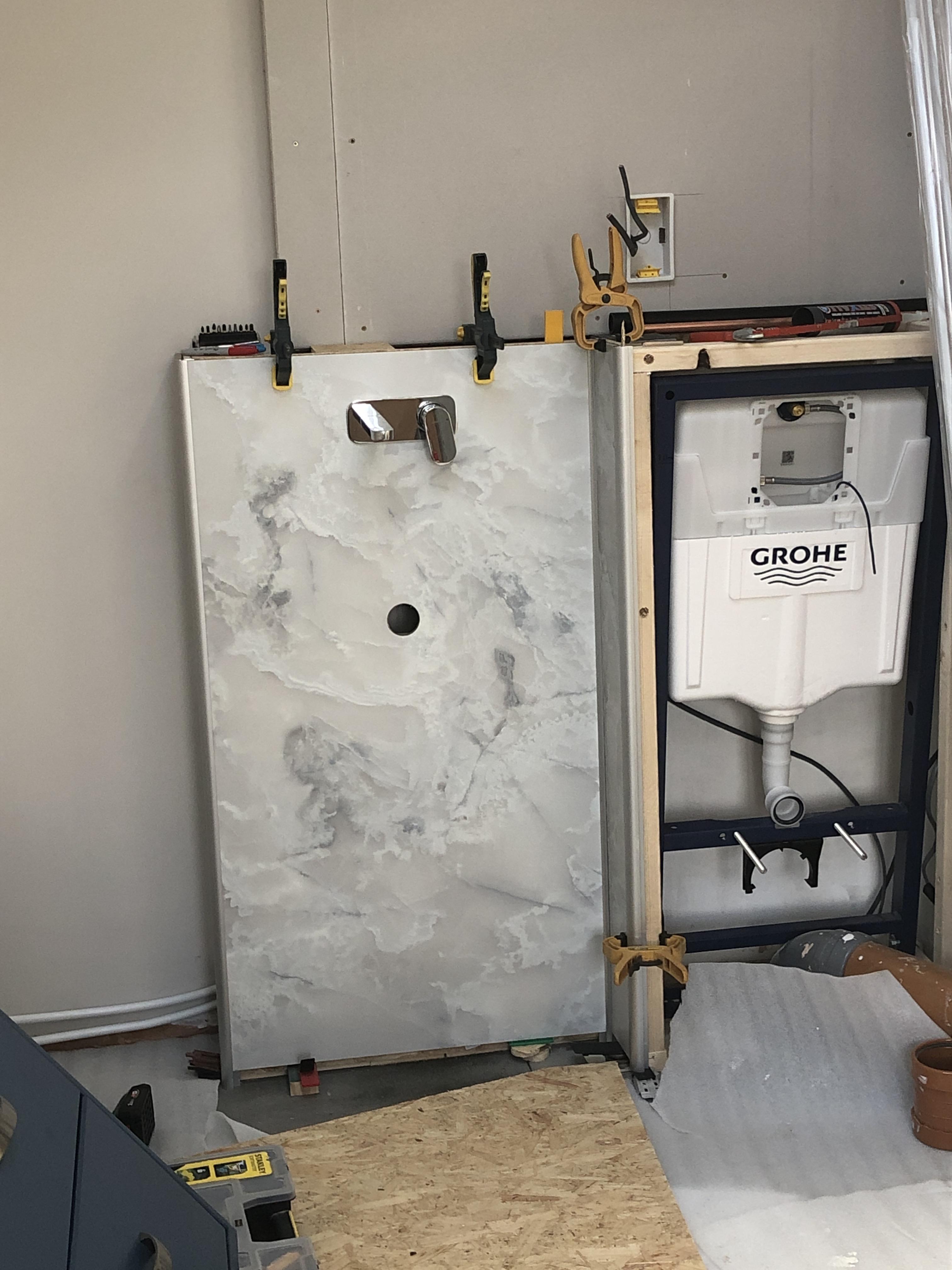

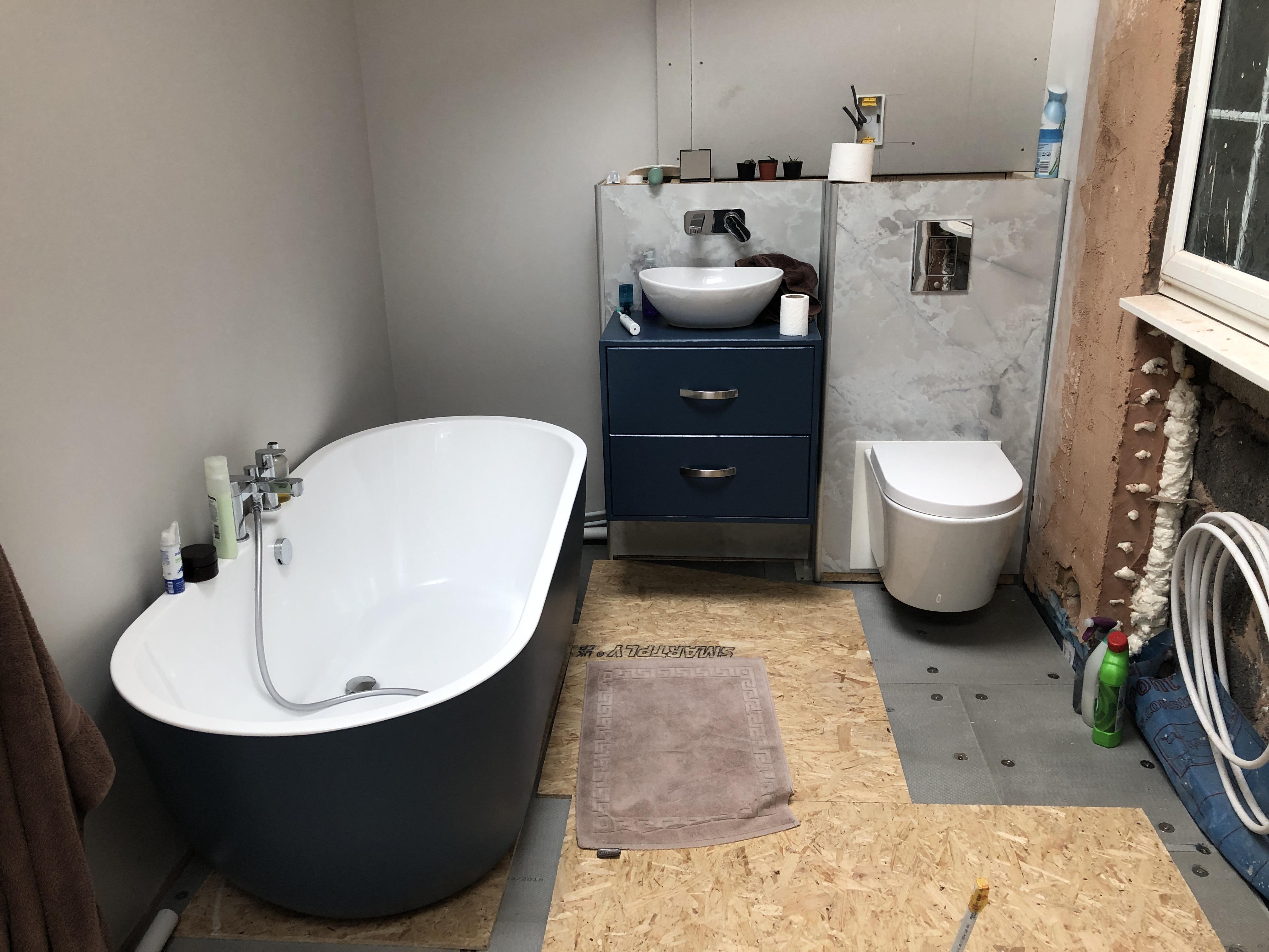

that all got painted and the sink installed, wall mounted tap and the wet room panels that I’m using both for this and for the walk in shower area all installed.

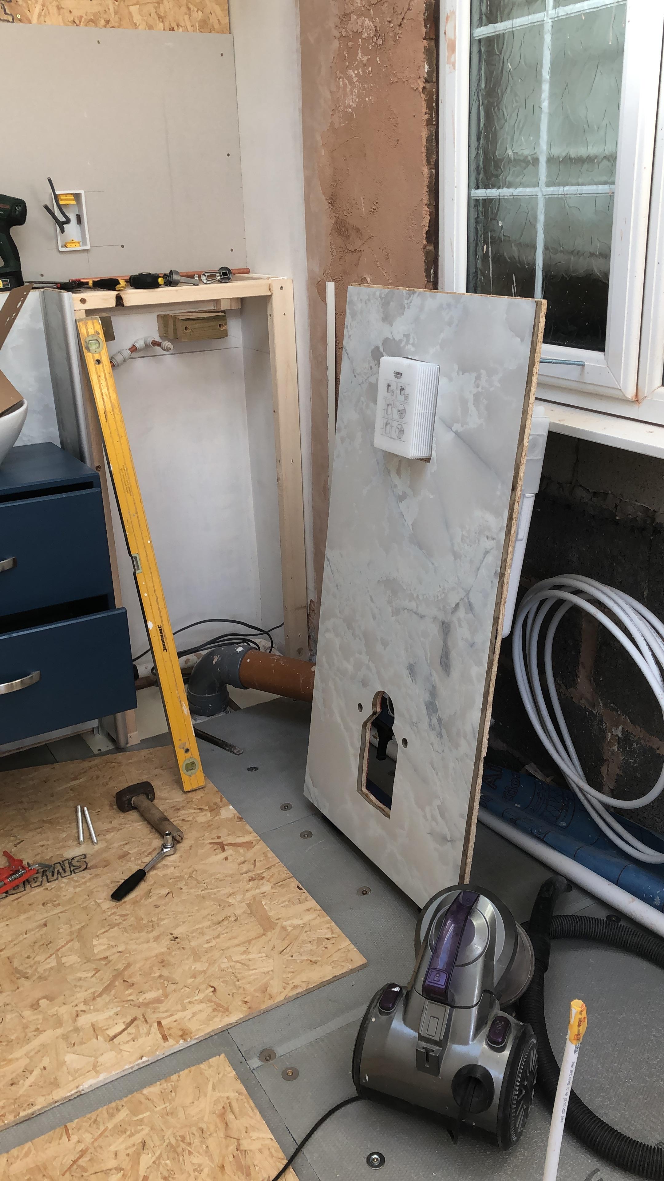

got to work cutting the OSB backing and wet room panel for the toilet in prep for the final big push to disconnect the old and commission the new, that was a hard days work!
And then bath and toilet all installed

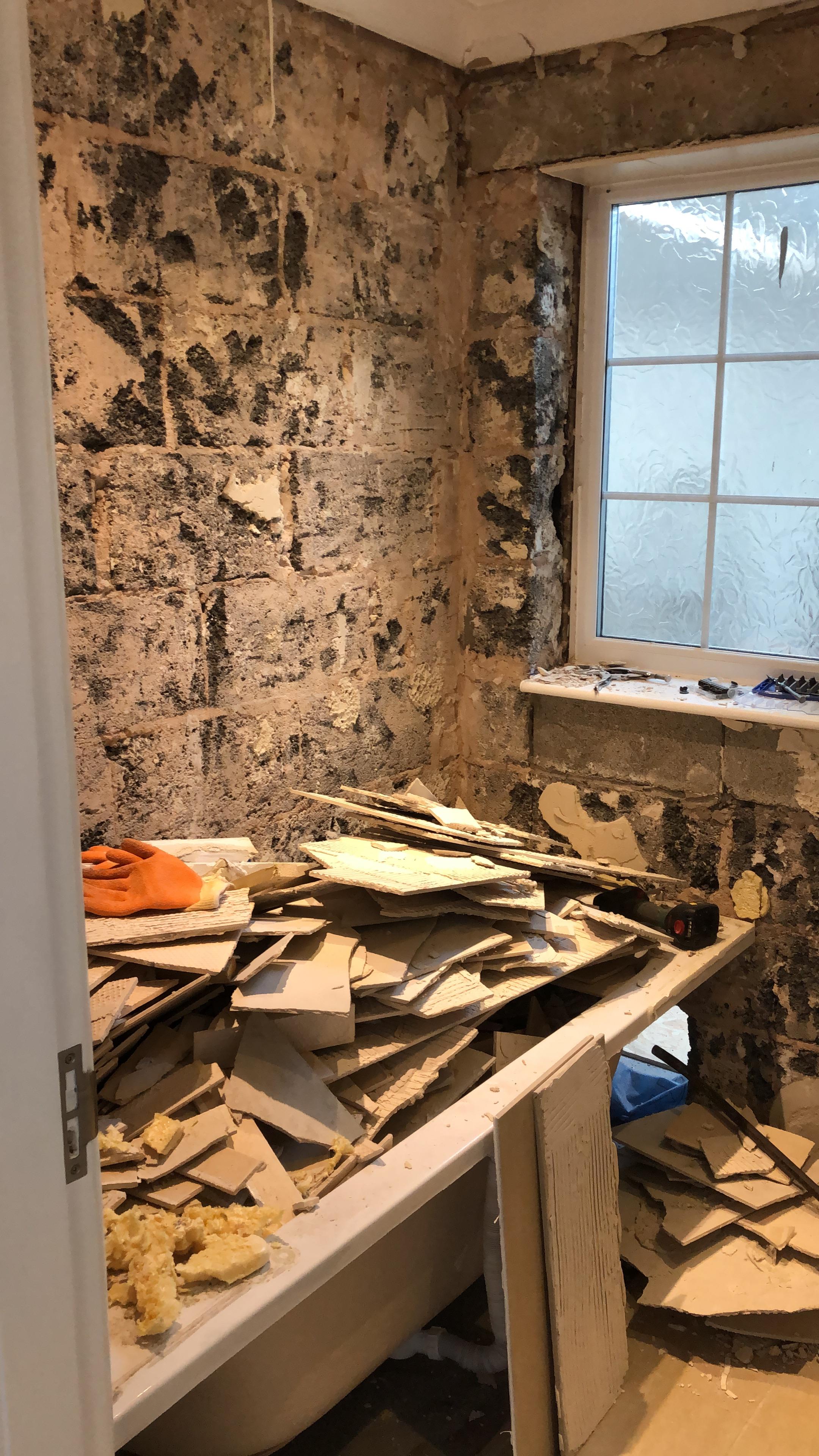

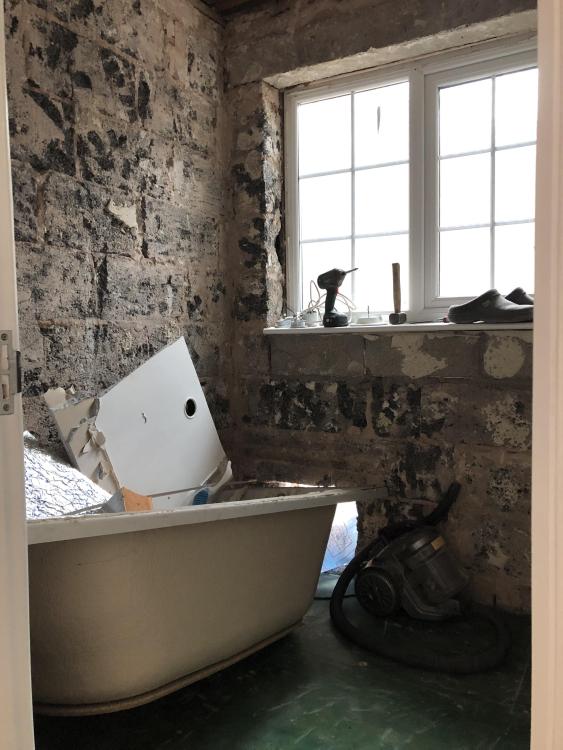

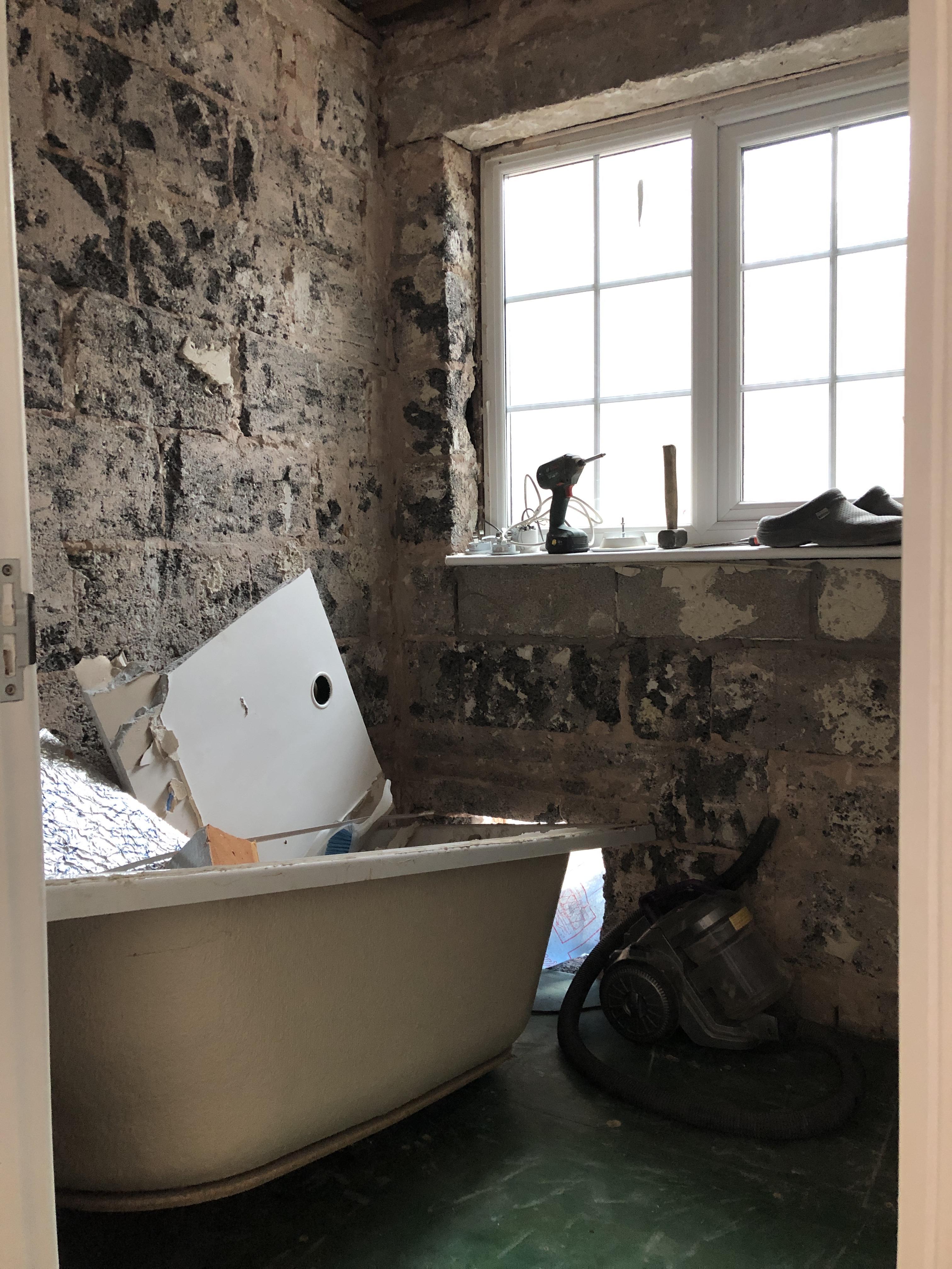

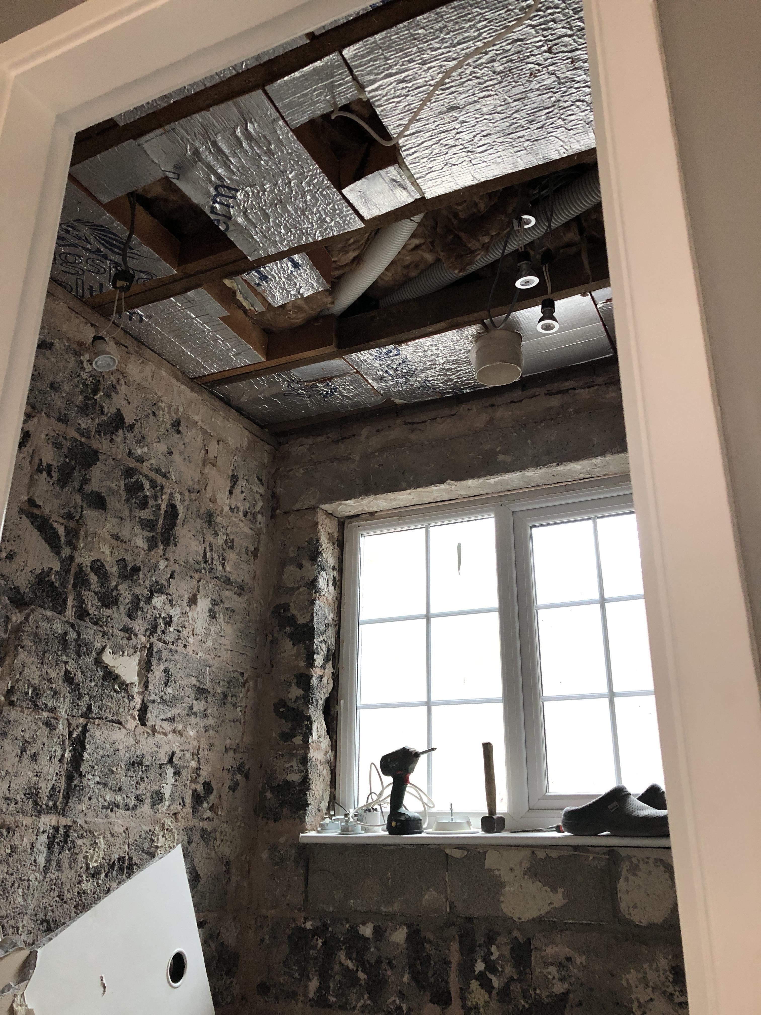

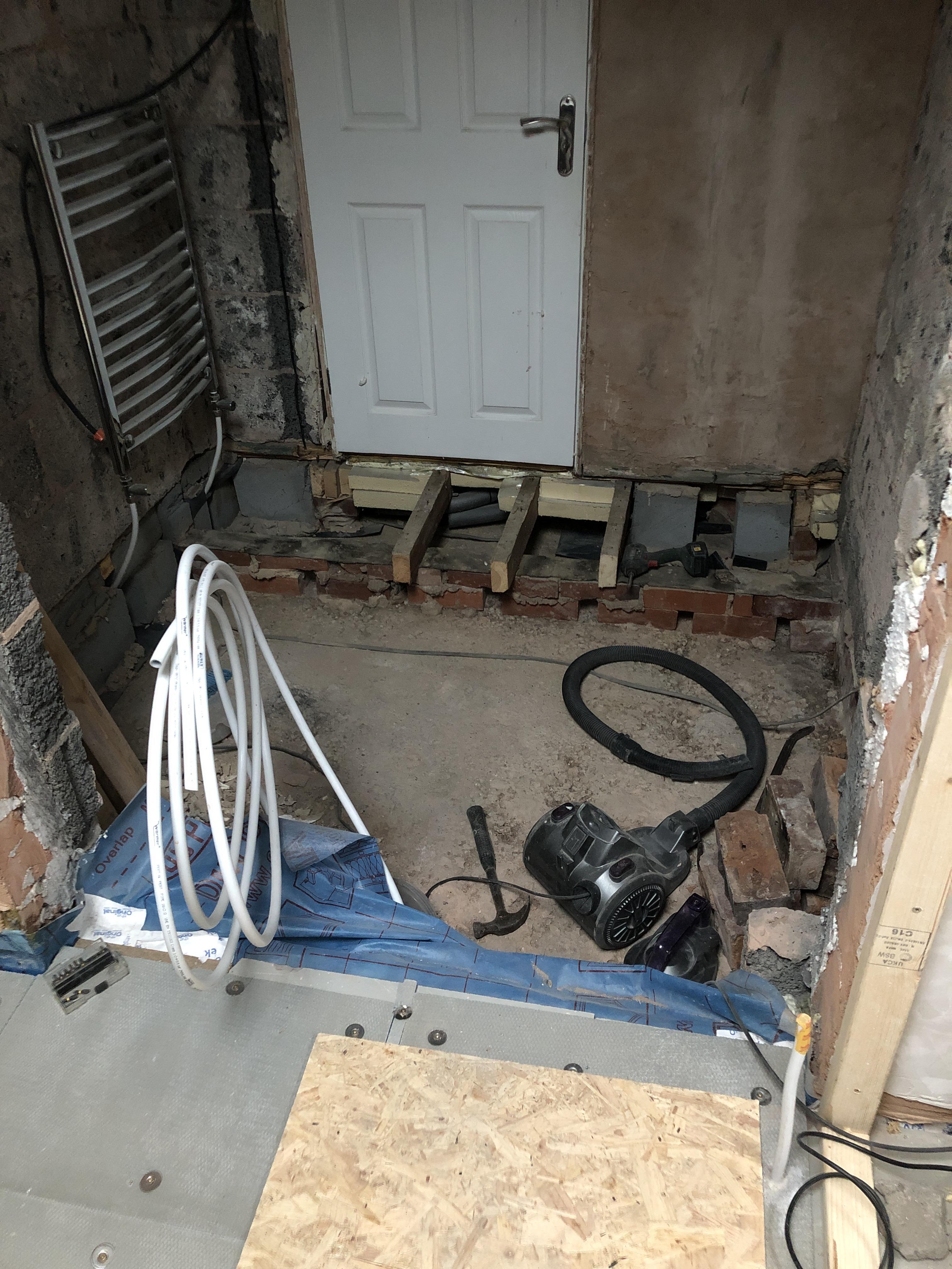

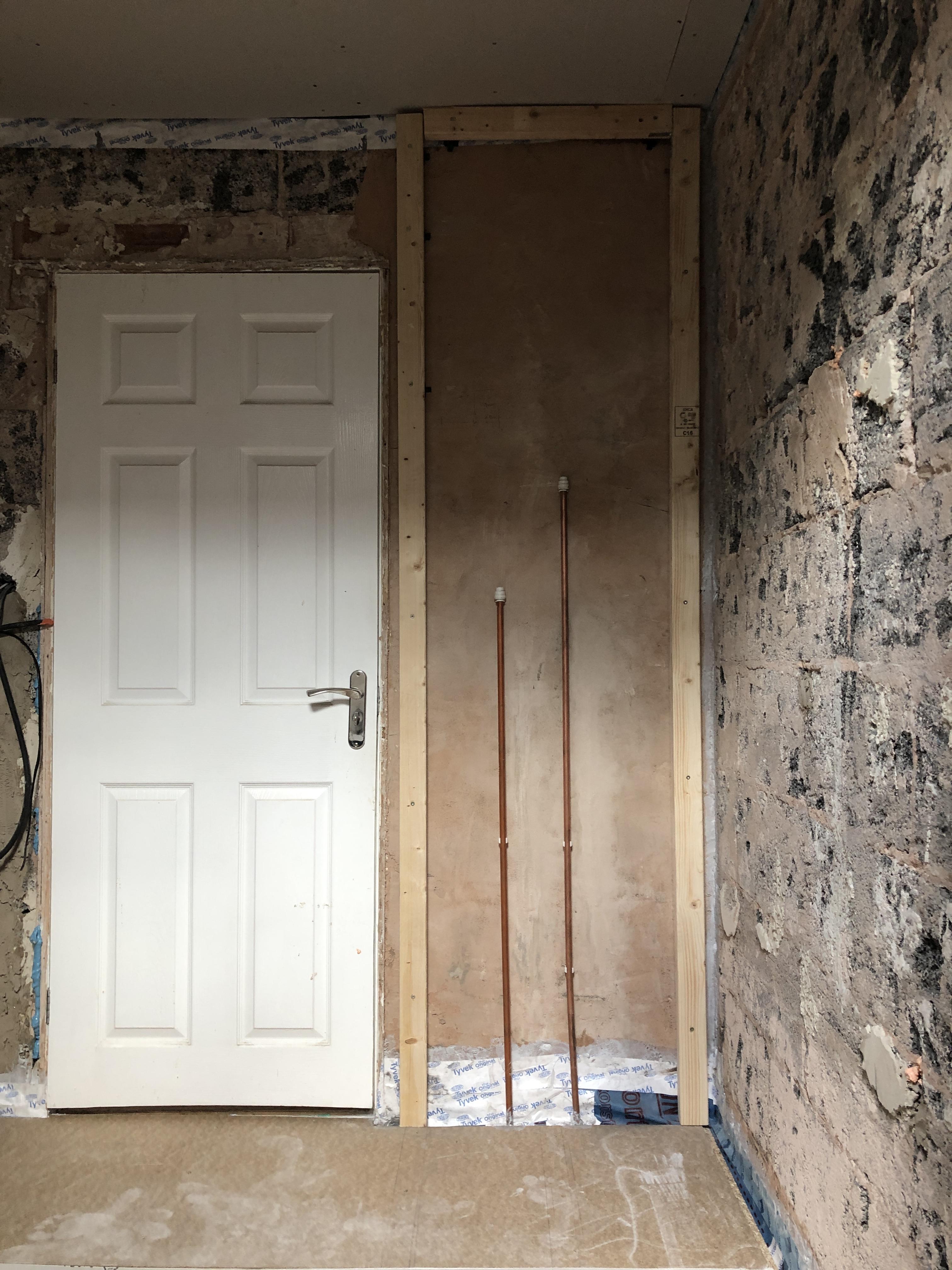

Made a start on stripping the old bathroom out

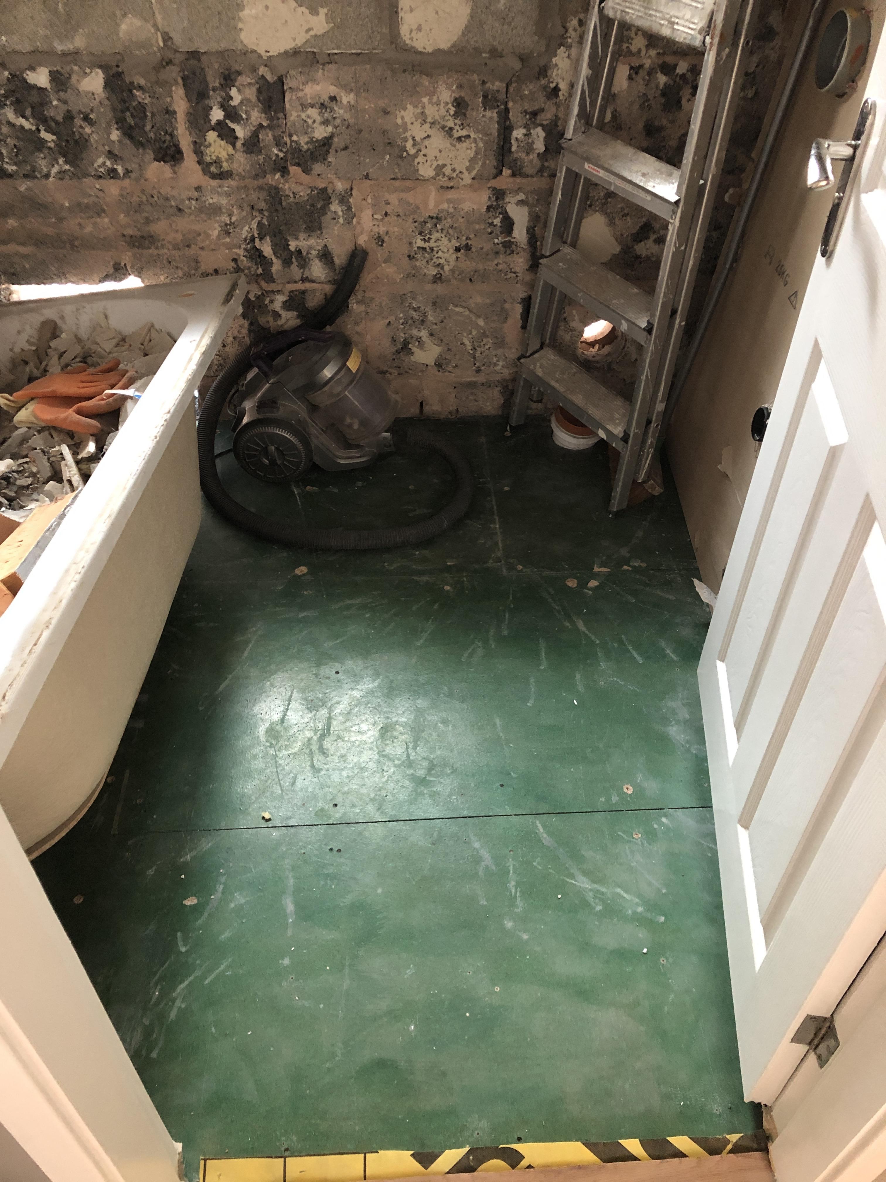

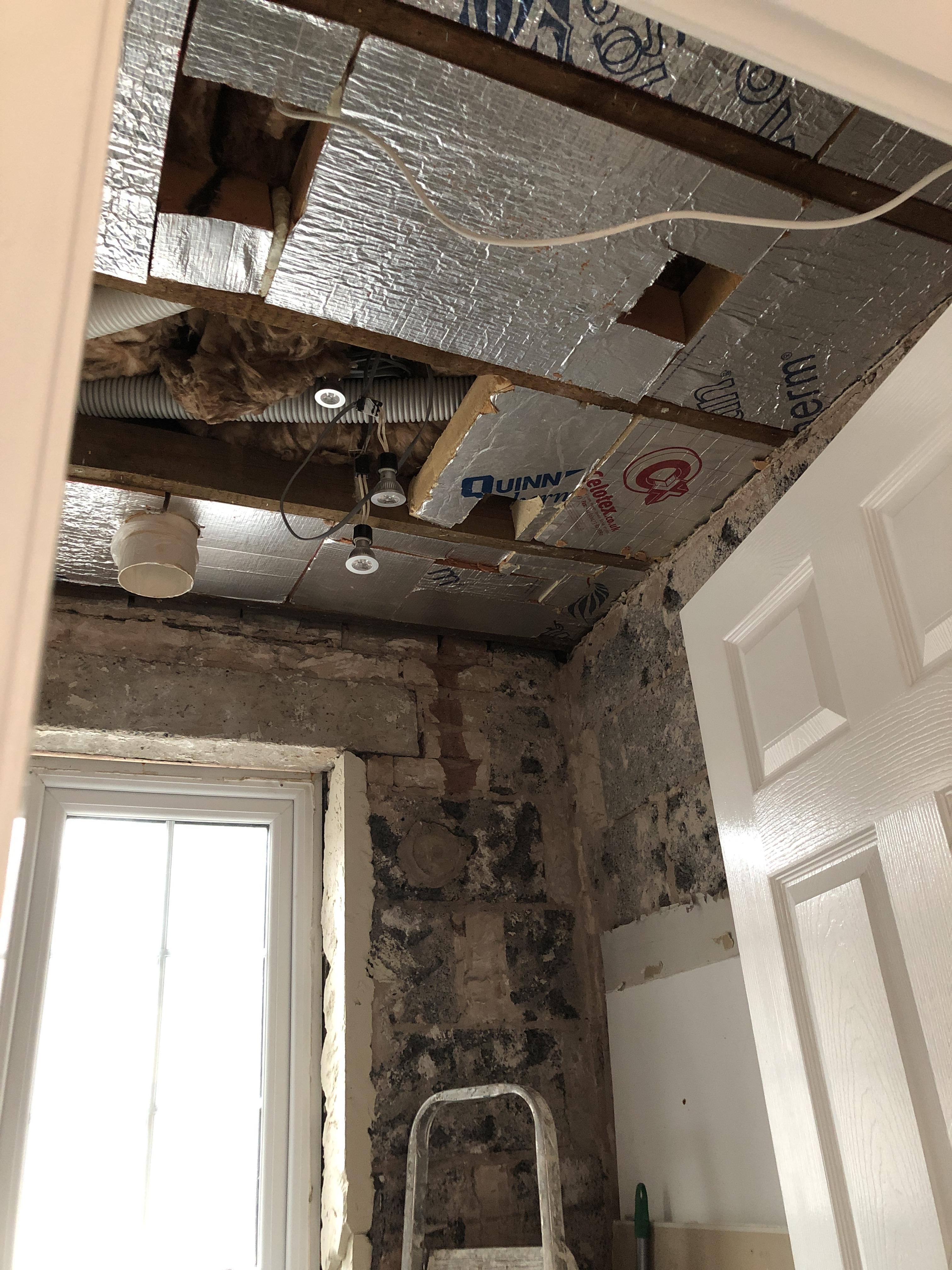

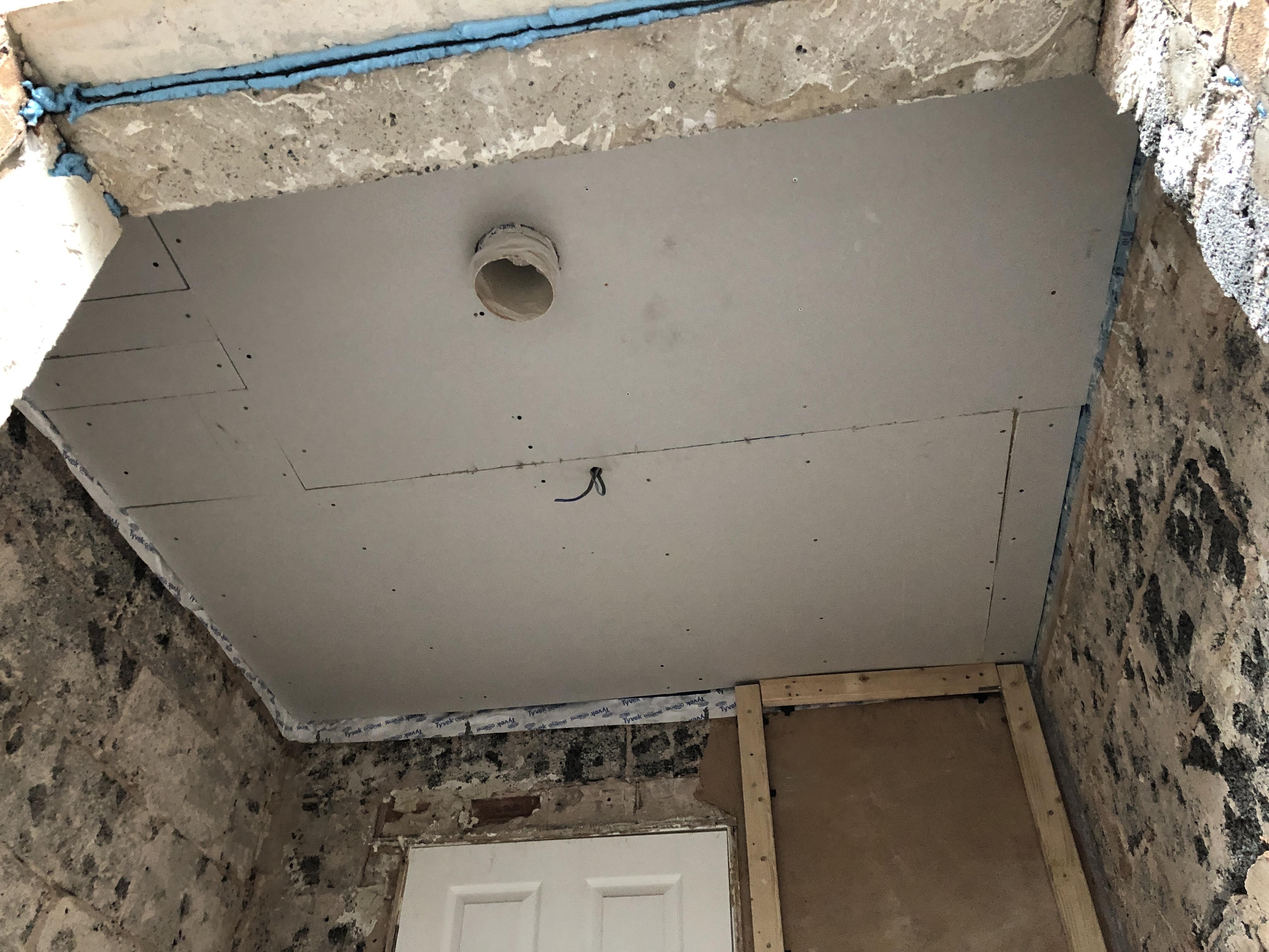

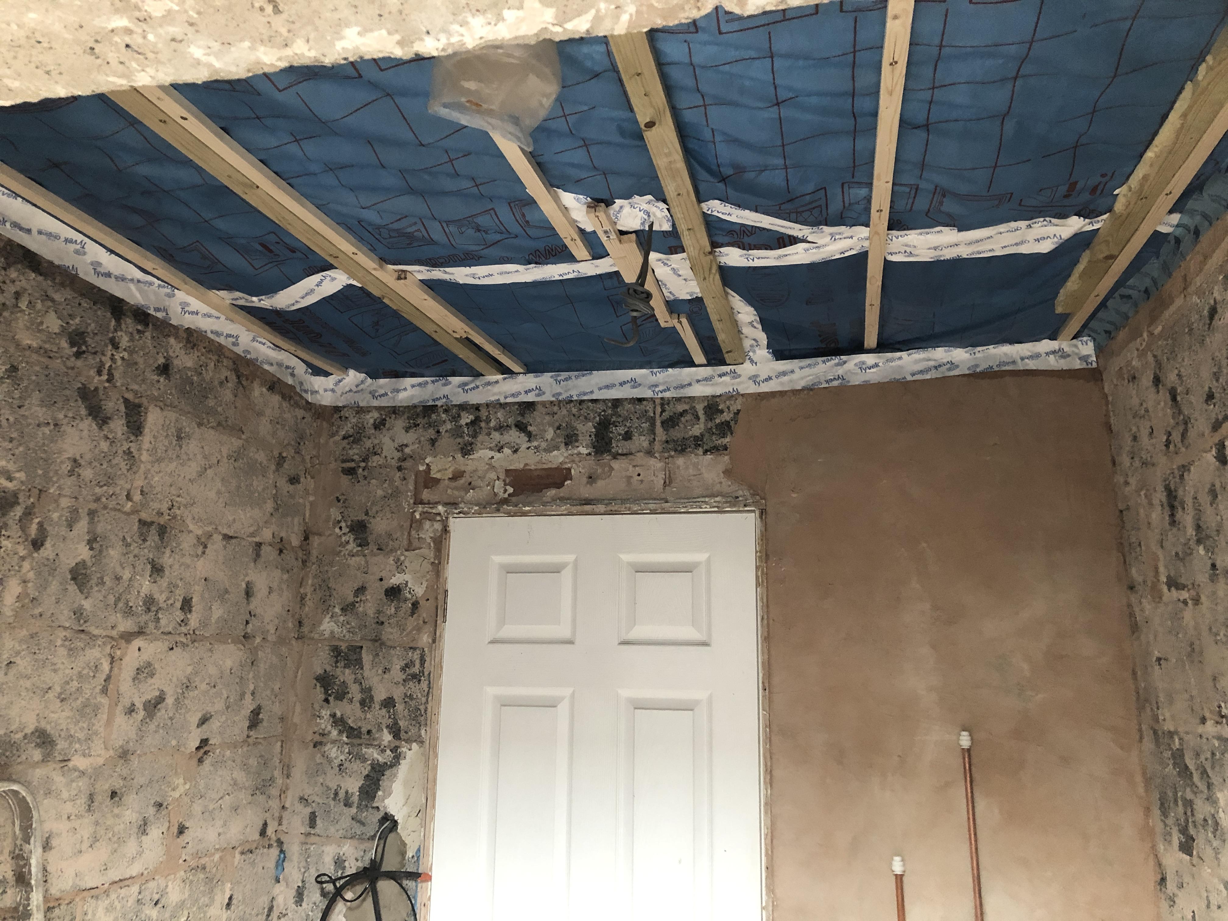

Next job is to patch up the loft insulation where the old spotlights were, new wiring in place for a single light fitting this time, airtight membrane adhered to the walls and then battens before reboarding it ready for plastering. Floor is coming up also to be replaced with 22mm chipboard to match new bit.

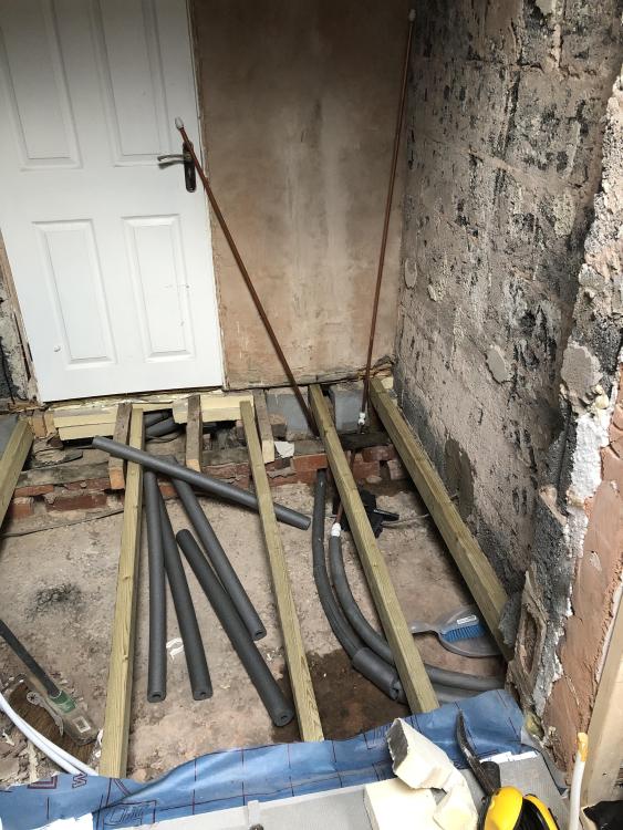

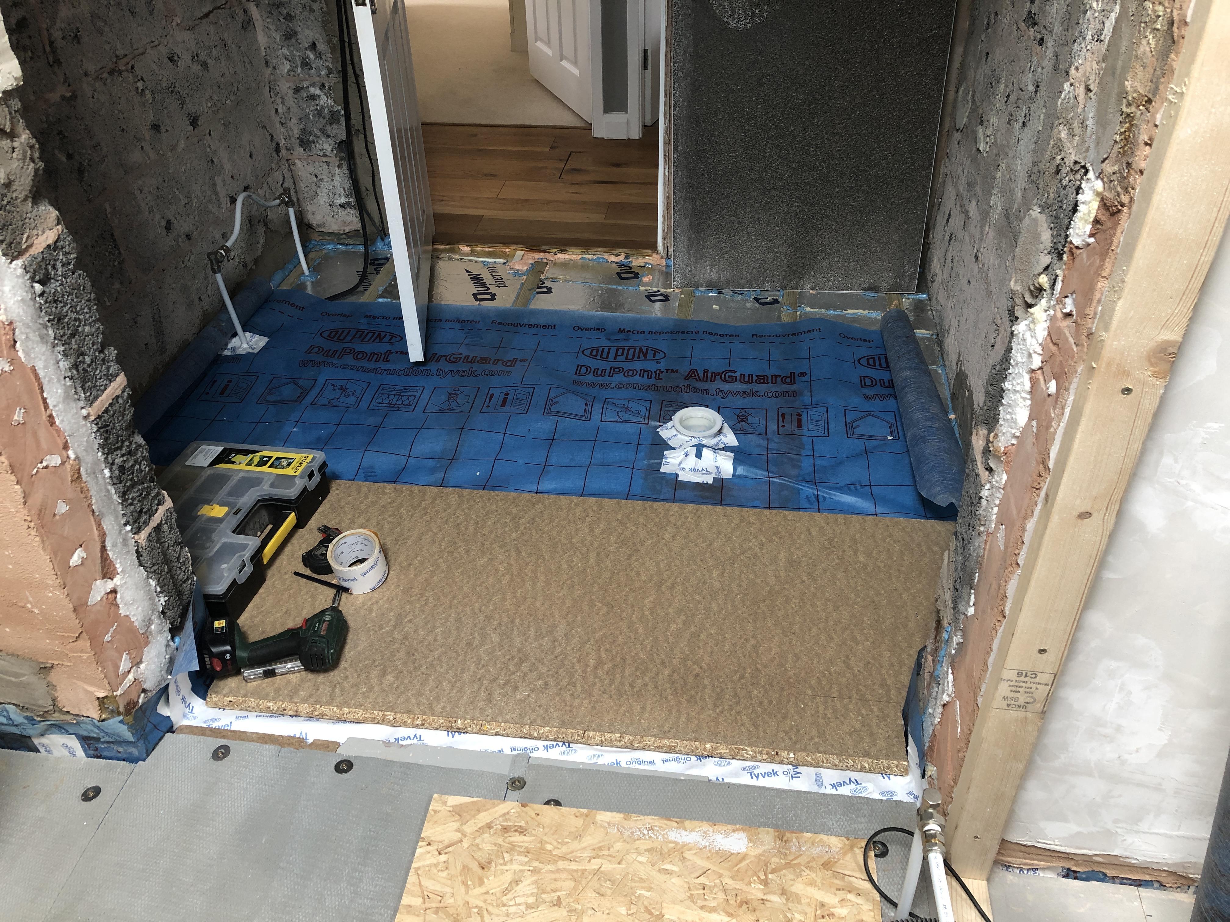

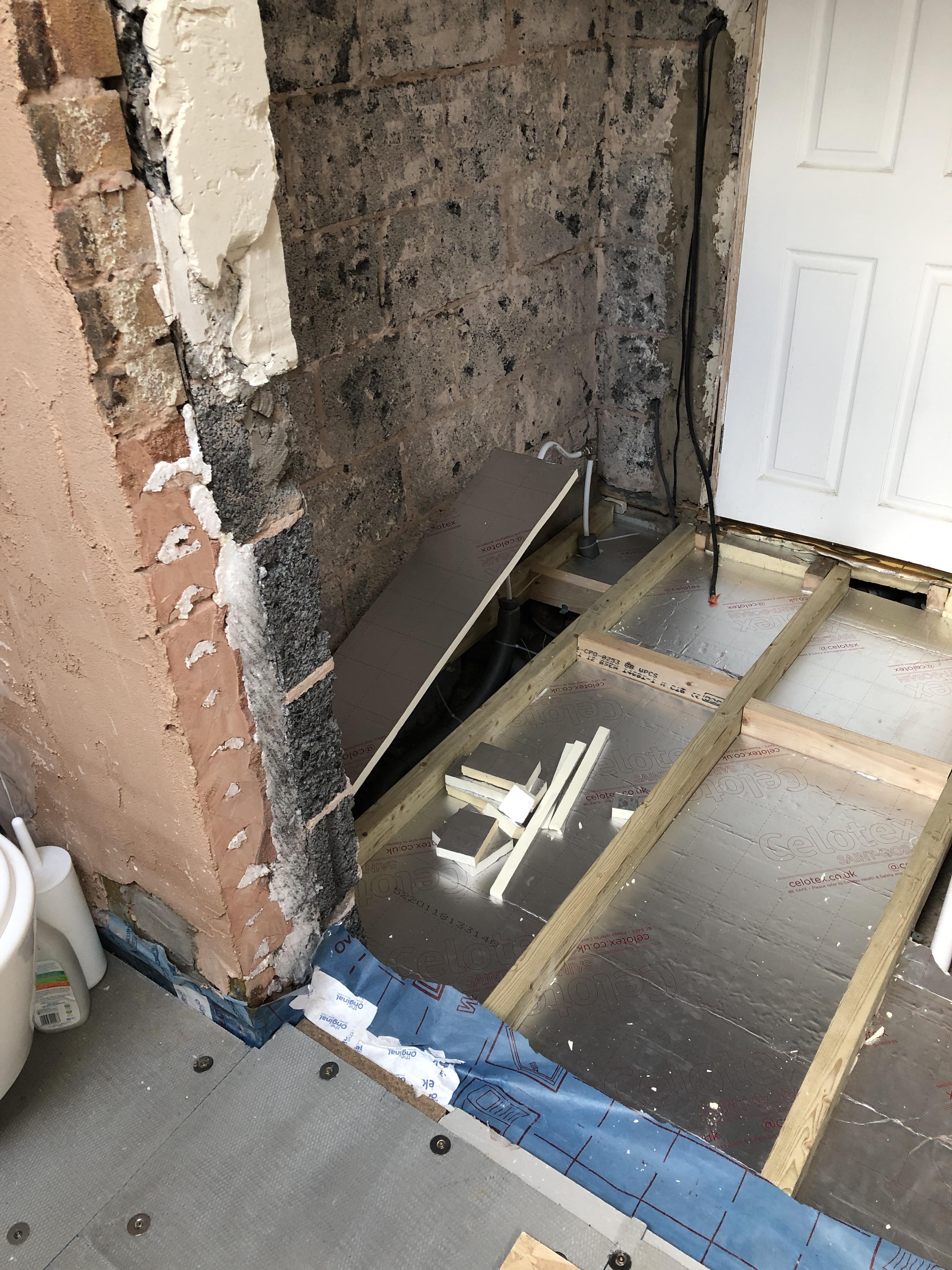

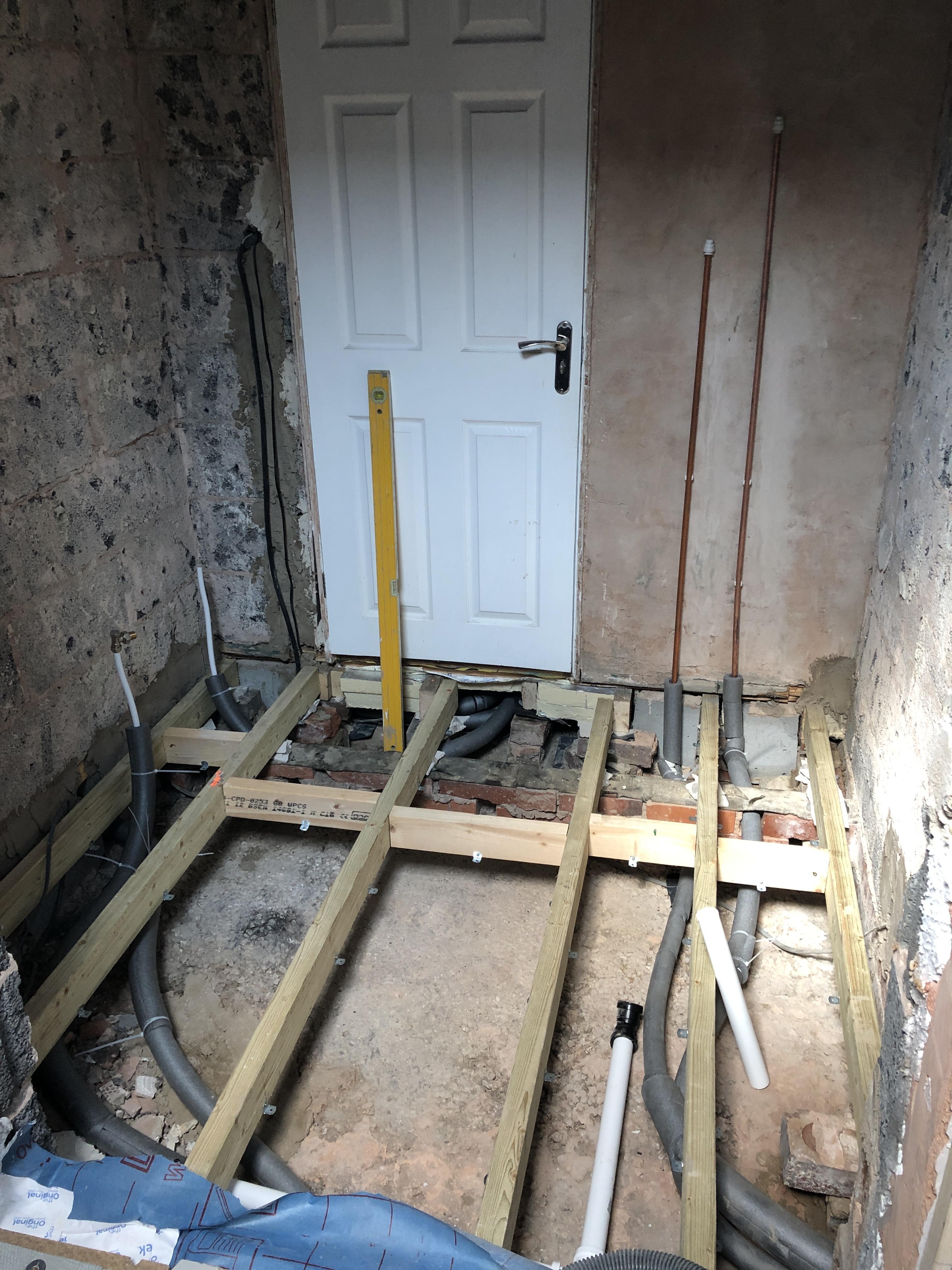

coinciding with what I always find the most difficult part of these jobs, getting the floor structure down, balancing definitely isn’t a strong point!

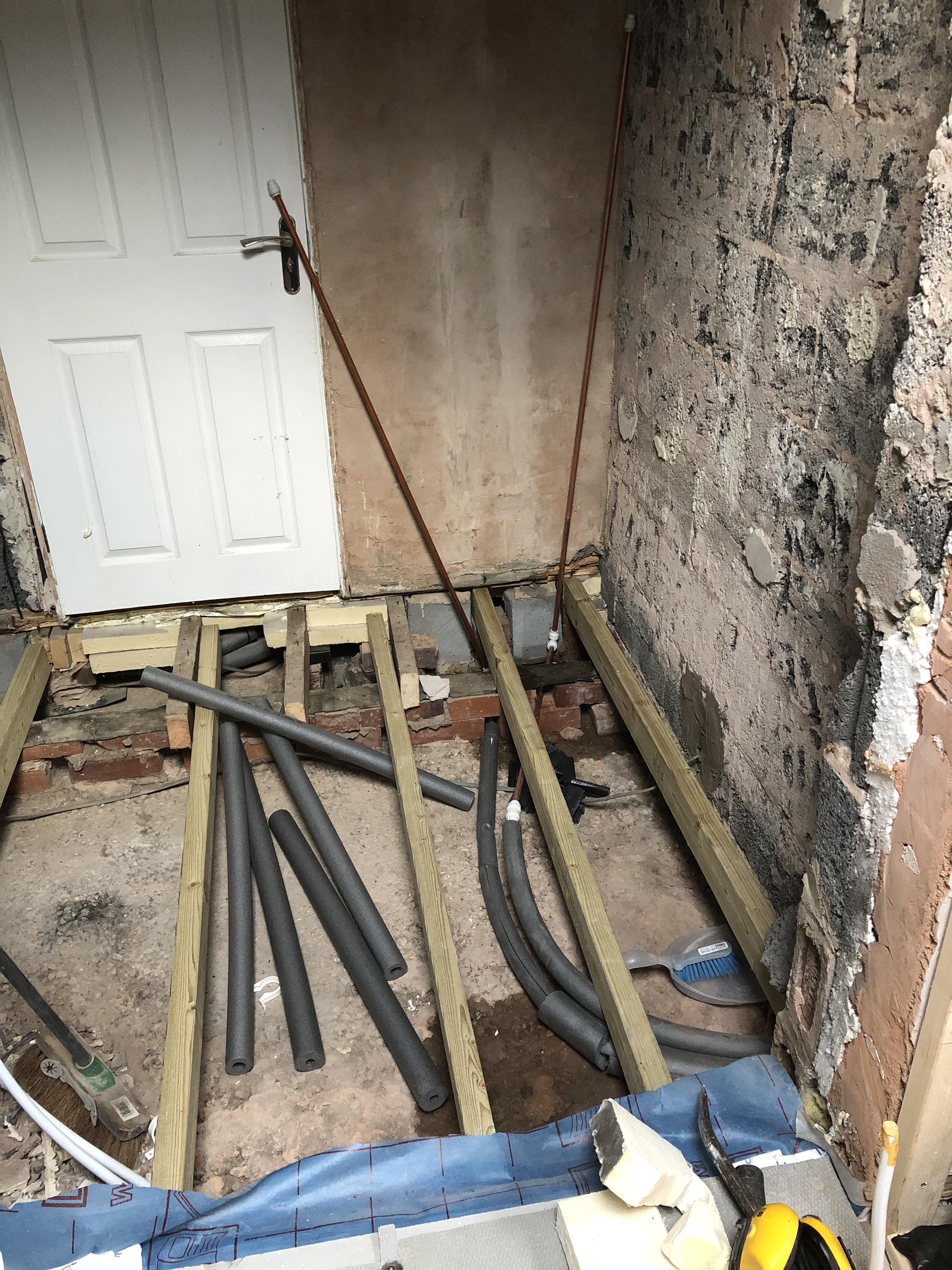

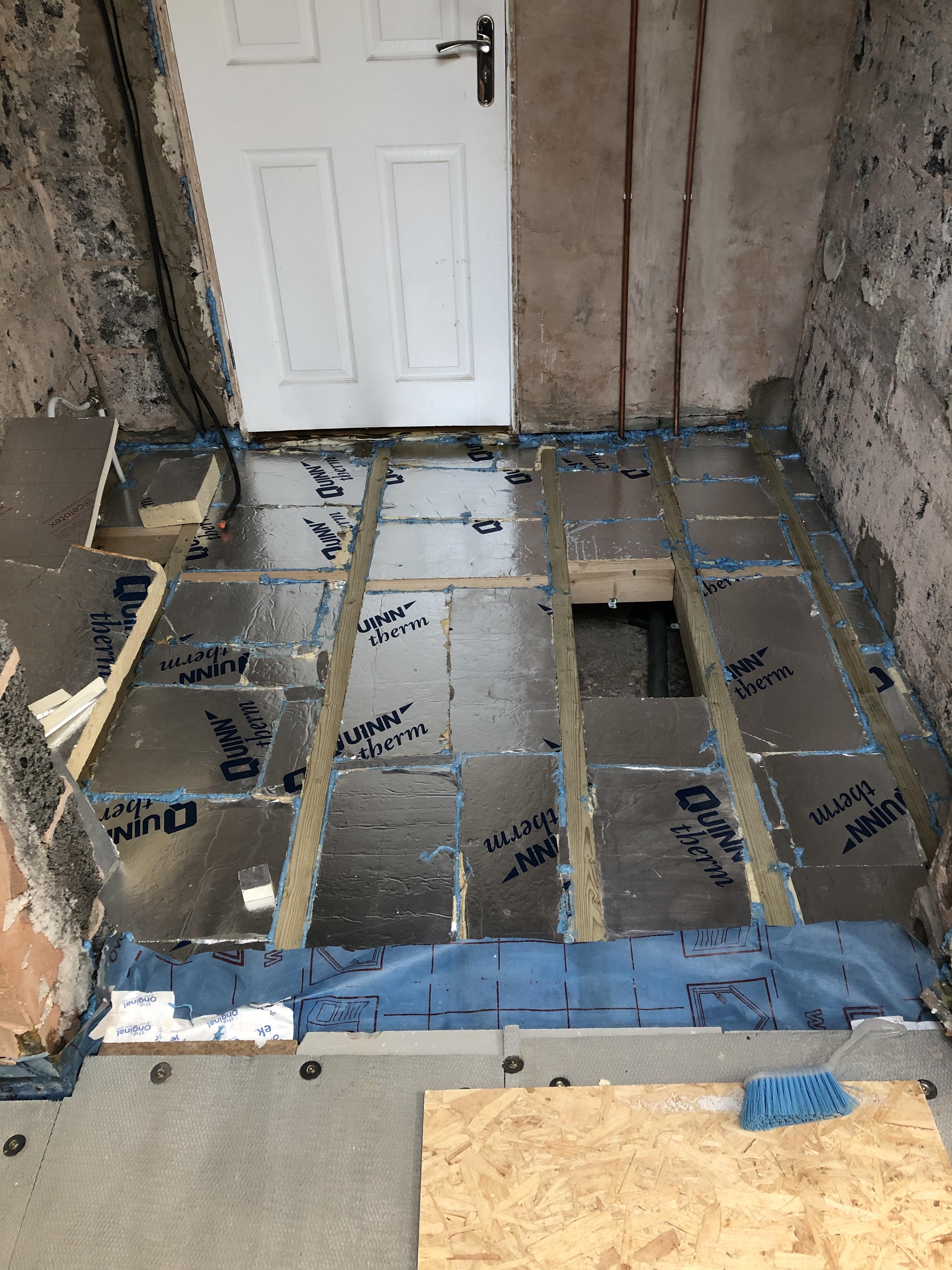

cut out the last of the woodwormed joists and decided to replace everything under there again even though quite a few were new from around 10 years ago, it was the first room I’d done and wasn’t prepared for what I found so the ones I took out were untreated, now replaced with treated.
topped up the floor insulation with another 20mm to go with the existing 70mm, new 22mm chipboard, and sorted both heating and supply pipes along with drainage for the shower.
be a few weeks now til I get some time to do the first batch of plastering, but I’m just happy it’s starting to look a bit more like a room rather than a building site.
Stumbled across a brilliant airtight primer this time too, Tescon's SPrimer, which is a sprayable primer. Saves killing a paintbrush, and is so easy to apply, but its a little smelly for a few days. I've still got a bit of the paint on primer, but don't think i would have had enough to complete the job, managed to get a can off ebay from someone who had finished their works and was selling excess off.
