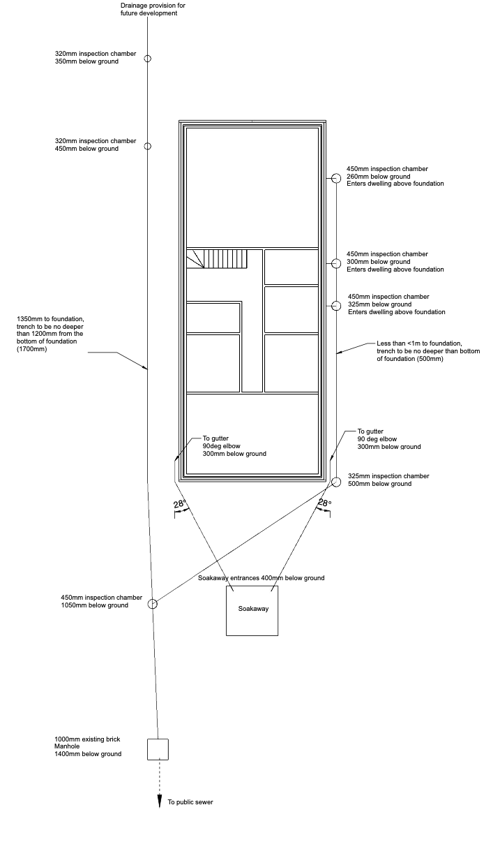

After obtaining planning, i got my building controll aplication under way. I had 2 options
- Pay £1100 for Building Notice
- Pay £900 for Full Plans.
Everyone on here recommends full plans, and it was a cheaper fee. I knew i'd have to either pay for the plans or do them myself. I opted to do them myself after loads of research on this forum (particiularily inspired by @HerbJ )
Here's my version of Herb's spec.
Building Regulation Specification Redacted.pdf

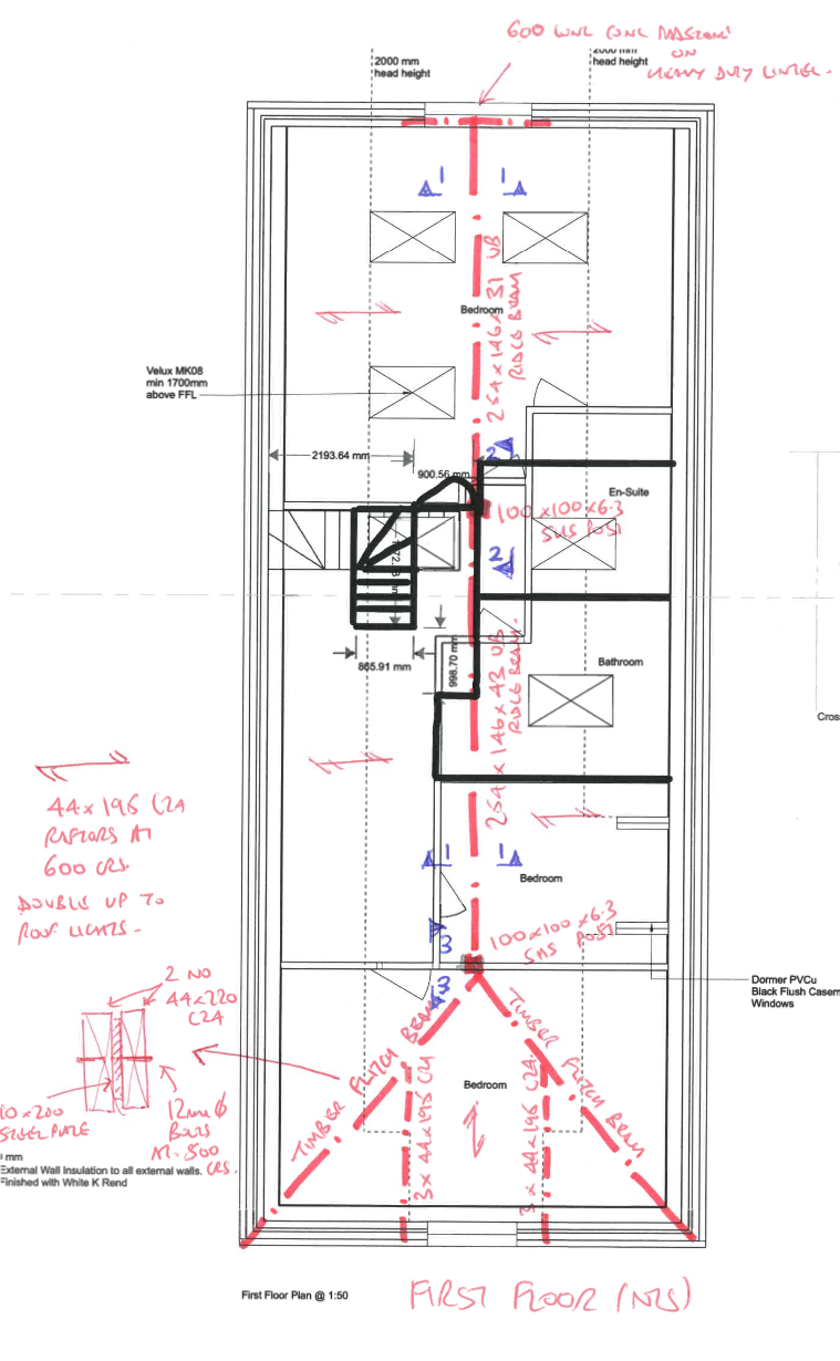

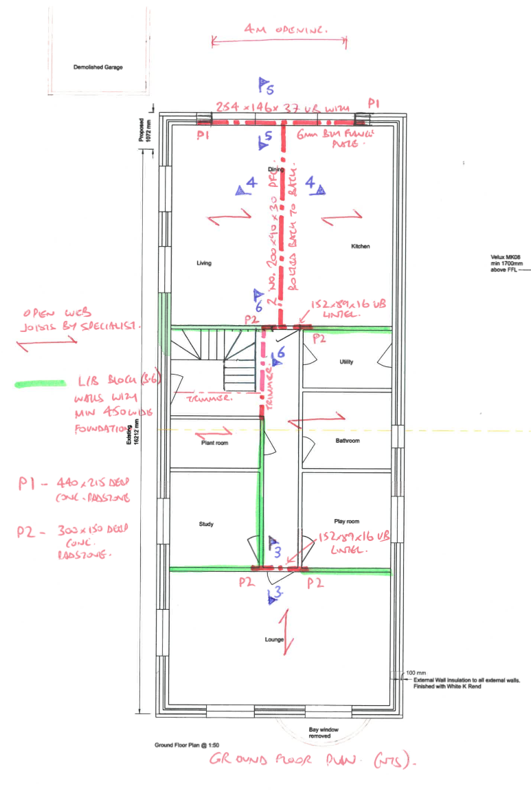

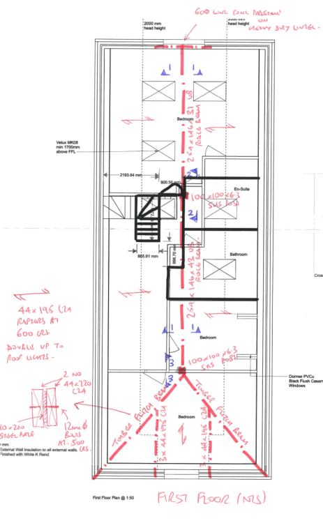

I paid a structural engineer to do the calcs.
Screenshot2024-01-04at21_49_48.thumb.png.8af17eed47dc659540db999270b79ba8.pngScreenshot2024-01-04at21_49_41.thumb.png.09f2e7356ab1440ec3bf8721ef12befc.png

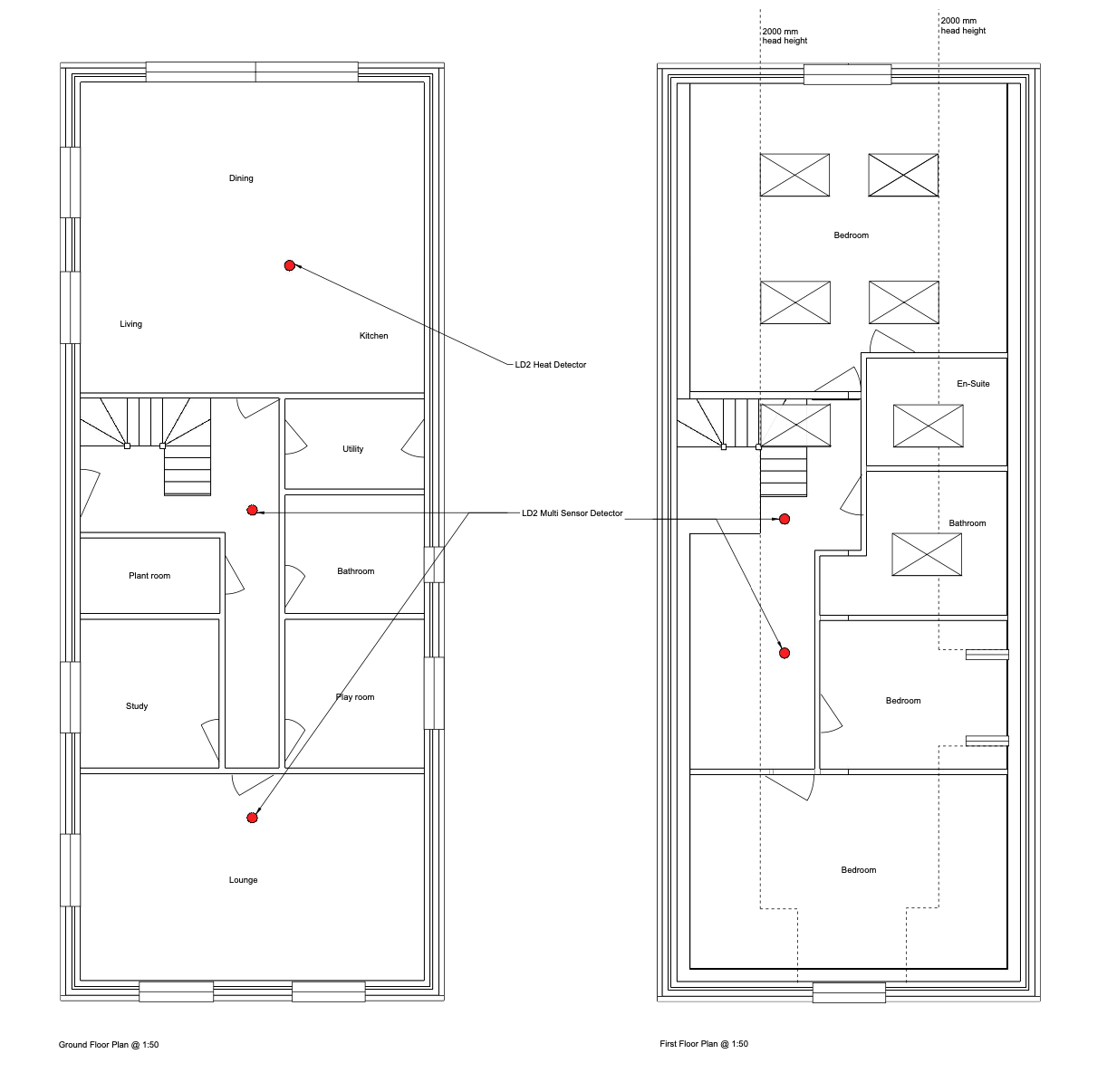

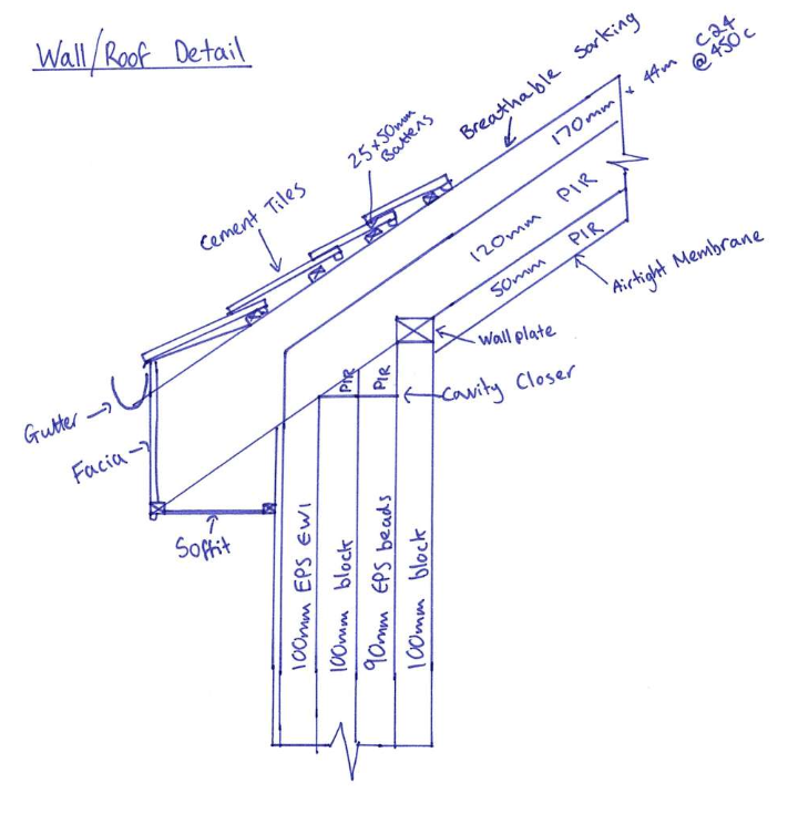

And then I did all the details, layouts and thermal calcs myself.
WRD_01.thumb.png.243d186e5442abd5b528a4f7e812a9ec.pngSHDL_01.thumb.png.23445a38a7ad21d981e521b5886defc0.pngPDL_01.thumb.png.01a25b42991679f08d0e5112d66920c7.pngNEWFSD_02.thumb.png.f2a953d013ccf80781ba60400f46c79f.pngIWFSD_02.thumb.png.1ab6c9679f360bbaa7246750612299b8.pngEEWFDS_02.thumb.png.2f2b2b59af29ff760b655acfc4b26fdf.pngDCRD_01.thumb.png.958dd3316491fcae399ca14a0c7b6b50.png

I paid for the application in August 2023 to allow me to get on with getting the footings in for the extension (and have them inspected). I then spent 3 months maybe, doing the plans in the evenings. I finally submitted them in October. They came back after about 6 weeks and asked for some ammendments (that are included above) and finally got approval 19th December 2023.
