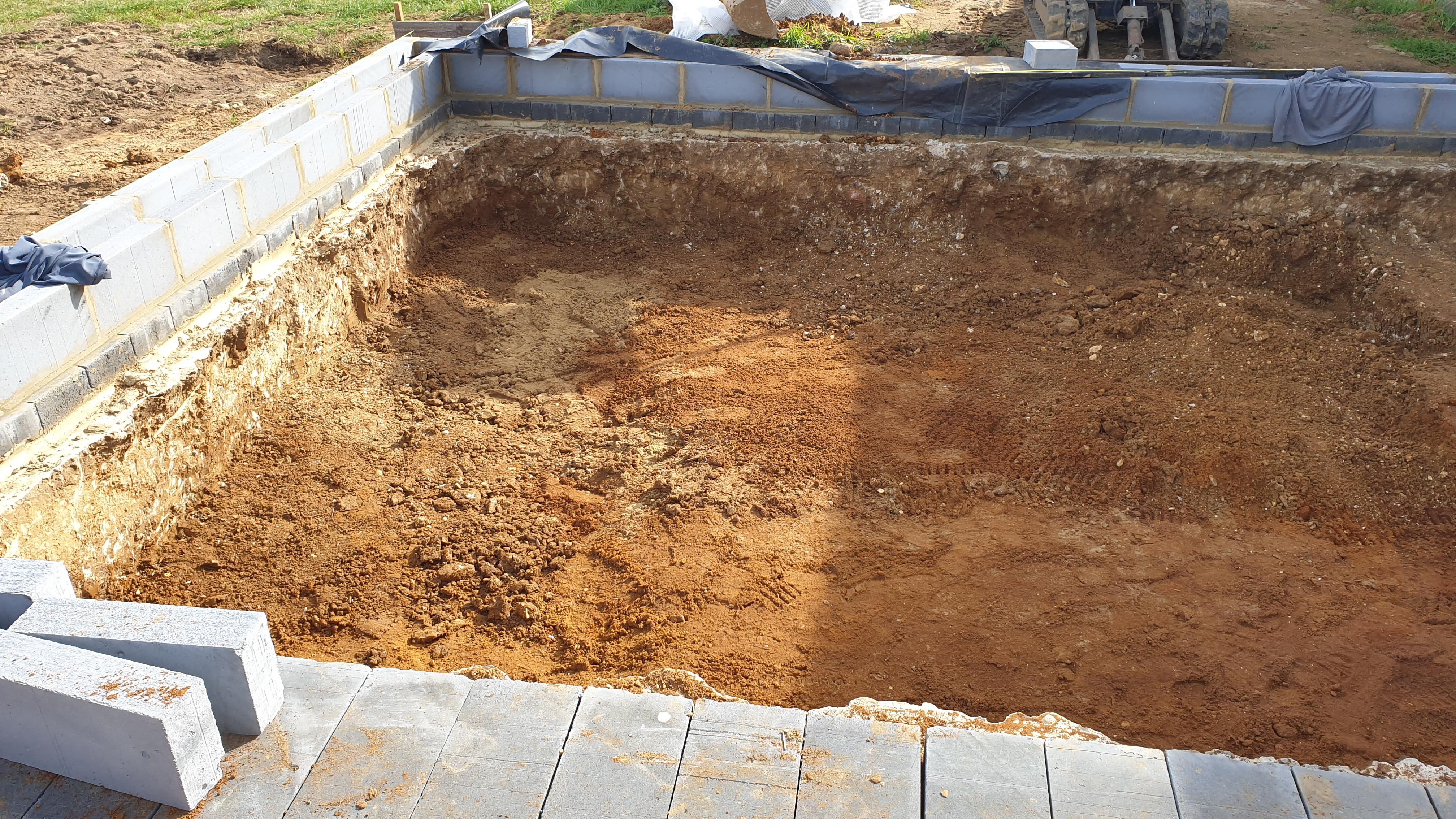

This period started well enough with the trenches for foundation filled ready to start building walls.

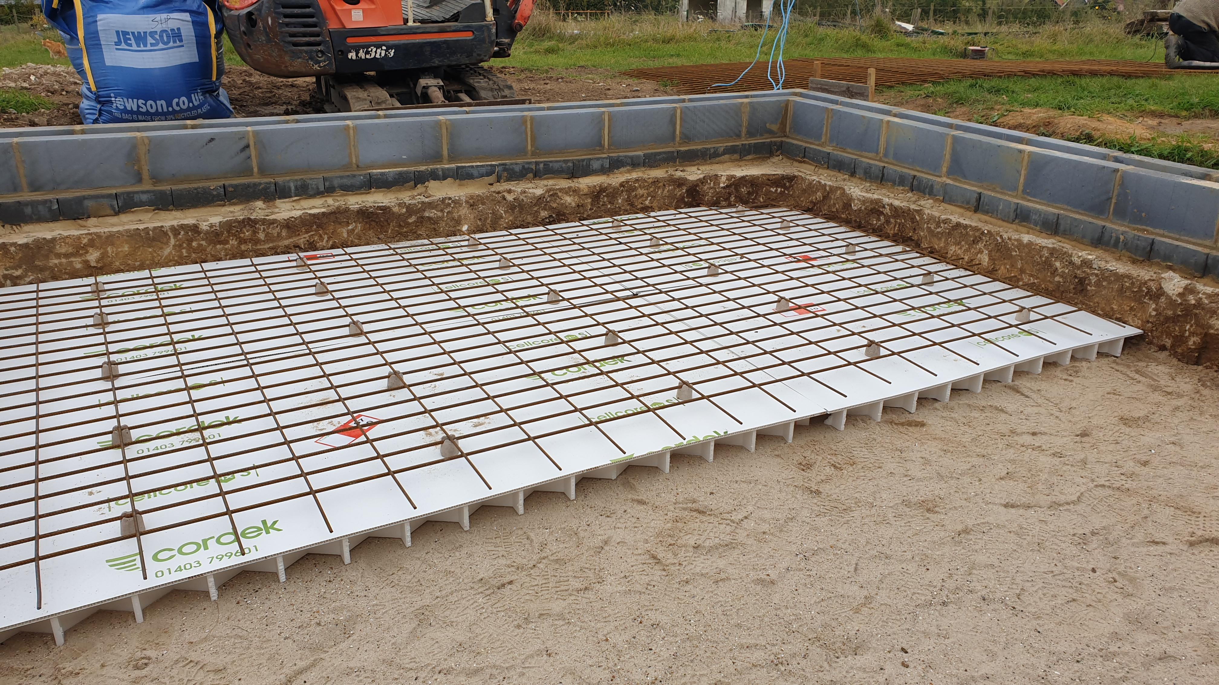

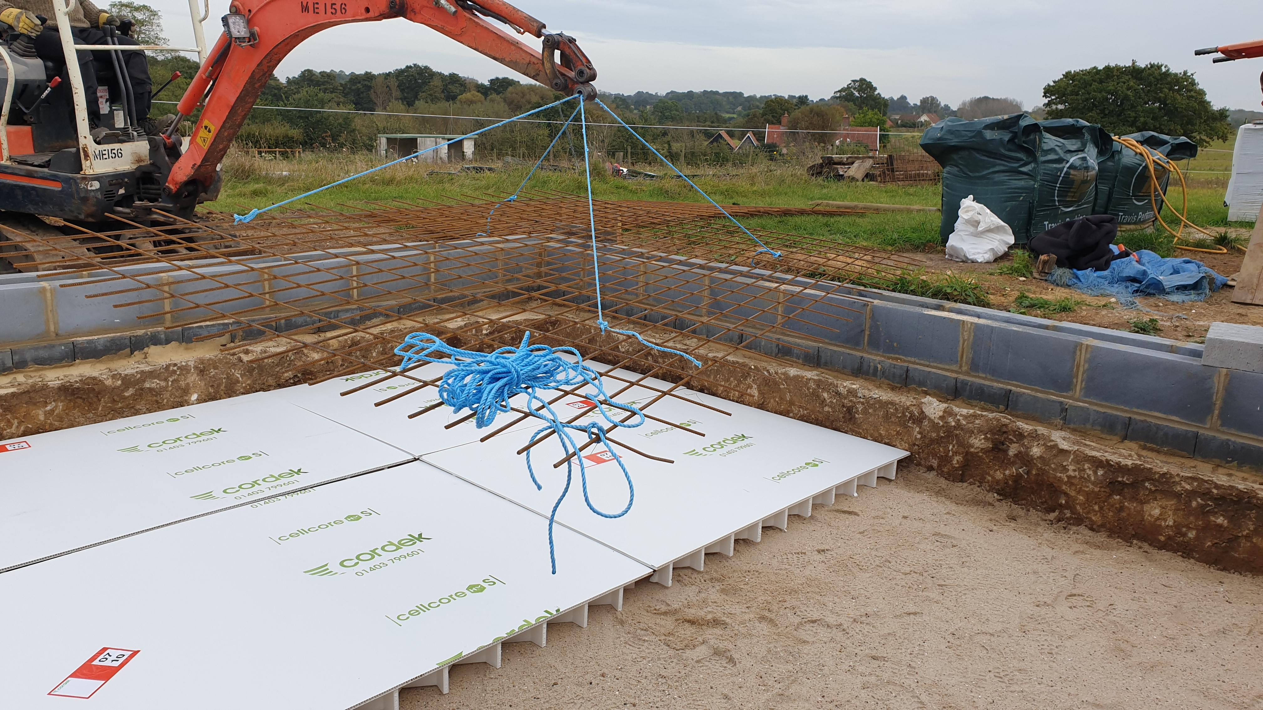

After digging down and down to the required depth (or so we thought) we started to place the cellcore ready for the mesh / concrete.
Most of this had to be done by hand as we somehow managed to build the walls before digging deep enough for the hardcore and blinding and couldn't reach lots of it with the digger.

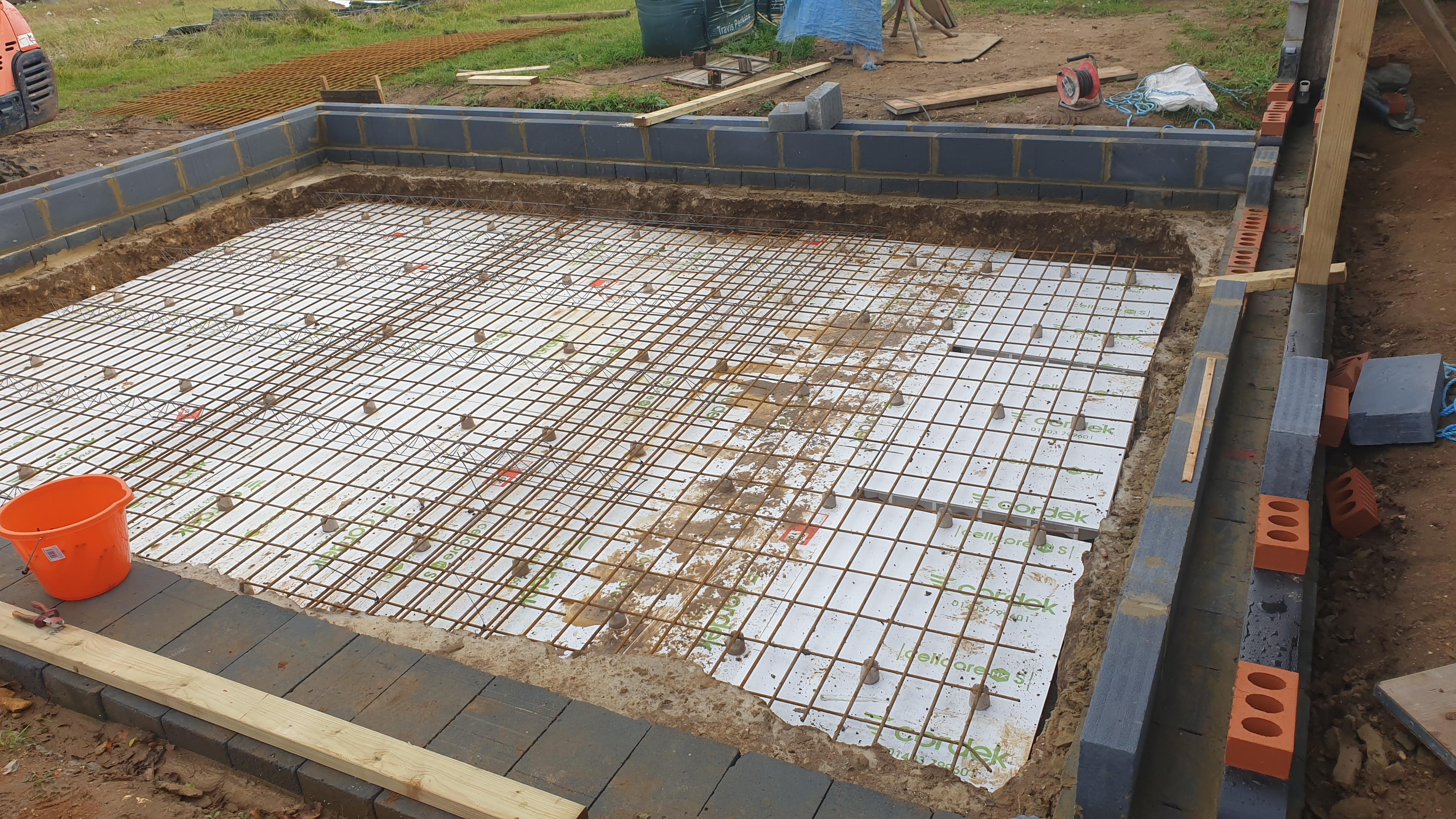

The cellcore and mesh were laid
image.thumb.jpeg.e960eb60b0a7d7ee490ab1fbf178d955.jpegimage.thumb.jpeg.c39b628e56ecbf97aaffa46505b9d304.jpeg

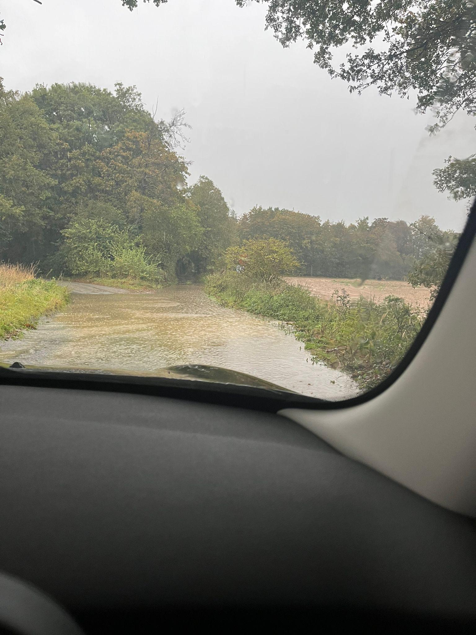

Then this hit - storm babett
our road and the site were totally flooded and the work from the previous day ruined

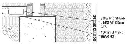

After waiting for it all to dry enough BC came out and said wrong, wrong, wrong.
We had mis-read our plans and somehow forgotten to suspend our suspended floor and to add even more woe we hadn't left enough bearing space on the foundations for the mesh to sit on.
Cue 4 weeks of SE, BC and the associated costs.  To be fair they were both really helpful at trying to sort out what was our mess with the least upheaval to us.
Then partially fill the hand dug hole, thankfully only one room not the whole house and having crushed 104 tons of concrete hardcore isn't in short supply.
In the end we had to knock down what we'd built and get agreement from SE & BC that we could use Shear Links between the mesh sheets and have any overhang of 150 instead of 200.
I hadn't even heard of Shear Links so sourcing them was fun as neither had any of the main BM's.
there are also many different shapes, we needed shape 33, like a paperclip
So, amended drawings, shear links, time and everything else leads, once again, to more cost and more time.

We are still not back to where we were, the blinding needs whacking again so the cellcore can be put down again, the mesh needs placing again with the shear links, the walls need rebuilding to DPM and BC needs to inspect.
Then we will be back to where we were 2 months ago.

Mistakes like this are easily done.
From the drawing it looks like the top of the cellcore needs to be level with the top of the foundations, so there may be a fair bit of infill to make up.

Well done for sharing.
More in a couple of months.
I suggest you don't leave it that long.
Preparing a suspended slab that isn't supported on the structure is a bit of a biggy, and there must be either a lack of clear information or a major misunderstanding.
How will the shear links be fixed? Steel fixing isn't easy to do properly, and general builders tend to be a bit casual about it.

First time DIY self building and my fault to be honest.  Hubby knows how to build, but not really how to read plans, he's used to be told, do this, do that and then do the other.
Plans are down to me and I've been so busy at work that I didn't stop long enough to even think.  Not again, I've spent this time going over everything again to check, double check and then do it again.
This wall was also supposed to be under-pinned, but when we took out the floor as per the plans the walls turned out to not be attached to the existing foundation and after one fell down it became clear that this bit of the build needed to be done from scratch.
This also necessitated involving the LPA as the existing plans were for single skin and EWI not a cavity wall, which is why there wasn't enough bearing space.
The other option given us by SE was to put in secondary foundation inside what we had poured, but then that had to be attached with horizontal rebar and vertical mesh as well as the existing mesh.  So, knocking down the cavity wall up to damp proof was a much easier option.
The shear links are attached with metal ties, bit like cable ties, but metal in the middle of each mesh, so that side is 100mm so shear links are also 100mm.

Have you steel bar spacers  for supporting the top layer of mesh off the bottom one, and tying them together?
All the work has to be top class. You get away with a lot if it is ground bearing, but this is a proper structural slab and will need care.
eg when the concrete goes in it must be consolidated (I'd say hire a vibrating poker).  and no added water.
keep the pictures coming. Can we see the whole of your slab design drawings?

I don't have the updated whole slab drawings, our SE just sent us through what I've posted, a bit bigger, but no more details.
The rest was left as the original without the shear links.
You are right about the spacers, we do have those, just didn't mention.
Thanks re the vibration, we will do that and not add any water.
