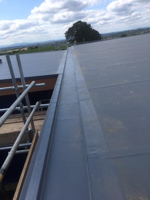

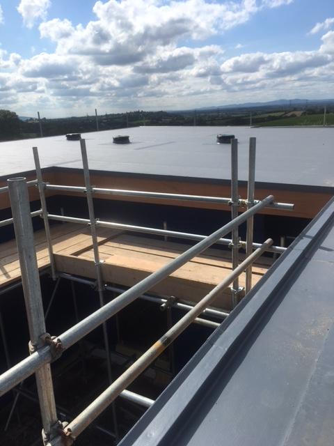

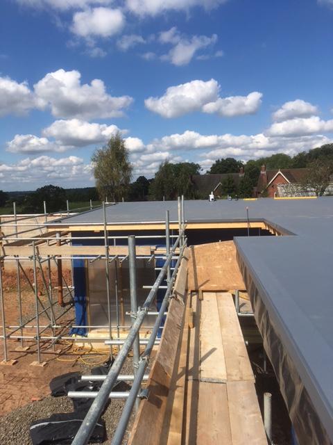

Its been on about 18 months and (keeping everything crossed!) no problems so far.  We went for hidden gutters and they are made with the membrane, there are big drains into the 2 downpipes we have, that amount of roof has a lot of water flow to drain. some pics of work in progress.
