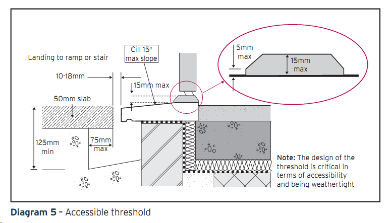

EverHopefull Posted March 2, 2019 Author Share Posted March 2, 2019 That's fine but the wide track for sliding units in my present house cause a step of 10cm high and 35cm wide between inside and outside. More step onto the track than over. New house has to be flush tracking. Link to comment Share on other sites More sharing options...

Jeremy Harris Posted March 2, 2019 Share Posted March 2, 2019 (edited) 6 minutes ago, EverHopefull said: That's fine but the wide track for sliding units in my present house cause a step of 10cm high and 35cm wide between inside and outside. More step onto the track than over. New house has to be flush tracking. I'm at a bit of a loss to understand how any supplier can sell a non-Part M compliant threshold, so the 100mm bit seems really puzzling. Part M is pretty clear, so threshold steps inside and outside cannot be higher than 15mm IIRC. Edited to add: Just found the details referred to in Part M for accesible thresholds. Any new door should comply with this: Edited March 2, 2019 by JSHarris Added more info Link to comment Share on other sites More sharing options...
