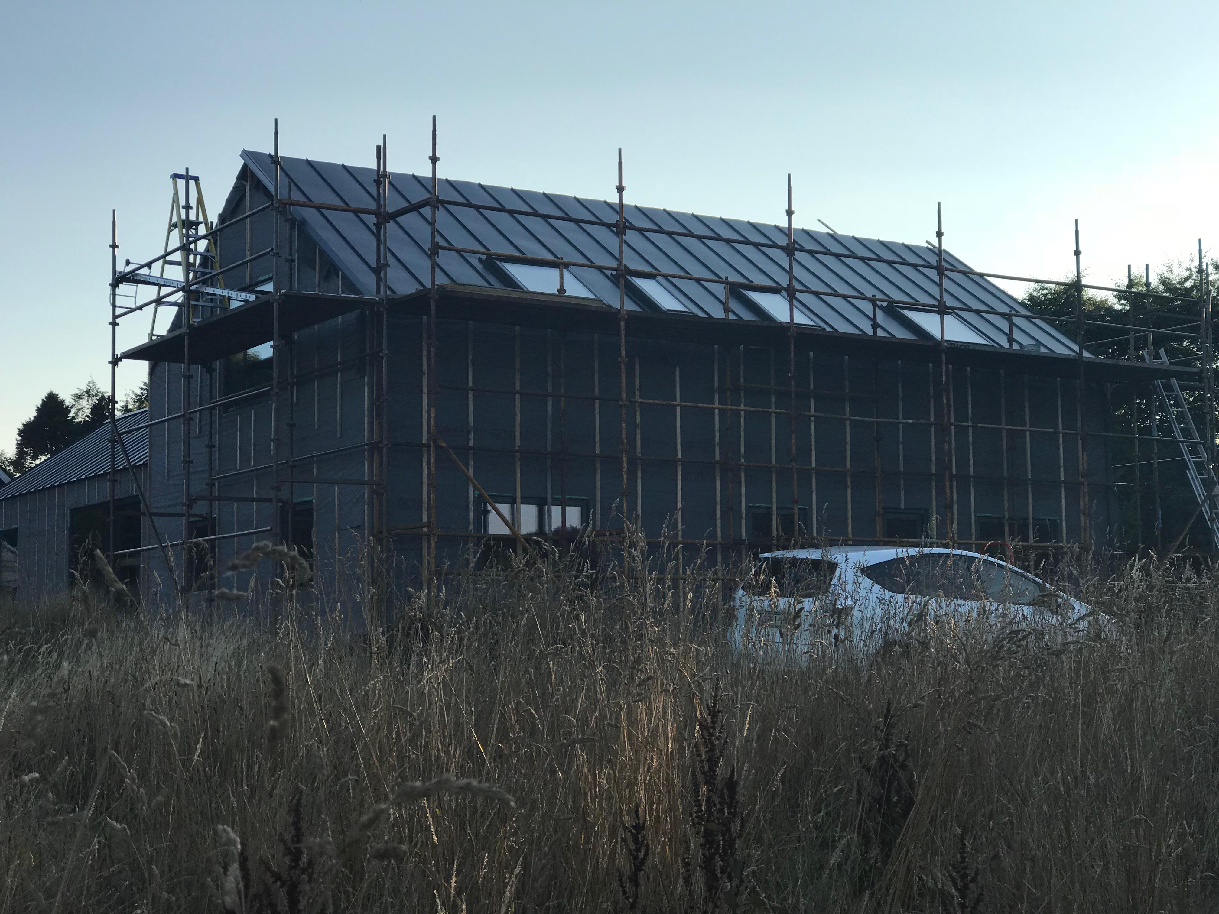

I need to cut a hole through the Tata Urban seam roof which I have been a bit reluctant to do.
Can anyone recommend  collars / flashings which would work best with the roof,
Thank you.

Thanks for your replies. I did look at this thread you had contributed to.
Yes I do want to avoid cutting holes in the roof. Gable end vent could work though its very close to Velux windows.
Or could put AAV at the top of stack in roof space above the 1st floor bathroom and venting at the end of the foul drain run near the Vortex treatment plant.
