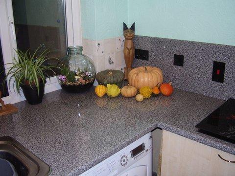

I had a go at grafting about 400mm extra onto a 600mm worktop:
You can't tbh see the join in this picture. (The line between the plant and big glass jar is just a reflection from something)
I ran the router down the two edges to be mated then routed out for clamps and joined with D4 wood glue. To start it was perfect but me being me left it for a while before siliconing over the joint and rubbing it in. Water got in behind the sink and swelled the join a bit. :(
Now covered over with Duck Transparent Repair Tape the whole length of the joint. Near invisible tbh.....except for the swollen bit.
