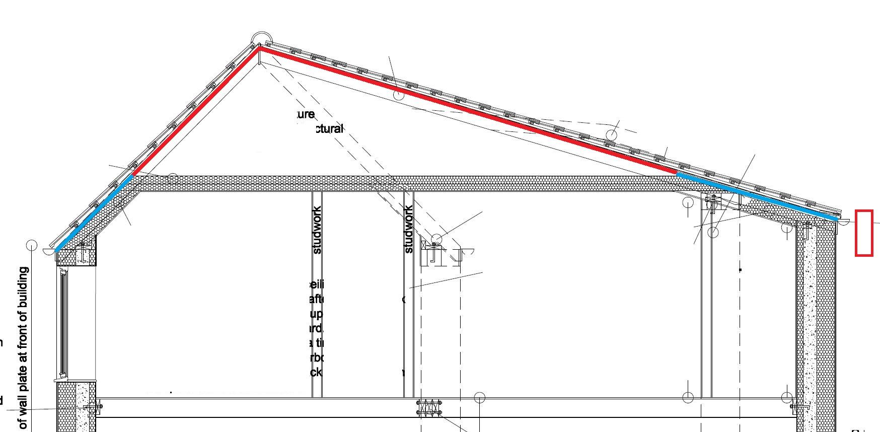

willbish Posted December 16, 2018 Author Share Posted December 16, 2018 Thanks @Ed Davies, Looks like green slime heading my way! ? I hadn't acknowledged the differing units of vapour permanence /permeability/ resistance/ resistivity, I'm not pretending I understand these differences yet. For me the Ubakus model is difficult to use because I want to experiment with different roofing membranes; my ecologist has specified a traditional bitumen felt membrane for the bat roost however this conflicts with using full fill insulation in the rafters. My current thinking/aspiration is to use a vapour permeable membrane for the eaves sections along with full fill insulation, then where the loft space starts transition to bitumen to keep the batman happy. There will be no insulation in the loft space rafters. If anyone has any other bright ideas /suggestions that would be great. Link to comment Share on other sites More sharing options...

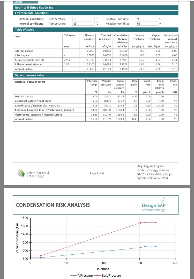

willbish Posted January 22, 2019 Author Share Posted January 22, 2019 As part of a quote for spray foam insulation I got some condensation analysis done. Should I take issue with the following from attached analysis -Outside temp 5*, wouldn't 0 or -5 be better to show larger gradient -Similarly inside temp 15*, as above, also plainly not accurate -Missing layer, I will be using an 18mm chipboard on between layers 2 & 3 -Condensation rate of 0.2g/m2h & Condensation rate 60days 284.2g/m2h. That seems significant but is it? Link to comment Share on other sites More sharing options...
A_L Posted January 22, 2019 Share Posted January 22, 2019 @willbish , 15/5°C is the CIBSE defaults for this calculation. I am not entirely sure why they have a positive condensation rate at the interface in layer 2. The vapour pressure is lower than the saturation vapour pressure and the structural temperature higher than the dew-point temperature. Certainly my own CRA software (operating to the same BS5250 standard) does not indicate a problem, even with chipboard added and a 20/-5°C temperature scenario. 1 Link to comment Share on other sites More sharing options...
willbish Posted January 22, 2019 Author Share Posted January 22, 2019 That's reassuring and much appreciated, thank you @A_L Link to comment Share on other sites More sharing options...
