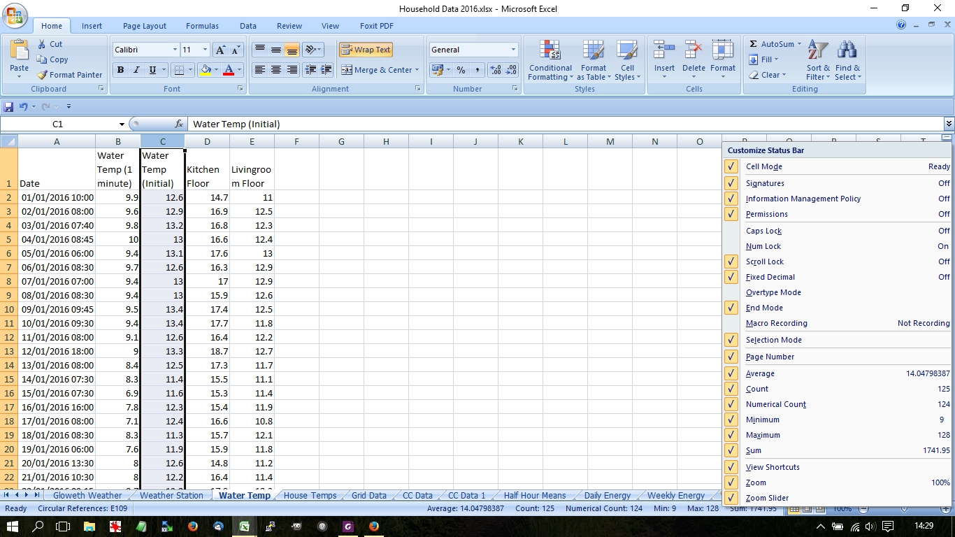

In Excel you can highlight and get some quick answers down in the bottom right hand side.  You can customise the results by right clicking.
The real way to do it is to use double entry book keeping methods, but this is tedious to set up and involves more work.
Main thing I do is to keep it simple.  So I try and always use absolute referencing when I can (names ranges and the use of F4) and often use two different methods to get the same result i.e. Average and then Sum and divide.
I still make many mistakes and can spend days looking for them.  One of the classics is mixing up text and numerical values in a range.  Of a simple decimal point out of place

If you look at my results you will see that the Max is showing 128, which it complete nonsense as water boils at 100.  So I know I have a mistake.
