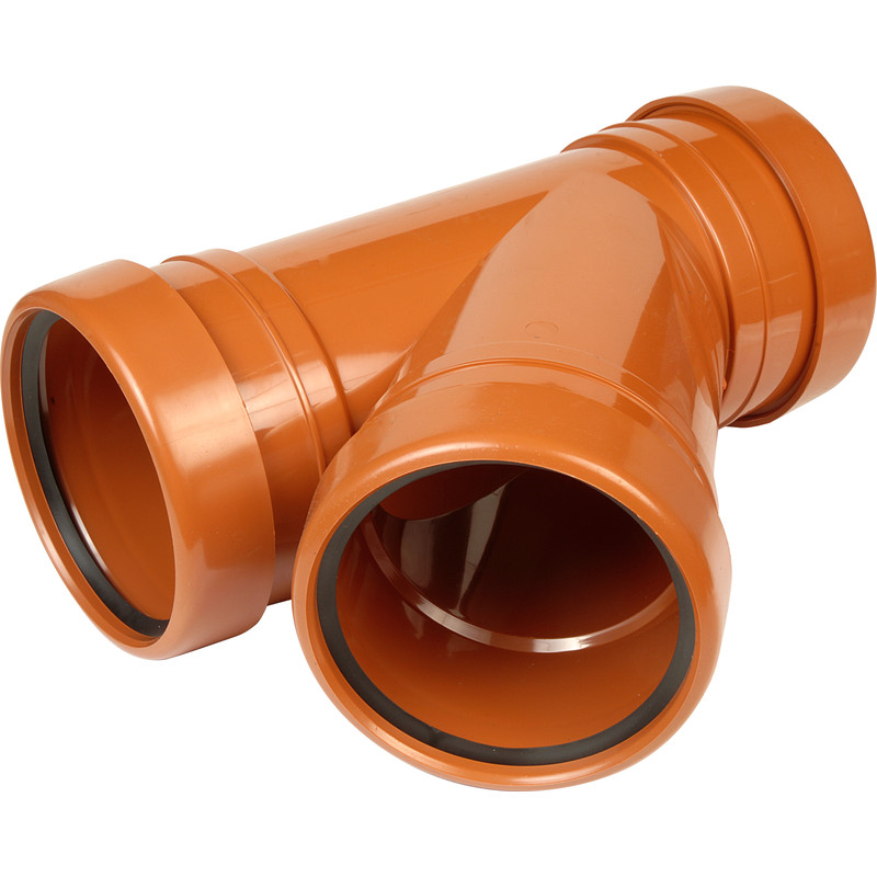

Nickfromwales Posted November 24, 2018 Share Posted November 24, 2018 Hi dave. Deffo run a 110mm soil pipe to the foul network outside ( NOT the rainwater ) and reduce to 50mm after the 110mm rises above the slab. As it’s a kitchen sink not a bath / other I’d avoid running anything smaller bore tbh. You could go for 50mm but then you have to have the reduction done underground outside which isn’t great. When the 110mm rest bend turns to vertical your pipe will be pointing up out of the slab. Get a 110mm x 50mm reducer and take that immediately into a 50mm Y branch ( T ). Into the 45/d off spur of the branch you put the sink etc and the vertical 50mm outlet of the branch goes to a rodding eye for access. I’ll do a pic in a mo. 1 Link to comment Share on other sites More sharing options...

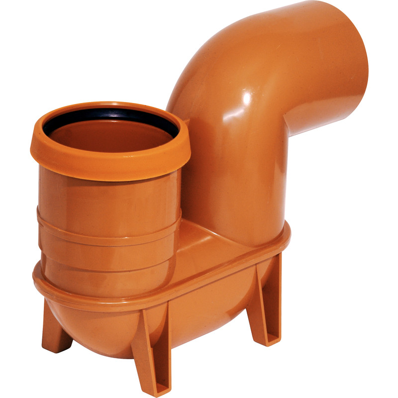

PeterW Posted November 27, 2018 Share Posted November 27, 2018 You can’t drop from a 50 straight into a 110 underground. Needs something like a bottle trap with a back inlet and a Y branch into the main drain otherwise you will her smell issues if it all dries out. Link to comment Share on other sites More sharing options...
DaveH Posted November 27, 2018 Author Share Posted November 27, 2018 Thanks Peter. Obviously there will be a bottle or P trap under the sink but you mean underground too? If I put a Y branch into the foul drain, then a P trap, and finally a reducer will that be OK to drop the 50mm pipe into underground? Link to comment Share on other sites More sharing options...
PeterW Posted November 27, 2018 Share Posted November 27, 2018 Prefer using stuff like back inlet gullies Back Inlet gully Allows you to rod if needed and also empty buckets etc Link to comment Share on other sites More sharing options...

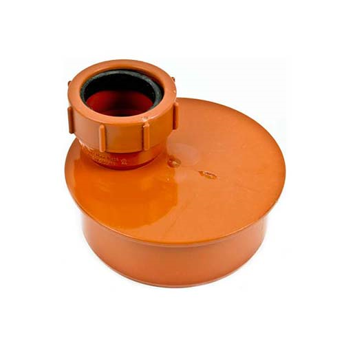

DaveH Posted November 27, 2018 Author Share Posted November 27, 2018 2 minutes ago, PeterW said: Prefer using stuff like back inlet gullies Back Inlet gully Allows you to rod if needed and also empty buckets etc OK. So the 50mm to 110mm reducer would go onto the back of the gully and then it would connect into the Y branch and feed into the drain? Ability for rodding is always a plus! Link to comment Share on other sites More sharing options...
PeterW Posted November 27, 2018 Share Posted November 27, 2018 Yep spot on.. Link to comment Share on other sites More sharing options...

Nickfromwales Posted November 28, 2018 Share Posted November 28, 2018 16 hours ago, PeterW said: You can’t drop from a 50 straight into a 110 underground. Needs something like a bottle trap with a back inlet and a Y branch into the main drain otherwise you will her smell issues if it all dries out. Disagree, sorry. There is a trap on every bathroom connected to a FW 110mm, which solely rely on the water in the trap for staving off back-stench from the sewer. You simply have a rest bend coming up from the slab, reduce to 50mm, and then connect to an appropriate trap. You won't get smells from the sewer unless you stop using the sink. 2 hours ago, DaveH said: Should I just fit an air admittance valve into the pipework inside the island unit or am I better running a separate vent pipe back under the insulation too? I'm guessing an air admittance valve will be fine but I don't want to find out after I've laid the UFH and screed that something else needs to be in there! As a) the invert from ground floor sink to horizontal FW 110mm pipe is less than 1300mm and b) you'll only ever be discharging a sink full of water through a waste outlet ( low litres per min flow / velocity ), you'll never get a vacuum deficit and therefore do not need an AAV. The image above is USA I think? Way OTT Link to comment Share on other sites More sharing options...
Nickfromwales Posted November 28, 2018 Share Posted November 28, 2018 If you fit one of these youd better get Dynorod on speed dial ! This will block with food waste in about 2 weeks. Thats for clear running / rainwater only. Link to comment Share on other sites More sharing options...
