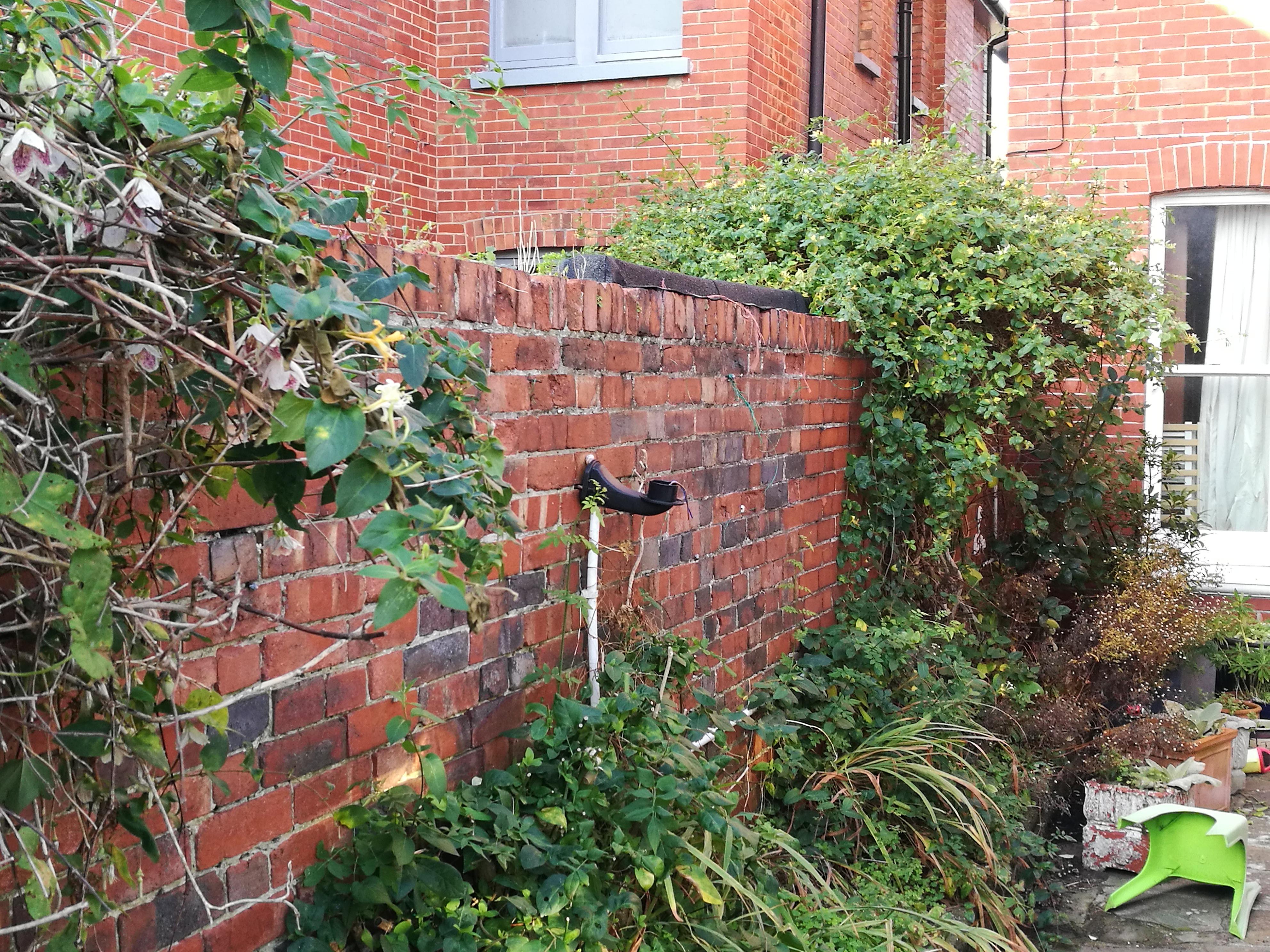

Triggaaar Posted November 17, 2018 Author Share Posted November 17, 2018 3 hours ago, Ferdinand said: That proposal to build overhand concerns me. AFAIK it reduces the visual quality of the work substantially, especially if you have to make like Mr Tickle to build it. Can you maintain it, and will you neighbour have to look at it? For me, negotiating access would be a better option for appearance and relationships We're talking about where the wall butts up against the boundary wall, so no one would be able to see it. Once the wall went above the boundary wall, the brickie would go to the neighbours side to build. Although the opinion here seems to be that we're better using brick and block anyway. Link to comment Share on other sites More sharing options...
PeterW Posted November 17, 2018 Share Posted November 17, 2018 1 minute ago, Triggaaar said: We're talking about where the wall butts up against the boundary wall, so no one would be able to see it. Once the wall went above the boundary wall, the brickie would go to the neighbours side to build. Although the opinion here seems to be that we're better using brick and block anyway. So how are you planning on doing the founds for this as if you are right up the boundary wall (yours I assume ..?) then the founds for the new wall will have to go beneath this. Would be better off dropping the wall and using the new house extension wall as the boundary by the sounds of it. 1 Link to comment Share on other sites More sharing options...
Triggaaar Posted November 17, 2018 Author Share Posted November 17, 2018 2 minutes ago, PeterW said: So how are you planning on doing the founds for this as if you are right up the boundary wall (yours I assume ..?) then the founds for the new wall will have to go beneath this. Would be better off dropping the wall and using the new house extension wall as the boundary by the sounds of it. I expect the boundary wall is shared. Our house is the boundary as far back as our house goes, and then the 9" ish wide boundary wall starts, and that wall is half on each side. I haven't asked the neighbours about knocking it down. It's a nice old wall, I don't suppose they'd want it gone, and for half the run of my extension the boundary wall is the back wall of their potting shed, so they won't want me knocking that bit down. Without the potting shed issue, it would make some sense, as the boundary could be a simple continuation of our house. Assuming we leave the wall, the plan is to dig 1m lengths of foundation (hopefully not too deep), put some steel continuation bars in, and fill them one at a time. Link to comment Share on other sites More sharing options...
PeterW Posted November 17, 2018 Share Posted November 17, 2018 Party wall agreement springs to mind here ..! If that wall is in good nick, why not get the SE to check it’s foundations and then use it as the back wall and then just build off the top of it..?? photo may help here ..! 1 Link to comment Share on other sites More sharing options...
Triggaaar Posted November 17, 2018 Author Share Posted November 17, 2018 6 minutes ago, PeterW said: Party wall agreement springs to mind here ..! Yes, there will be one. Hopefully they'll just sign and leave it to me, as I can't afford to pay for a surveyor for them. 6 minutes ago, PeterW said: Party wall agreement springs to mind here ..! If that wall is in good nick, why not get the SE to check it’s foundations and then use it as the back wall and then just build off the top of it..?? Lol, I wish. It's a nice old wall, not a good old wall It won't have good foundations (might not have any at all) - it already leans and has cracks in it. It's just that it's over 100 years old, is a nice red colour and has character. As a garden wall, I like it. 6 minutes ago, PeterW said: photo may help here ..! If needed, I'll do that. But we definitely can't build off of it. Knocking it down (for the length of the extension) would be good for us, I guess I should at least ask the neighbours Link to comment Share on other sites More sharing options...

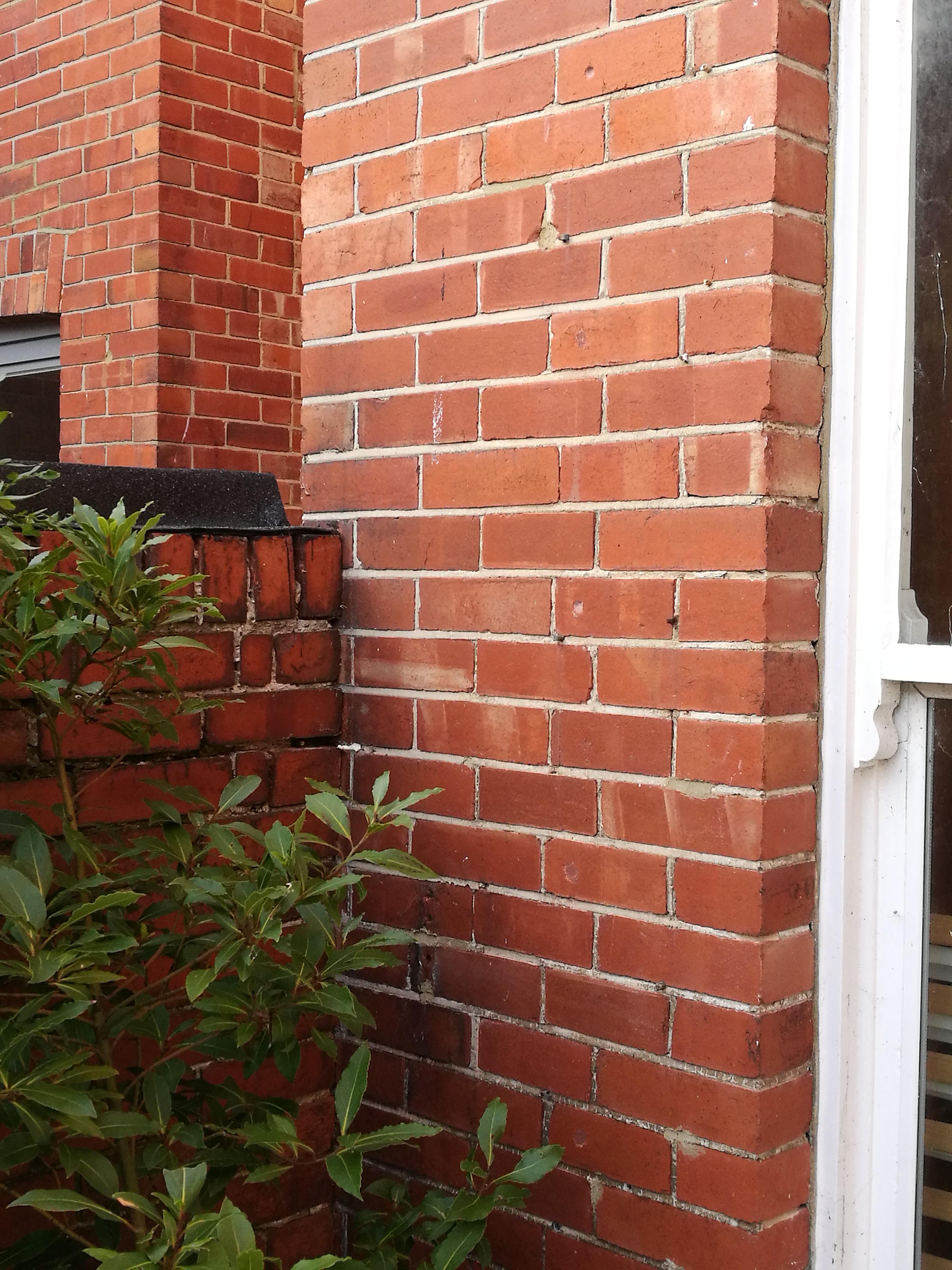

Triggaaar Posted November 17, 2018 Author Share Posted November 17, 2018 35 minutes ago, PeterW said: photo may help here ..! Ok, photos attached One just giving a general view of the wall, the other showing how it attaches to our house. The window (edge) to the right of the join will be inside our new room). Link to comment Share on other sites More sharing options...
